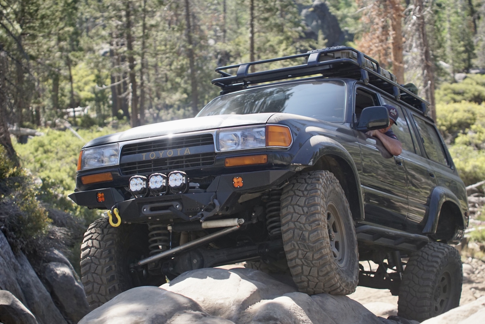

Here I will document the build of Honu 🐢 the 1994 Toyota Land Cruiser.
As she sits today:
Honu 🐢 is a 3x locked 1994 FZJ80 finished in 6M1 Dark Emerald Pearl. Built in Japan, sold in California and driven a scant 177,000 miles by two owners on the day she became mine. I found her on FB Marketplace in Newark, CA. I messaged the seller, who was listing it for his dad. He claims his father owned it since 2000, and drove it regularly until he parked it in 2020. He changed the oil, put a battery in it and listed it for sale. I managed to talk the seller down a bit and after a short drive and a test of the locking diffs in a dirt parking lot nearby, she was all mine. The seller said he was fairly certain that his dad had never used the lockers, never even knew what the knob was for. I drove it the 65 or so miles home without incident.

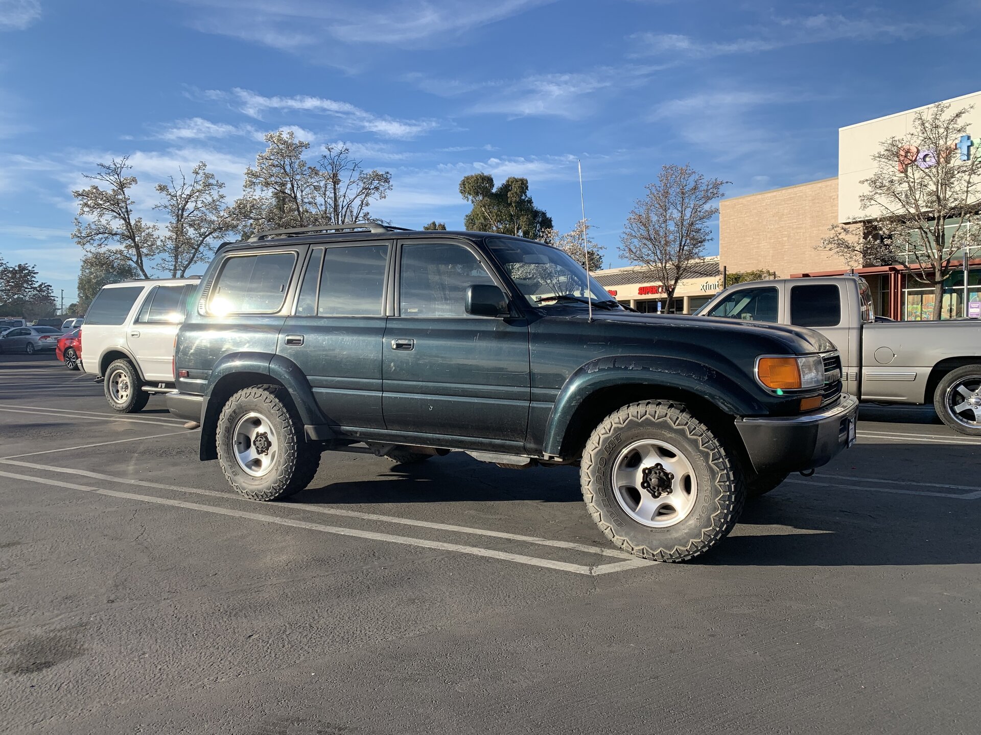

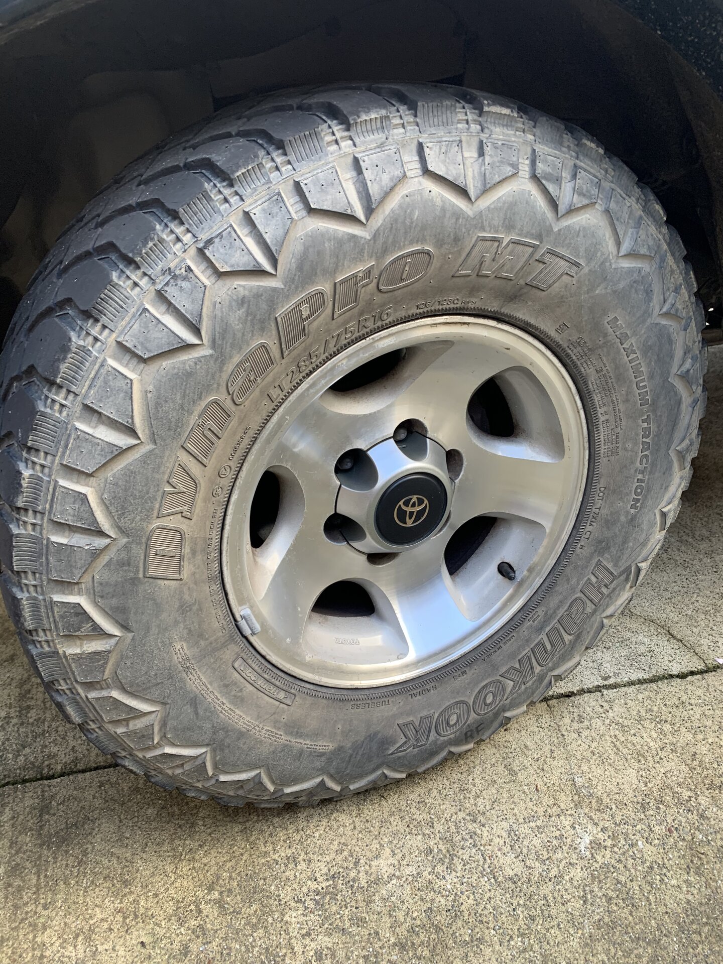

The first order of business was to give Honu 🐢 a solid once over, or as the folks here are calling it these days "Baseline". My experience (albeit limited) with Land Cruisers has taught me that there's none better suited for this task than the legendary Georg @orangefj45 and his team at Valley Hybrids. I swapped out the ancient cracked tires for a set of 285 Hankook MT's. They're worn and loud, but at least they're from this decade... after that it was off to Valley Hybrids for a full inspection. Georg worked his magic on Honu 🐢 and replaced the following:
New Aisin water pump, Tstat, upper and lower rad hoses, PHH, overflow bottle, fan clutch nut, rad flush and clean, front main seal, oil pump cover, valve cover gasket, spark plugs, wires, disributor cap and rotor, pcv valve, starter, belts, air intake bellow, air cleaner, oil change, brake flush, front drive shaft.
All in all he said it was a pretty clean truck and didn't need much more to be happily driven on a daily basis. Knowing that the crew at Valley Hybrids had gone over it with a fine tooth comb was worth its weight in gold. I am a fairly serviceable mechanic in my own right, but when it comes to determining the safety and operability of this LC, it was worth every penny to have them do the work.

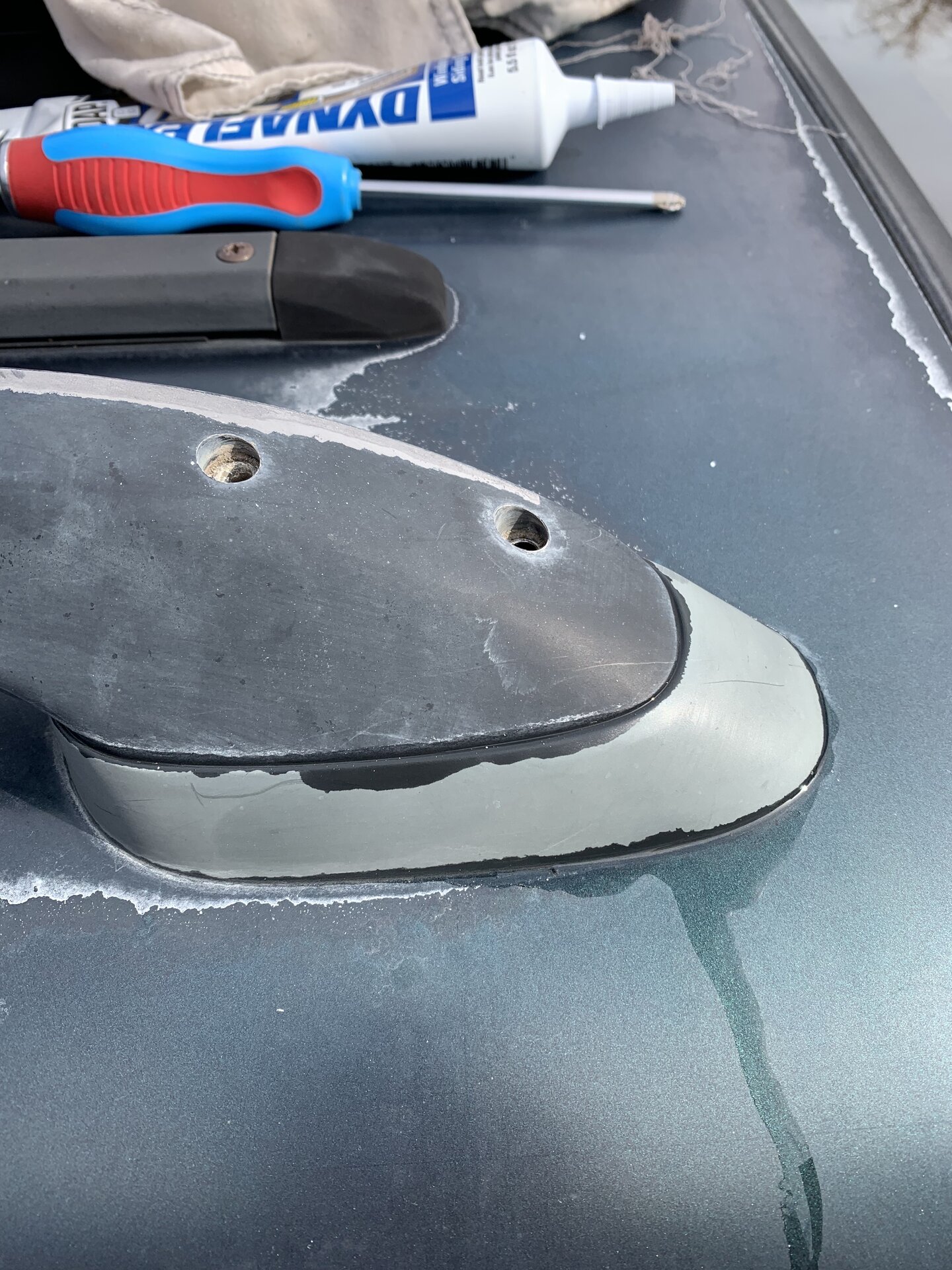

Replaced the p/s rear window vent trim with an OEM piece. Also installed a fresh steering column clamshell from Cruiser Parts. Pulled the roof rack and resealed all the holes with silicone sealer.

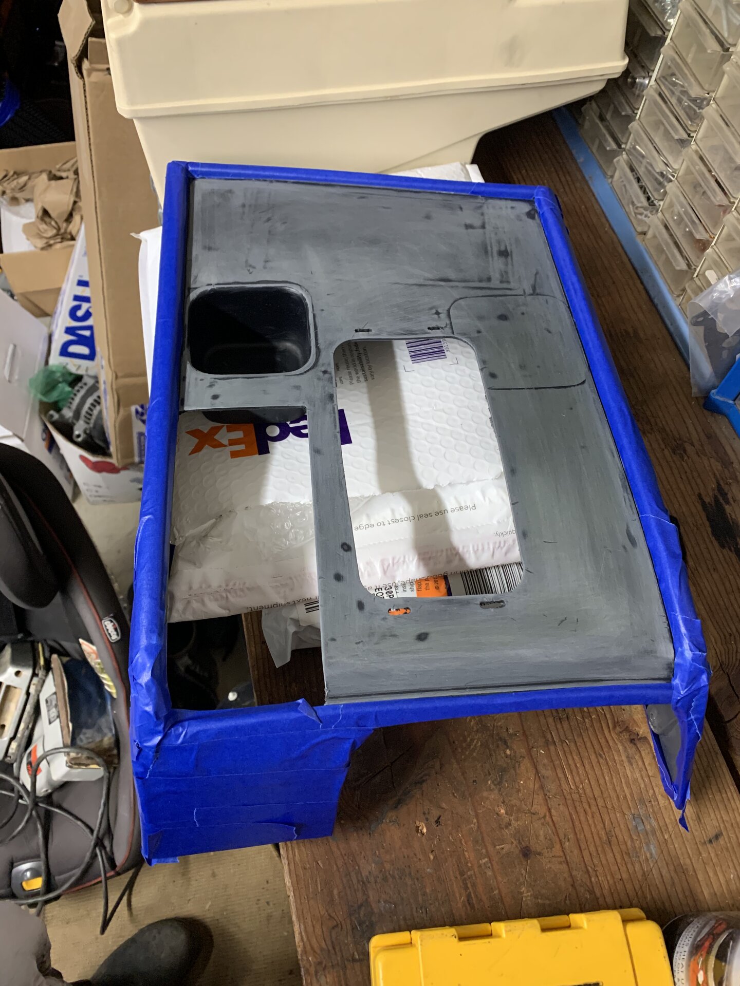

Next up is the removal of faux wood trim… the center console trim was pretty awful so I started there. Took forever to get all the goo off from the sticky tape.
And of course I added the must have cup holders from @bhicks

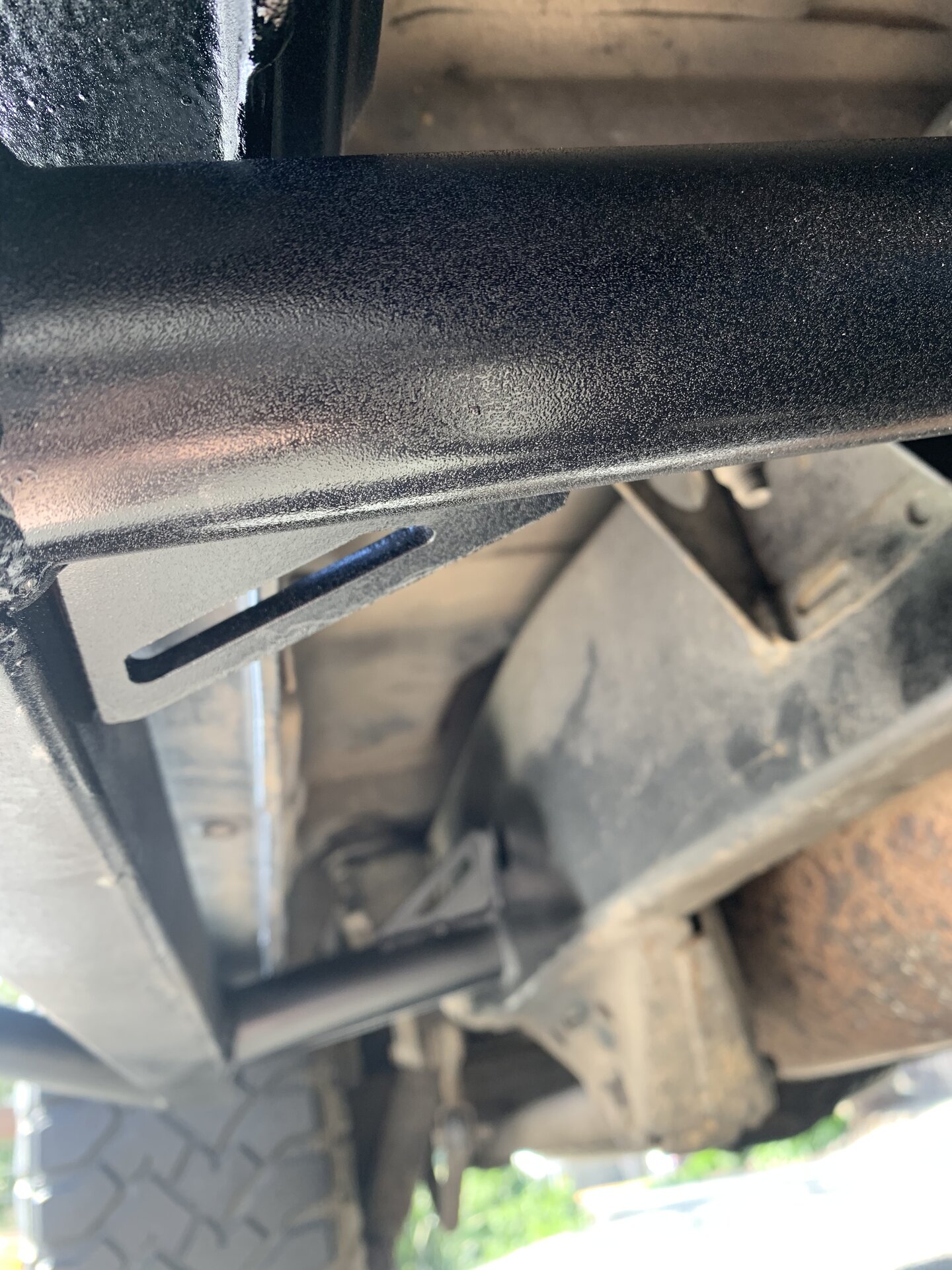

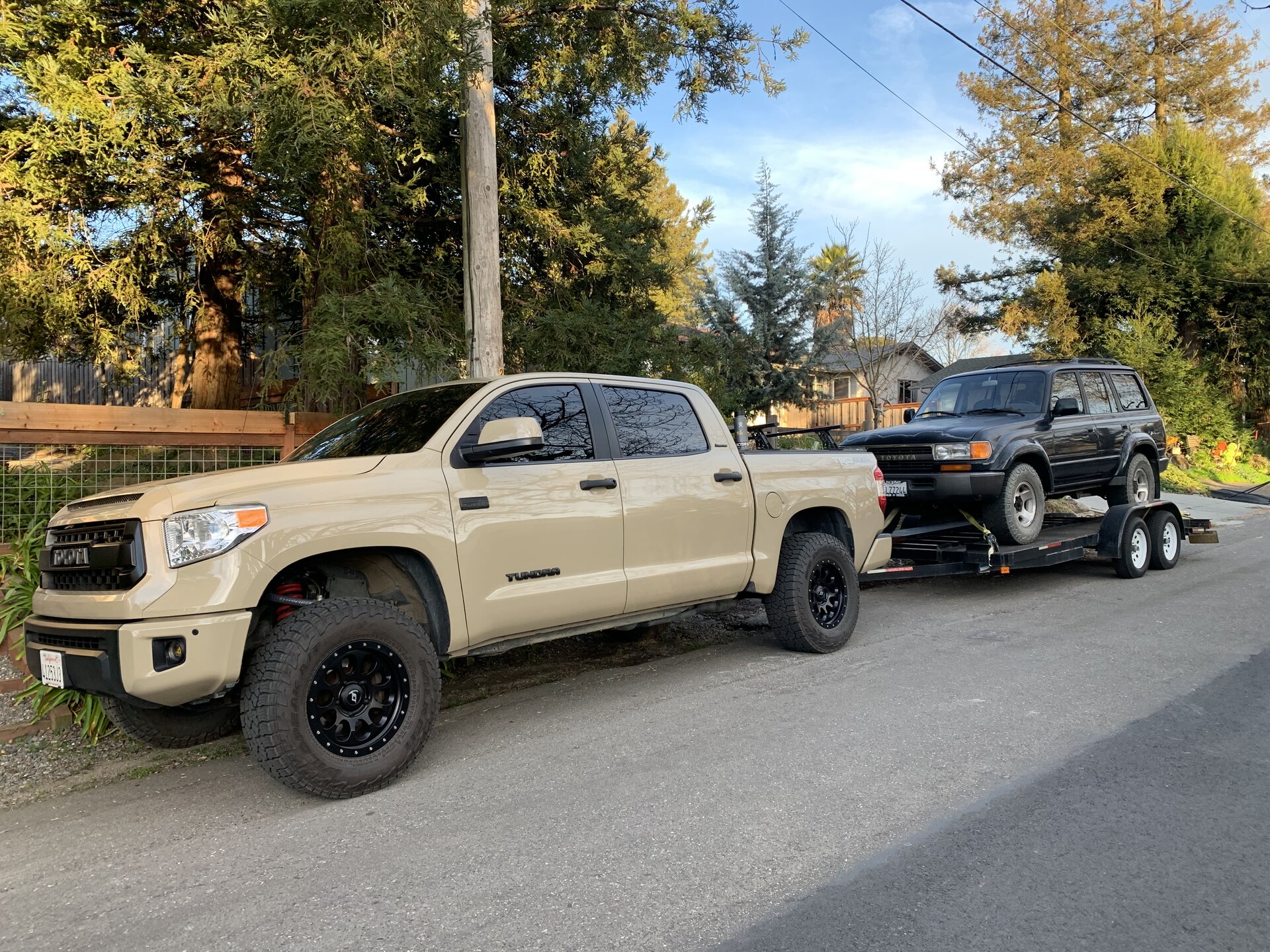

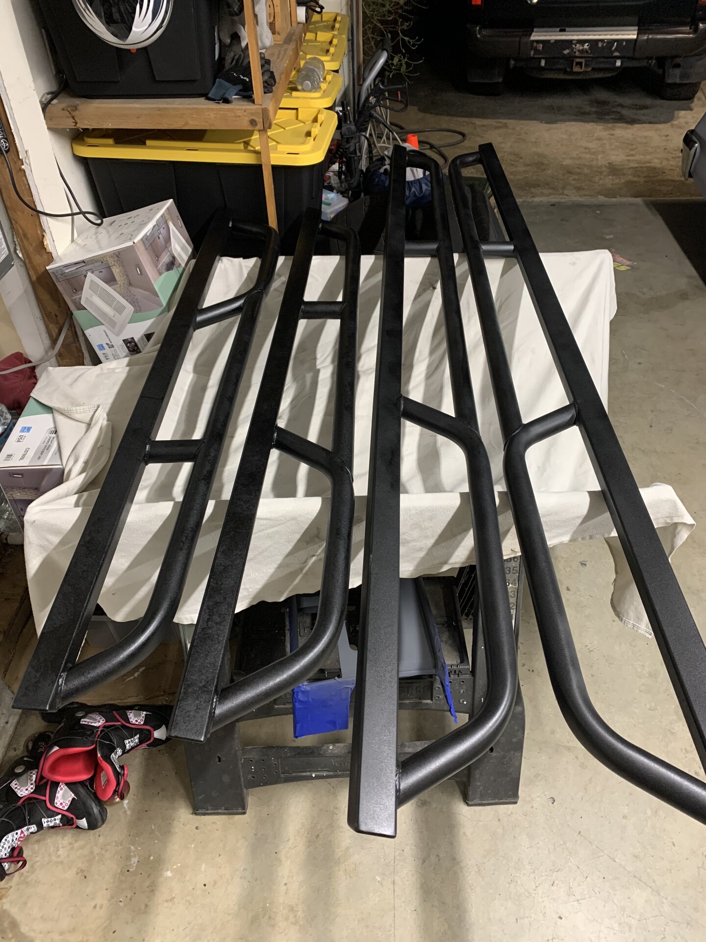

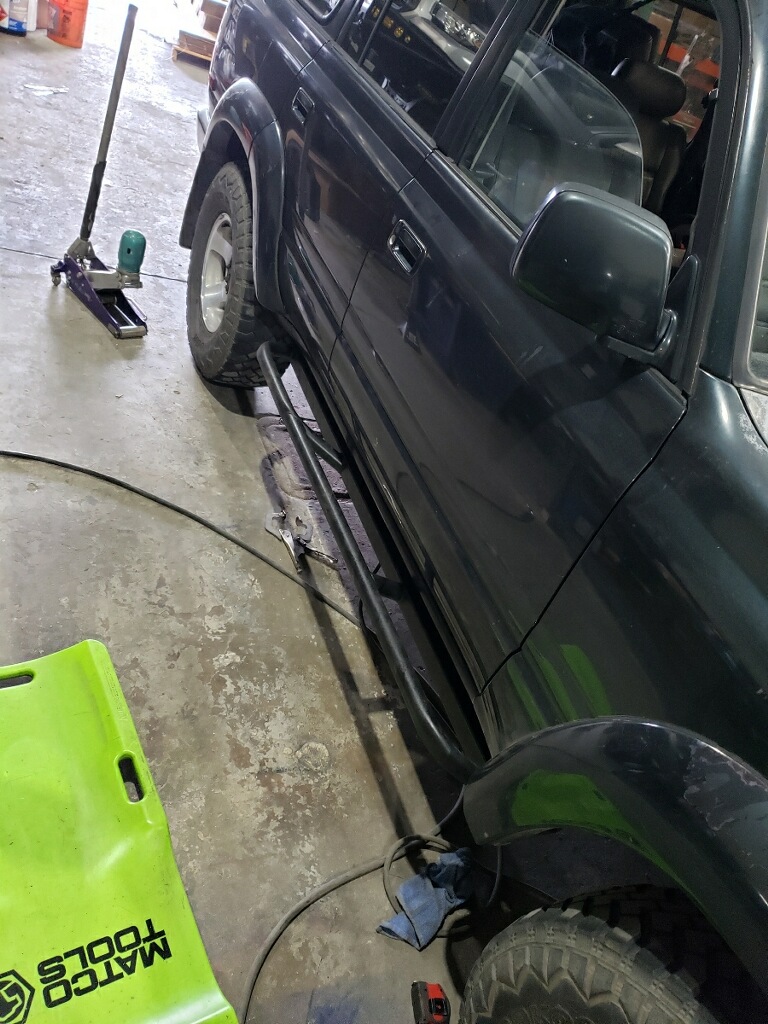

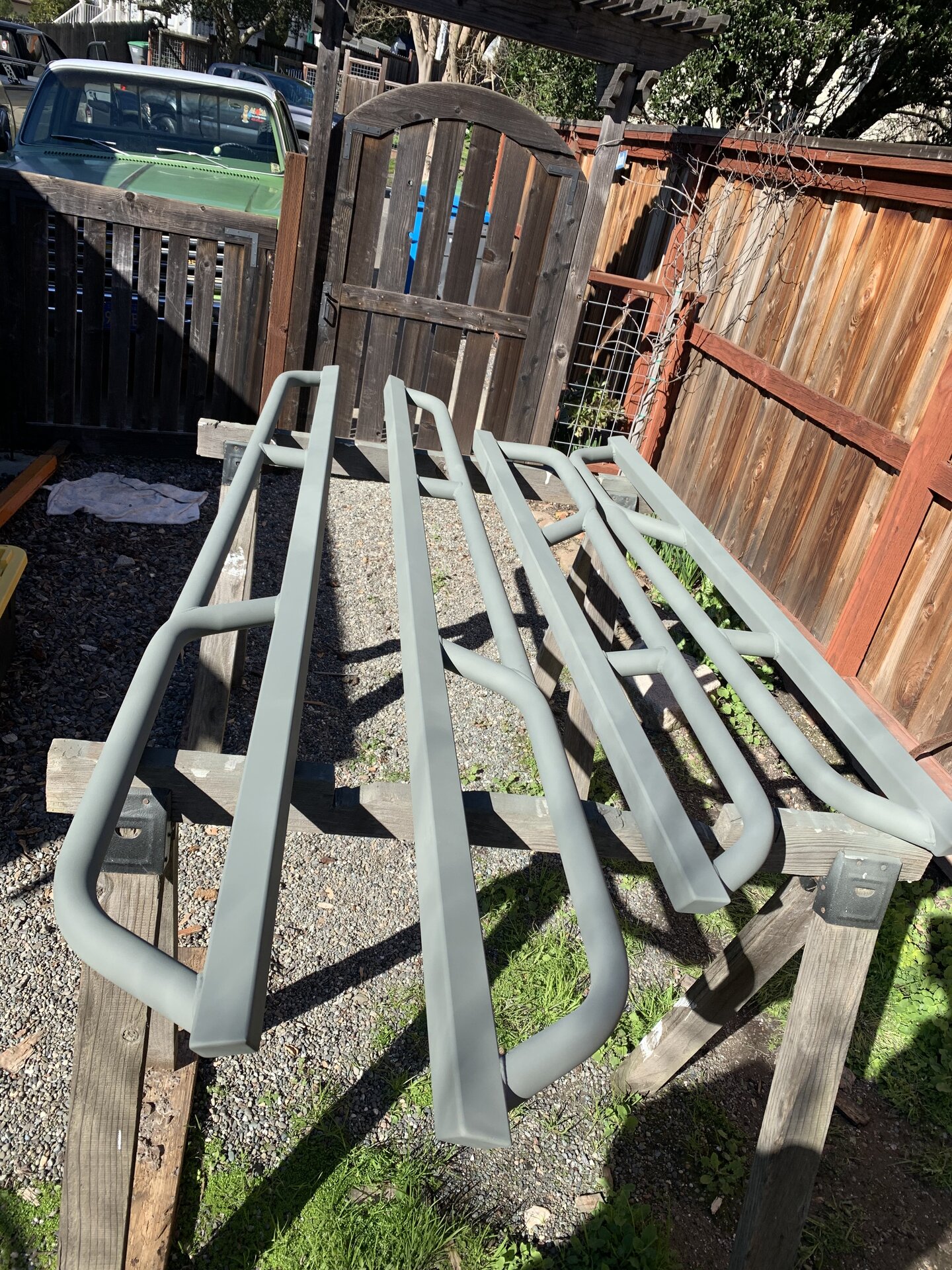

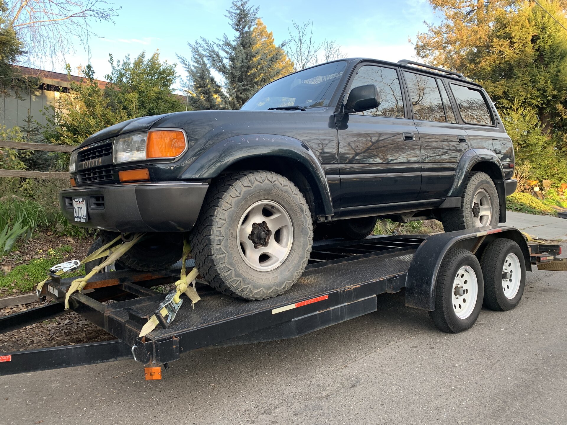

Pulled off the running boards today in preparation for rock sliders!
Loaded up on the trailer. Headed for the fab shop tomorrow to get the sliders welded up.

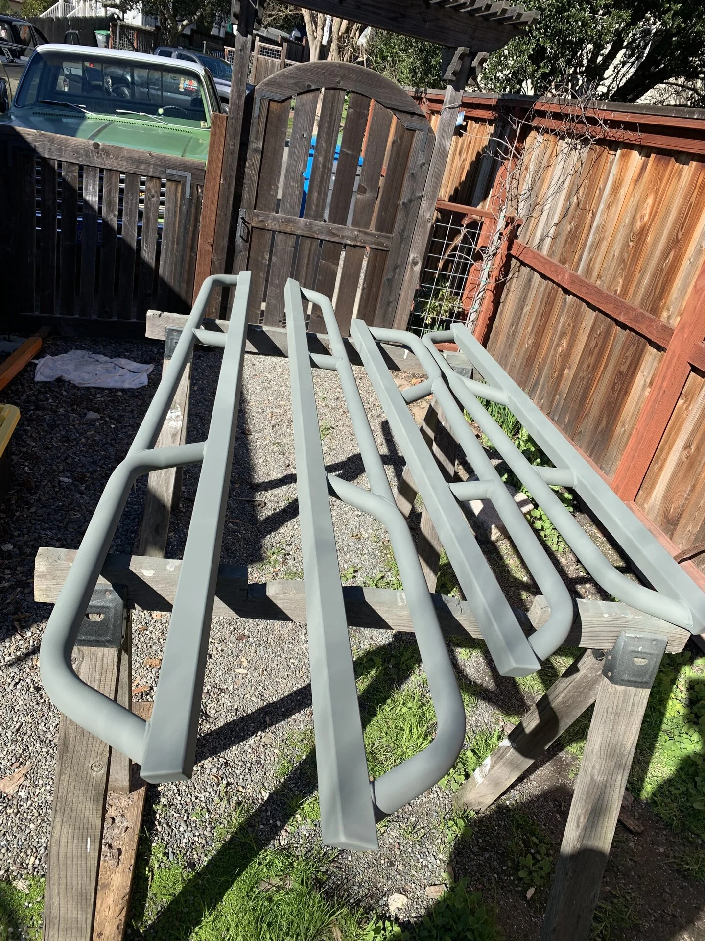

Putting a set on Sandra (the tundra) as well. Prepped them with self etching primer and a few coats of bedliner.
nice tundra LC combo
Pulled off the running boards today in preparation for rock sliders! View attachment 3253204
View attachment 3253205View attachment 3253206
View attachment 3253207View attachment 3253208
With the removal of the running boards changes the look of the LC a lot huh? Great looking Tundra, still my favorite body style of the Tundra. New Tundra looks like a Silverado.
Thanks! I shoulda pulled those running boards off long ago... sliders are being welded on today or tomorrow. :cool: Can't wait to see how she looks. And thanks for the kind words on Sandra, I'm a big fan of that truck.
