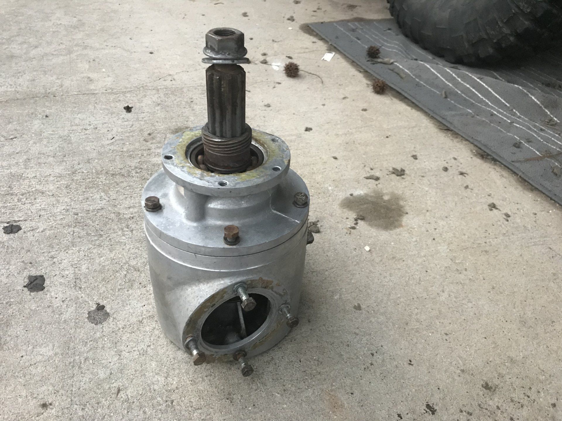

So, about a year ago, I scored what I thought was a Fairey OD. Come to find out, it is an old hone-o-drive OD.

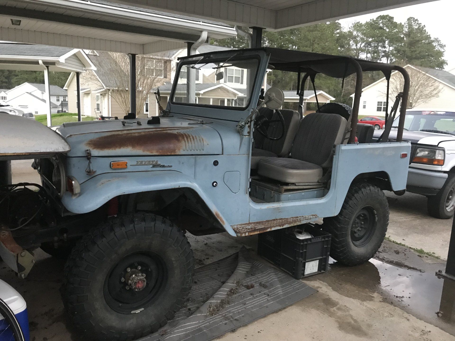

I’ve recently decided that this will go into my most driven FJ40. I enjoy the 4:10 gearing offroad but it has gotten old for extended treks. Really anything over 10 miles one way. I want to be able to start trying longer treks like driving to events, trails, etc. I’m trusting that this is the solution.
Notice the mathematical equation on this cool manual that Brian @whitey45 sent me. Thanks! At 60 mph, I’d rather be at 2000 rpm than almost 3000. It is a 30% od!

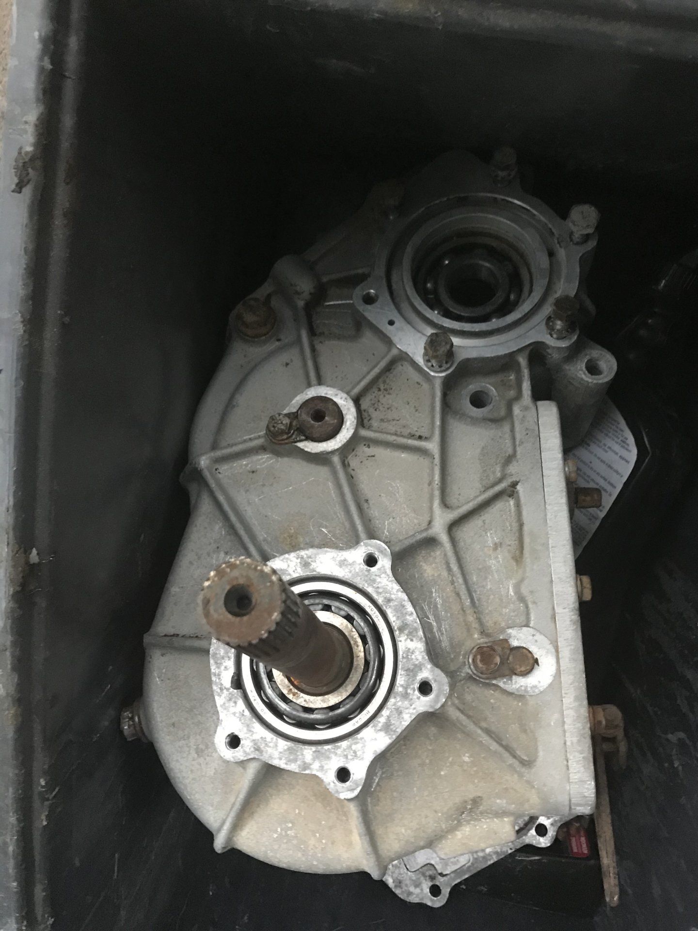

I just ordered a t case gasket kit from cruiser outfitters and I will soon drop off my rear drive shaft to have it shortened 210 mm’s as per the manual. Only thing I’ve done is clean and degrease the t case / od.

33 KO2 mud terrains
Stay tuned!

1. I wouldn’t get the driveshaft done until the overdrive is installed. I like to take my own measurements, even if it’s only an 1/8” difference.
2. Hone drives are more notoriously weak than Fairey, so I’d be giving that OD a real thorough check before installing. The small helical gears cut into each other fairly quick if the shafts that they ride on aren’t up to snuff.
