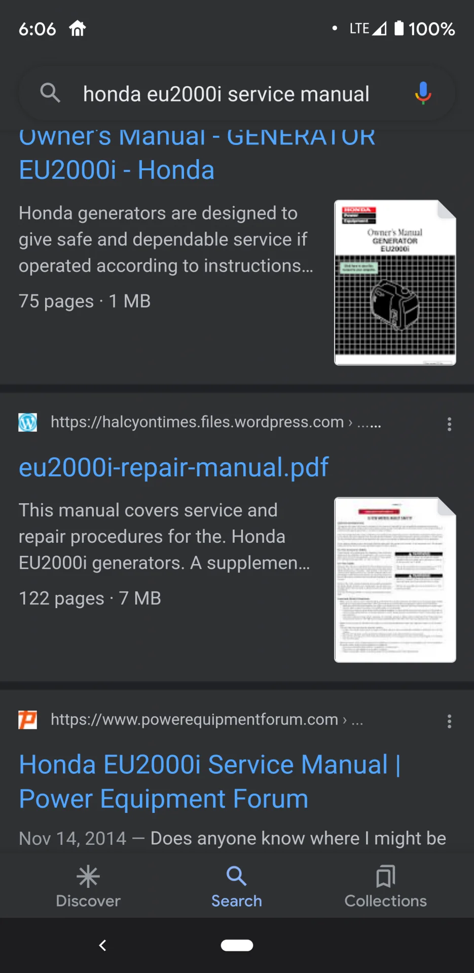

Sorry this isn't clicky, but the service manual is right here.
fantastic! got them both. that will help. Thanks so much!
