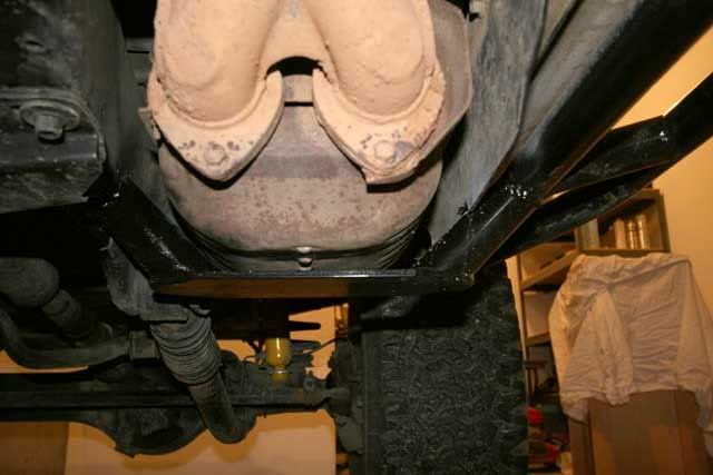

Lousy pics but should give you an idea of what I did with them. Welded to the frame with gussets on top of the tubes.
Couple of how I worked around the cats.
Driver side
