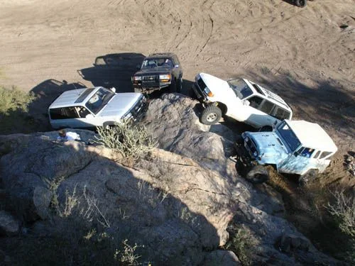

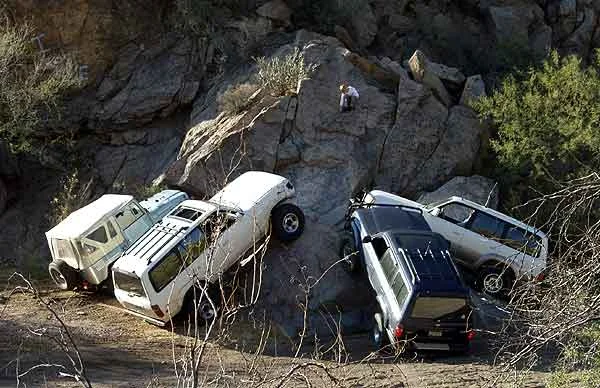

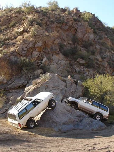

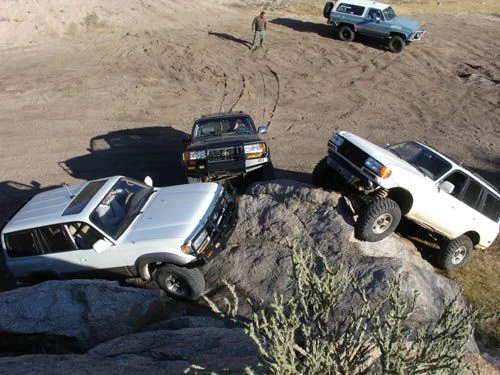

Bouncing along Upper Sycamore, and THEN... we found the perfect rock for poser Pics :cool: first there were two, and then three....
...and pretty soon there were four Cruisers on that rock :cool:

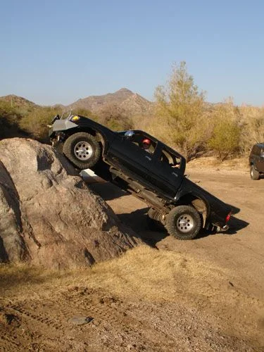

looked like the perfect service bay, and the Taco wasn't that far behind. If you wanted to see the K5, well, that's on another forum...;) ;p
And note, in contrast to a recently posted poser pic of a certain black LX, there were NO stacker rocks in order to git up on that thang...;p :grinpimp:

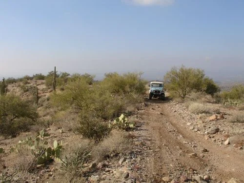

A few more...
Well, to complete the Holiday Wheeling Season, Karen and I are going to do a New Year's Day jaunt north of town. We plan to run Table Mesa Road from I-17 (exit 236) into Camp Creek Road which spits you out just north of Cave Creek and Bartlett Lake. This is not a difficult run (I ran it my stock Avalanche 4x4), but is fun, scenic, and offers some side trails as well. Anyone intersted, post up and well figure out a meeting place - no gas at Exit 236, as I remember.
