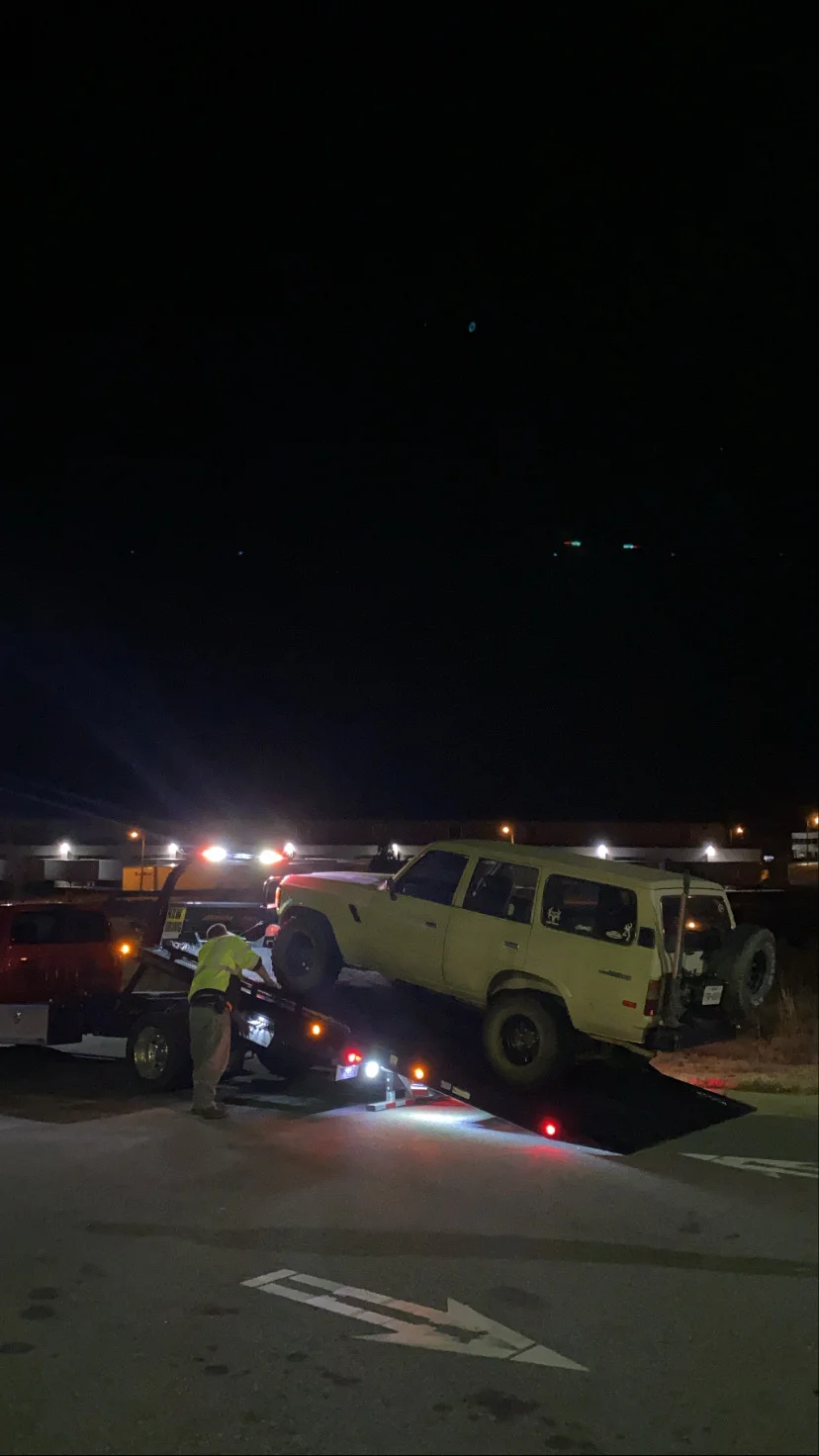

I was filling up the tank, having nursed a dying alternator/battery for a few hours now, and the slave cylinder finally lost all hydraulic pressure. Seal was toast and fluid was gone. I bumped the poor truck away from the gas pump and headed for a parking spot out of the way to diagnose and work on a plan to patch her up. Went to back it into the spot and there wasn't enough juice left to bump it. At which point, with parts stores closed, no uhaul with a car trailer handy, and not wanting to spend another night on the road, I got to put my AAA coverage to the test that I had acquired only 48 hours earlier once I had officially taken possession of the truck. We got picked up and, thanks to our AAA driver attempting to break the set the land speed record for a flatbed carrying a FJ60, we were home in record time.
Now she's home and parts are stockpiling to get her baselined. New clutch slave and master were already on order as well as a new alternator before we even got home.

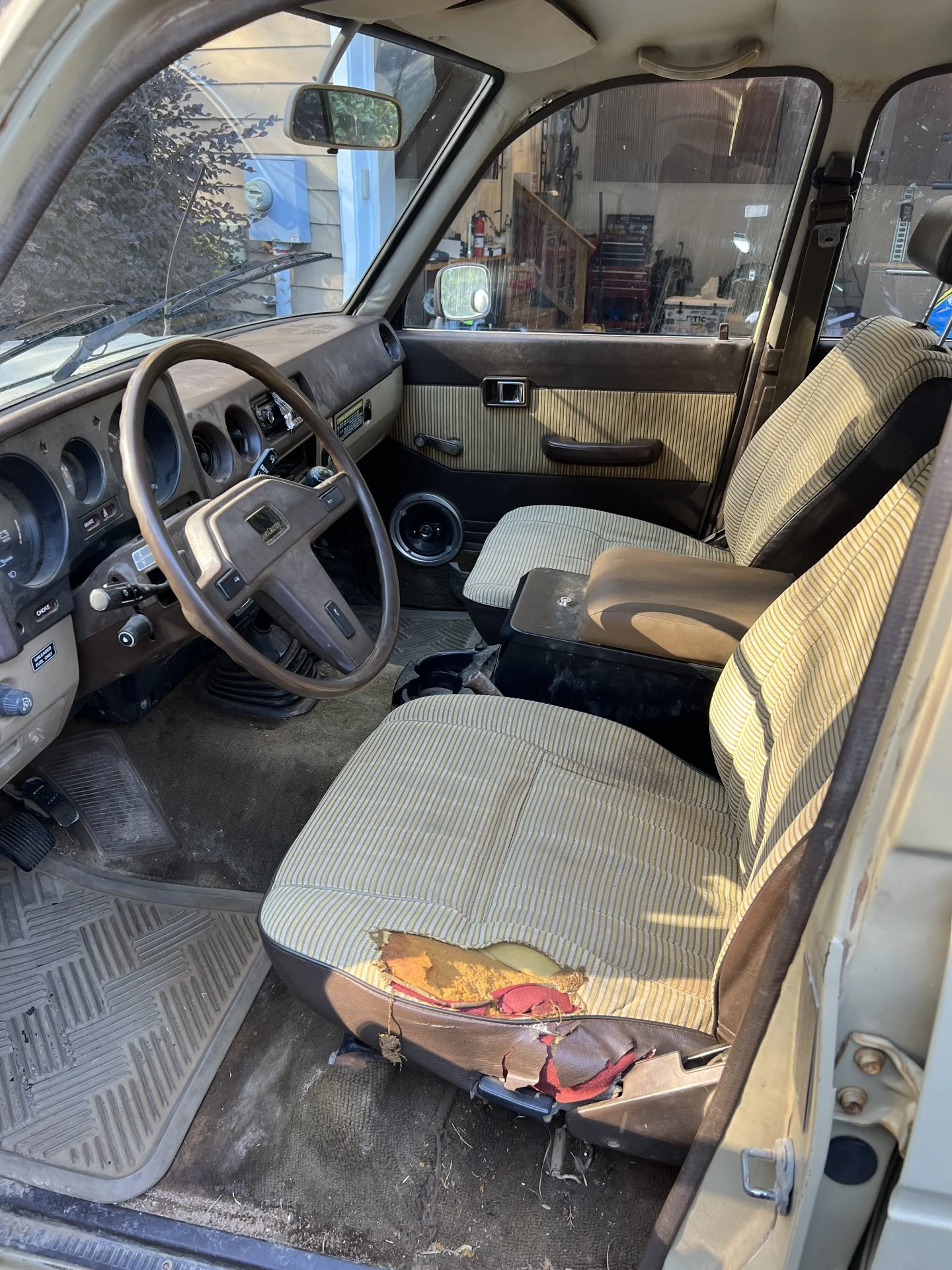

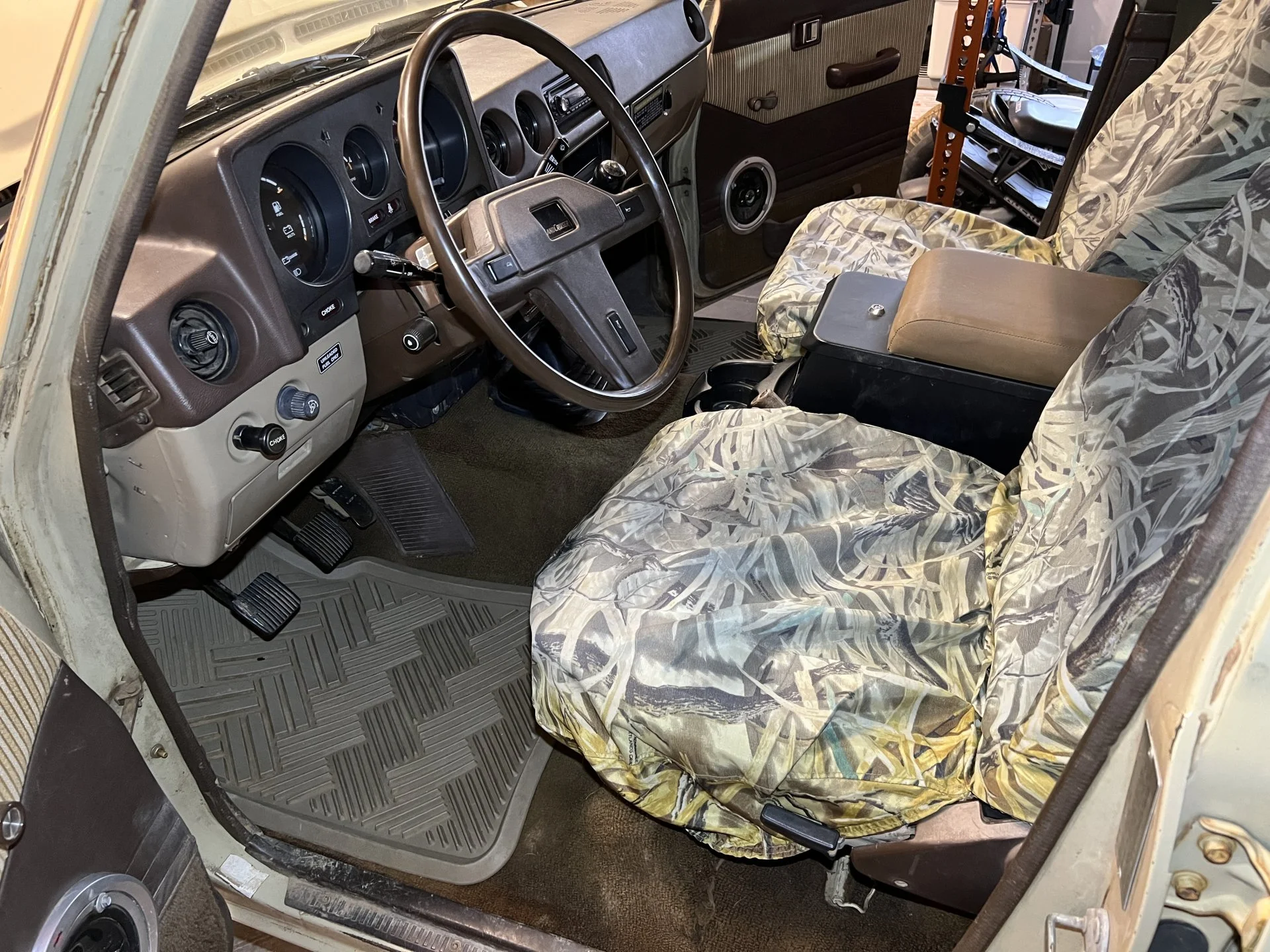

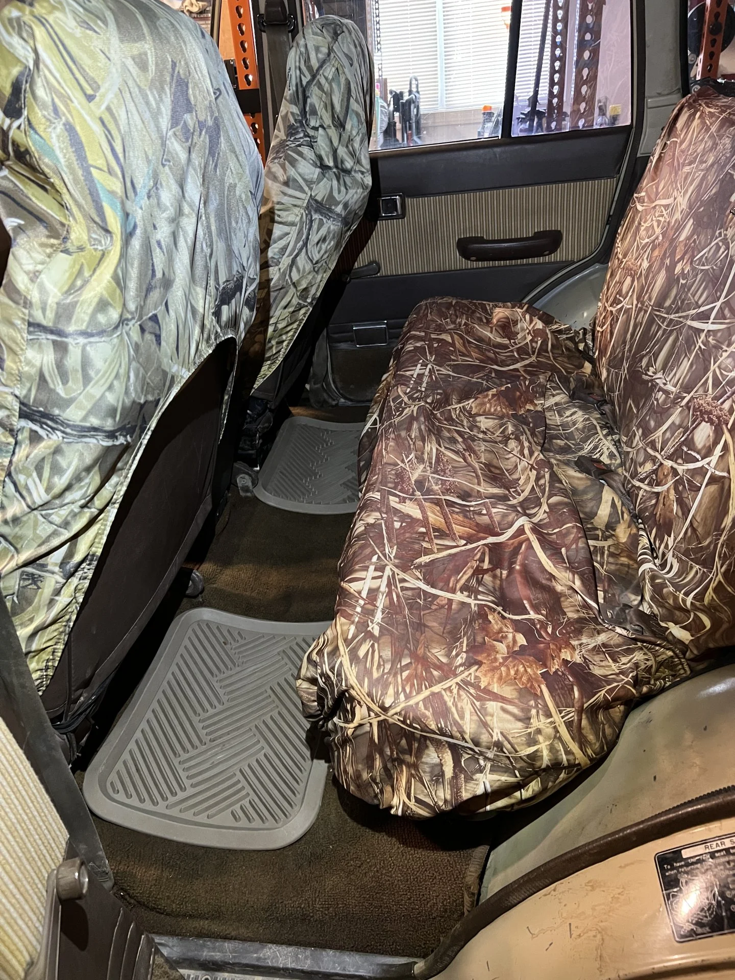

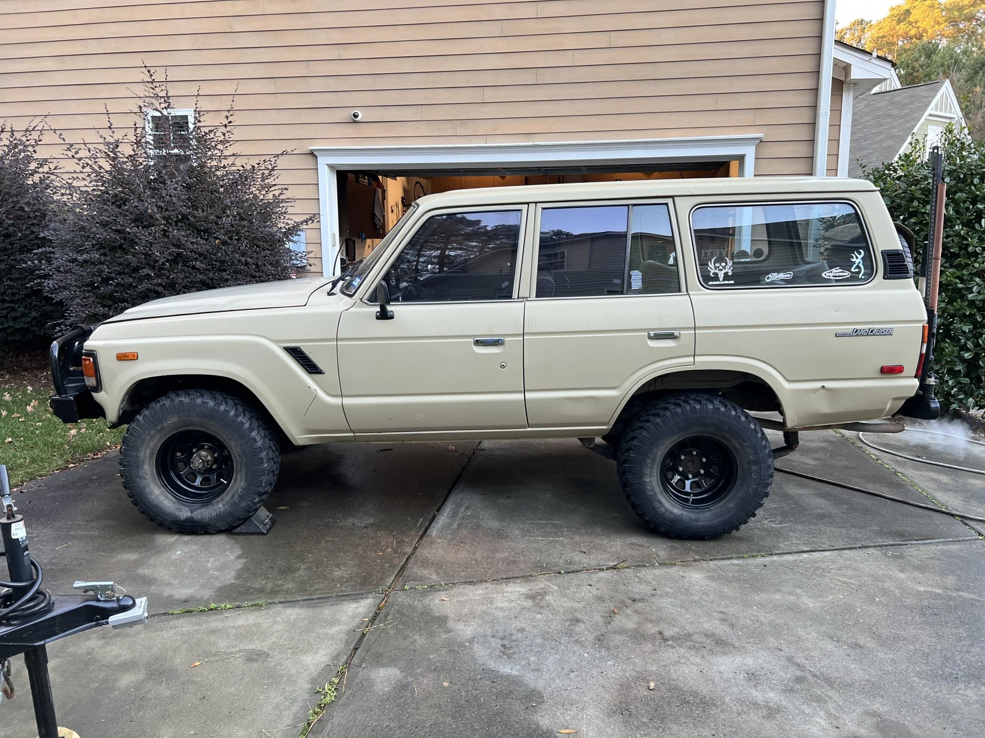

Some updates from the past few days. Gave it a bath and the first of probably 2 or 3 rounds of interior cleanings.

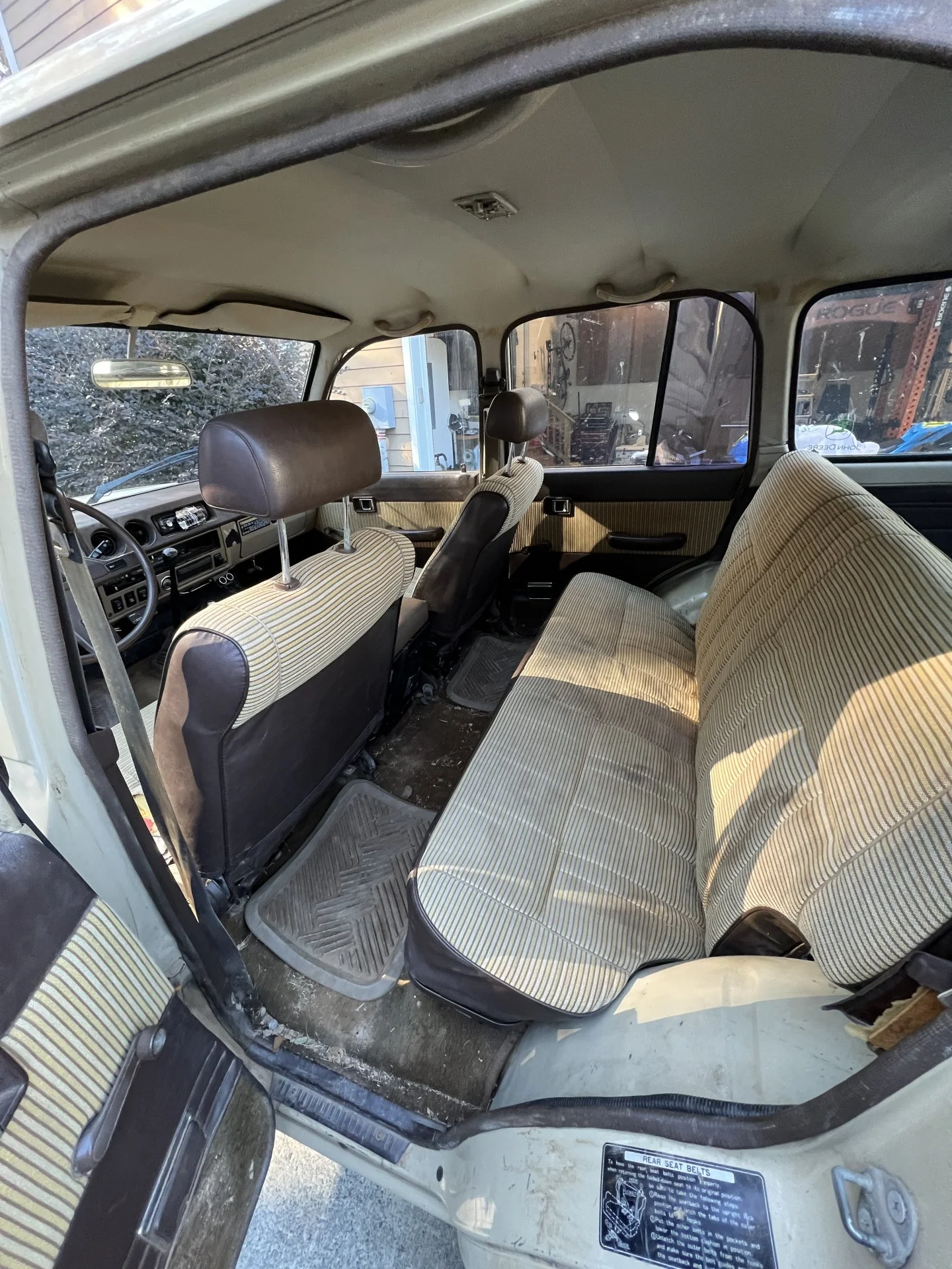

Interior as purchased (minus seat covers). Being a deer lease truck, it had years of mud and dirt ground into the carpets.
Here are the pics after the first round of cleaning. Carpet has some APC and brushing done prior to a date with a pressure washer. The carpet will get another round of cleaning and washing once my sound deadening arrives this weekend. Seat covers reinstalled.

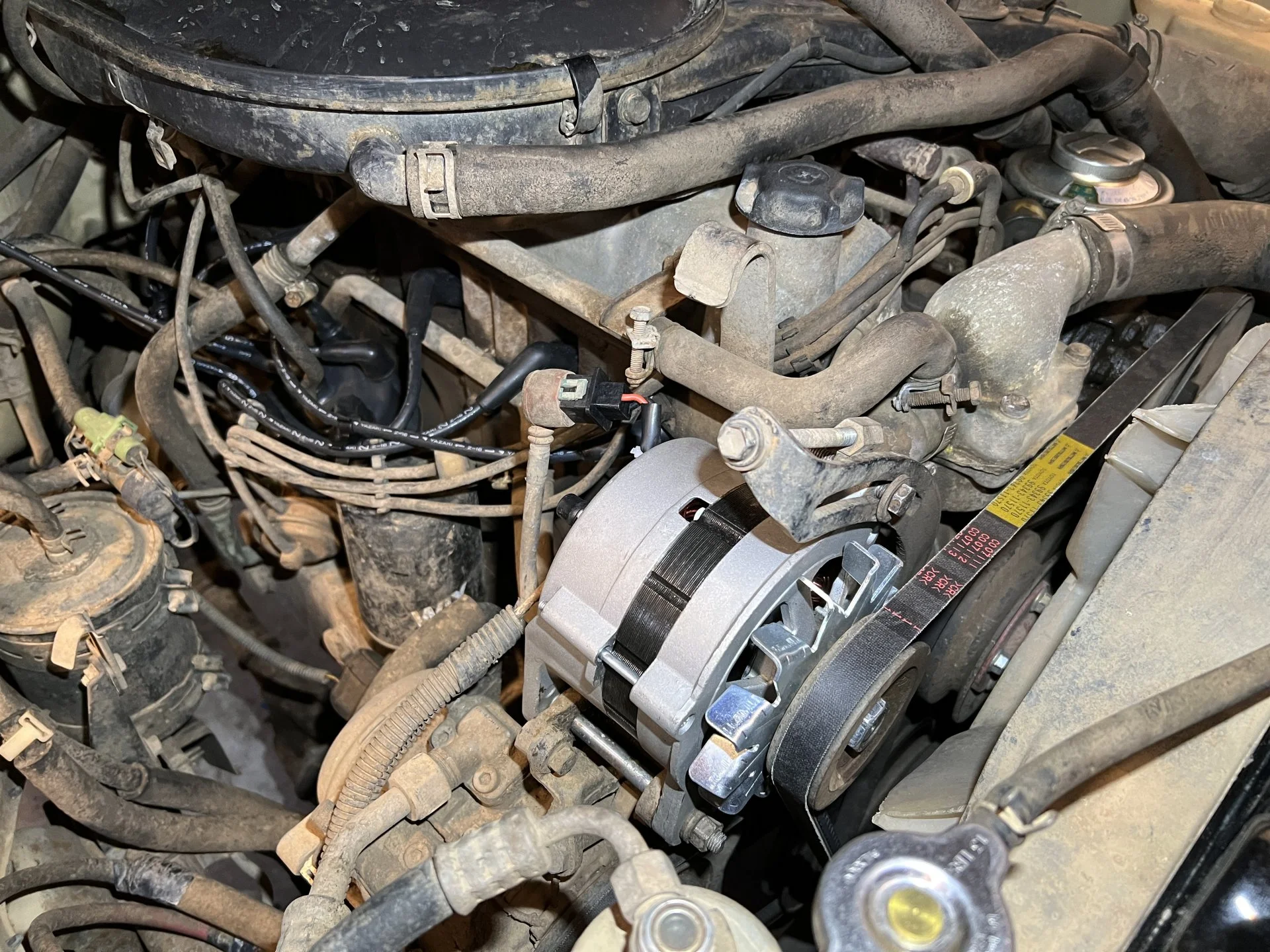

New 55amp alternator installed along with the first of 3 new belts. I also went through the first major system, ignition. New cap, rotor, wires and plugs. You can see that the engine bay will be getting some cleaning love as well in the future.

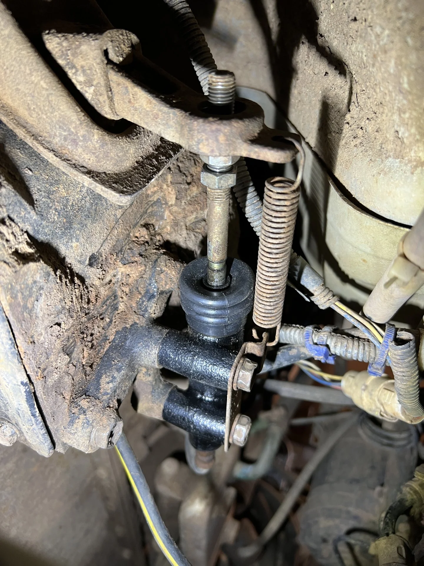

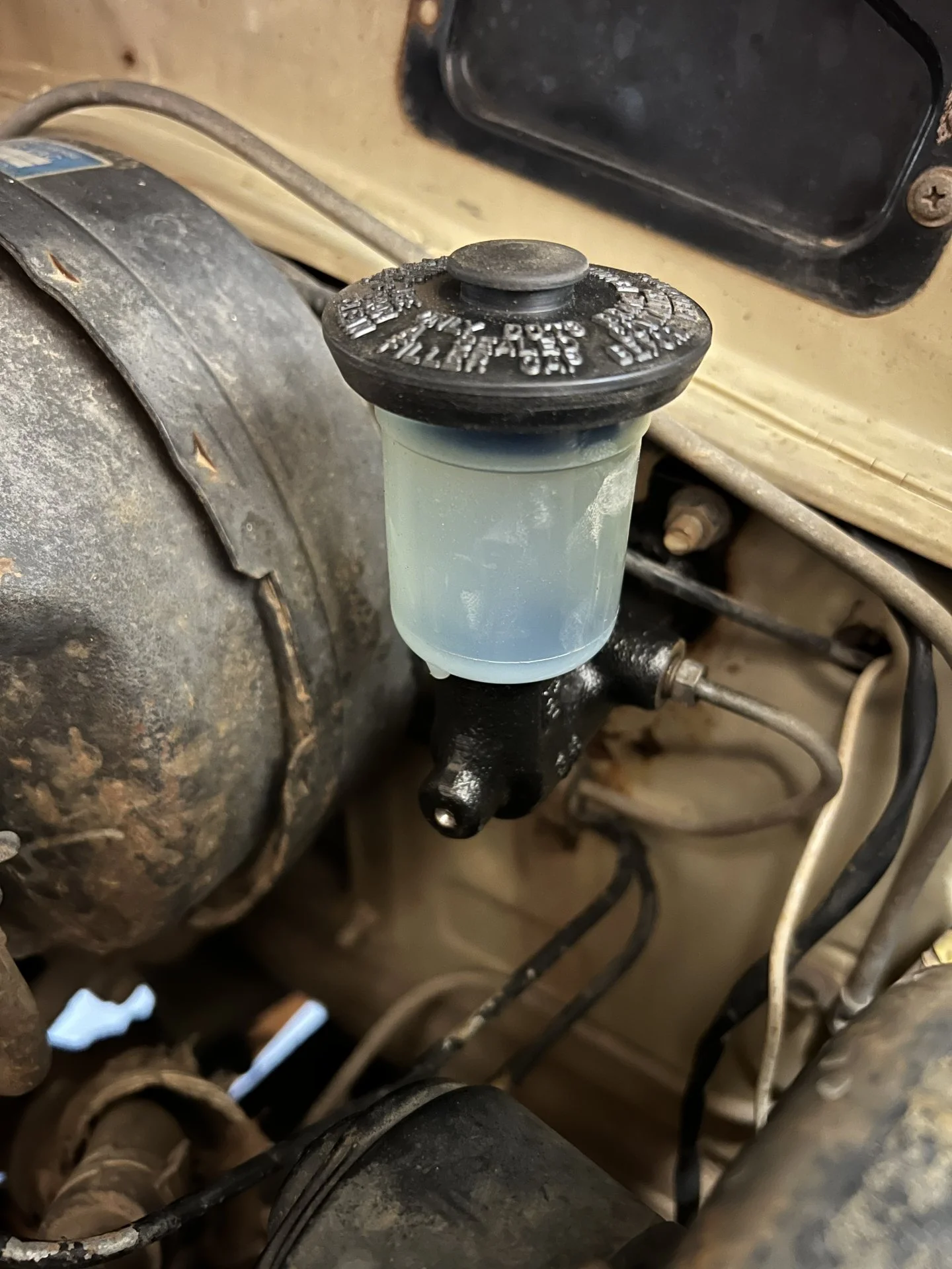

Next up was correcting the reason for our breakdown on the trip home. New clutch master cylinder an slave cylinder installed. Clutch is working great once again! New slave cylinder came with a rod that was about 1/2 the length of the OEM one so I reused the stock one as the other was too short. Rock auto guaranteed fitment FTW! Will keep an eye on it and see how it goes. I have another on hand in case this one is wonky. (yes, the locknut on the slave cylinder rod was snugged up after this pic was taken)
Love those safari stripes on the upholstery. Yours is pretty nice compared to most, minus the driver's seat rip that is always common. You could go really period correct and get some sheepskin covers.
They are definitely cool. I'm waiting for some more supplies to show up before I tackle really cleaning up the stock fabric seats as they're a bit dingy. Going to see if I can source a driver seat that isn't destroyed.

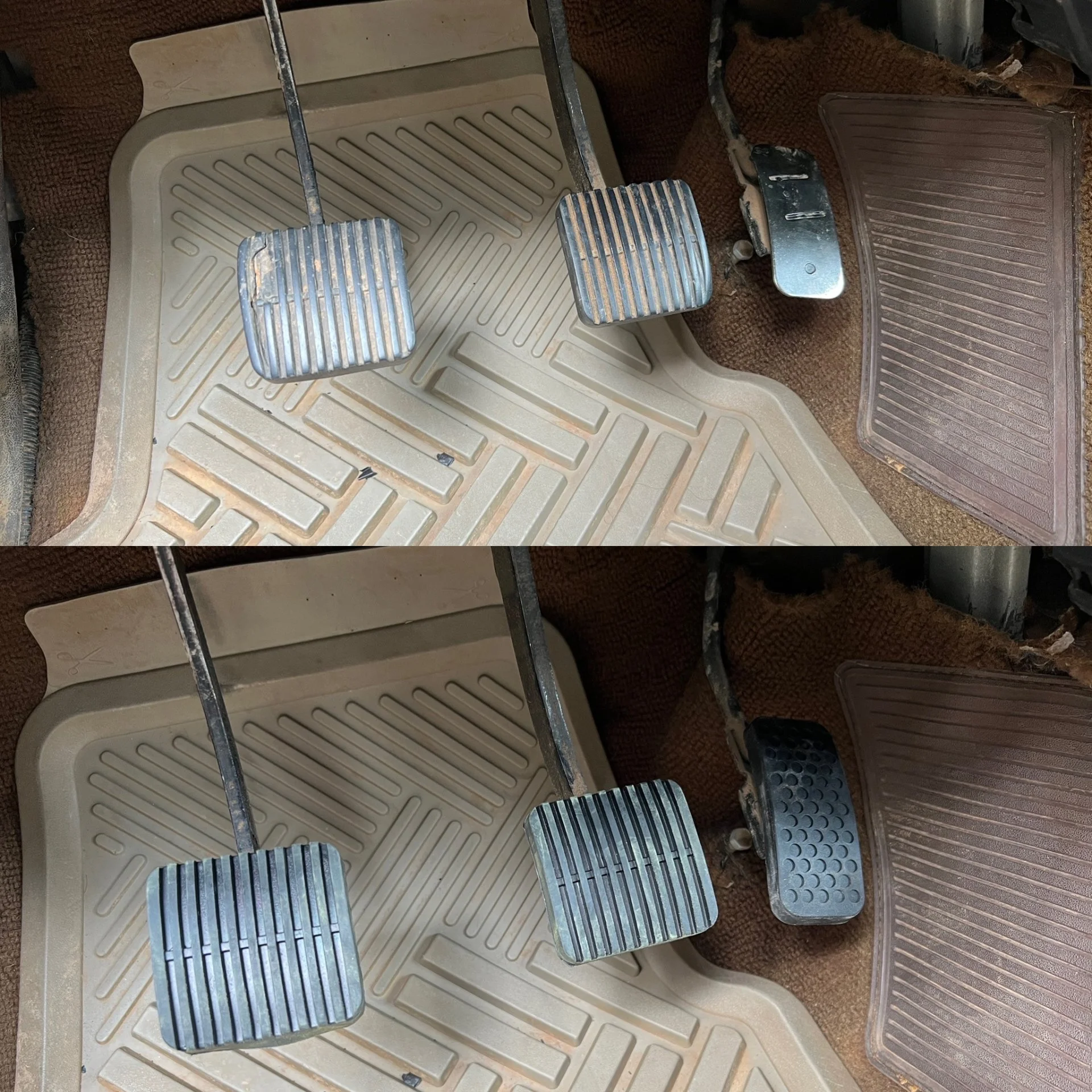

While I'm waiting for the rest of the parts to arrive to overhaul my cooling system, I decided to tackle some smaller tasks today since an order from my local dealer showed up. BTW, with Toyota's new dealer parts websites, I love the fact I can order stuff from my local dealer and pick up with no shipping fees instead of having to order from McGeorge or the like.
New liftgate struts (to replace the 2x4), shift knob, and pedal pads. Some items that make the day to day driving experience better.

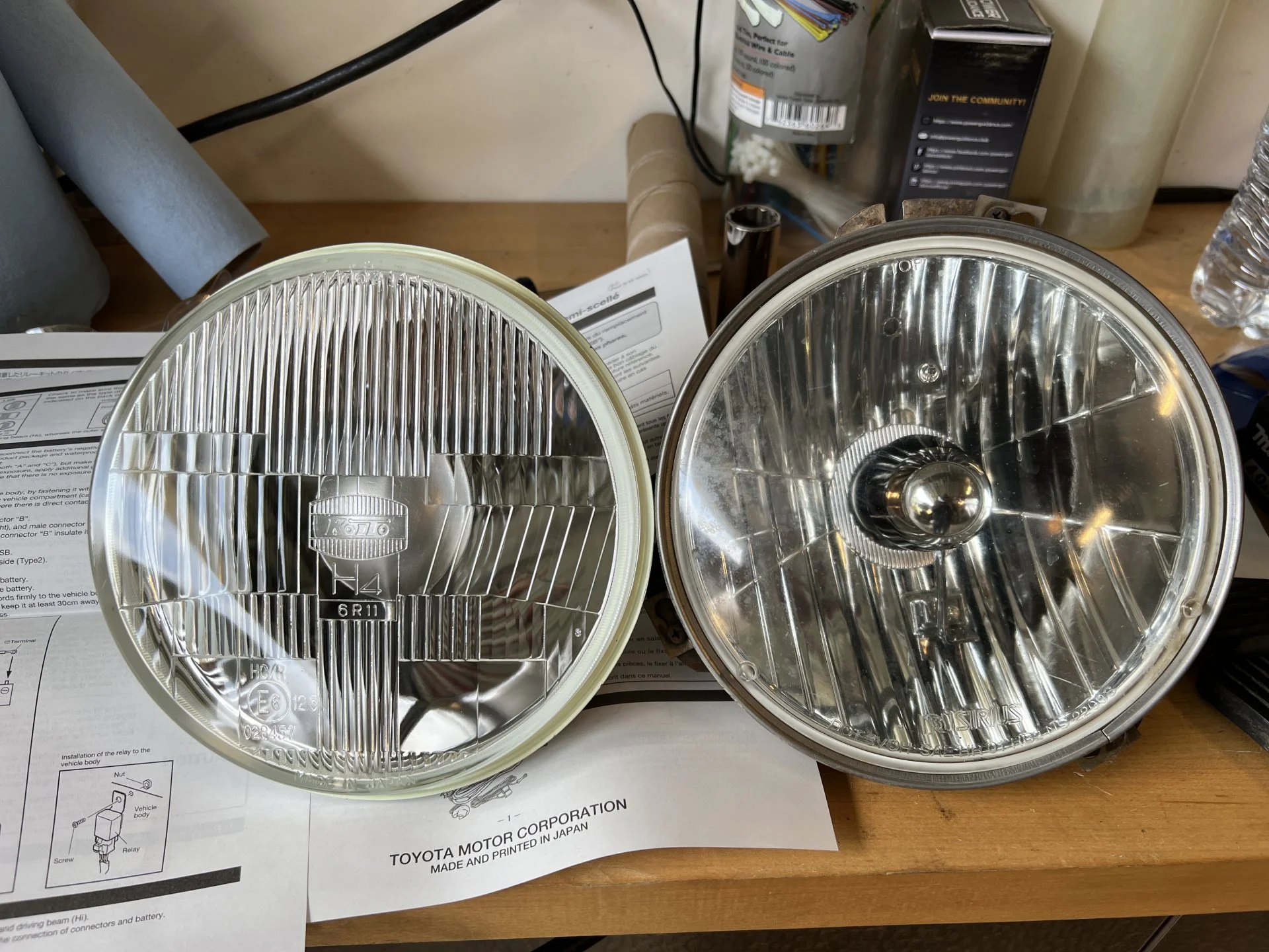

Then thew in my new Koito Toyota headlights for $40.14. (PN: 81110-60P70)
New on the left, old on the right.

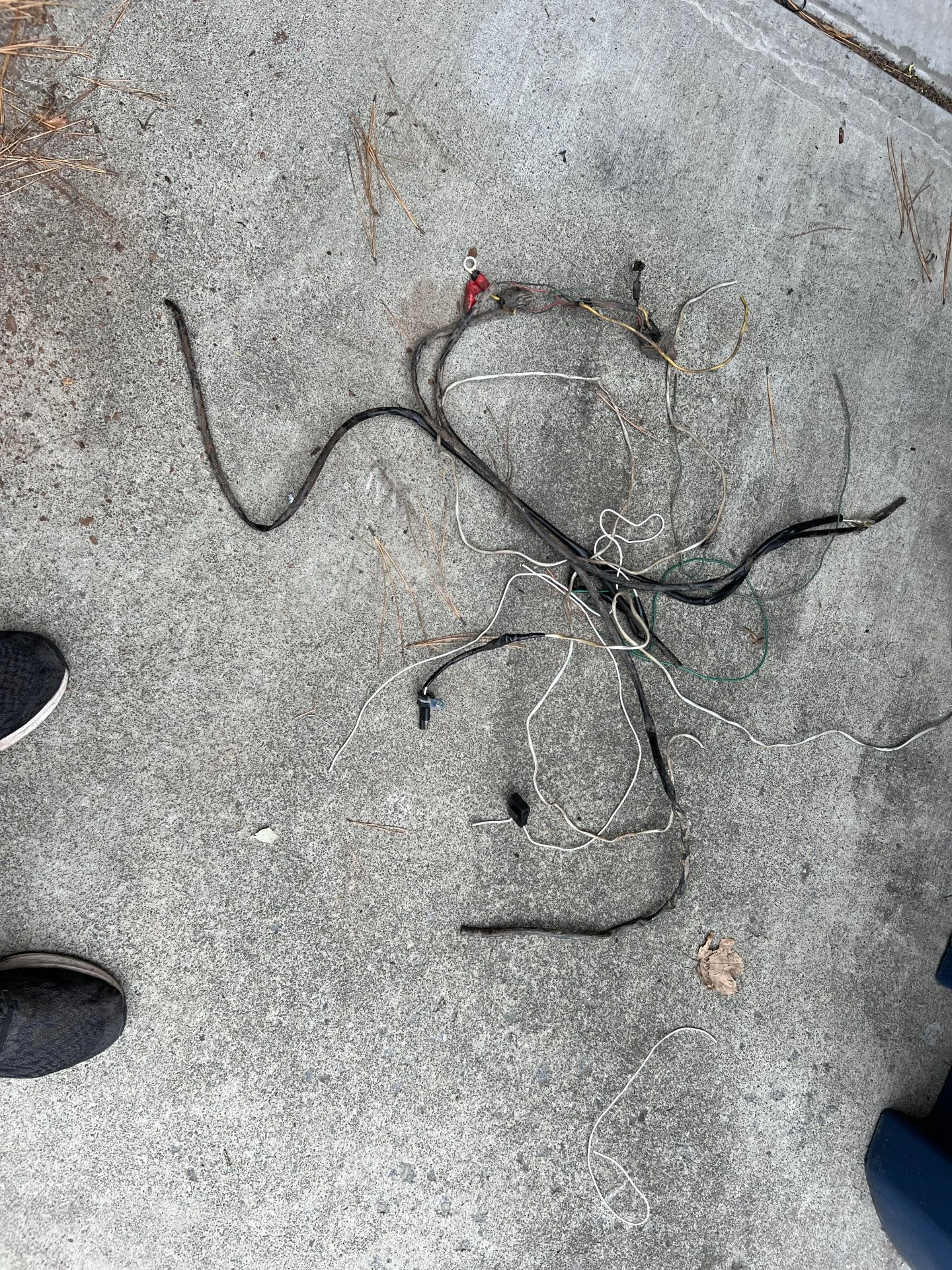

Then while putting in the new harness, I decided to get rid of some of the old accessory wiring in the truck that I didn't need and/or will replace with other accessories and newer wiring. Still more to come out.
The new headlights are the ones on the right? Best swap out those bulbs for LEDs. Super cheap and a ton of light.
:popcorn:
:popcorn:
New ones on the left. They are already way brighter than the stock ones! Once I get the cooling system sorted, I'll get the truck out and aim them.
Save the old ones for me, they look similar to my roundeyes :D
The ones on the left are h4 housings right? You can put led bulbs in those too, costs like $30.
You’ll be really happy with those lights. The pattern is so precise that it more than makes up for any lack of power.
