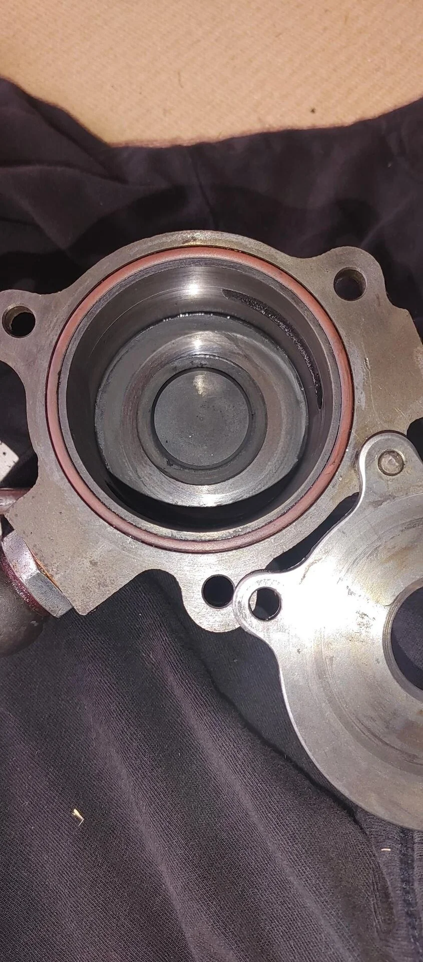

I have removed the alternator to dis-assemble the VAC unit and was surprised to find wear marks that are not central, so maybe the O ring(s) are not seating properly
I can't replace the O rings as my supplier has told me they are not available.
Can anyone advise whether the scuff marks are nornal (see pic) or is the an issue.

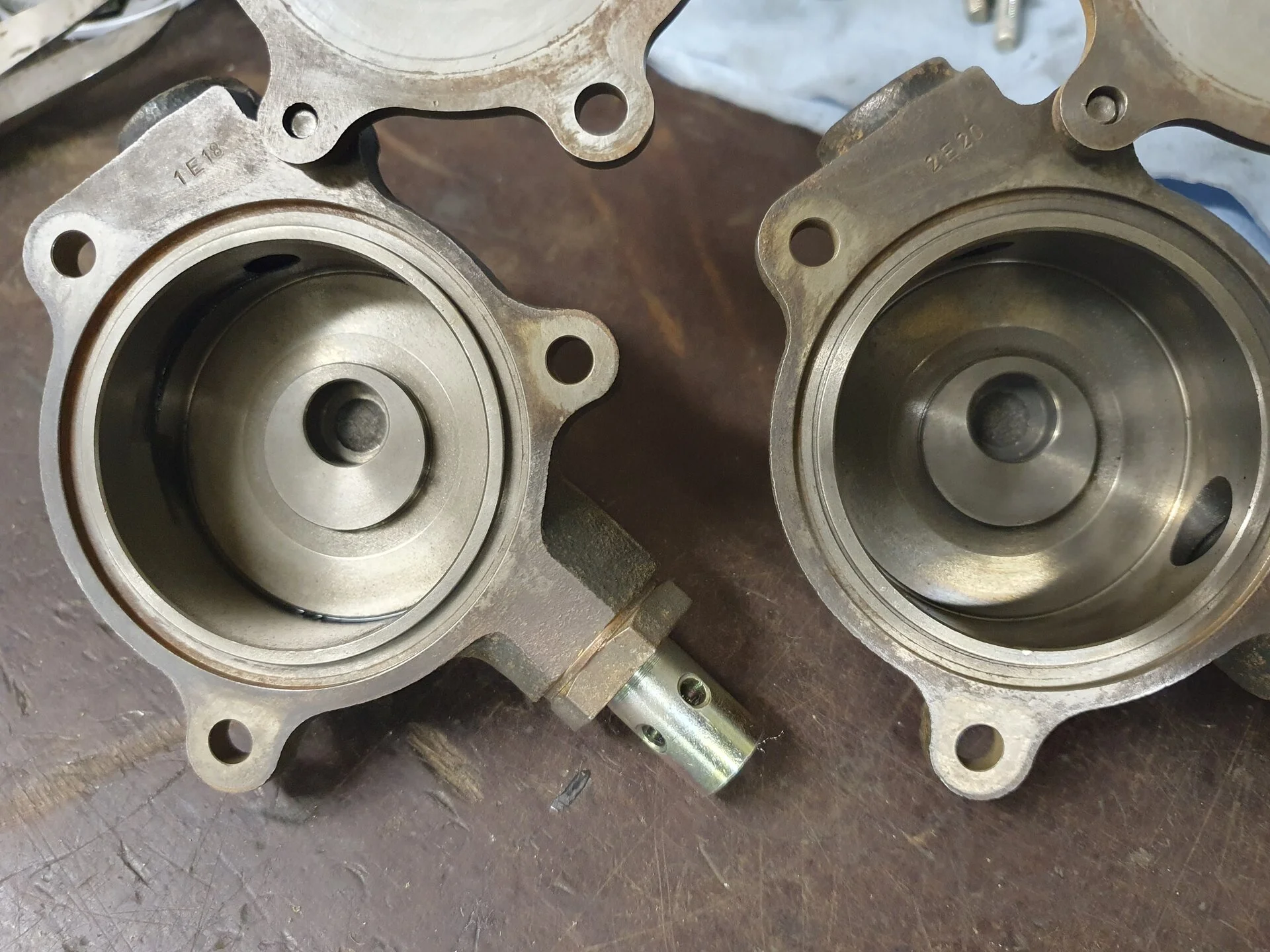

Just took 2 alternators apart and this is how the pumps look inside.
Almost no wear marks.
Your center part looks way different.
The vacuum it creates is kept in the system by means of a one way ball valve. That is the shiny part on my picture.

Your two at least show symmetrical marks around the centre.
So something seriously wrong with mine. And it was obvious the first day.

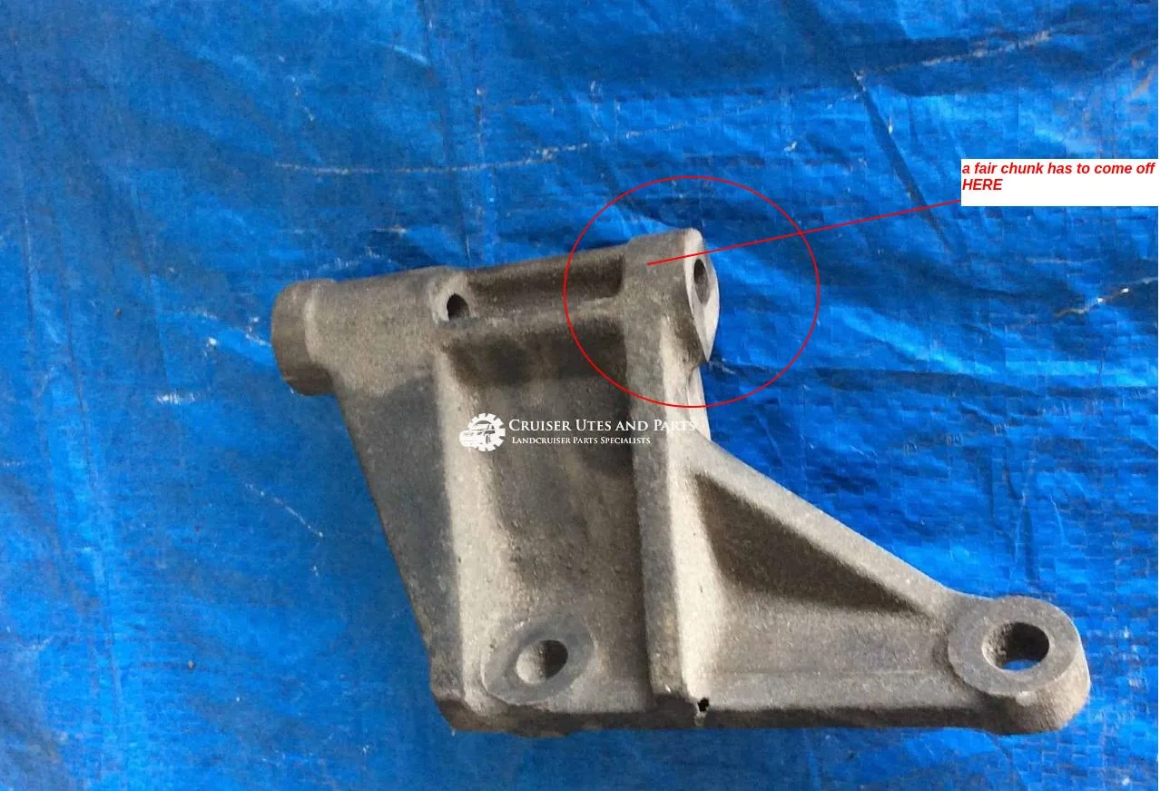

Looks like I need to get a Japanese truck 24v alternator over the counter here and butcher my mounting bracket.

IF others here that have cut their mounting bracket to fit an ISUZU 24v could post a pick of what they have done it would be helpful.
My reckoning is, the bracket may be susceptible to cracking after being cut as a fair bit of the rear thick part of the foot has to be cut off.
Leg to leg for 12HT 105mm isuzu is 81mm. Not a lot to remove but its the solid piece at the end.
I found an other mounting bracket I could but as a backup buy $200 is a bit steep. I guess I could get out the MIG and make something up
