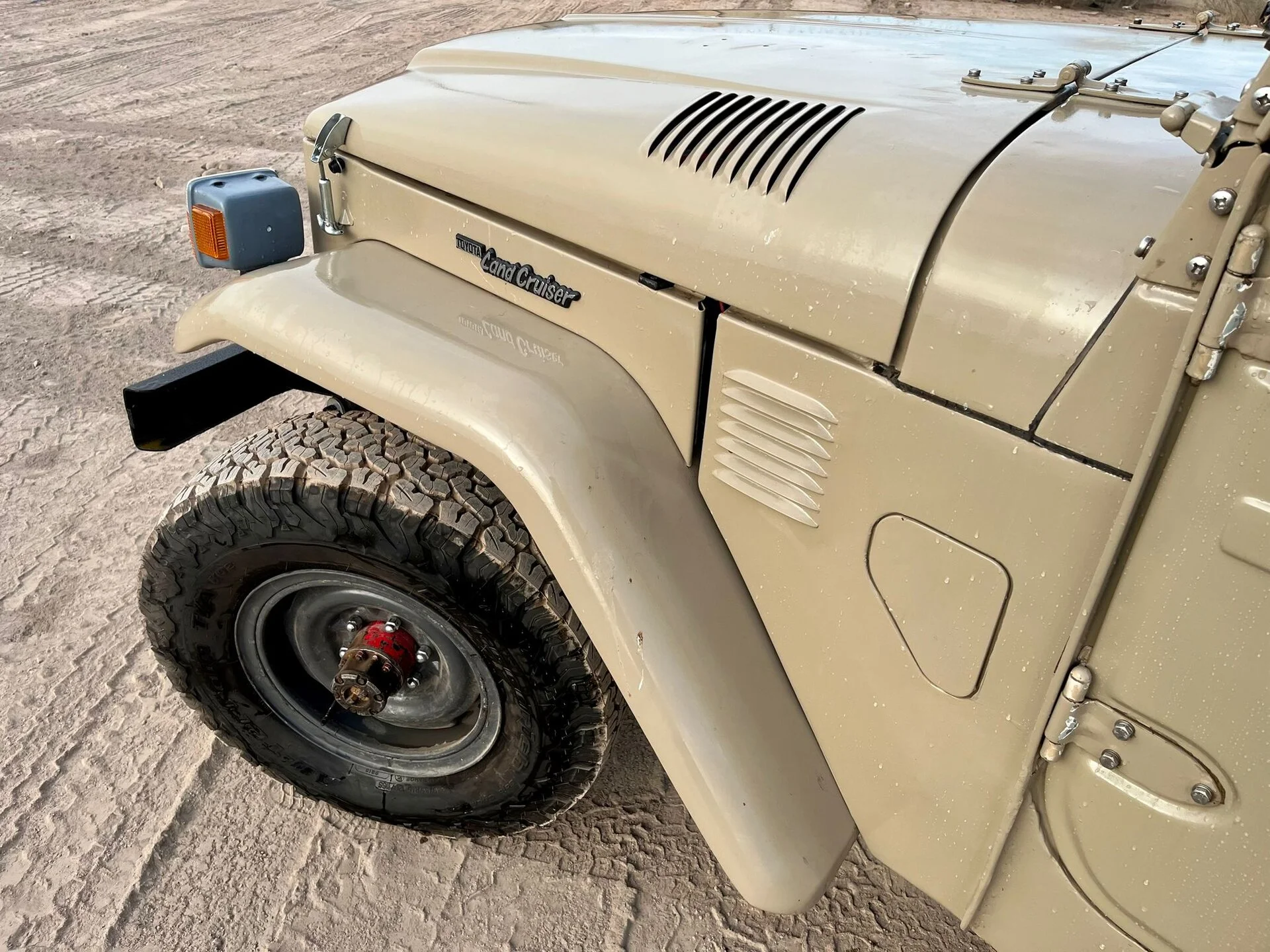

The "Good One" as found, in the middle of nowhere.

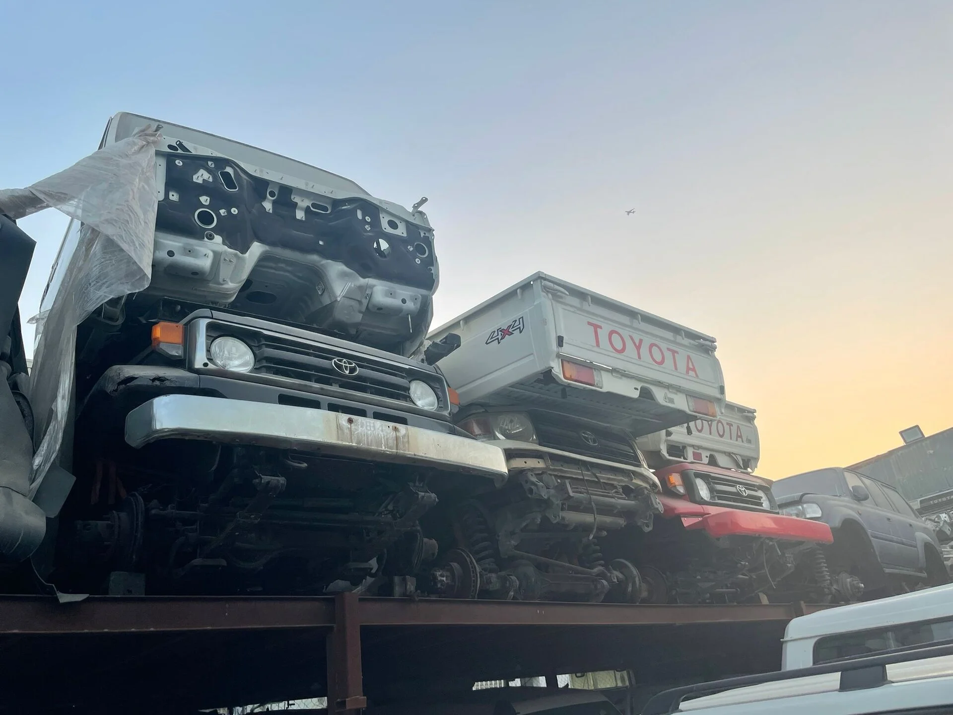

Then off to another place...

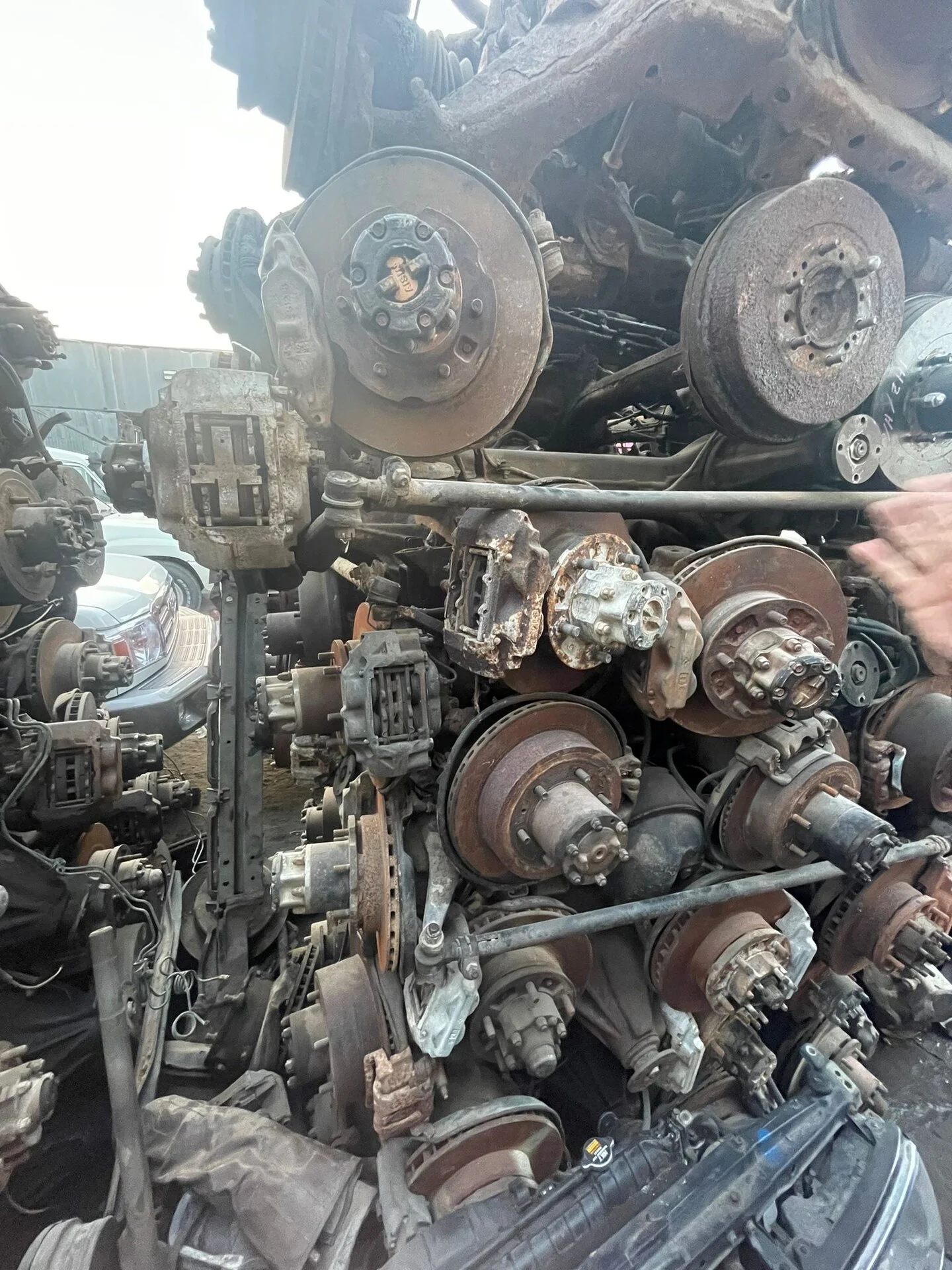

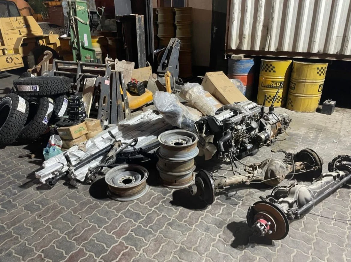

Yes, please this Japanese firetruck with 8000km on the ODO, i'll take the front axle
and a pair of locking hubs, Aisin please.
Endded the 3 days trip with my pile of junk and some stuff from Ironman4x4 and BFGoodrich :) Straight to container and shipped !

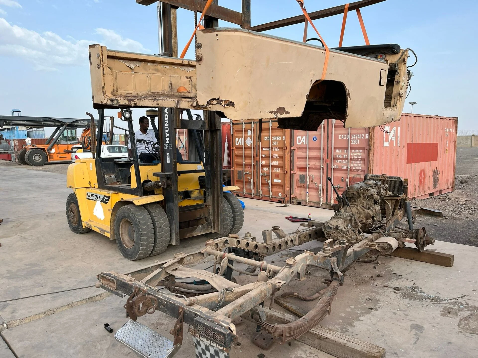

My friend found an all wheel drive Renault Kerax truck with a pretty decent auxilary crane. Loading was tough but we succed. 4 hours of Truckoffroading later, the Troopy was about to get offloaded to the shop of my friend.

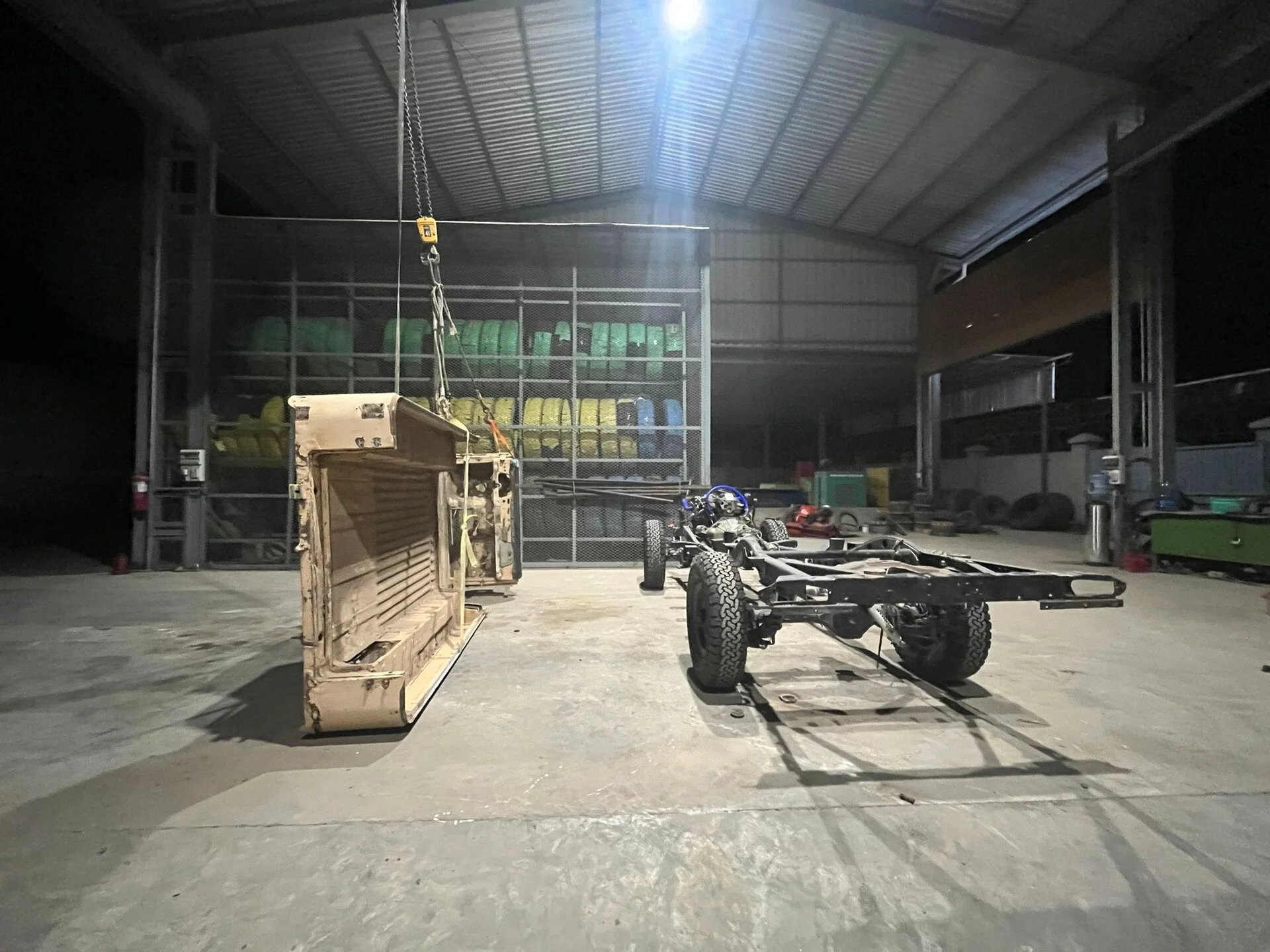

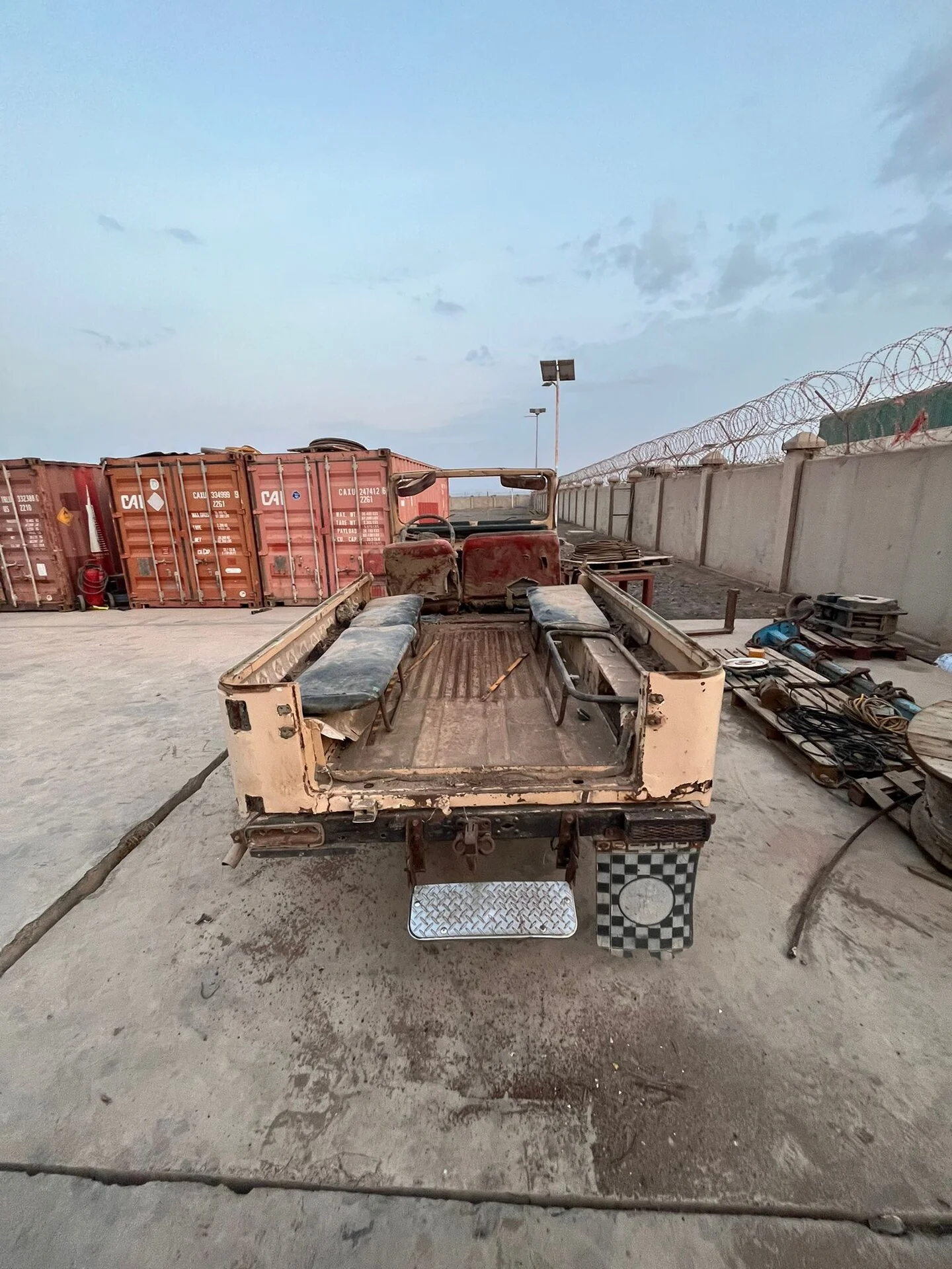

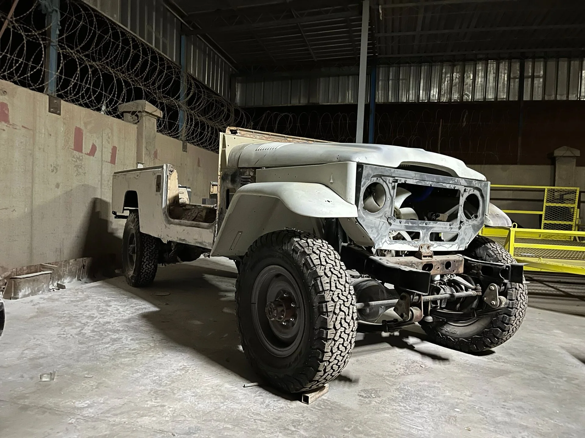

And then, we start the dismantling of it
More and more.
The idiom was "we will dismantle until we find something great to start with........"
This frame was then bristle blasted. and we started to repaire/reweld the 5 cracks found on it.
I've decided to mig weld some fish plates around the engine block supports and reweld leafsprings eyelets. Without welding the two C shapes of the frame in order to keep the flexibility of this riveted assembly.
DISCLAIMER: i know there is some better ways to achieve some better things. Decisions are made on the basis of Available tools, technologies and spares.

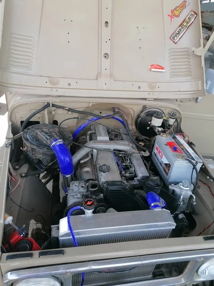

In the meantime, engine was getting a new reinforced clutch straight trom Austalia, Xtreme Outback branded
Engine, tranny, axles, leaf packs, shocks were installed, test fitted, with the body on and of 10.000 times.

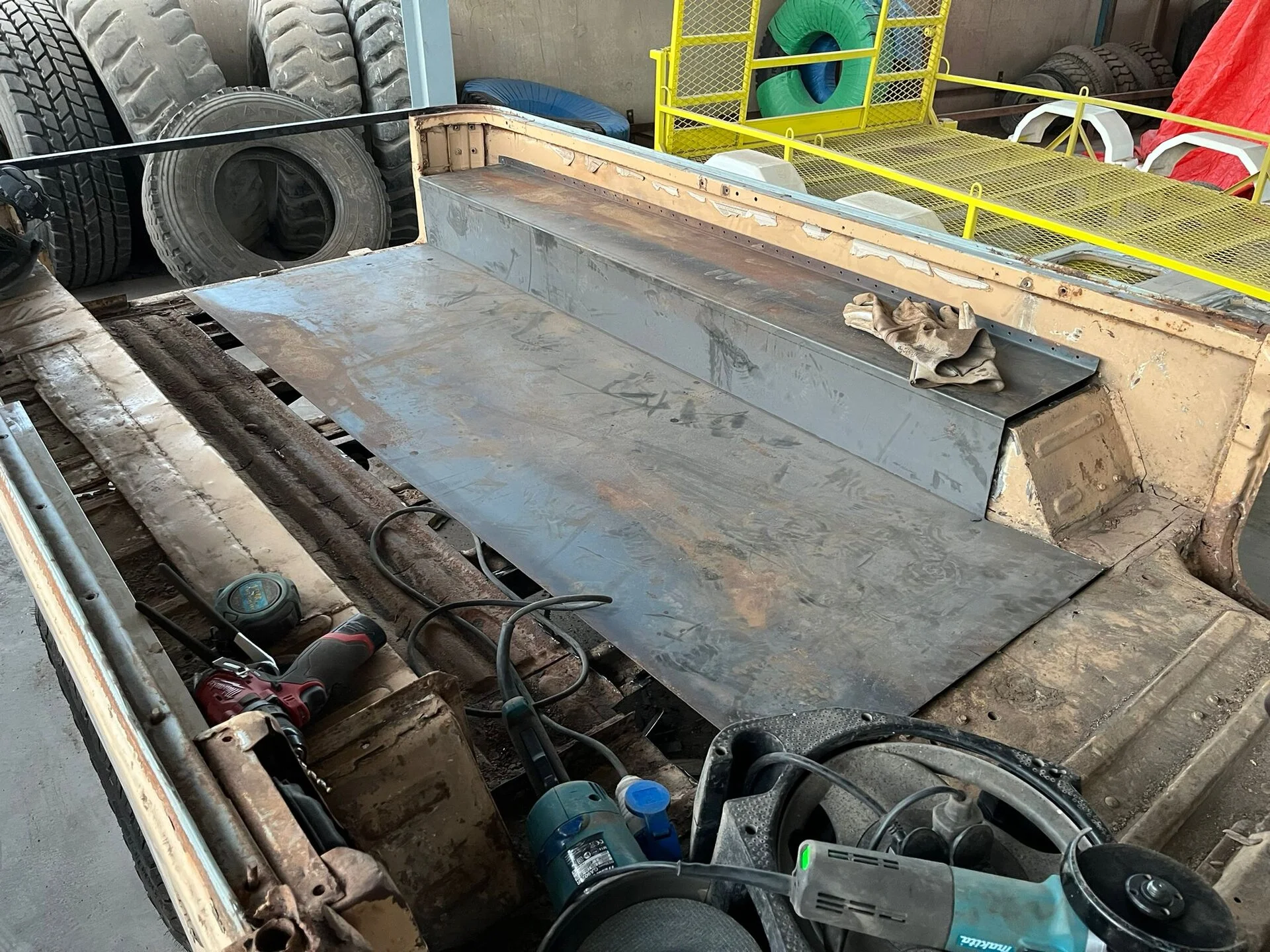

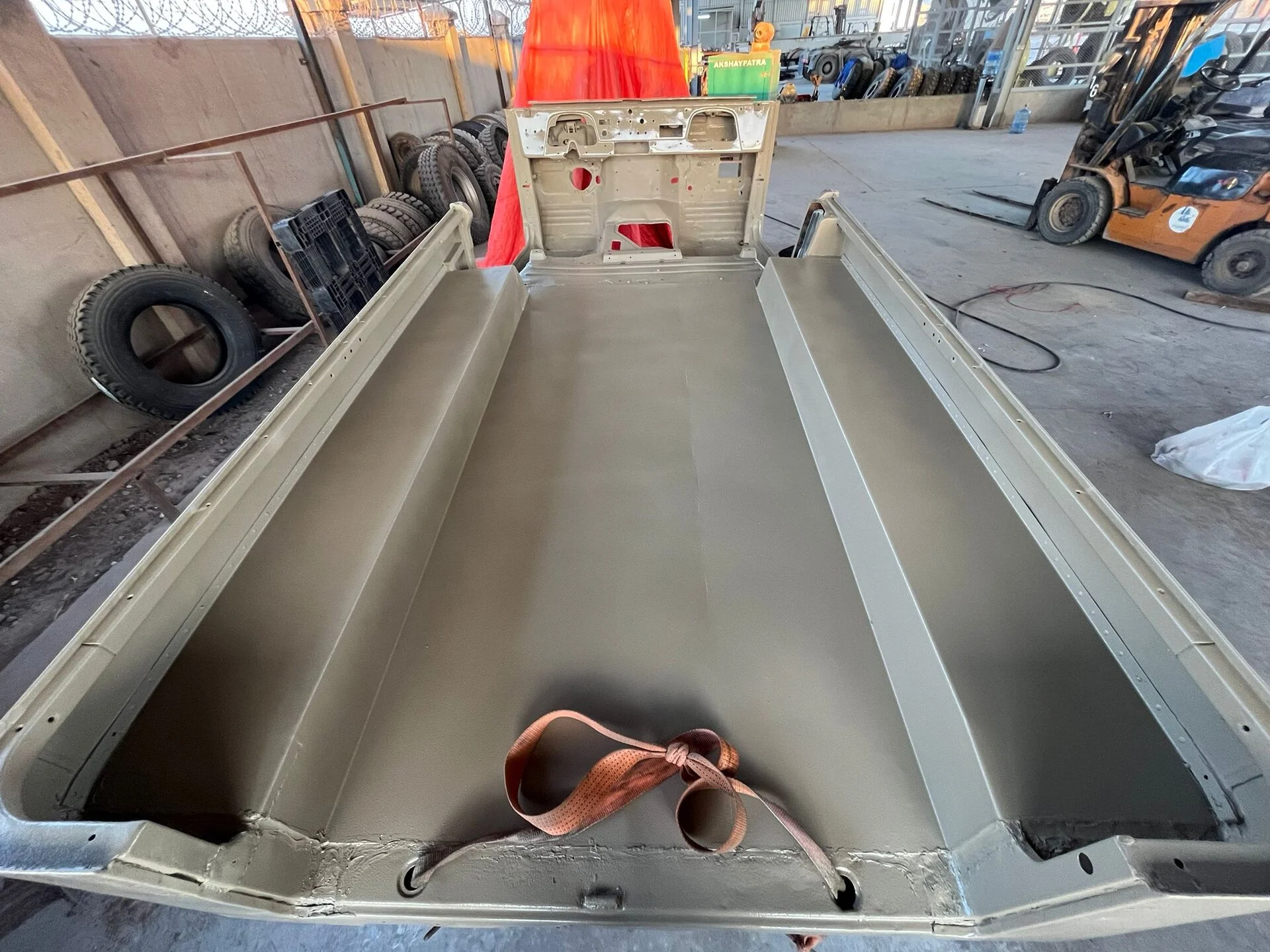

After turning, returning, on and off the chassis, it was time to get on the body. Part that i love and hate at the same time... bodywork.
The floor of the rear tub was toasted and already repaired multiple times by stick weld ans some brazing....
I've decided to get rid of it. New sheetmetal. 2.0mm thinck (yes, thats really thick but was the only available).
Some surprises.... cut, weld, grind, antirust, bondo, sanding and off to the next one.

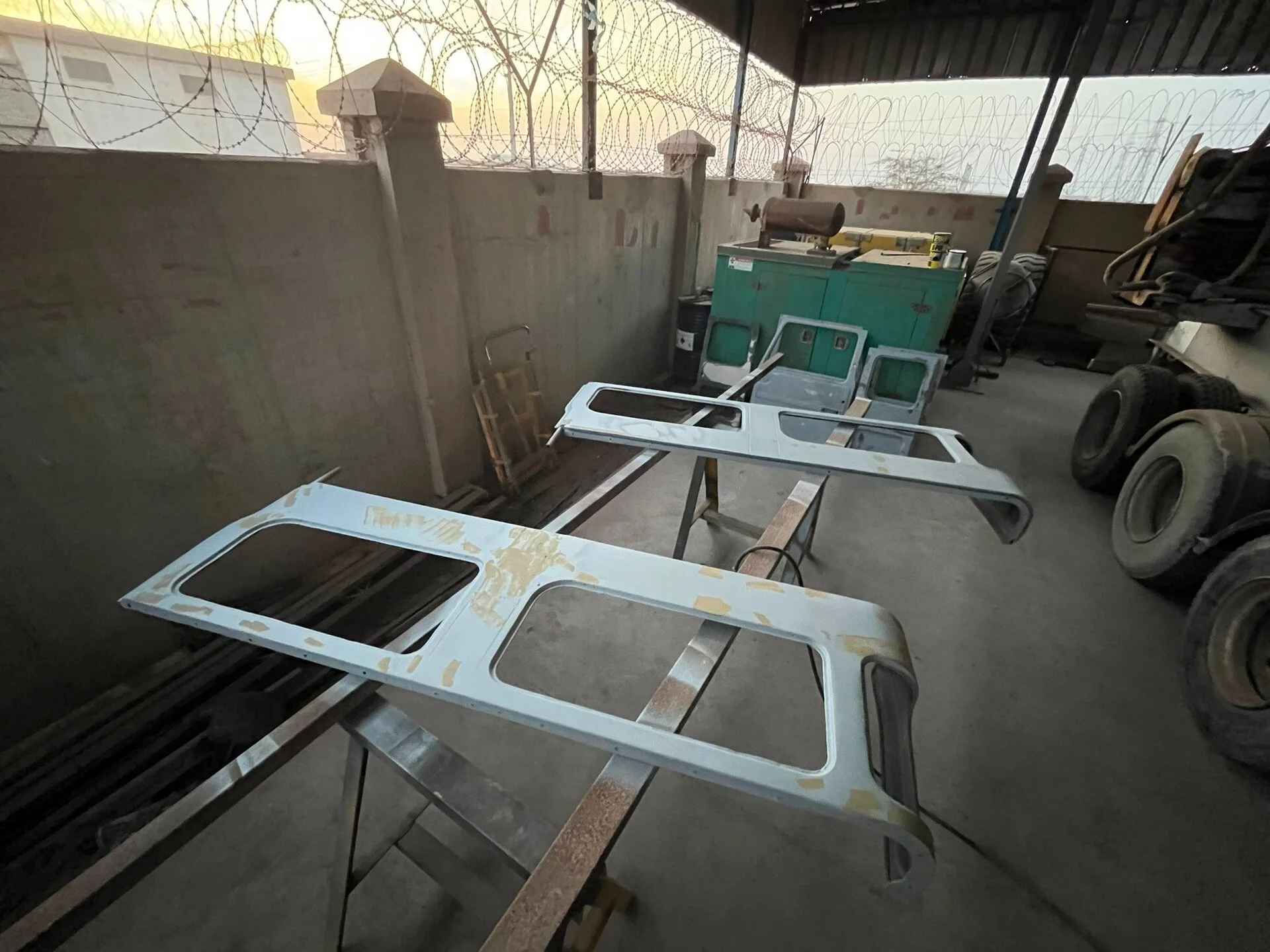

all original panels were bristle blasted in order to break and remove rust while leaving and good grip.

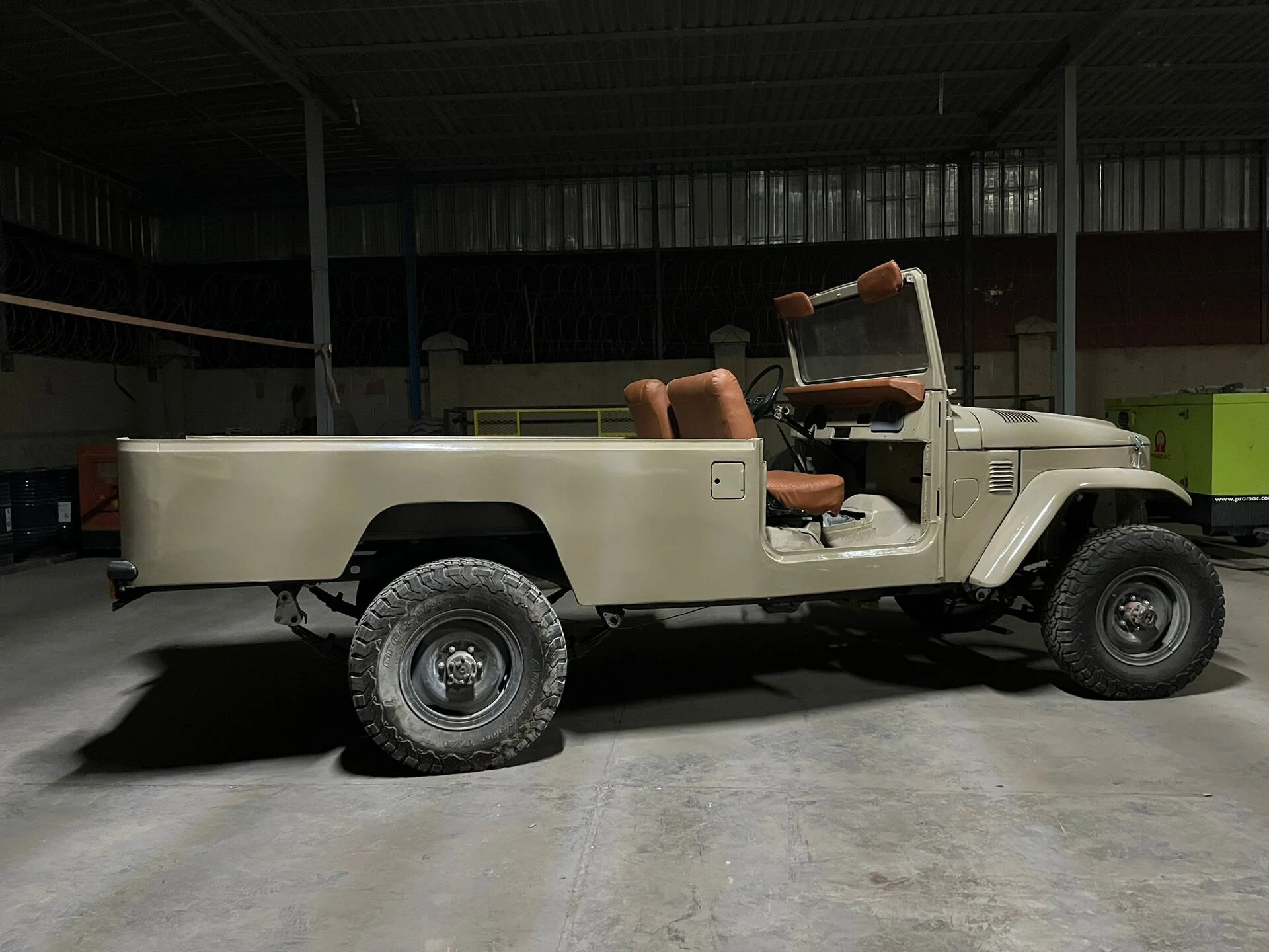

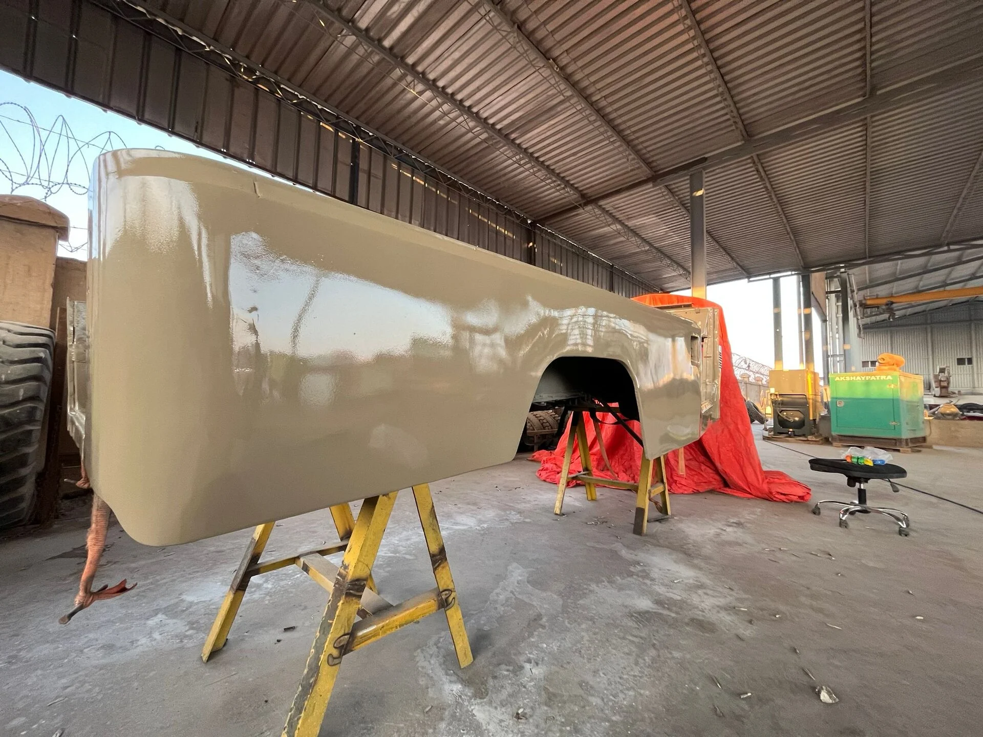

Then, the paint ! After 2 years without painting anything, am almost proud of what i've done here, without booth, in a hot weather.
stick welded plates are ok-ish, sort of a souvenir from its past ownersssss
All insides were done in tinted Raptor lining, all Ext in standard paint, Toyota 4V6.

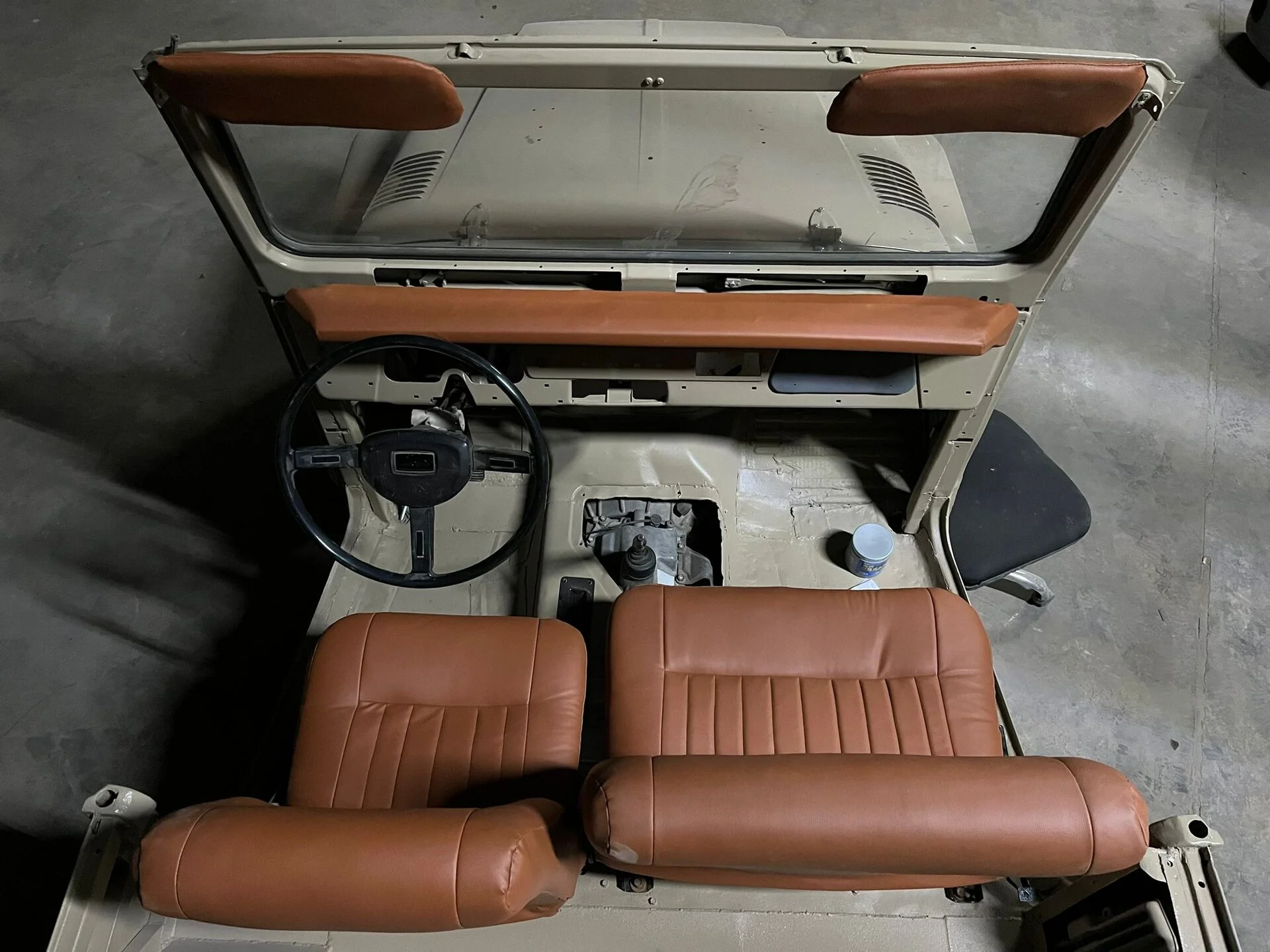

Then, seats were handed to a local guy to redo them. The tub was back (again) on frame and everything is coming back together !

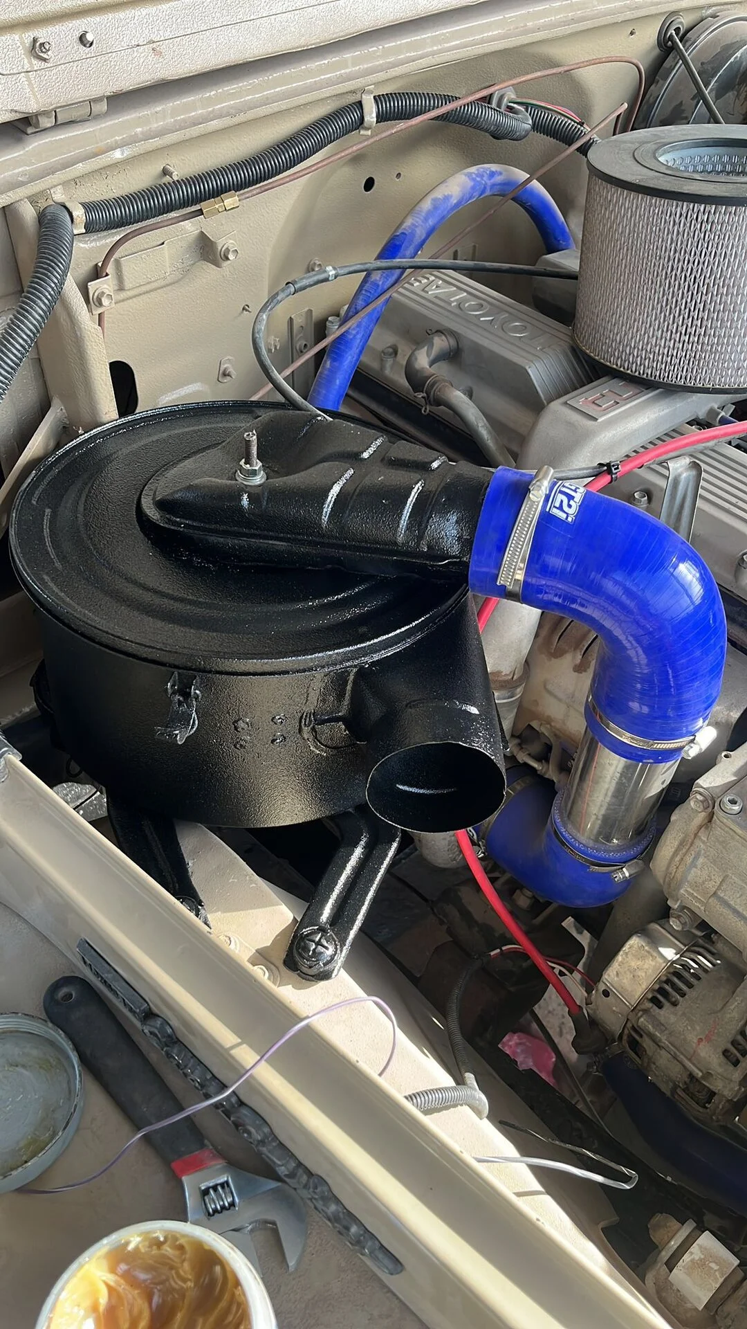

this air box was needing a fresh coat...

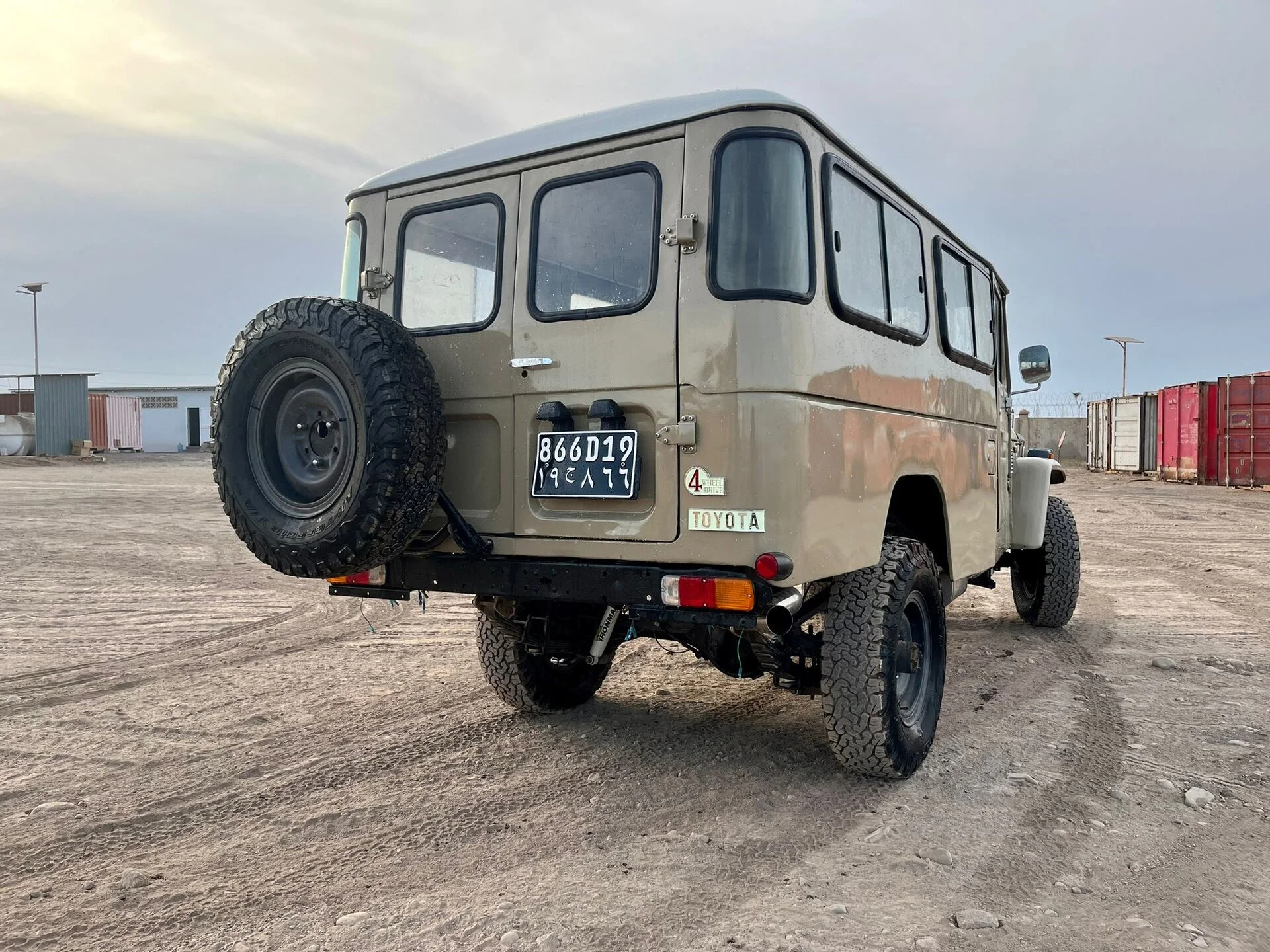

Here marks the end of the "friend's shop" time; some photos before getting to the house after registration, insurance and tax payement.

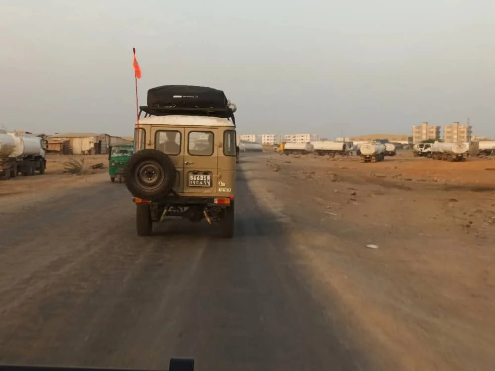

roof rack and tent installed, on the road going home to finish little things ! :) :) :)
