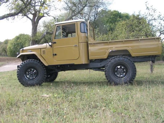

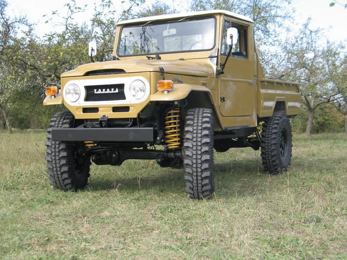

and one thing to note on that picture of the Fj45 with the FZJ79 bed. it has a significant body lift on it. I would imagine approx 1-2 inches. To get the FZJ79 bed to line up as they are in the picture and to fit a rear aux tank some minor modifications are needed. I"m still not exactly there yet but hope to have bed modified and mounted by the end of January.
I'm not even sure that the frame in that picture is off a FJ45. No springs, don't see the plating the FJ45 frame has at the back of the cab on the frame. It also appears the arch in the frame above the rear axle is at the level of the floor in the bed. Doesn't look like it could rest any lower on the frame than it does now. It's Proffitts selling later pickup bodies?
The truck at the top is a 45 cab + 70 bed on an 80 frame. A true hybrid project.

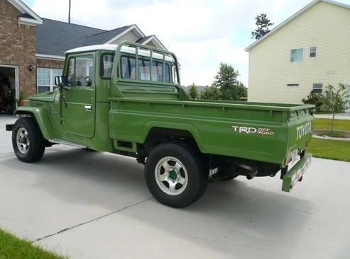

Yeah it's not an FJ45 with a 75 bed as requested but it's all I could find. I see them all the time down here, so it can be done. Just custom mounts: 45 on one end, 75 on the other.
