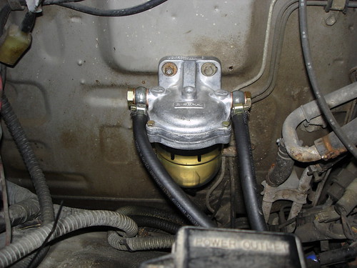

While taking a pictue of my add a leafs for another thread I noticed this electrical connector. On the right hand side of the vehicle, behind the transfer case. Followed the wire up under the drivers seat (RHD). Any ideas?

Creetings from Finland!! This is my first message:cool: All HJ60s and 61s here are diesels and factory equipped with water separator. It has his own warninglight: rightside of the diff lights.
Just couple weeks ago I got airleek trough it. Ofcourse it was raining, middle of nowhere and midnight... Original is VERY expensive. So now I have basic and inexpensive separator bolted firewall in engineroom.

Expat, HJ60 seems right, this could be the water separator wire.
Did the European HJ61's get a water separator? I have not seen one on a JDM HJ61. BJ74's do have them in the engine bay.

Greg, mine has a water separator. It was a Italian 61! With also AC an LSD, power windows and central locking and an electric antena. I'm after the lockers and a PTO, might have found the axles with lockers cables etc for 1200 zoros + shipping from finland to france.

I also have a water factory separator in my HJ-60 VX .. with power windows, spring on seats, power antena, power locks .. and bla bla bla ..
