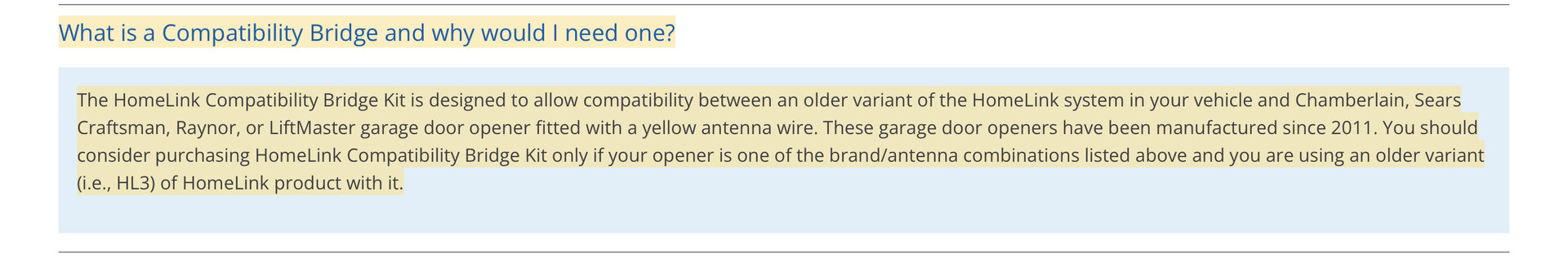

You may need a compatibility bridge for openers made after 2010 or 2011
Oh goodness that's a bit much. So there is no way to get it working without this? I was hoping it was something I was doing...
What model year and brand garage opener are you using? Unfortunately, if it is newer one you may need to use a bridge.

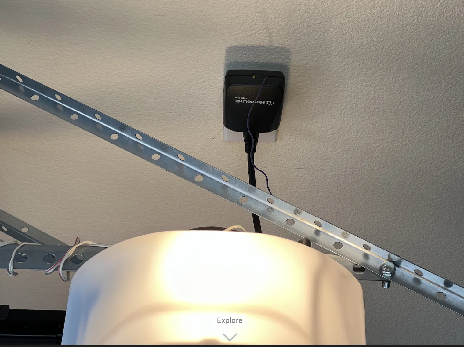

House was built in 2020 so yea, pretty new. Dumb question, is that bridge being installed in the garage or GX?

In the garage. It's pretty easy to setup. I just have mine plugged into the ceiling where the opener plugs in.
