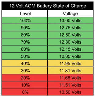

An Optima redtop is an AGM battery. A fully charged AGM battery should read very close to 13 volts when fully charged and at rest.
That said, the OEM alternator will typically charge an AGM battery to 12.7 V and should be putting out 14.4 V when running with no load. If your alternator is putting out less than that, I would put a meter on the output lug of the alternator and get an actual reading. You could have a failing battery or the alternator could be on it's way out or there is a significant load on the system. Either way, I wouldn't rely on the OBD2 monitor when diagnosing.
I have an Odyssey AGM charger that I use for my Interstate AGM batteries, and it will read 100% charge at 12.8, so I live my life very comfortably at 12.7.
I would not be overly happy with 12.4 after a 7 hour drive.
