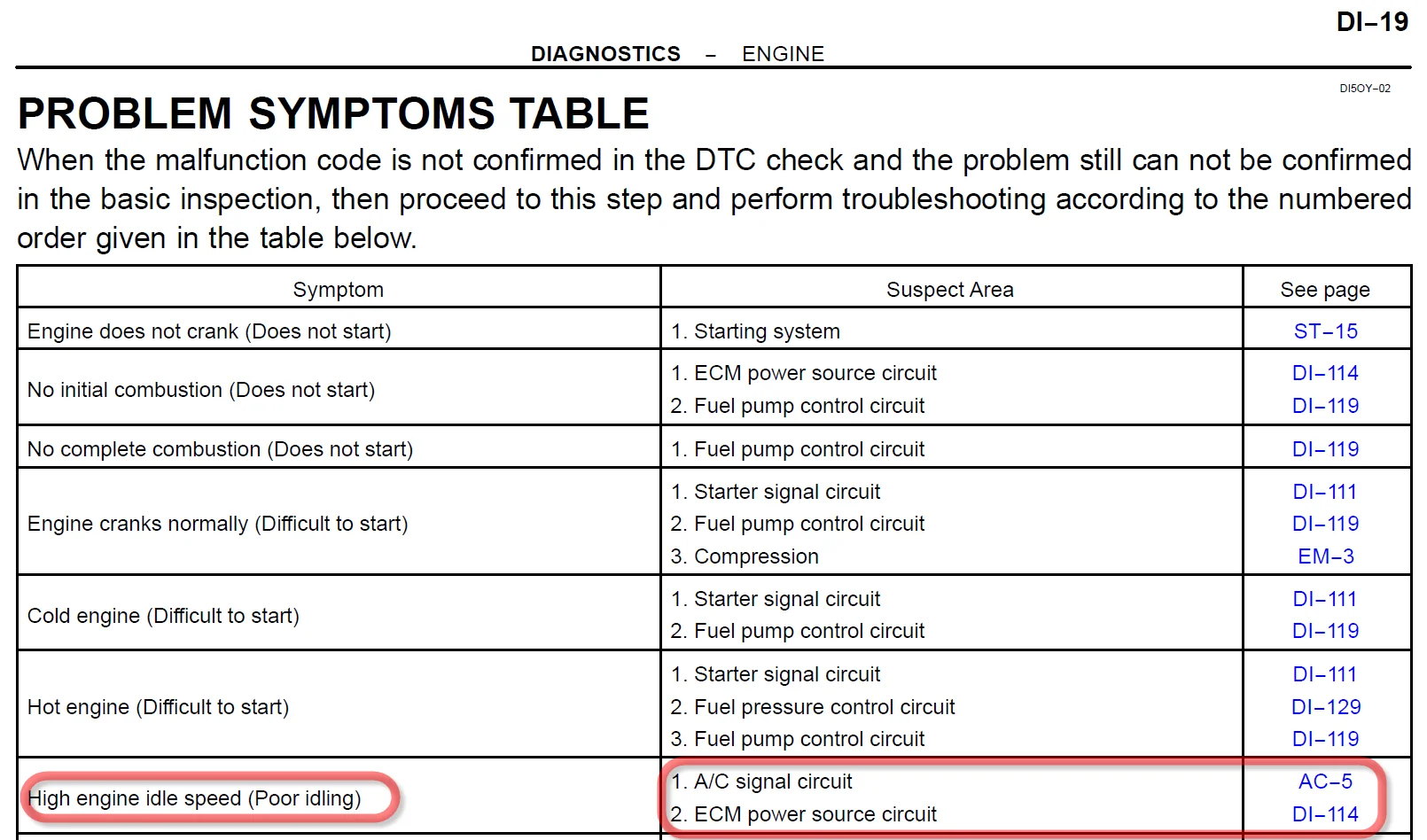

I’ve been dealing with high idle for a few months. It was hanging out @ 2000! So with the help of mud and my FSM I changed some parts related to the idle. You could say I threw some money at it but I’ve seen some changes. The list is long!
Both 2 wire temp sensors, my IACV benched checked but I changed it anyway. Both O2 sensors, EGR valve. I pulled my TB and cleaned it and tried to adjust a new TPS but failed miserably! I even swapped the ECU (ECM) and nothing changed. My wire harness near the EGR valve looks fine. So after all of that my 1FZ-FE with 305K miles runs super smooth. No issues starting or performance. It just the pesky idle hanging @1000 and dropping when warm to @800. I never had a rough Idle. I do need to check my timing. All this trouble shooting brought to the alternator question.
I don’t know the ECM power source circuit?
The ECM power source circuit check in the problem matrix starts on page DI-114 and is a catch all of the connections to the ECM. It's Toyota's way of saying "if you checked all the usual suspects, look in the basement and the attic, because it's got to be in there somewhere". That would be my absolute last resort. You'll need a multimeter, a pair of needle probes to go with it, and a weekend. And beer.
