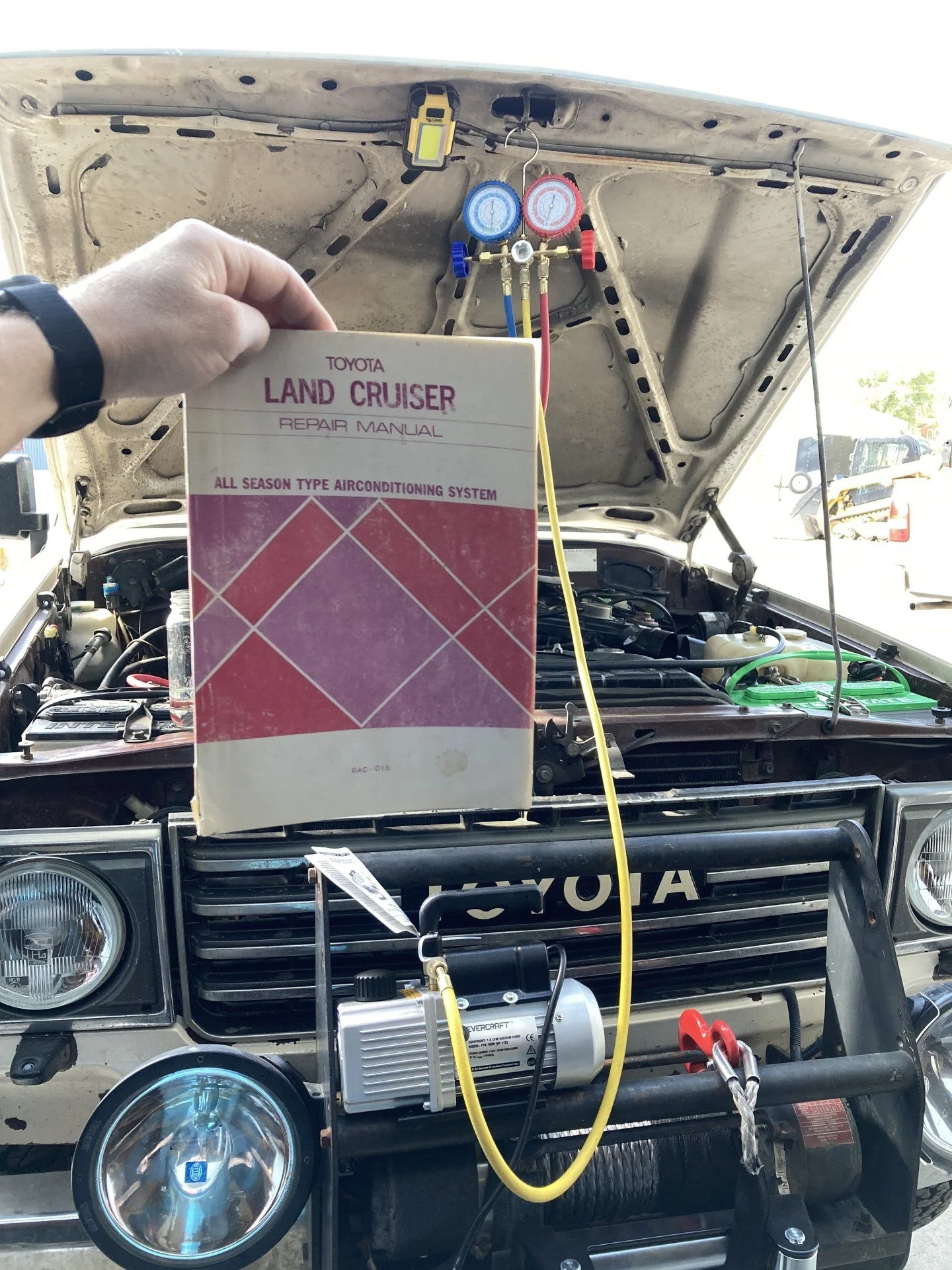

Have a side-tap for cans that works with R12 and R134, and its almost perfect for the ulta dust can. More on that later. Went to a buddys house who has a vacuum pump and drew down to zero. I *know* my system has a slow leak, but didn't want to leave any moisture in there. I live in AZ so moisture is not usually a big problem, but best practices. Vacuum done, hooked up the can tap to the yellow hose and put the can into the tap.

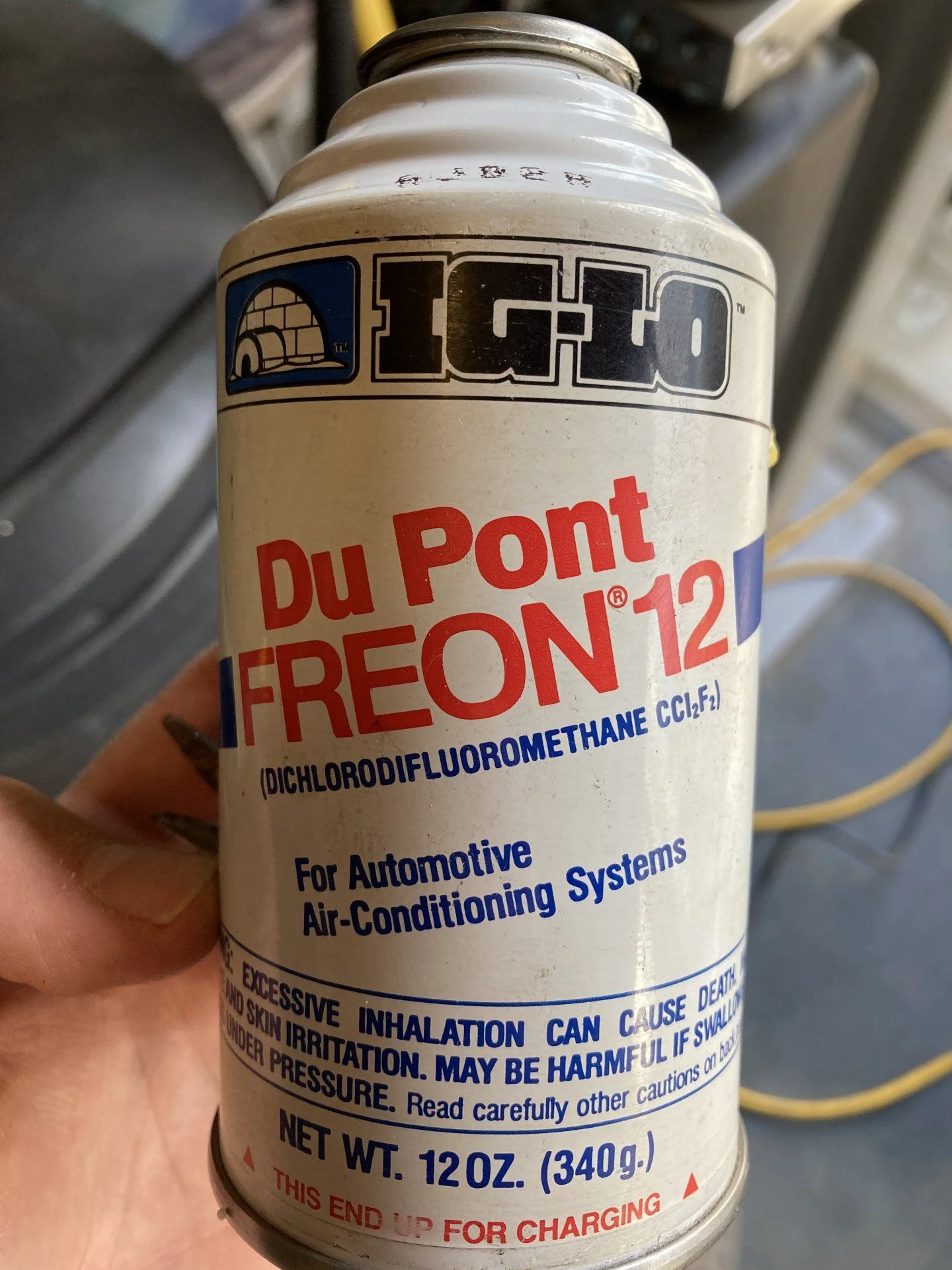

FYI, R12 is still available. Yes it costs more, but it cools so so well Ask me how I know:
