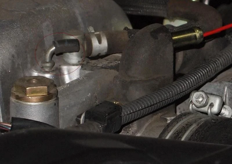

Anyone know what this is for, I notice while cleaning throttle body next to PVC vacuum hose. ?

I'm thinking this "port" goes straight though to intake manifold. Possible for test port or perhaps accessory not on my 2001 LC.
It could be more than just a vacuum tap.
We need a more detailed diagram of intake manifold than I have seen.....................anyone
