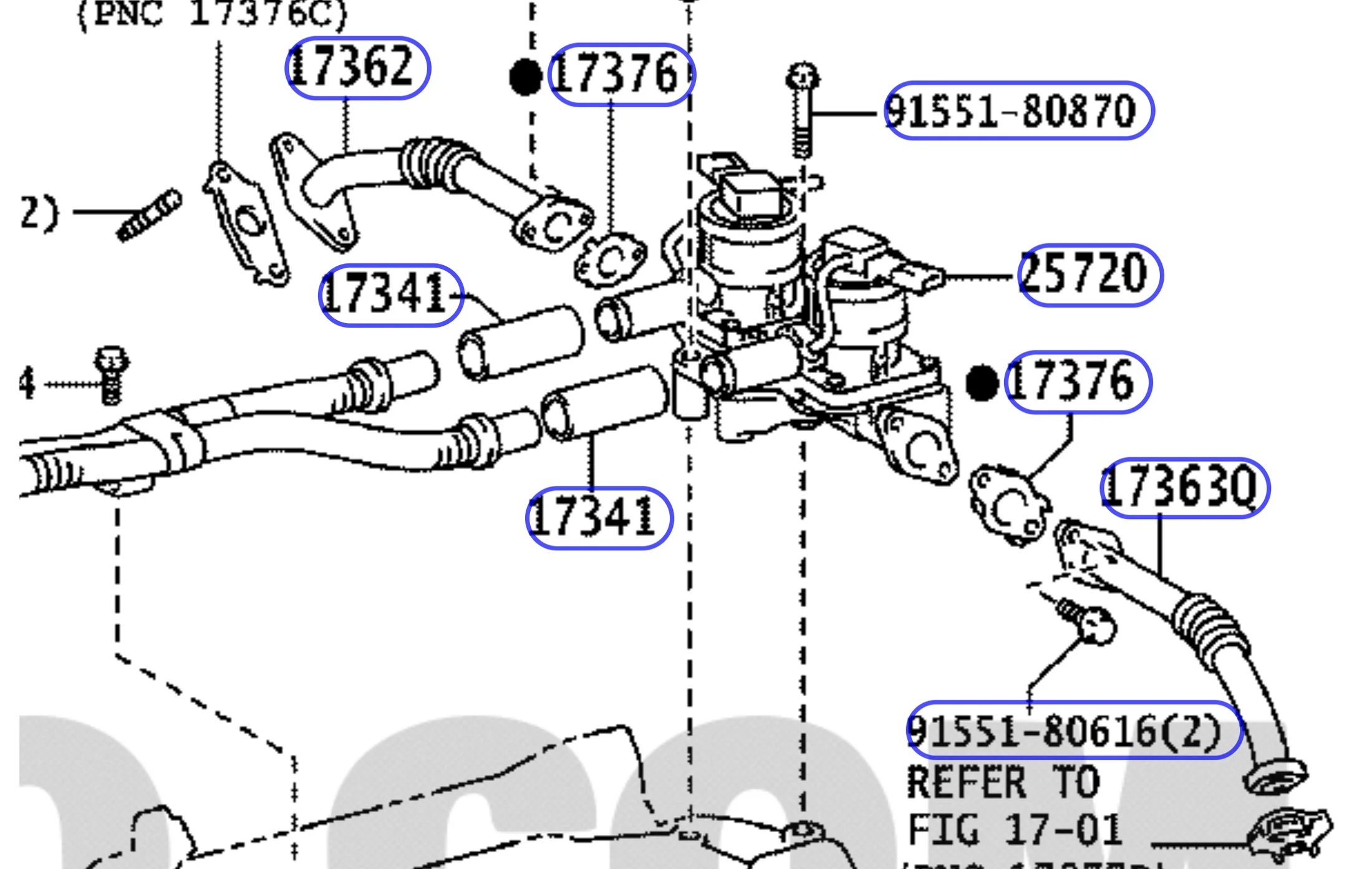

Any concerns about their sensors' longevity? Is it some bespoke part, or they found something, adapted and charge arm and leg now?
I am asking because that sensor's shape is exactly like manifold pressure sensor on 4th gen turbo Subaru Legacy. I think it is a cheap part in the aftermarket, like $30. Of course we would need to know the electrical specs to be sure.
I removed my SAIS while replacing my intake manifold. I did similar to above, but I ended up leaving the valves in. Couldn't justify spending 400-500 for new sensors from Hewitt. I removed the pipes that go towards the pumps and removed the pumps as well. I disconnected the hard lines that go towards the exhaust manifold and then cut everything down to the part that bolts to the exhaust manifold out. I left that part installed so that i could have something to bolt the blockoff plates to.
Hewitt acknowledges the cheap aftermarket options but says they have tons of problems with them and that is why they only use Toyota (or expensive) sensors. Not sure from what vehicle. If that could be figured out, possibly they could be procured cheaper than what Hewitt sells them for. I'm pretty sure you can buy OEM valves with the sensors built in for the same price or slightly cheaper than what Hewitt sells two sensors for.

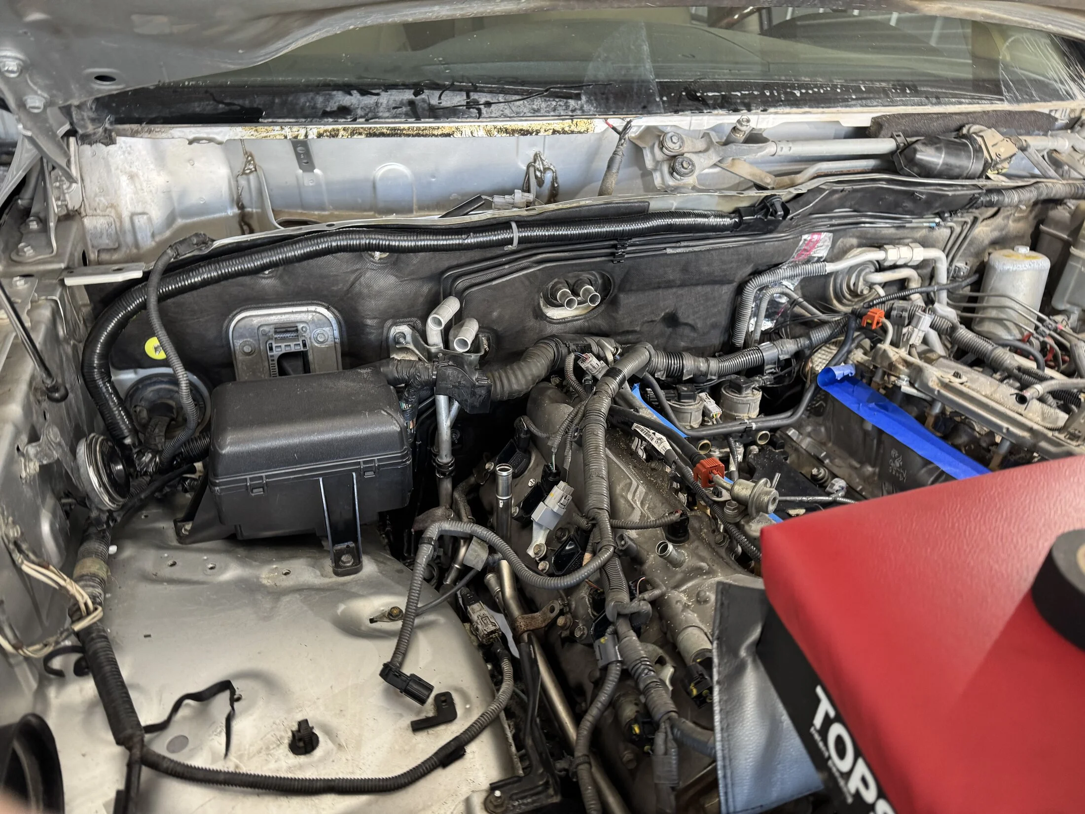

I will say, it’s really not a big deal leaving the valves in with all the plumbing removed. I was just hoping to not have the extra wiring. Here’s a shot of mine with everything removed.
