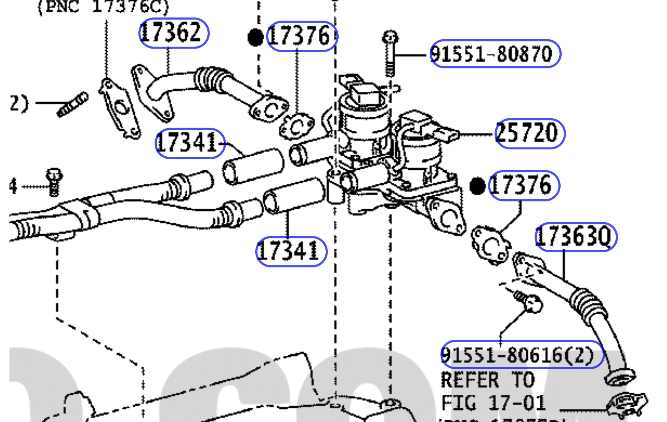

So you eliminated these pipes completely and plugged the openings at the exhaust manifold vs. using the block off plates Hewitt sells and the end of the tubes?
I read the bolts at the exhaust manifold can snap on rust belt trucks and then you are in world of hurt.
Sorry for the late reply. Yeah 17362 and 17363Q have flanges at the end of the tube going to the exhaust. I chopped the tube off the end and had the hole in the flange plugged and then ground down flush. Super unnecessary but I just didn’t want those tubes just hanging out down there for no reason.
