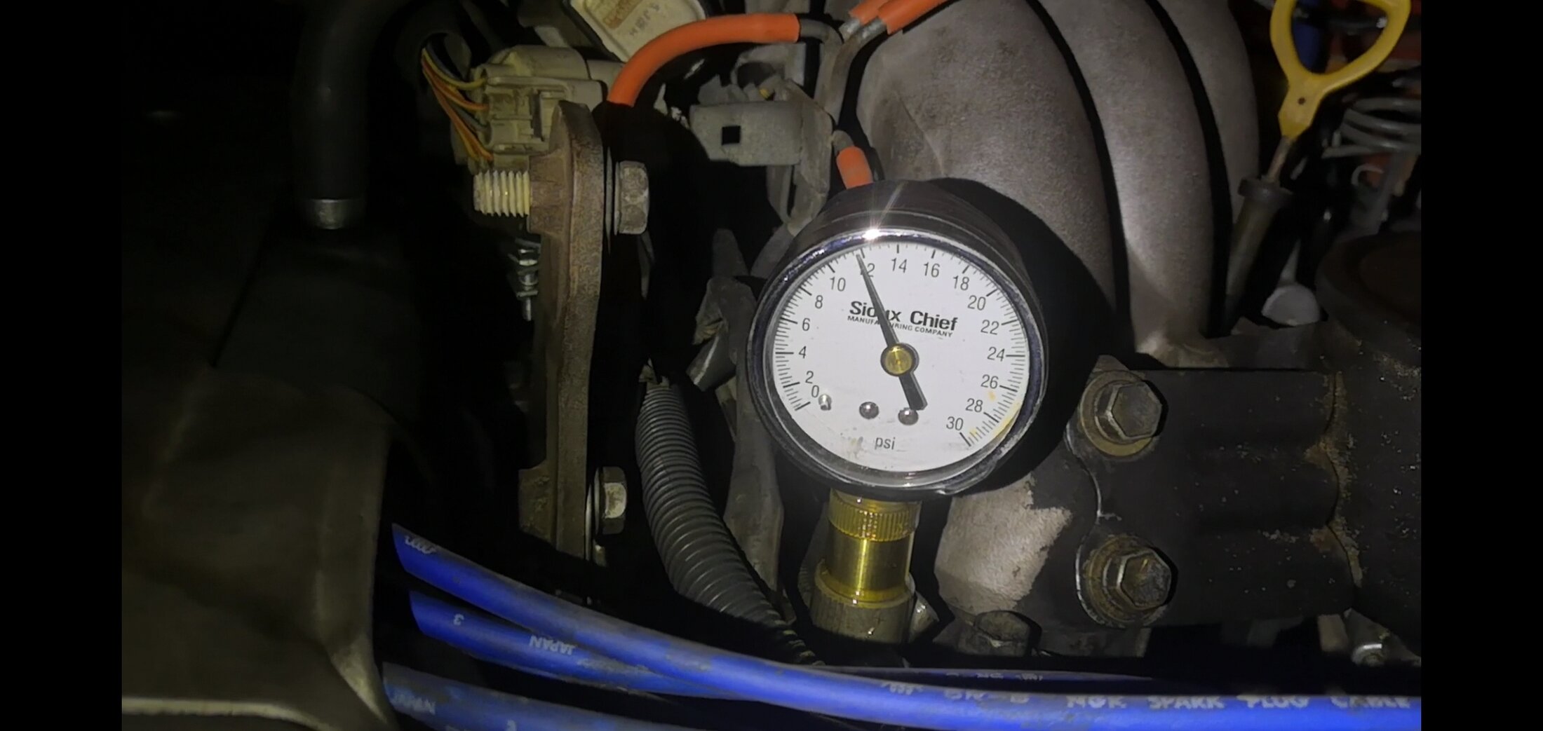

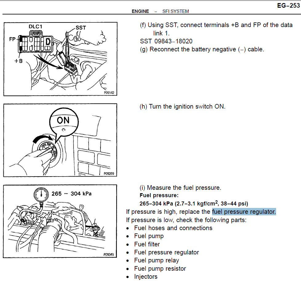

I'll be taking off the FPR now and measure the pressure in the rail - if it's too low, it's the pump, if it's too high, it's the FPR?
12 psi - way too low! I'm surprised it runs at all with this?
In addition, I also tried to done some quick testing of the FPR with compressed air. I tried up to 70psi, and nothing came out. Does it need liquid to operate / open?
FPR should release air around 40-50 psi, replace both the FPR and fuel pump, check all fuel lines solid and soft while you're at it.
I'd test the fuel pressure regulator before I bought a new one.

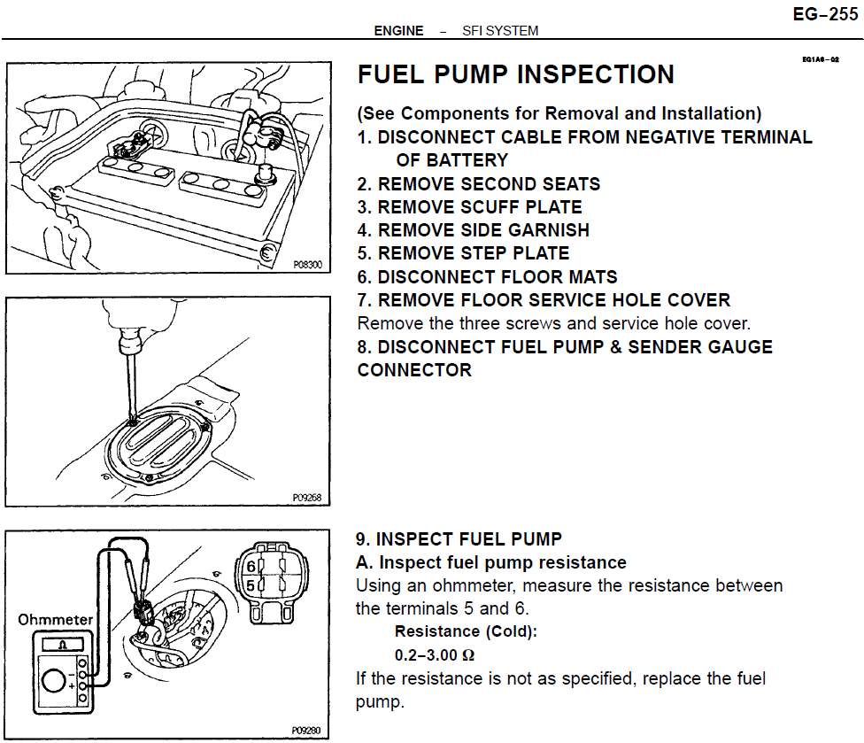

Also check power to the fuel pump, make sure it gets good voltage and wiring is OK.

I'm reading through this quickly but it seems like you may be skipping some troubleshooting steps and being quick with the parts cannon. Of course, more is happening on your end than is in this thread and I didn't read every word so I may be wrong in that assessment.
Have you worked through the pages that @Malleus shared above? Did you confirm that the primary fuel filter is not the issue? Have you confirmed sufficient voltage at the pump during all operating modes?
You did mention that the fuel pump looks new so replacing it seems like it may be premature if you haven't ruled out low voltage or a clogged primary filter.
If fuel pressure is low it seems less likely to be the regulator and more likely to be an issue on the supply side.
Keep in mind that resistance increases in electrical circuits as heat of the components/wiring rises. How this may be impacting your 80 could vary and it may or may not be relevant to your low-power scenario but it also could explain why your performance issues are temp related. etc.
