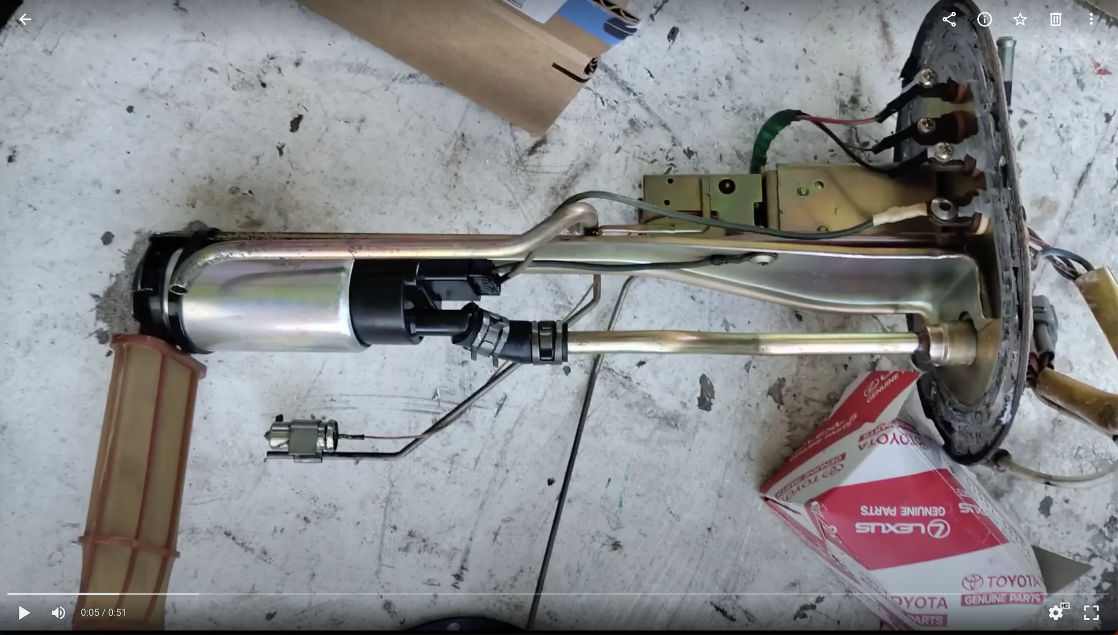

So here is what I found:
:facepalm: That's literally how I pulled it out of the tank! Unbelievable it ran at all and produced a somewhat consistent pressure. I drove it for 700 miles like this...
The pump otherwise looked fine. It is the same model that I had ordered as well - Delphi FE0402. I decided to replace the pump with the new one regardless, and keep the old one as a spare. I also replaced the rubber hose, the hose clamps, as well as replaced the zip tie that mounted the old pump to the bracket with a clamp. No idea how that is supposed to be done? But the clamp looked like a solid solution.

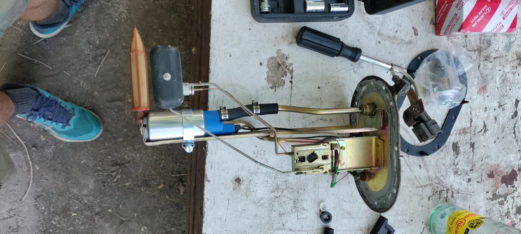

This is how it looked like when I put it back together:

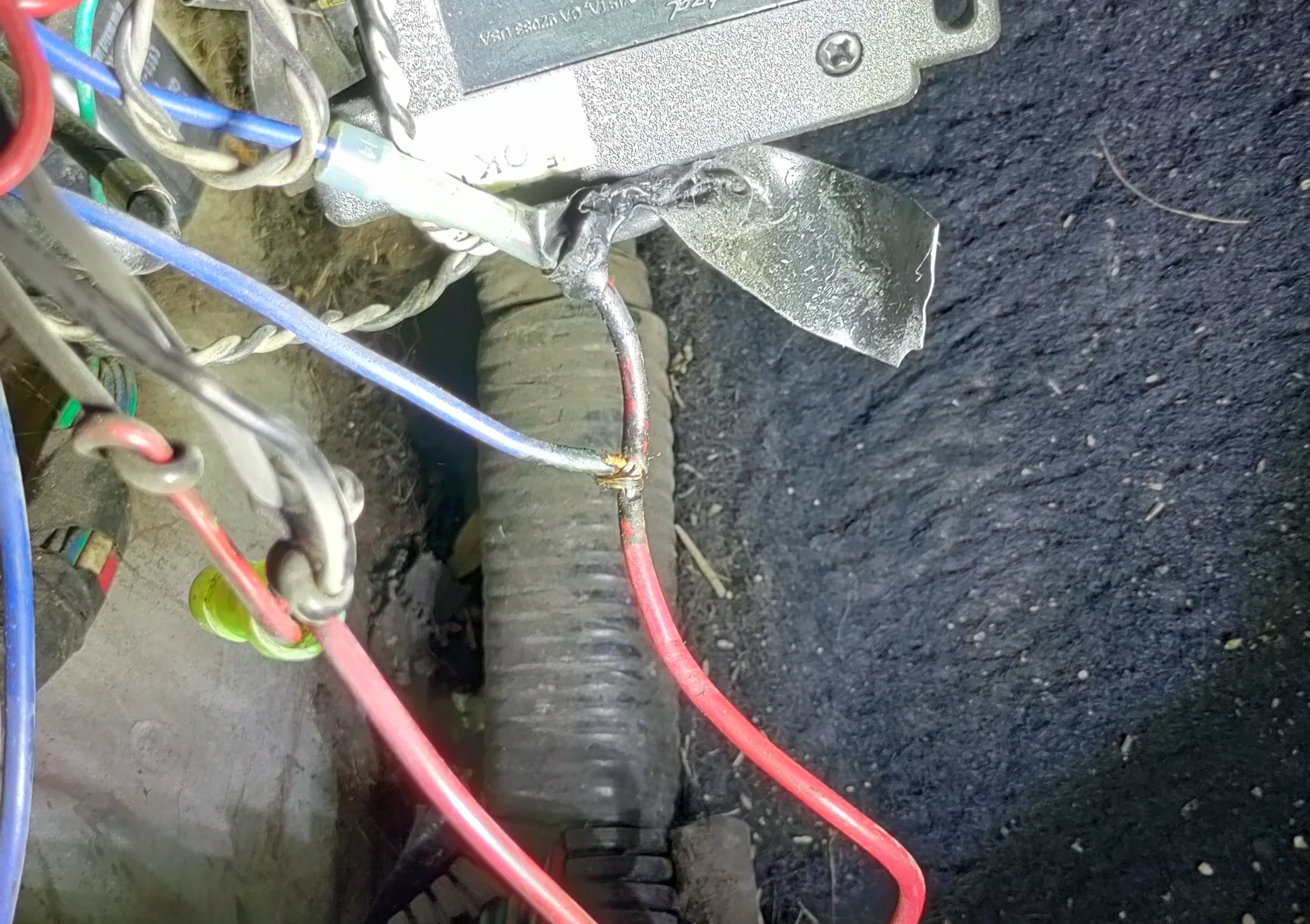

The positive power to the fuel pump ran through this professionally prepared wiring junction.

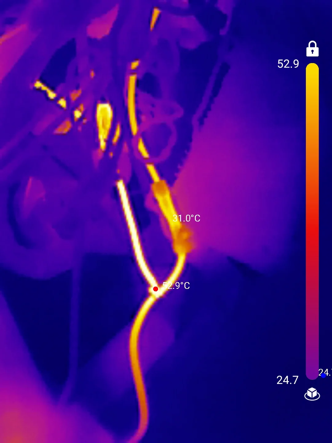

This professionally prepared wiring showed a very low resistance, as can be seen by the low losses and corresponding low temperature in the IR camera image.

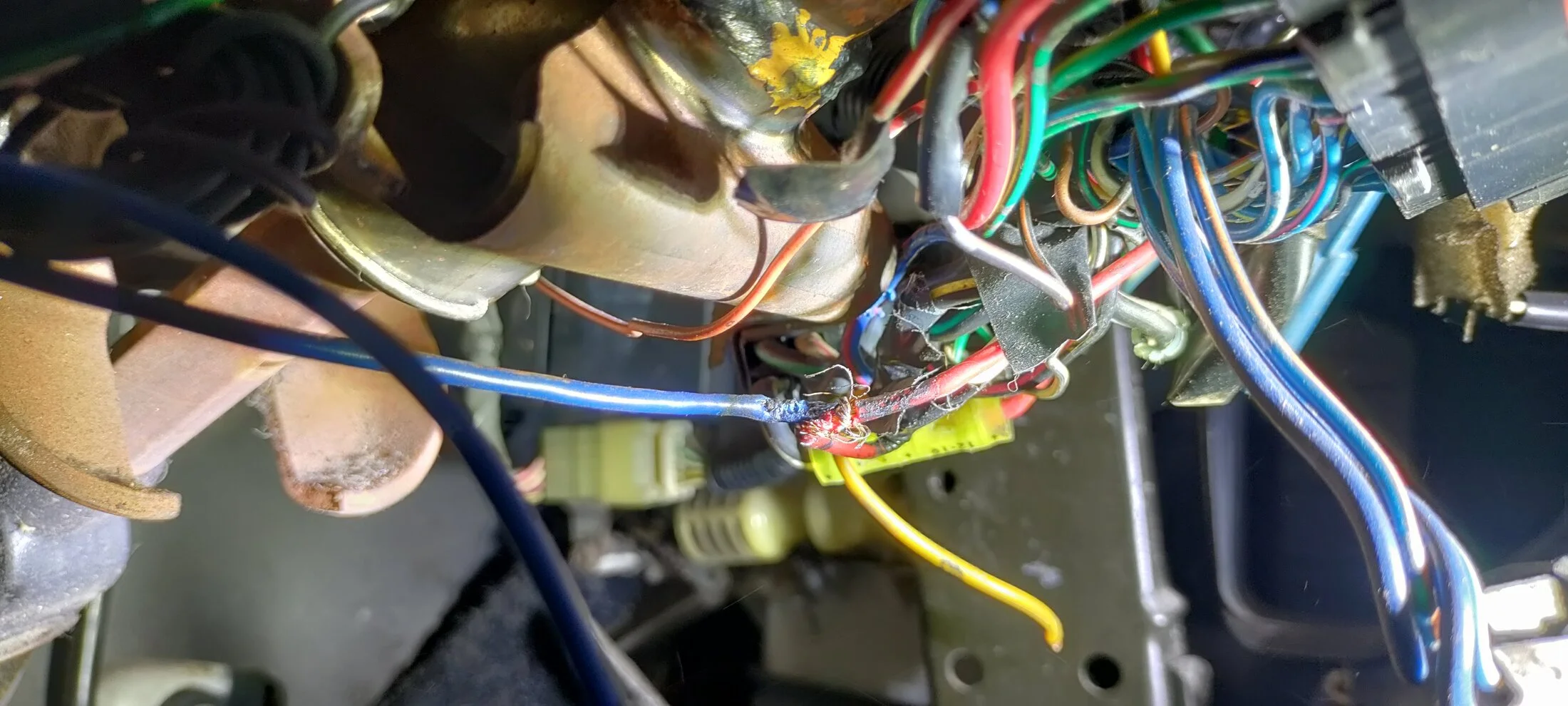

Sarcasm off. I have no idea who prepared this - someone wired in something in there at some point. I found four of such horribly prepared connections in the the wire to the fuel pump. Another one below.
This didn't cause any issues yet. I incidentally stumbled upon this while trying to fix the center diff lock system. I was trying to get to the center diff lock relay - more on that in another thread. While trying to get to the relay I touched some of these wires and I had the ignition on so I could actually hear the fuel pump slow down, and I also felt how these wires were hot.
I am out of words. I've never seen anything like this done so poorly. I don't fully understand what they tried to wire in there. It looked like there had been a theft protection system installed before. I assume part of this mess was because that system failed and someone tried to get the car going again. There was something more, other things that at some point were wired in that were now just dead end cables.
I was shocked. I hope I'm not going to find any more things like this in the car...
