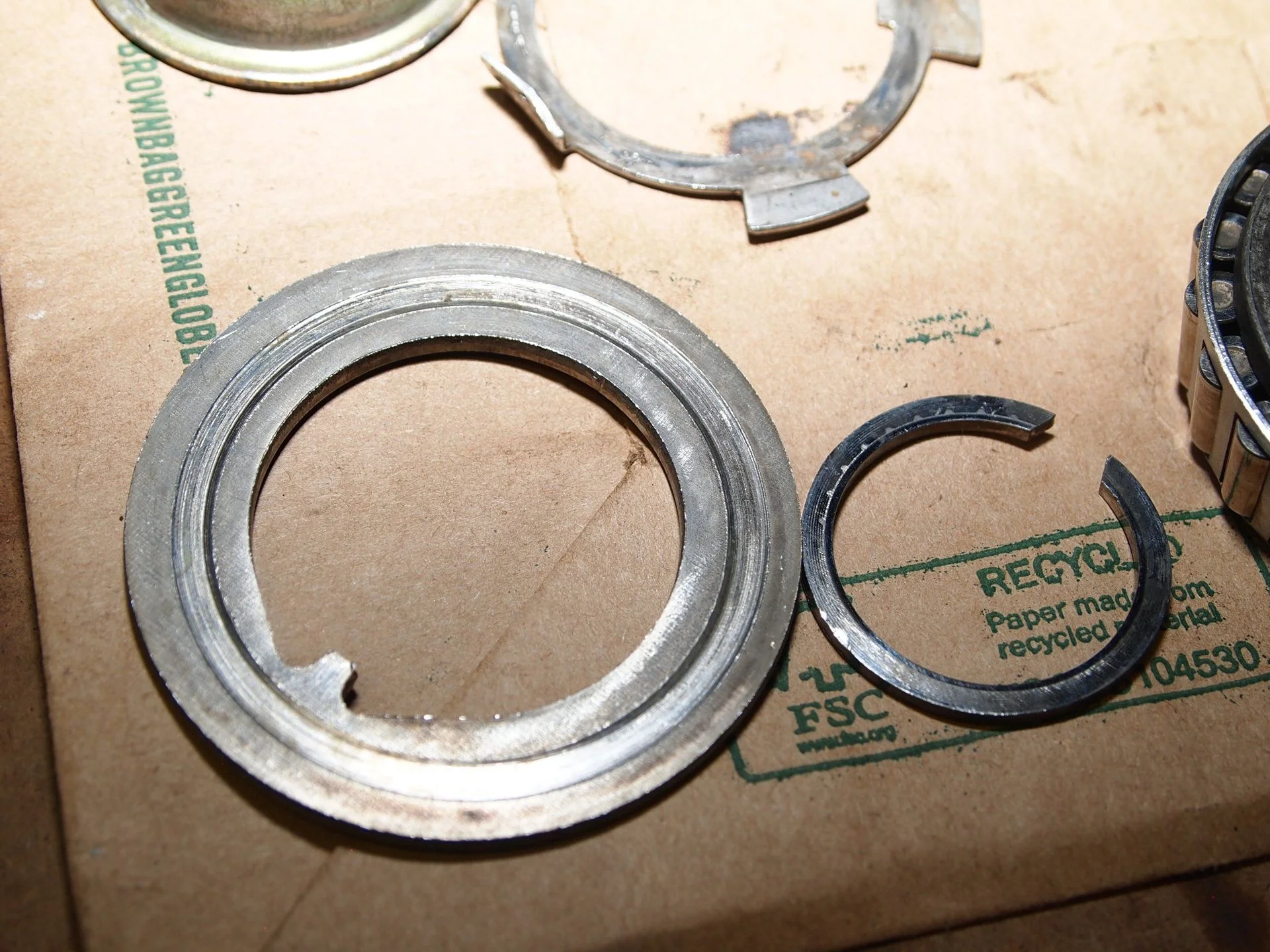

Scored claw washer from loose wheel bearings:

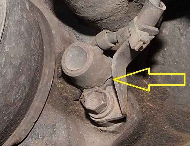

Wheel speed sensors reads wheel speed here.
