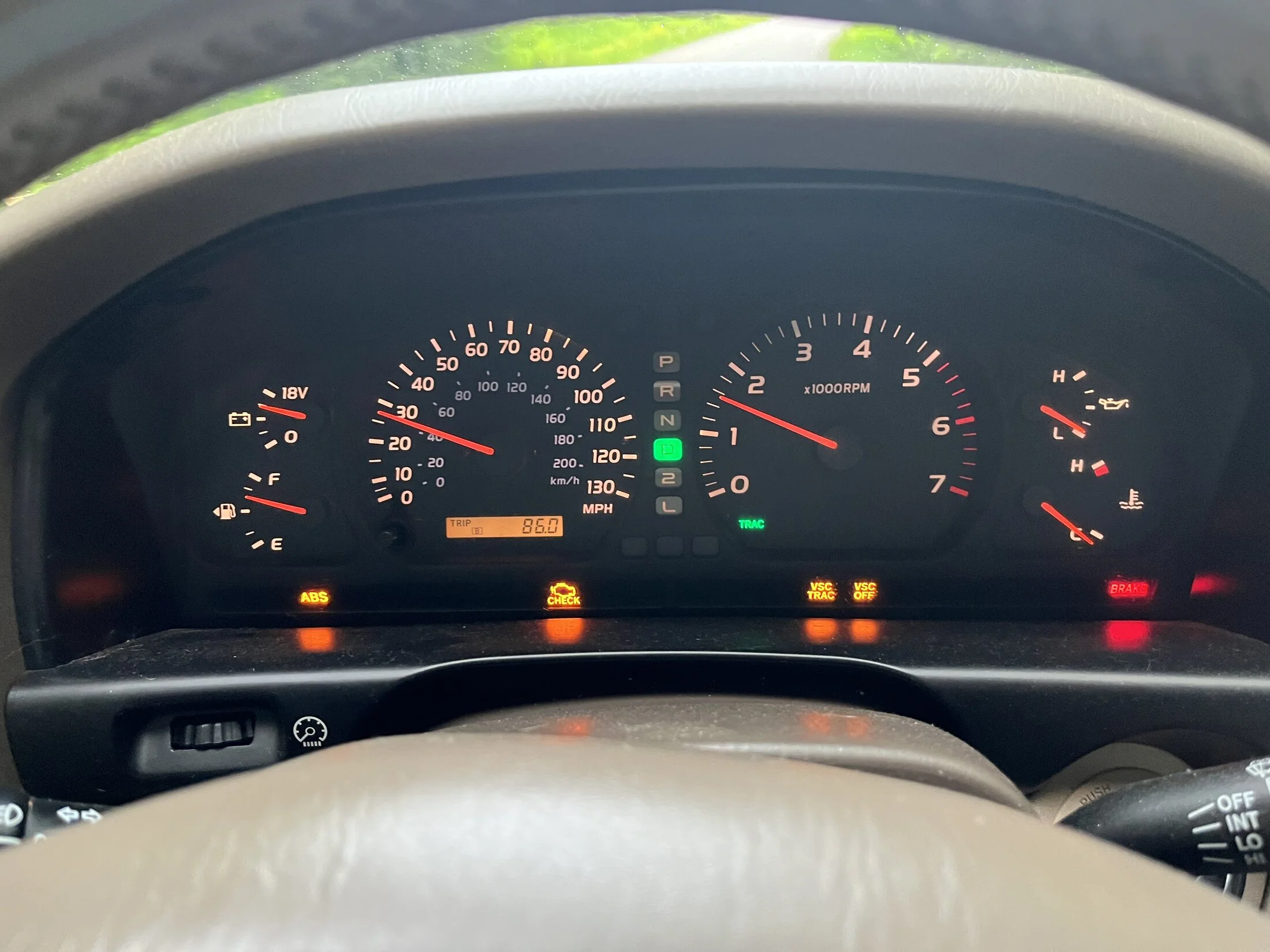

I see in picture, the CEL (check engine light) return.

This picture was from Monday, CEL has not come back. Was a P0440 code and it had been tripped for a while. I found a hose fallen off in the evap system and reconnected while I was poking around under the hood. My obd2 reader gave me no other codes or faults but I do not believe it can read ABS or Toyota specific stuff it’s just an Innova 5310 basic reader.

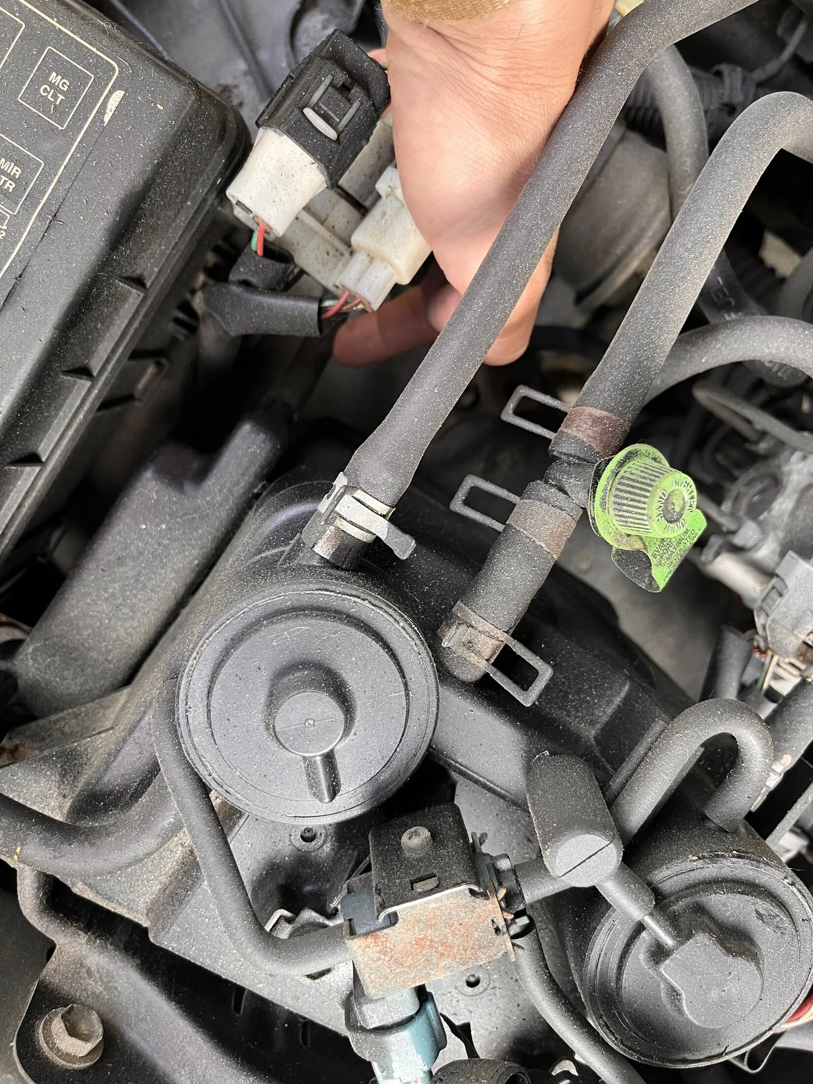

Post pictures of hose you connected?

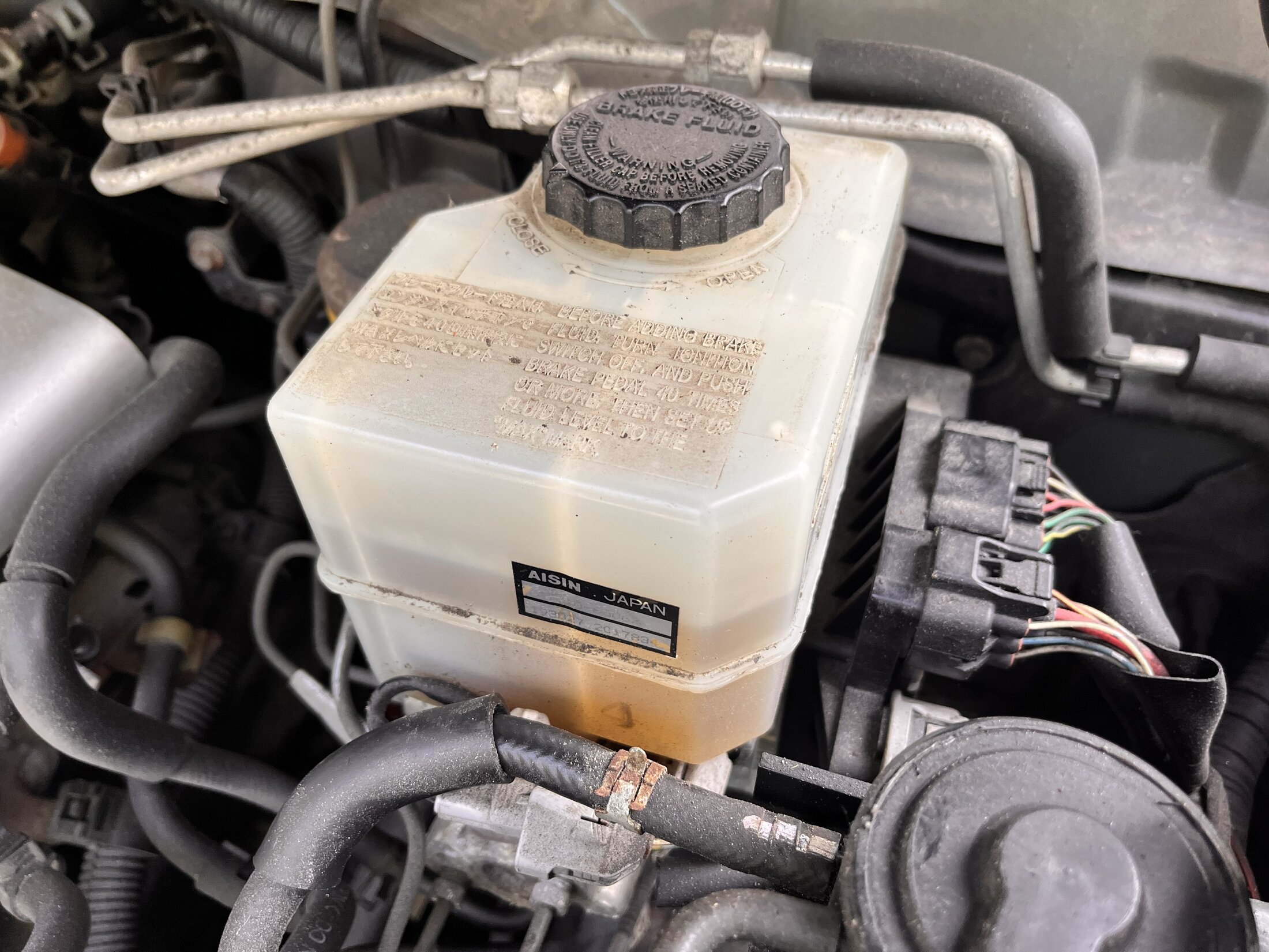

Also post picture of brake reservoir and the wires inside boot at bottom of ABS unit (black box on side of brake master wire attach to)

This picture shows disconnected hose. Vehicle has been driven 116 miles so far without CEL coming back on. This may have not been the cause of the P0440 but so far no light
Here is the reservoir. I performed the motor test and it ran 31 seconds. It did sound like it stopped and restarted somewhere around maybe 16 seconds?
