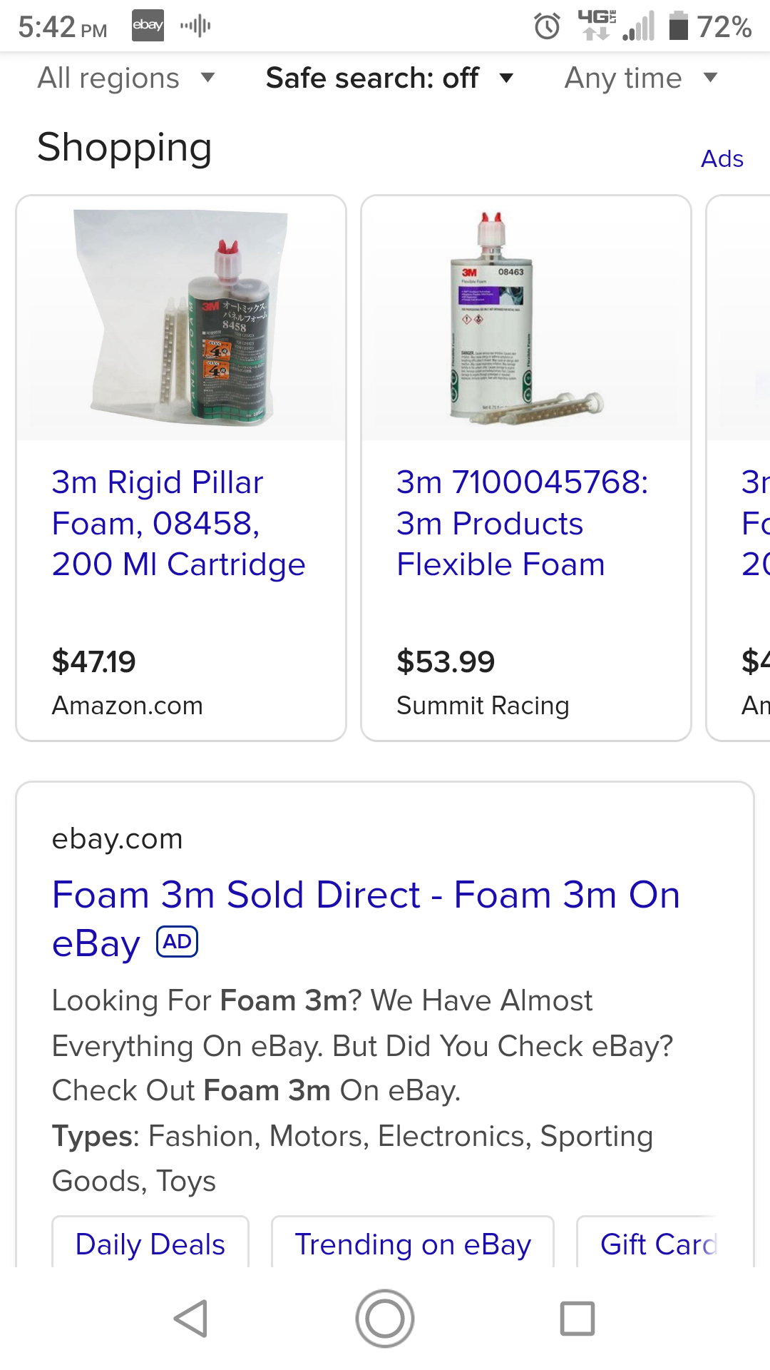

That is a sizable gap, I'd say that support is likely bent down relative to where it should be. That being said I'd verify the cause of the gap before pushing the hood skin to the support and gluing it there- you may end up with a large depression in the center of the hood. The automix foam products pictured are actually made for this purpose(between skin and support) but require a special gun to dispense. The window urethane would also work, and if you got the one pictured you could apply it yourself with a standard caulking gun and skip the trip to the glass shop.

I'll ask around in the local community to see if I can borrow one of those two-tube dispensers. I borrowed one from @Splangy a few years back to do the seam sealer along the rain gutter on the hard top.

Agreed, the original underhood decals are super neat. They'll be absolutely worthless since I'll no longer have a 2f in the rig but I'll still mask around em and save them for posterity when the hood gets sprayed. Solid game plan on coming up with a loaner 3m automix gun- that's definitely the best way to make this repair. If it were me, with that gap- I'd run with the flexible foam for this repair versus the Ridgid.
