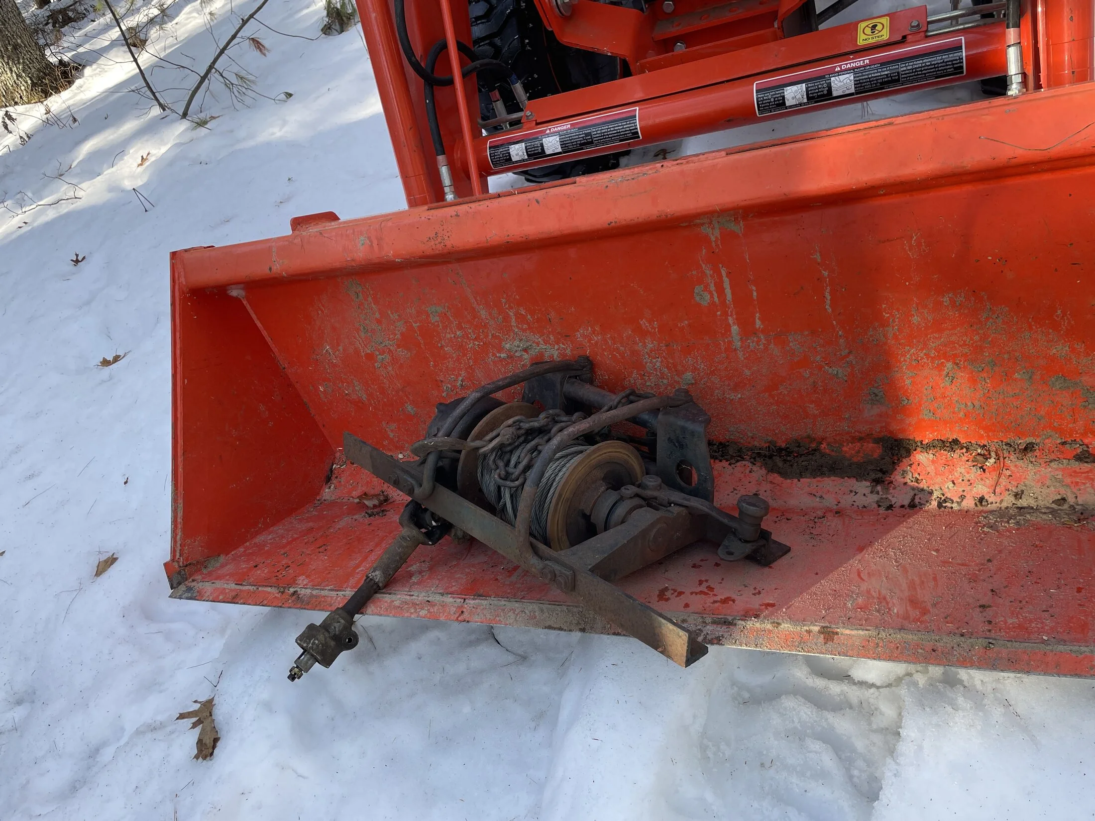

I’m new to fj40 world and hope I’m posting this in the right place… I am trying to remove an oem winch off a 1973 I picked up about a year ago. However, I’m struggling removing the winche’s front drive shaft from the hole in the frame’s front crossmember. I would like to hear from someone who has done this… b/c: do I try to remove the pillow block body (13) or come about it from the other end and remove the front u-joint (3) and pull the yoke (7)?
Here’s pics and manual reference. Thanks for any help or references to old threads

Thx. That info helps a lot. Well, I finally got the other winch off by slotting the crossmember. I didn’t want to chance cracking the pillow. Another question: I looked on SOR and not seeing replacement u-joint. I take it they not available anymore? If so, I better be careful pulling these apart lol.
