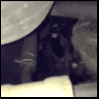

I can't say 100%, but I don't see a leaky rack, I think I see a leaky hose that has gotten fluid all over the rack. And also (not 100% sure), it looks like probably an inner tie rod end is gone. That usually happens if the truck hits something like a curb, pretty hard. Again, it's a pretty shaky video, so no guarantee on what I am seeing.
That looks to be the source of the leak?
That does look like a leaky rack on DS. Boot was very wet, typical of leak. That's not to say oil may spilled or a power steering fluid leak (ATF) from above. Look around see if oily above the DS rack boot. If not, I would add some AT-205 Reseal to power steering, clean and watch level. If yes oily above DS rack boot just clean and watch. If boot full of AFT it will continue weeping. So watch level also at reservoir.
Could not see much as camera moving all over fast. But pump may not be leaking, may just be leaky hoses from reservoir on PS (very very common).
The Stocks may be ok, besides I only saw one wet not all four. These are not like cheap regular shock, that we'd say; sure replace them all when one leaks. It fact it's ok for them to weep a bit. I'd flush the AHC, clean shocks and watch. His suggesting all 4 is uncalled for. It shows he's not that knowledgeable with these AHC systems or something worse.
Would it be nice to have new a rack, YES. But his moving the wheel showed nothing, as one wheel needs to be held in place (on the ground) then we watch for movement in gear of rack.
Thanks for looking the video over 2001LC, I really appreciate it. I'll check it out and see if I can find the source of the leak. I took it down to Shawn at LC specialist (per reccomendation above) today and he is pretty much saying what youre saying but would need to get in to verify.
