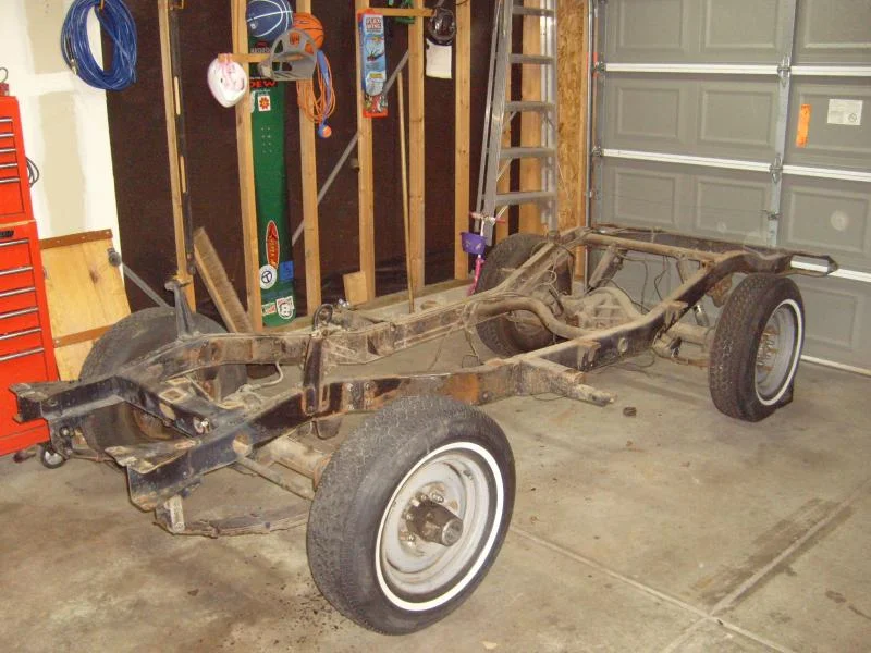

It finally feels like I am making some progress on my FJ40 project. I just got the frame back from the sandblaster and I am ready to refinish it. My initial thoughts were PPG epoxy primer follwed by Eastwood semi gloss chassis black. Now I am wondering if maybe I should start with POR15 first. I decided against powdercoating beccause it's just gonna get chipped and paint will be so much easier to touch up or even re-spray down the road. Thanks in advance.
I'd go with the POR or Rust Bullet followed by chassis black while it is all out in the open. That way when you do touch ups you will touching up over a good solid rust free and inhibited base.

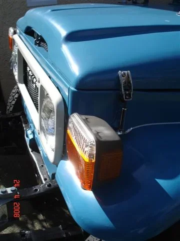

I've NEVER found ANY paint that lays down better than POR15 primer.
I can't recall seeing any brush marks left behind anywhere and I even handbrush it on my BJ40 bodywork prior to spray-topcoating!
Here - This has been POR15-handbrushed and the topcoat is exactly "as sprayed" (no sanding/polishing/whatever):
Brushing has the advantage of very little wastage too because POR15 primer costs $52 for 500mls here.
I like to choose the primer colour as close as possible to the topcoat colour too. (Thus scratches/chips look less ugly.)
