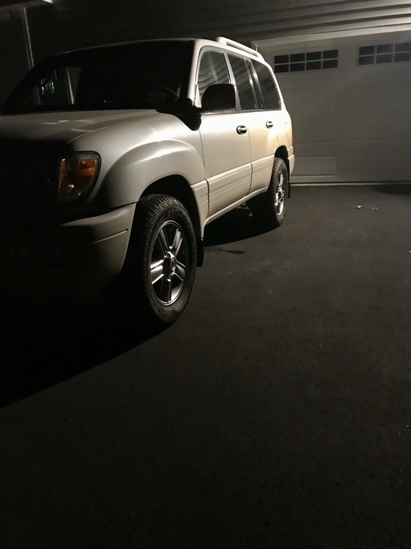

I'm a fairly new LX470 Owner, currently driving a 2004 220K mile plus truck running 275 65 18 BFGs and an OME lift on it. Would love to throw some 1.25" spacers on it to push those wheels out a bit but didn't know if I'd regret it later with faster wear and tear on bushings and control arms or if it would also lock me in to have to continue to purchase tires of a similar size moving forward because I don't want too much offset. As it looks today, I don't like the look of the tires sitting inside the wheel well so it's 100% a visual thing about pushing those wheels out to at least run flush with the fender. Would love any thoughts on regrets or stories of success on a similar set up. Also curious to know if Slee's are the spacers of choice or if any other brand is recommended. Thanks in advance!

Here is mine next to a non lifted twin with 285s, twin has ugly fender flares though. Hope this helps to make your decision...

oem tire size and wheels
Bora 1.25 is flush with the fender
Perfect imo
