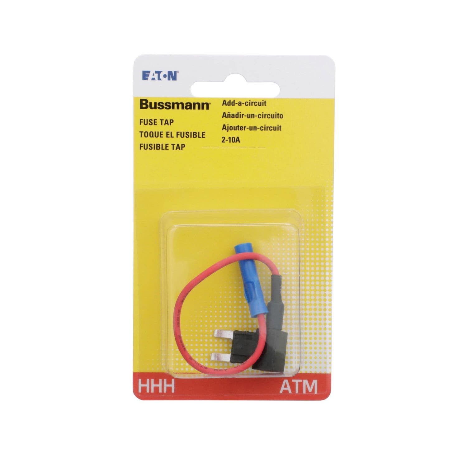

Look for something like this if any of those fuses have power you can jumper in there.
Yeah, I have one of those but for some reason that i need to investigate further 12V is not present all the time on those fuses..
So they are only active with ignition. That black connector looks factory just cause it has a tin slide on attachment.
Perhaps if you want a 12V power connection, might I suggest a dedicated line from proper fuse box? I know it’s a much longer line, but in my experience this keeps system troubleshooting easier. If one thing fails, it’s doesn’t
take down a string and sometimes that string has that one singular important item, like a fridge. It’s my cautious approach to extras. I believe that any one system should be able to be removed for repair and not impact anything else.
