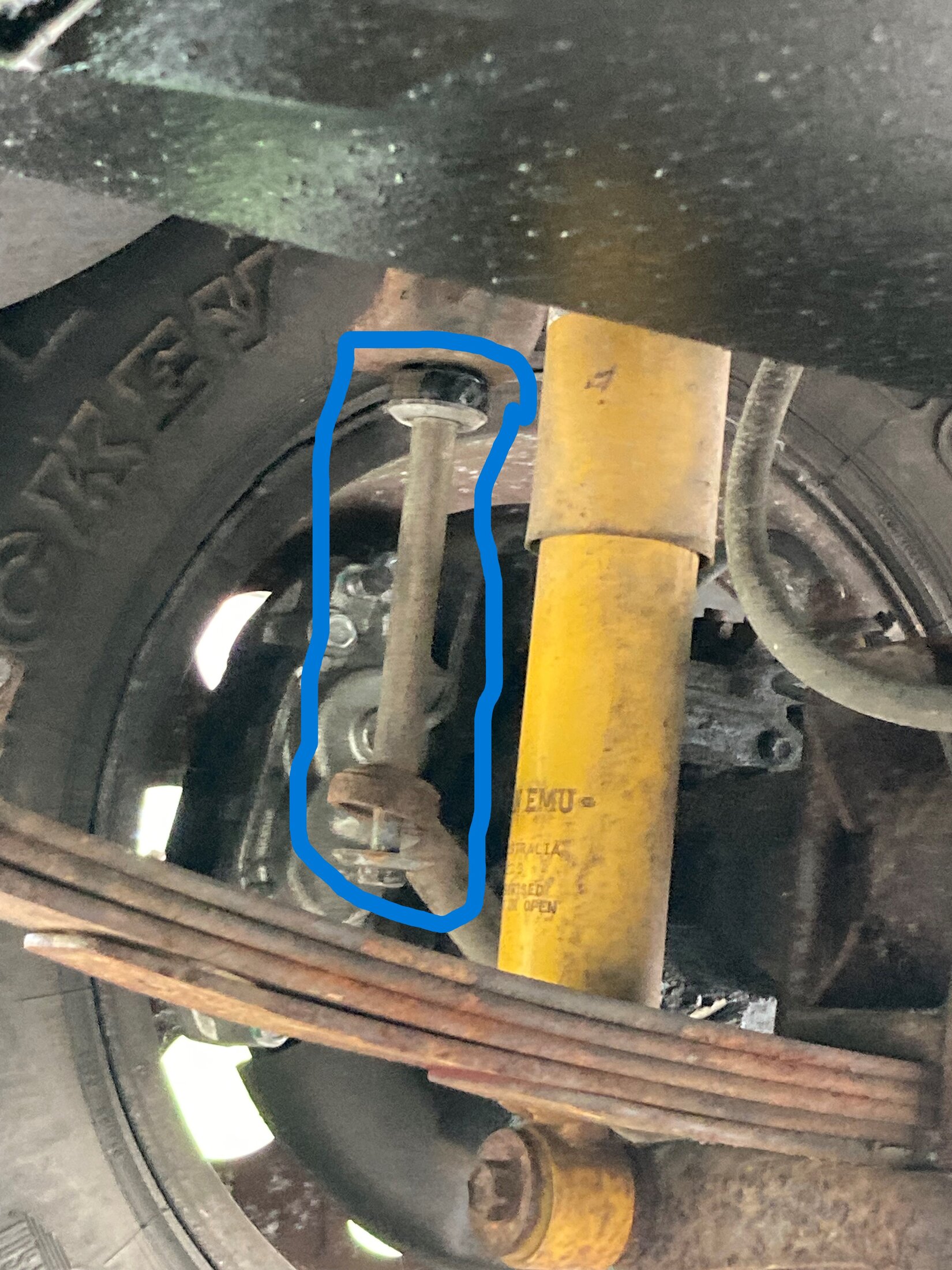

I've searched here and on vendors' parts sites and can't seem to find the name of this part. It's clearly related to suspension / stability. Please help me identify the part that I've circled in blue:

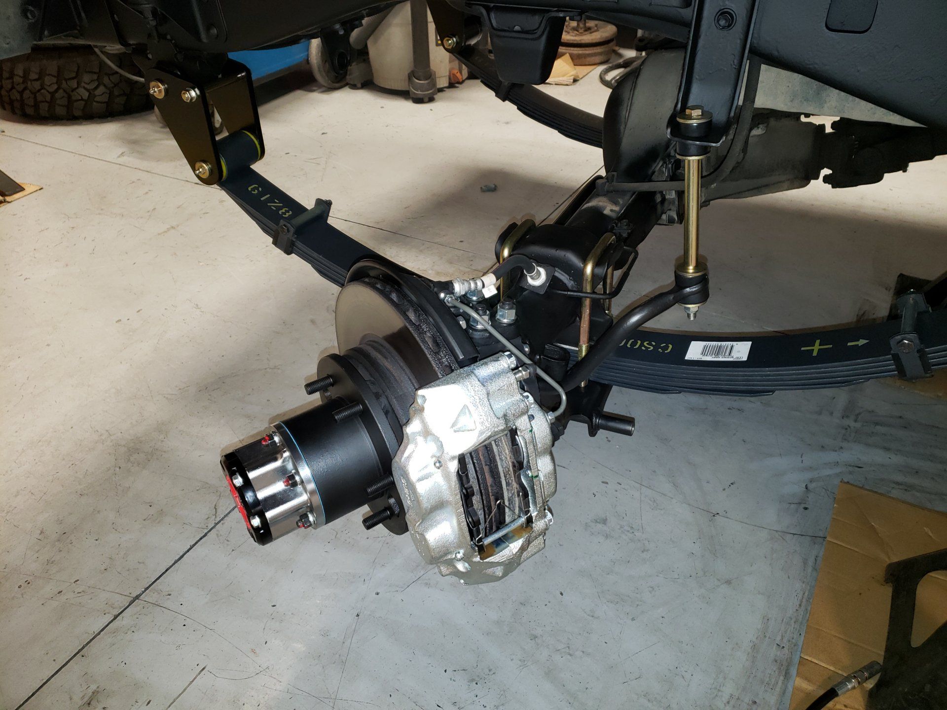

just did two suspension upgrades. I would check with Valley hybrids first to see if they have them in stock. If they don’t, I would check Cruiser Outfitters if they don’t I would check man freeIf they don’t, I would check Cruiser Outfitters if they don’t I would check man a fre. If your truck is lifted, you need to be sure to get the extended sway bar links.
Depending on where you’re at, you may need them for the front and rear sway bars.
And you probably need an extended link (or just the bushings) since it appears your truck is lifted.
Right, good catch, thank you!! It looks like Man A Fre offers extended front sway bar links for lifted FJ62's like mine. I think I'm going to order their version for the 2-3" lift, which mine has based on my OME light duty suspension system. Sound right?
