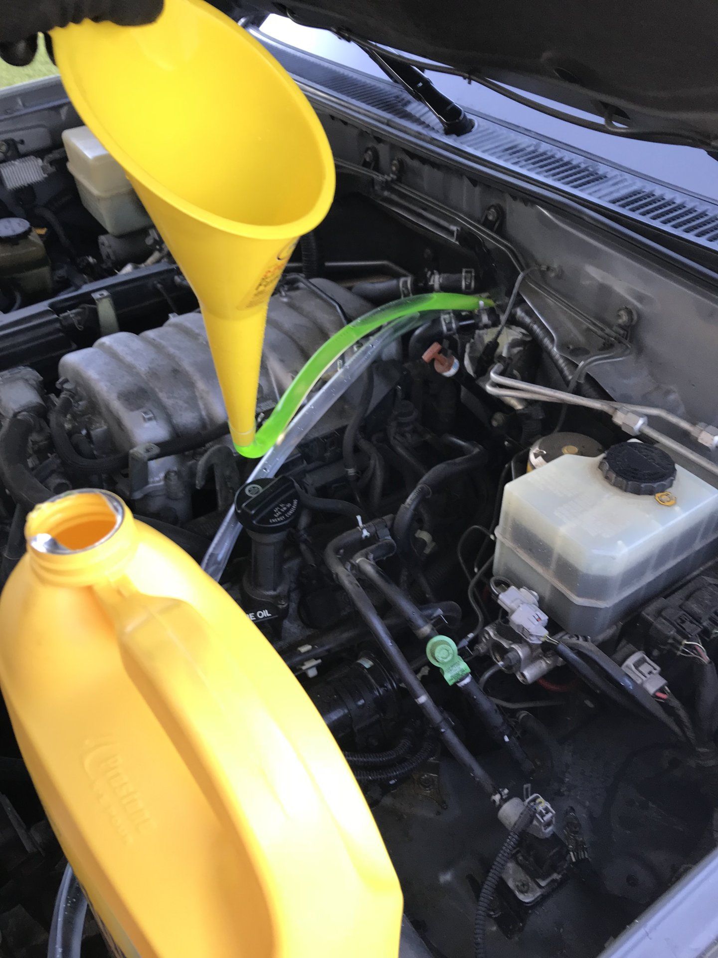

My buddy loaned me his Air Lift system to evac and fill the coolant, gonna do that along with some CLR in the main heater core for a few hours and a new OEM thermostat from Toyota-san this weekend. Will report back.

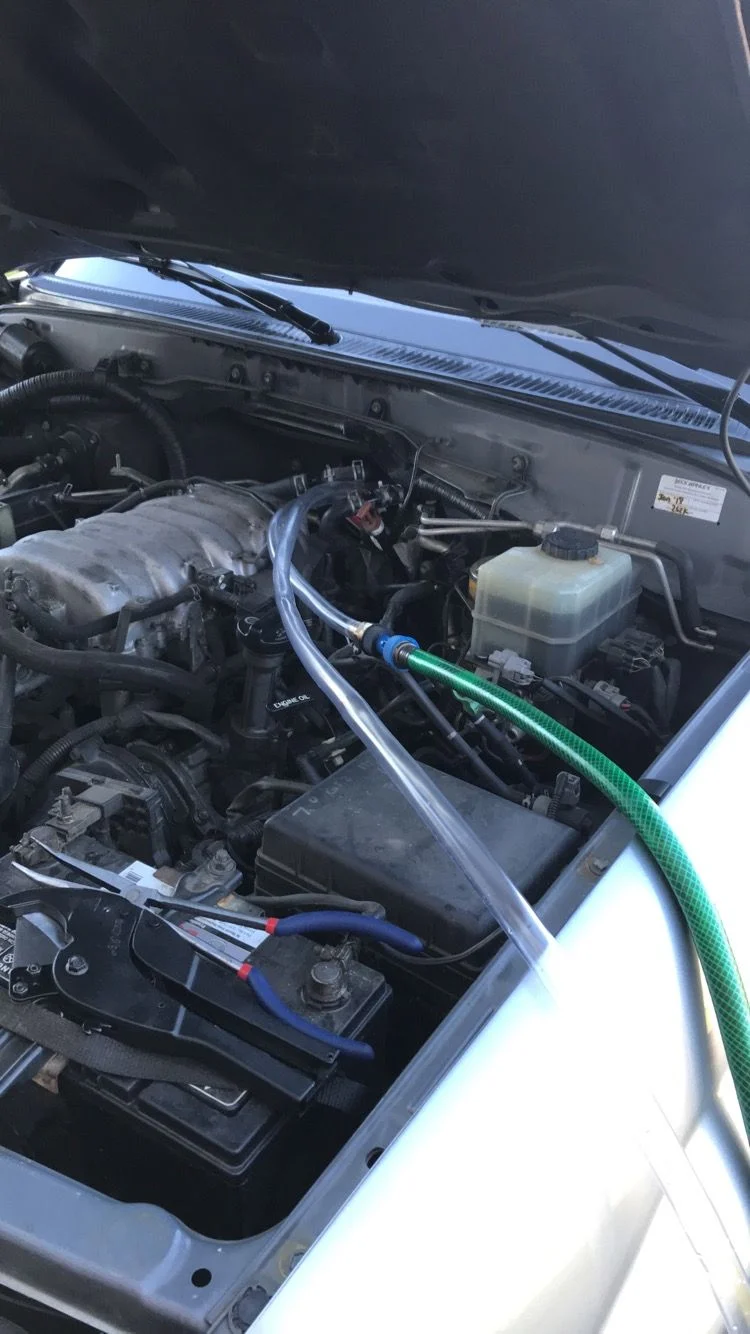

The heater core is not that big a deal just backflush it. My heat didn’t work at all, flushed the core and it blows like a volcano now.
I have backflushed it with a garden hose and done a chemical flush - slight improvement but no love.
I’m not too familiar with this procedure, are there any write ups or info on how to do this correctly? Thanks

Number one reason for low or no heat, is coolant "low" or "air bubble" in heater core. When bleeding coolant system it's very important to check under cap of radiator after bring to full operating temp, then allow to cool down for 8 hours.

When flushing front heater core, it should flow unrestricted.
BTW: Using tap water to flush is bad idea.
Prestone sell a tee that splices into heater hose and attaches to garden hose, it promotes use of tap water. For this reason I do not trust Prestone products.
Yeah those tap things are not great, wouldn't use one of those. 6 hrs of driving with tap water in the cooling system shouldnt hurt anything, and its easy to back flush off a garden hose and not off some sort of rigged up pressure vessel with distilled water in it.

You can burp the system by keeping the radiator cap off DO THIS ONLY WHEN THE ENGINE IS COLD +WEAR GOGGLES, and starting the engine to warm up. Keep the ac and heater both on to heat the engine quicker and to flow coolant through the heater core. If these is an air bubble, the coolant level will go down, then add more coolant mixture. I use this method and never had an issue on all my vehicles.

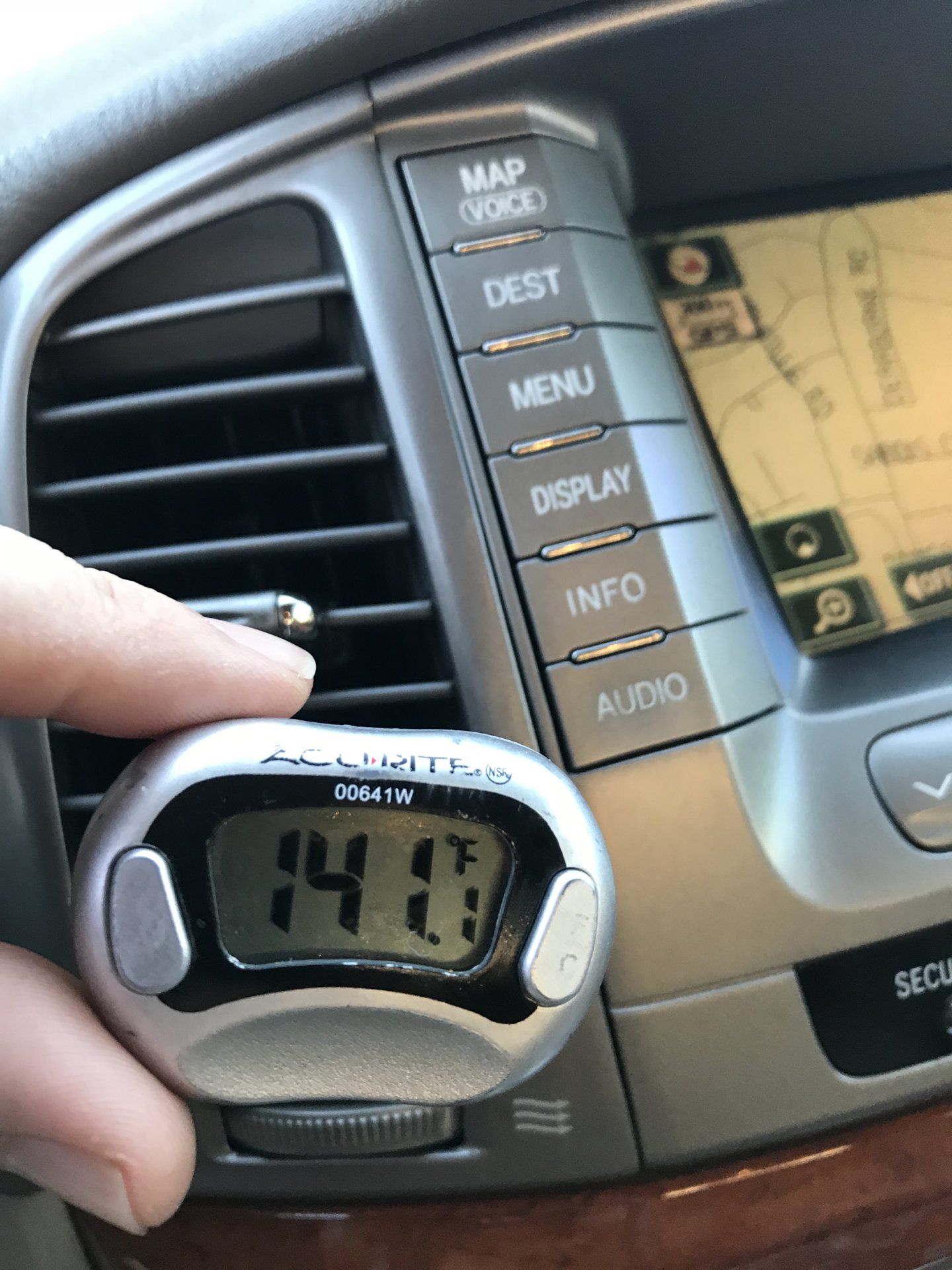

I followed the instructions in this video and it worked like a charm! Went from 75 degree temps measured at the vent to 140+!
There is not enough water left in the system after draining to say so. Maybe a cup in the whole system.
Flushing with a garden hose is fine, if you want to get every last drop out, jack up the back of the truck. Everything will run forward adn drain.
You can fill the system with water form the garden hose, add your cleaner, drive for a day or so and then drain and flush the cleaner out and you're good.
