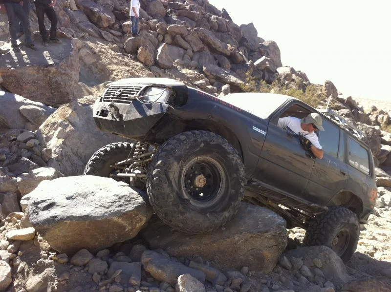

on chocolate thunder at hammers

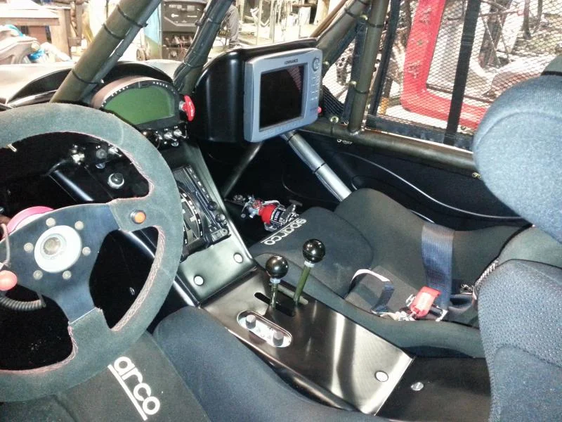

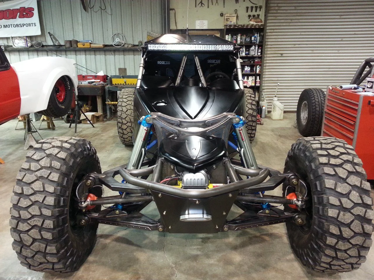

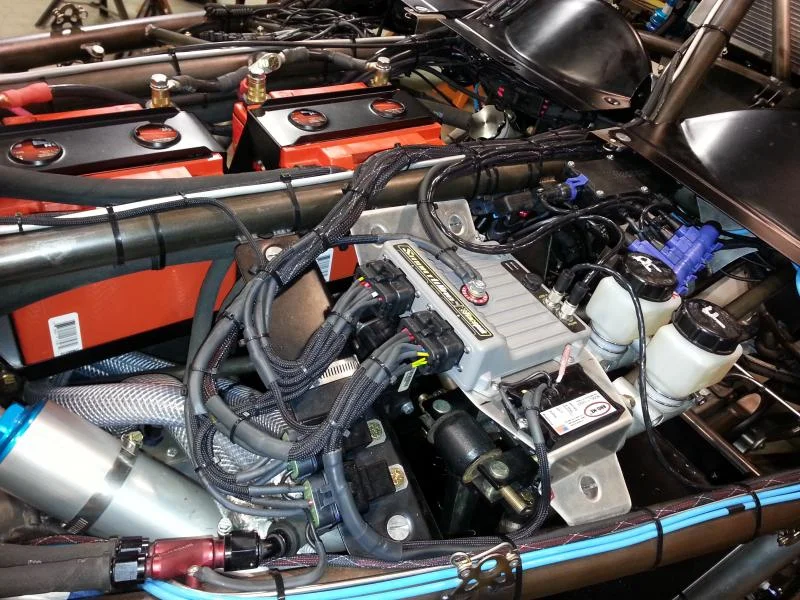

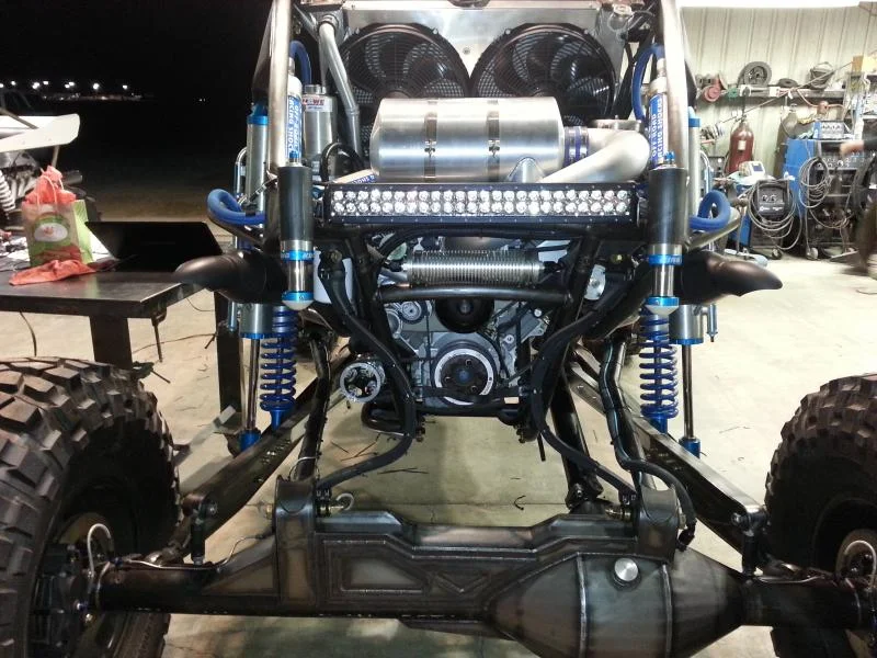

You should see the IFS Super buggy me and dad conceived. It could run the Dusy in a day and be back by dinner
My favorite part is the Lexus badge.
Thats one Awsum Darth Vader buggy ! Thumbs up to you and your Dad. As for your engine Issue, your fuel pump may be getting tired. Good Luck, Enjoy those children !!!
Alright I hope you sort out your fuel problems, but you can't post a pic of that bad ass buggy and not feed us with more info, holy chit that is cool...
ya buggy gets it
rear engine ls3 dry sump 500hp
atlas 3.8
culhane TT t400 tranny manual VB
10" currie rear arb 35sp 300m
9" Curie front arb, dutman ifs, RCV d60 "birfs", 935 cvs, all 300m
king race 3.5 coils and 5 tube bypass shocks all around
30" travel rear, 22" front
Racepack guages
sparco seats
39 Crawlers with race run flats inside (no spare)
4400 lbs of zombie hunting bliss
