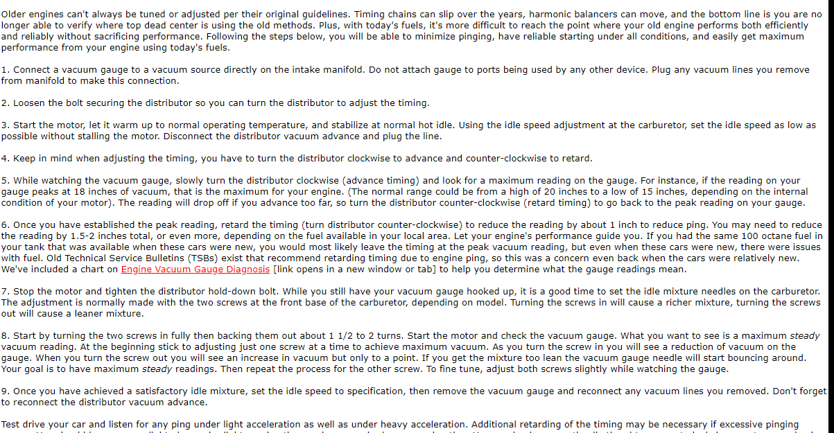

Try looking at this.

However, I want to make sure I don’t have things completely backwards, based on what I read in the article attached to 1969FJ’s post.
That article says you turn the distributor clockwise to advance, but I’m pretty sure it’s the opposite on our engines. Can someone confirm that? Also, I believe that as you advance the timing, the position of the BB drops lower in relationship to the pointer.

Yes as advanced it drops lower in the window.
