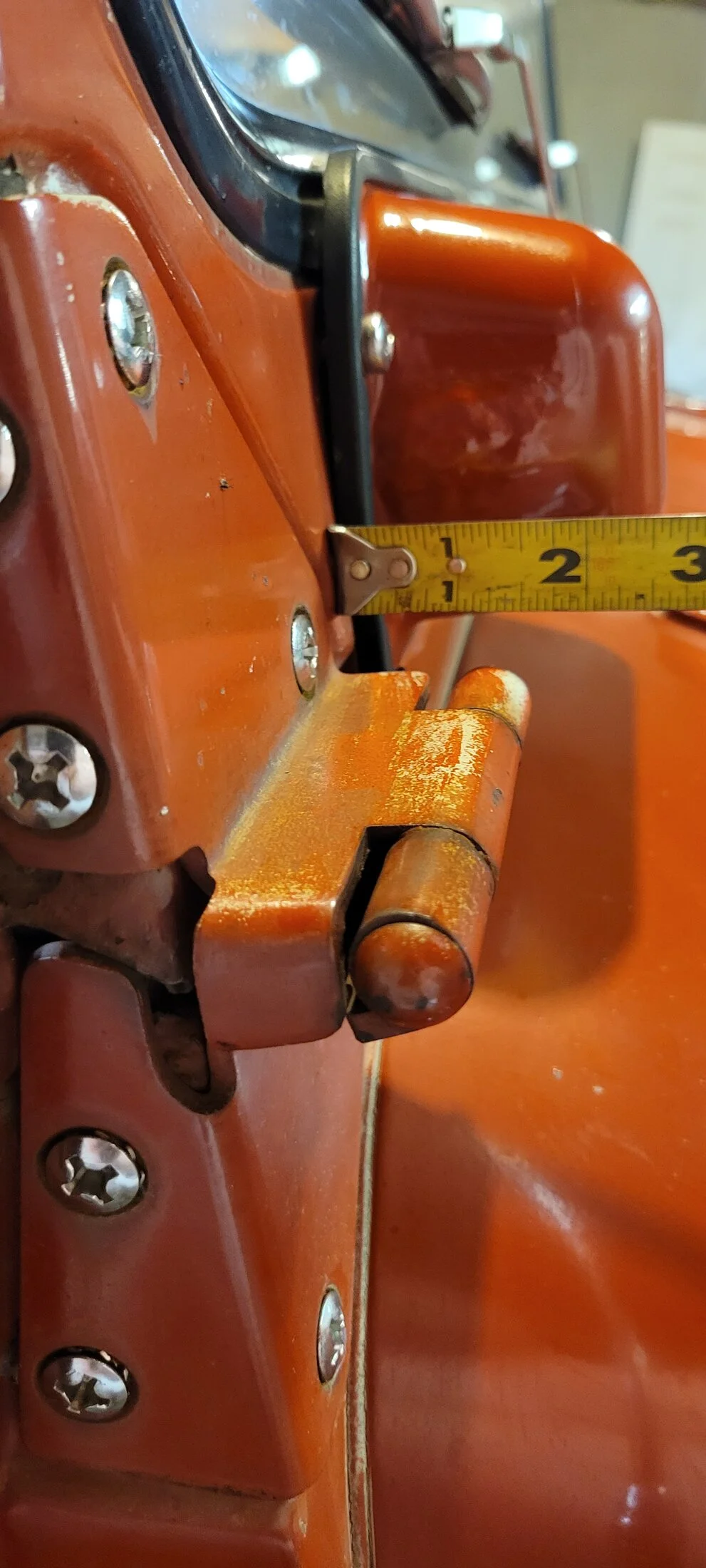

How stiff should the bib hinge be?
If its in the right position I dont understand why folks are trying to get it to move?
Its one part I wont be fussing with on my re-rebuild of my 76 and I definately wont be doing speed engine changes under enemy fire any time soon

It Should move freely ,the two piece one is early ,all of mine that I’ve had 1974 and later are of the one piece design.
Mine is actually loose and floppy it nice if ya ever need to tip the bib forward loosen the fender bolts and in tips forward no need to even remove the bolts. Just loosen them.

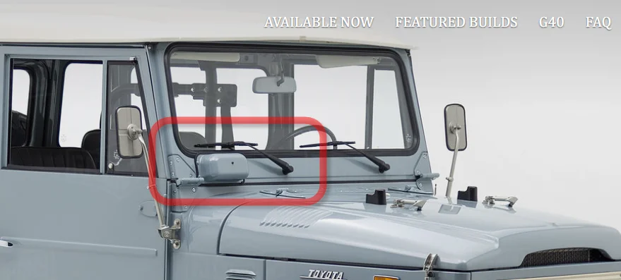

I know this is off topic but i see no trouble dropping the windshield on later models 40 series , it is designed for that
Really? What did you do about the windshield wiper motor? After '73, it's on the outside of the windshield.
