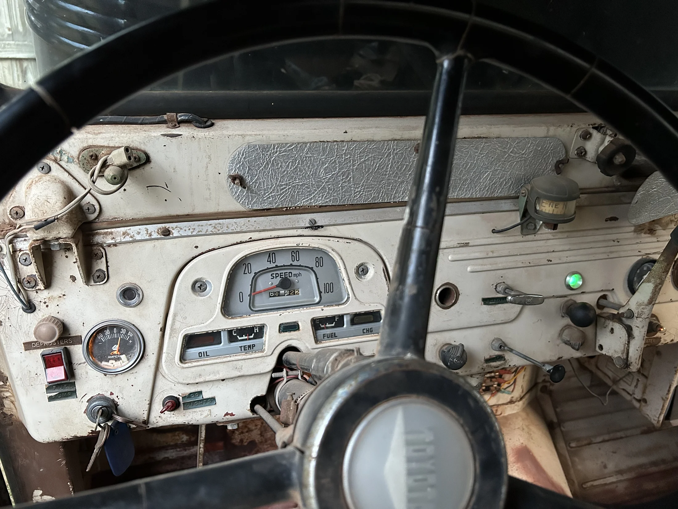

If it’s not too much trouble, could anyone help me ID some of these controls? I’m confident on some of them, but not all. My choke cable is broken/disconnected I haven’t dug in yet. Is the green light factory? If so what does it mean? Not sure what the big pull handle on the right side is. Thank you guys in advance. US spec 1962 LC original F engine, 3 speed converted to floor shift.
Looks like a lot of PO Mods - read the labels. Choke looks like the black knob silver shaft that's pulled way out 45 down left of green light. G L Could be part of 4wd indicator
Handle is the transfer H-N-L.
Green light is the front drive indicator.
Front drive (4wd) is engaged by the knob under the light.
There is a hand throttle that should be above the choke.
Im missing both the choke and hand throttle knobs and cables.
Ok makes sense. Thank you very much. I figured the handle was the 4wd shifter but wasn’t positive. Noob questions I know but my oldest LC was a 91 80s series lol this is by far the oldest car I’ve owned. Really appreciate the insight. I’m curious, did you convert to FI or electronic choke?
Thank you for your help!
Whenever I get an engine(2F) in it, it will be carbed, with a choke and hand throttle.
