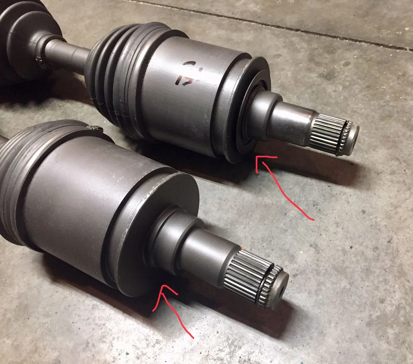

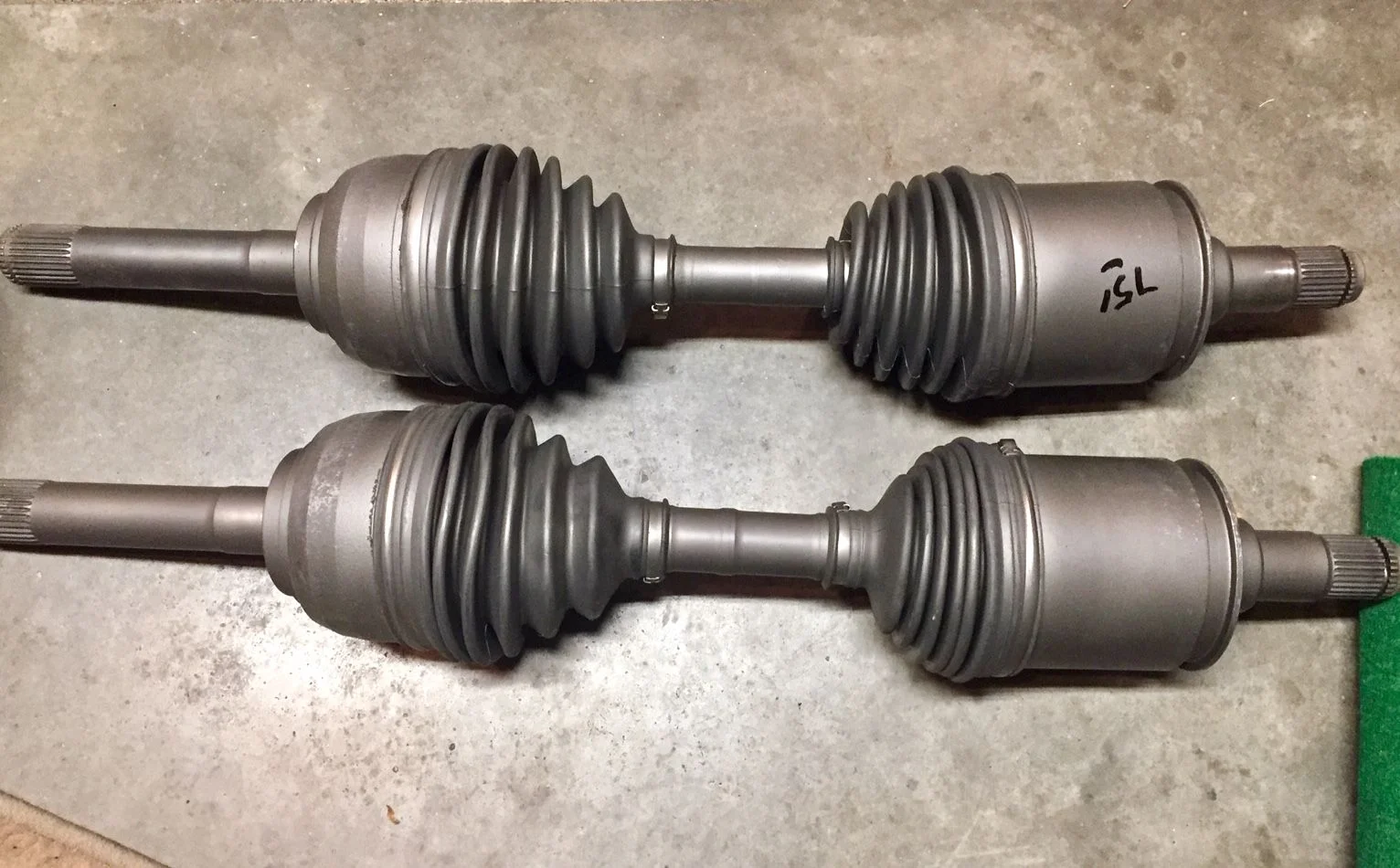

Hey Mudders
I need some help determining if some remanufactured CV’s I got from Detroit Axle are oem. Not sure how guys tell if they are oem or not. Also, there’s a seal or part missing on the diff side of the axles. I don’t know my cv anatomy, so I don’t know what to call it, or if they are functional. Thanks for any help you can offer.

I think they are both OEM cores.... One has the dust cover on it (top one in second photo), one does not. The dust cover should not have been coated with the rest of the axle, but it won't hurt anything.
I've gotten too much differing quality from Detroit Axles in the last couple I've seen, and had to send the last one back because the dust cover would not fit tight at all. I think someone polished or wire brushed the exterior too much. After some success, I just cannot recommend them anymore. Why one has a bulge in the middle of the axle and one does not, I cannot comment on, perhaps model year differences? The fact that the both axles are coated, and not polished on the ends, bugs me, and the pitting on the outer joint of the one is not good, either.

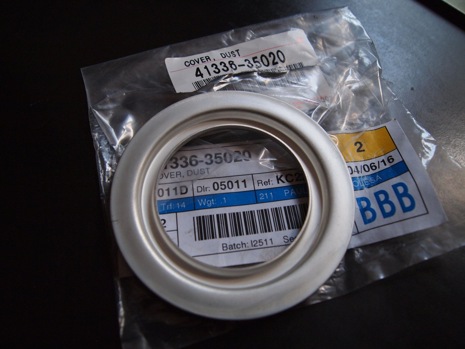

This is the dust seal that is missing on one of them:
41336-35020 - Genuine Toyota COVER, DUST
Thanks for the info gatormark91. Should I be upset one doesn’t have a dust cover on it? What characteristics are you looking for that determine whether or not it’s oem?
No, a lot of the axles don't come with the dust cover. You can carefully remove it from the old one if you want to re-use, or buy a new one (link above). The aftermarket axles will have a different shape to the housings on the inboard joint (less than the factory cage with 6 balls, less range of movement), and generally, the axle will be thinner. Detroit Axle says they only use OEM cores, which is good, but the quality is not the same from my first order to my last. I'll probably go with Toyota remans next time, just to skip the hassle.
To re-use the dust cover, just work around the spot between the cover and the housing with a very thin flat-head screwdriver, tapping it with a small hammer until you get a gap, the go up to a slightly larger screwdriver. It should be a firm fit, but it won't take much to get it to pop off.
AND - replace the diff oil seal while the axles are out. Skipping that should not even be considered. It's cheap insurance against a leak. Remove the old seal, and drive the new one in until the rubber sealing lip for the axle shaft is NO DEEPER than a straight-edge held across the end of the diff tube.

Looks to me like your missing front Dust Shield also. I found this part #, but it's not for the series 100.
The boots look like aftermarket, which if like the ones CVJ uses will not last. They offers OEM boots for ~$85 extra per side.
OEM boot kit have yellow clamps on outer tulip. As do new OEM FDS.

I'd clean all paint off axles and seals & seats areas.
Make sure to use new inner snap ring. Also the hub flange snap ring.
A very import area to inspect is condition of teeth of axle. Paint will make hub flange feel tight on axle. But as paint wares off we find the teeth worn and we get play. This play is leading cause of the D to N to R clunk.
Next inspect the outer axle grove where hub flange snap ring seats. It needs a very good 90 degree retaining groove. If it's worn down or round, snap ring may pop off.
I'd send them back. I've used OEMs I'd use over rebuilt or fork over the money for new OEM FDS along with new hub flange and cone washers.
If you keep them!

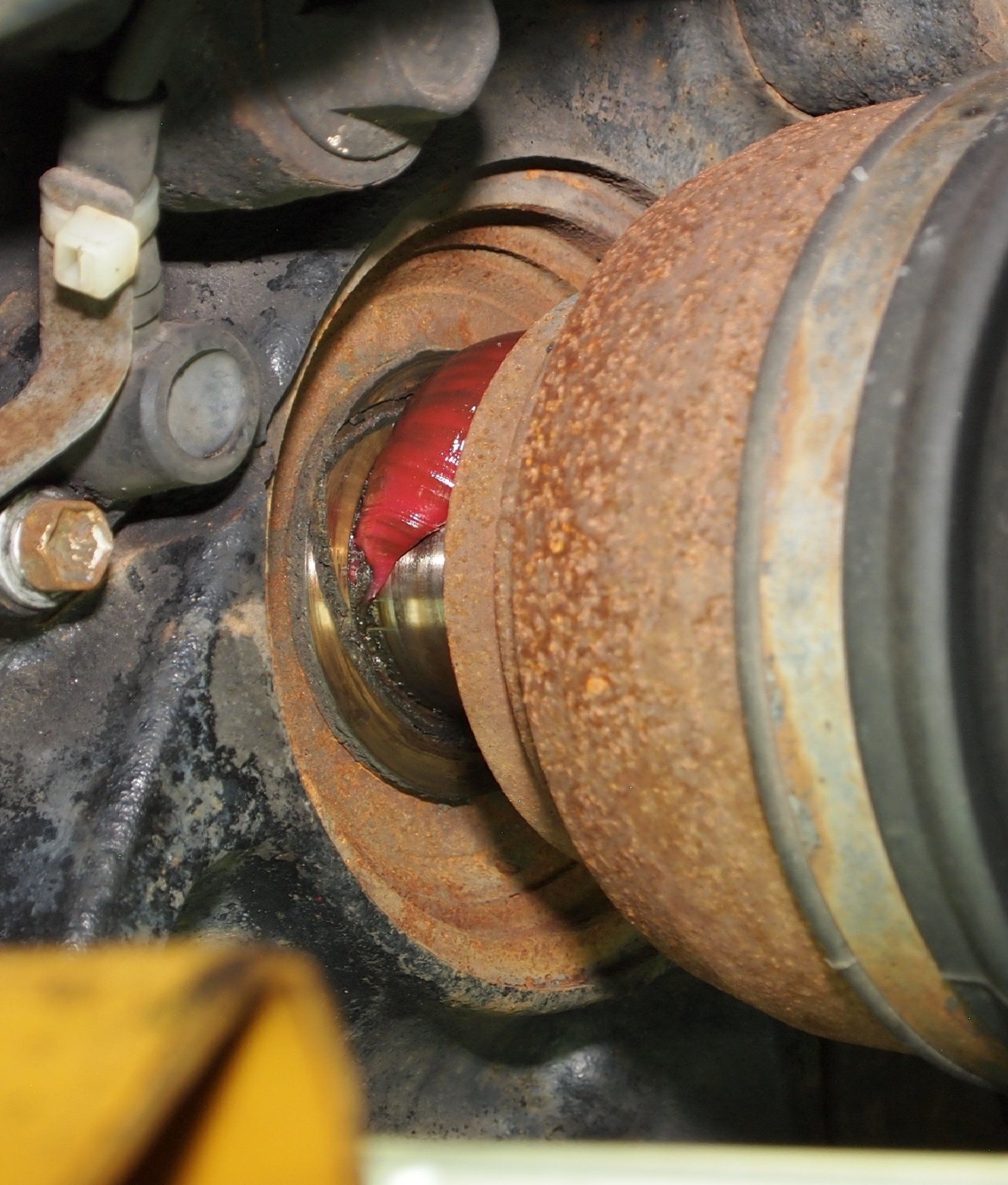

I made a simple seal install tool for Dust cover (inner axle seal)
You may like this, but this one was easy often they take a little more effort.

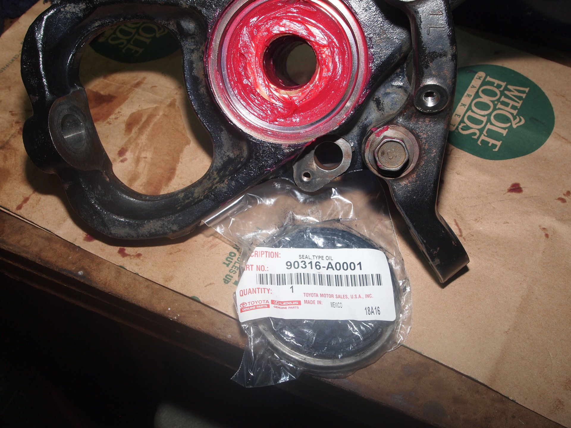

This should be the correct outer dust cover/seal part number, I believe:
90316A0001 - Toyota Seal, oil (for front axle hub lh); seal, oil (for front axle hub rh). No.2 | Toyota Parts Overstock
(click on 'What this fits" tab to see LC100, it is on the list)
It's actually available on Amazon, with Prime shipping. :)

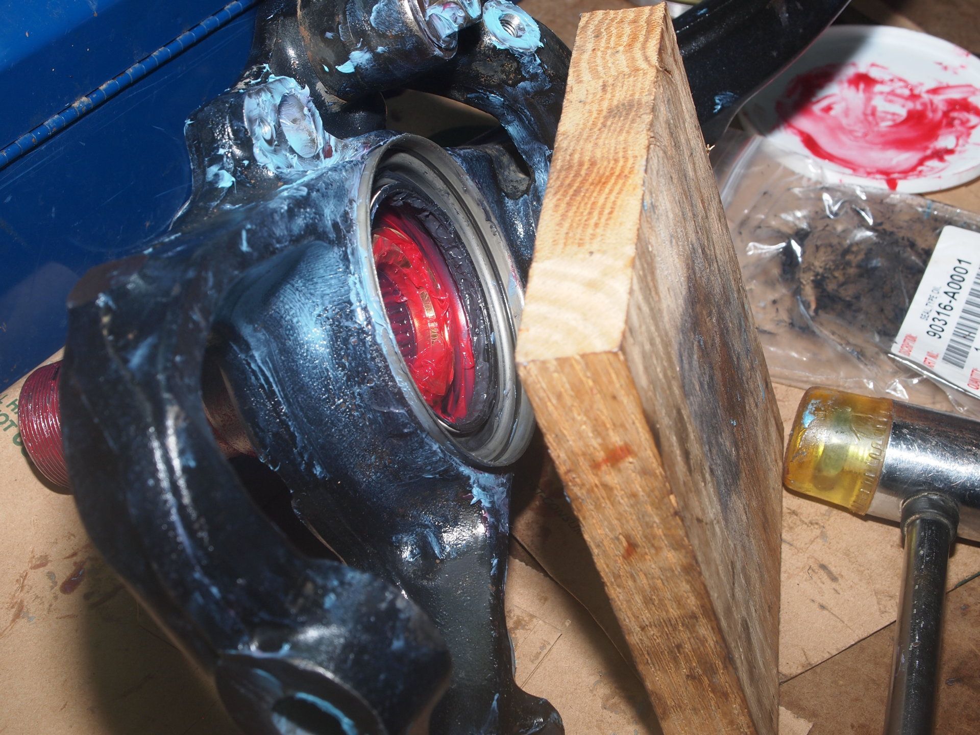

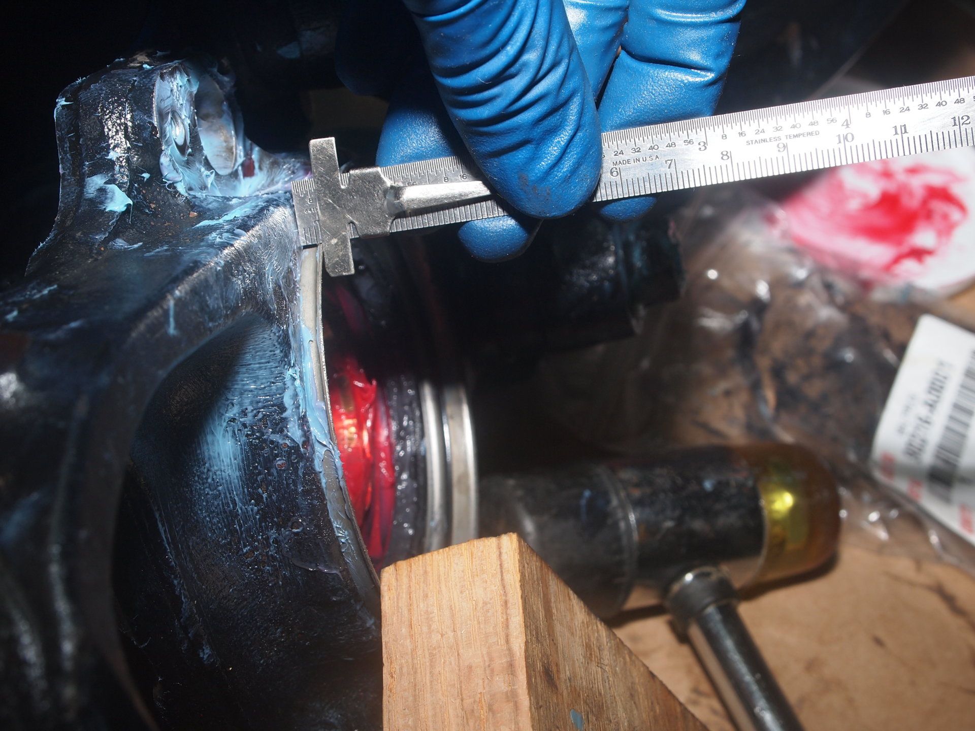

To be clear: The seal PN # you post is the one that goes in back of knuckle. The outer axle front drive shaft dust shield nest in it.

Got it, I see now why you said you did not want to buy a new axle to get the part - Toyota doesn't seem to list a separate PN for it for the Land Cruiser. That's just stupid. :-(
OK, ordering a set of the dust covers you listed myself, now. They originals weren't on mine when I put the first axles in, but the oil seal was doing OK, so did not even notice! Thanks!

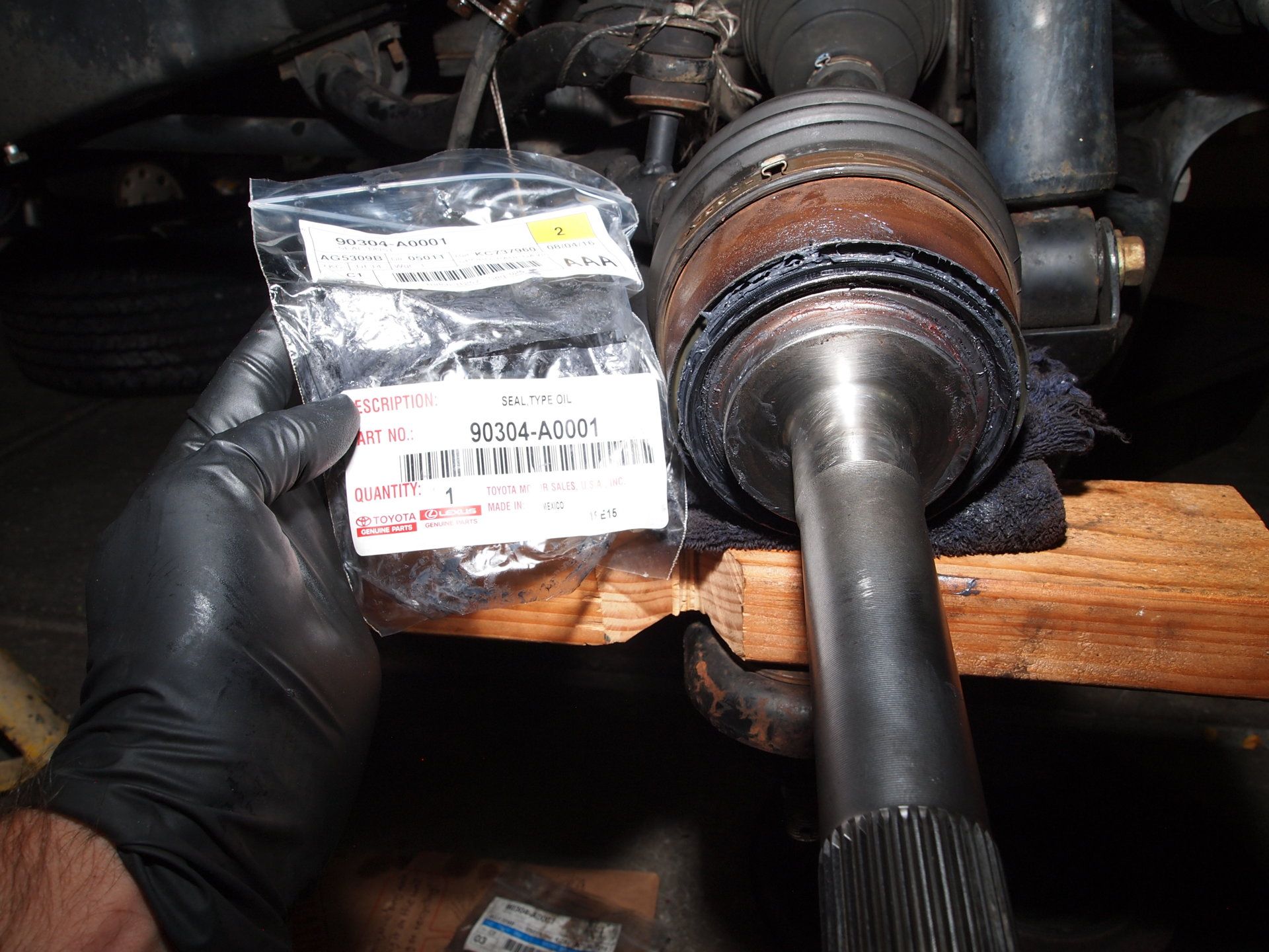

When I did the outer axle seal PN # 90304-A0001 substitute, it may have been a Tundra PN# i don't recall. I did NOT have a new FDS with seal to compare it too at the time. It seem to work fine. But the rig sold to a local mechanic and I've never heard back anything on it or from him. That seal was a very tight fit to get on. So take your time, they bend easy.

If you're asking about the seal in back of knuckle, I use vise-grips. Just clamp on the lip with round end of vise grips toward outside, and then roll the vise grips down to outside. Pops out easy, but bends seal.
