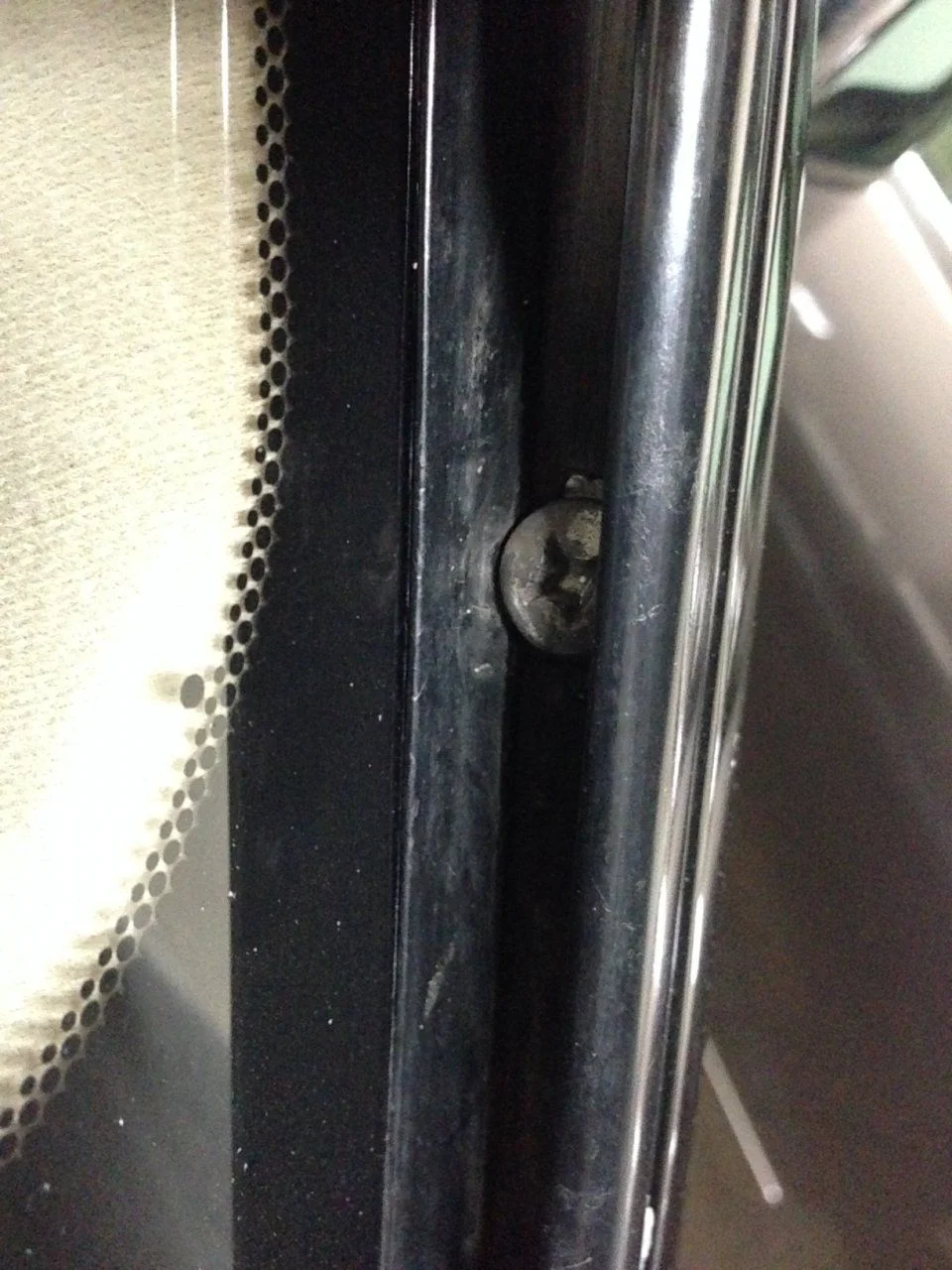

Now, I just spoke with the glass tech and was told that he is planning to put self-tapping screws in place of the rivets :bang:. He claims he has done several of these and it is impossible to put in the new rivets because there isn't much room for the rivet tool. When I insisted he put on new rivets and not the screws he offered to just glue the trim pieces instead of using screws or rivets.

Find a different installer or just put the trim pieces on yourself. Don't let him get near it with the self tapping screws.
I used a regular run of the mill rivet gun to install mine without much issue. I had the problem of previous installer using large sheet metal screws so I had to use a couple different sized rivets to make it all work. These are the oversized rivets I found that work and still have the plastic top hat:
Ford PN: W713819-S900 (4mm)
Toyota PN: 90269-06013 (4.8mm). You'll have to drill out the aluminum trim and file down the rivet head slightly to fit the trim channel.

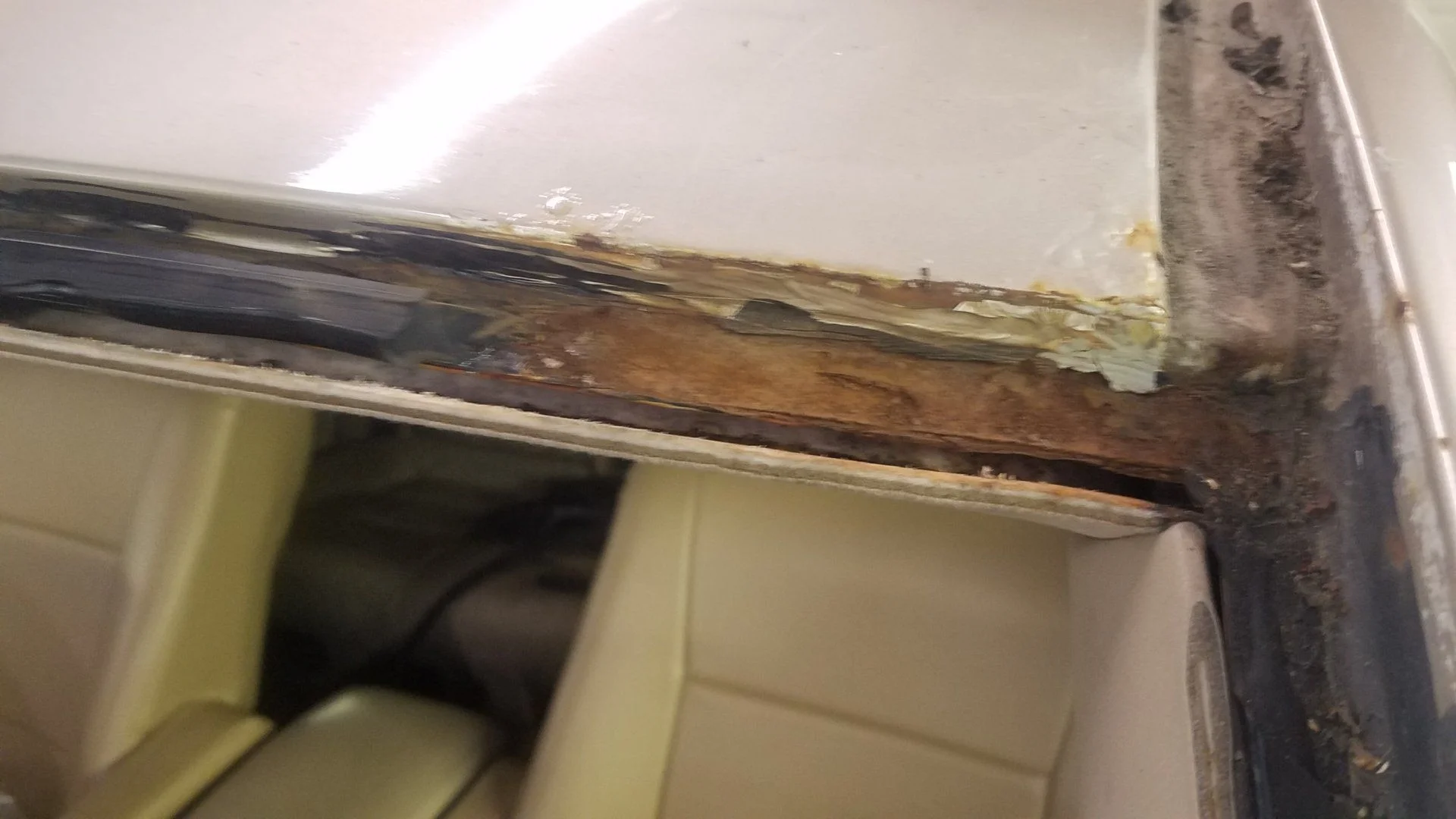

Here's a pic of the top corner that caused the leak in the first place.
Good news! Yikes. Nasty looking pic. Glad to hear the body shop helped get you all squared away.
