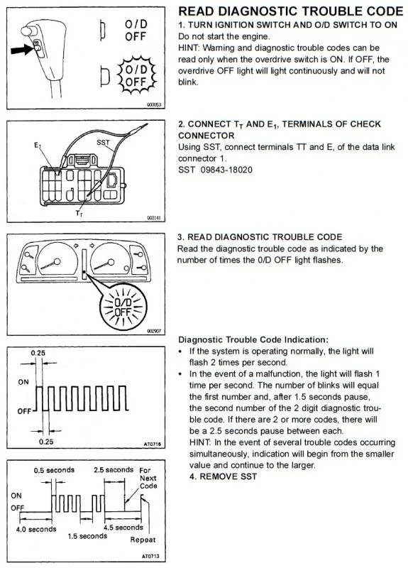

Here's how to read trouble codes from the TCM. I won't be surprised if this doesn't work, since you probably have a loose or dirty cable that you need to pull out, clean, and shove back in.
