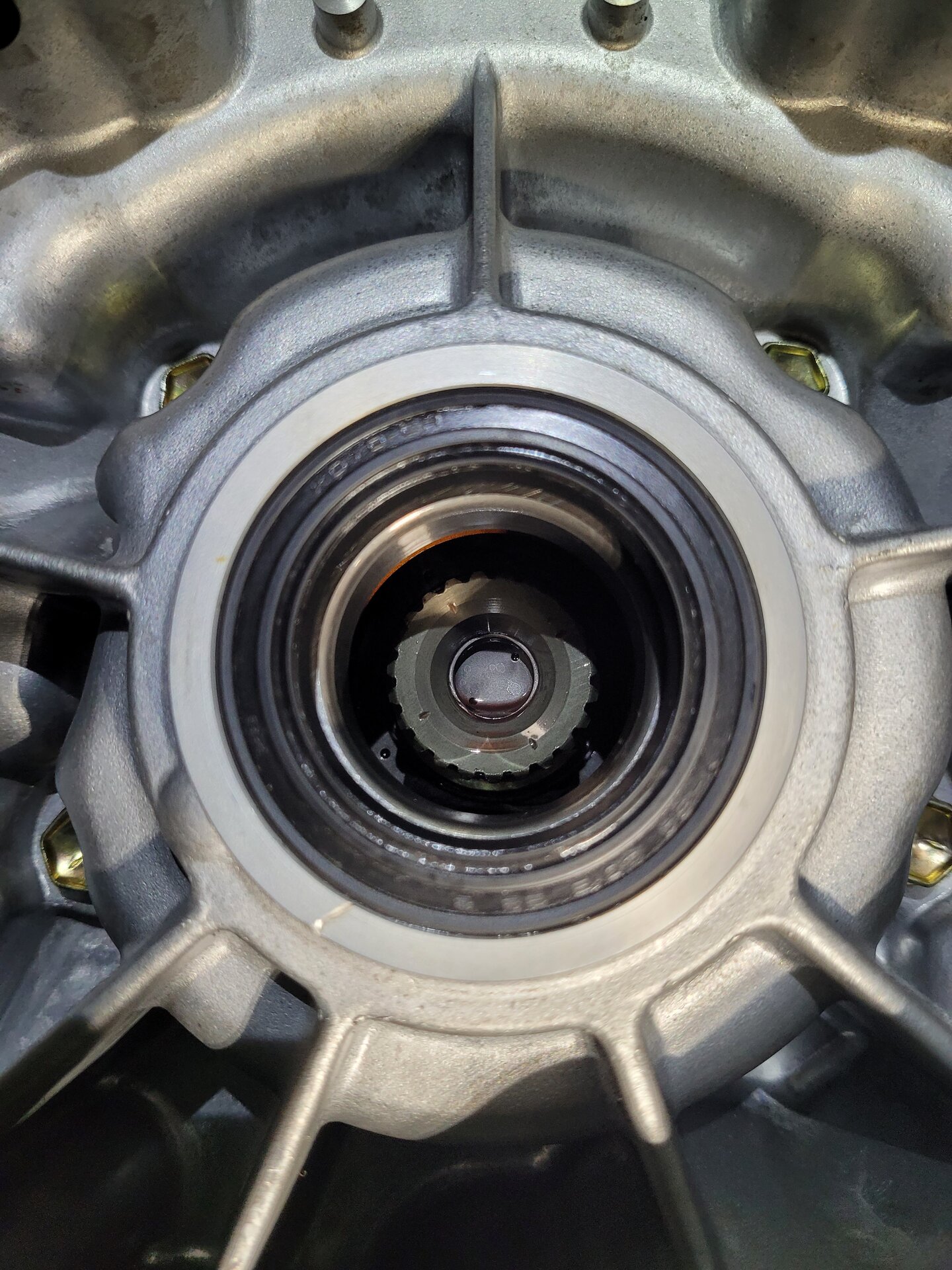

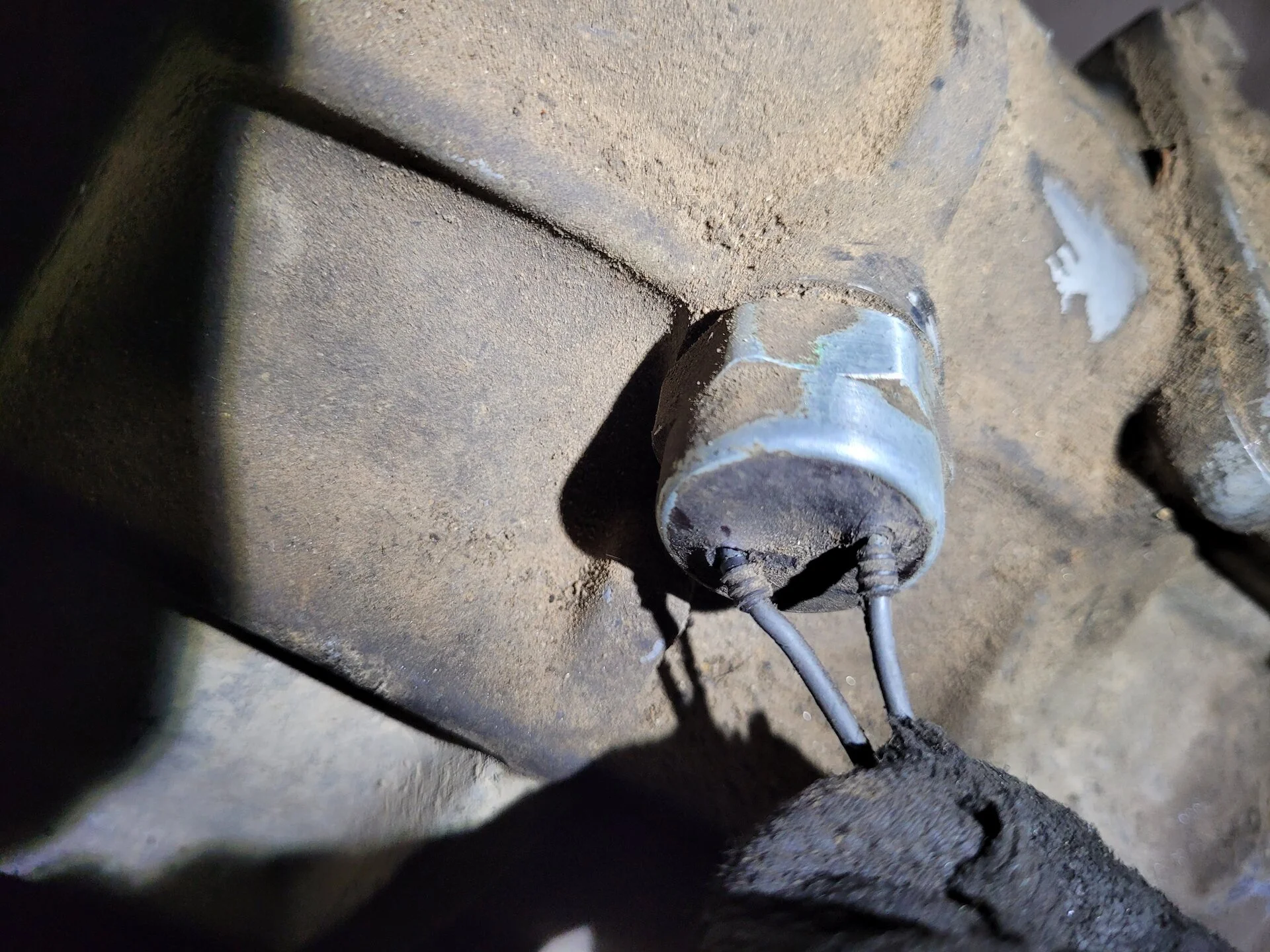

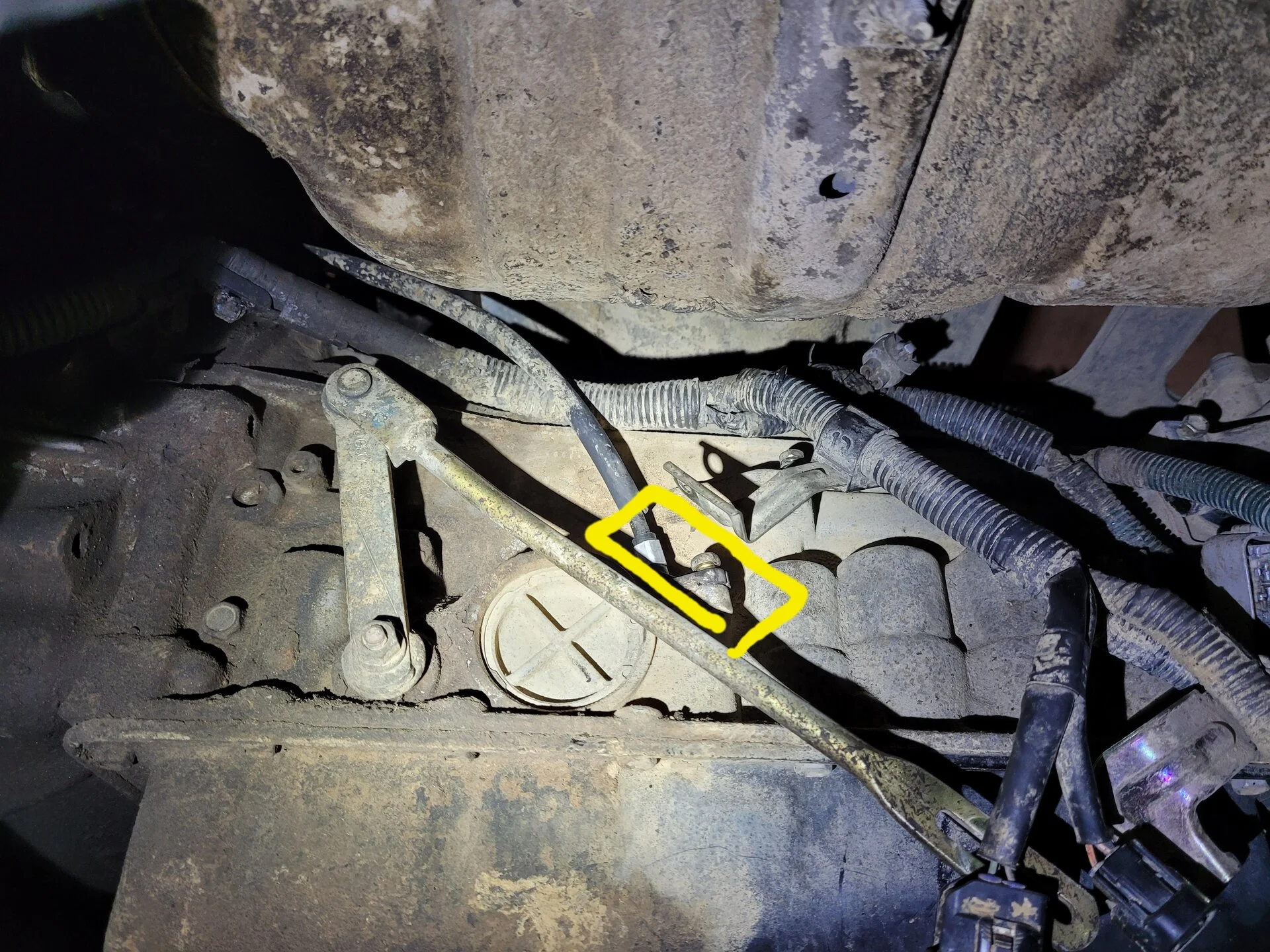

Cool. I have the tools. Almost got the transmission pulled. Accidentally may have pulled the wires out by a millimeter when removing the t-case. Does it look like it's at the point where it needs replacing? If necessary I'd want to replace it now while it's out rather than later

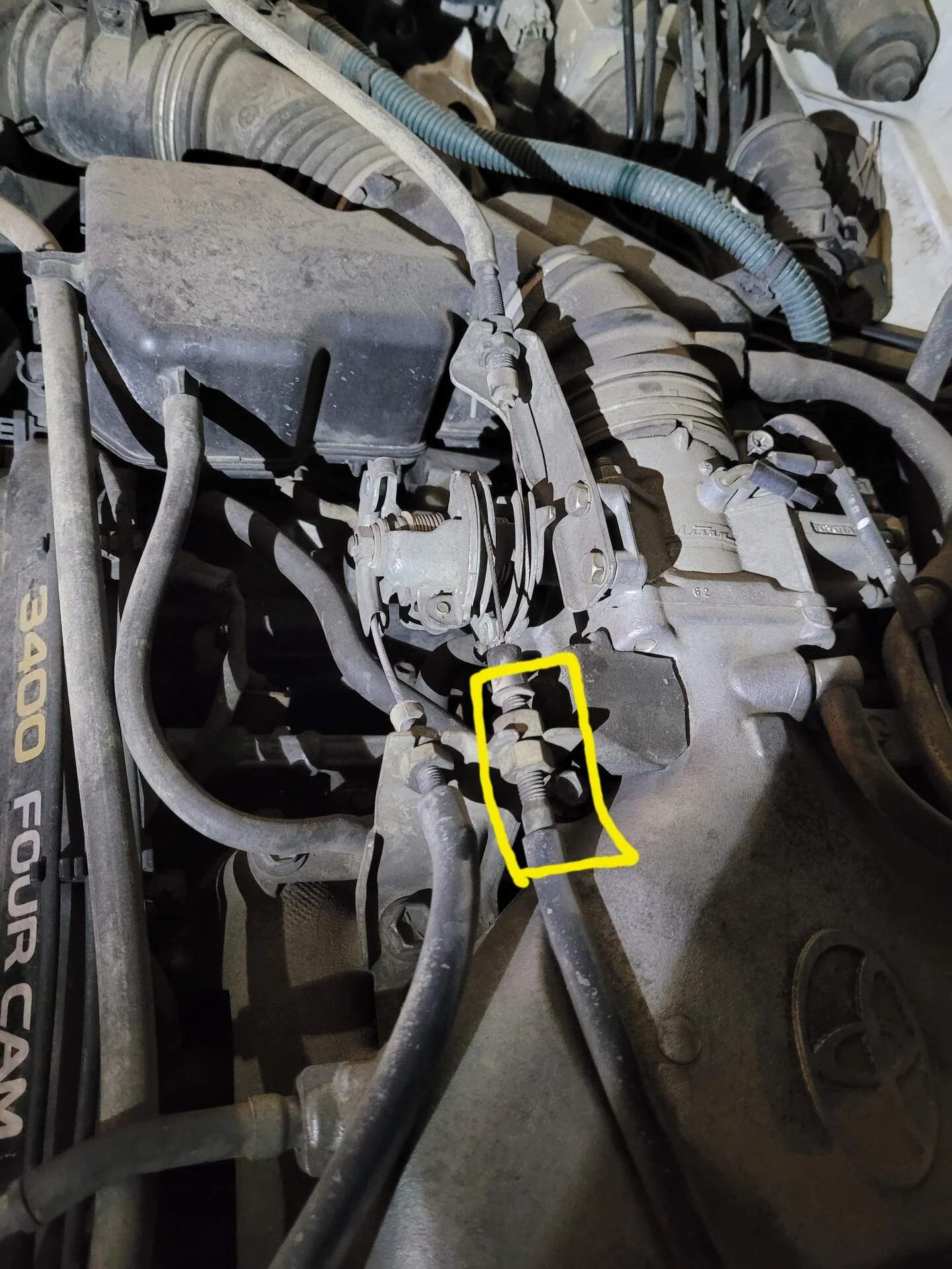

Also, the cable from the transmission to the throttle. Kick down cable? Not sure what its for but I didn't see it in the youtube video. I'm assuming the easiest way is to disconnect it is from the throttle rather than the transmission itself?
T-case to transmission input seal

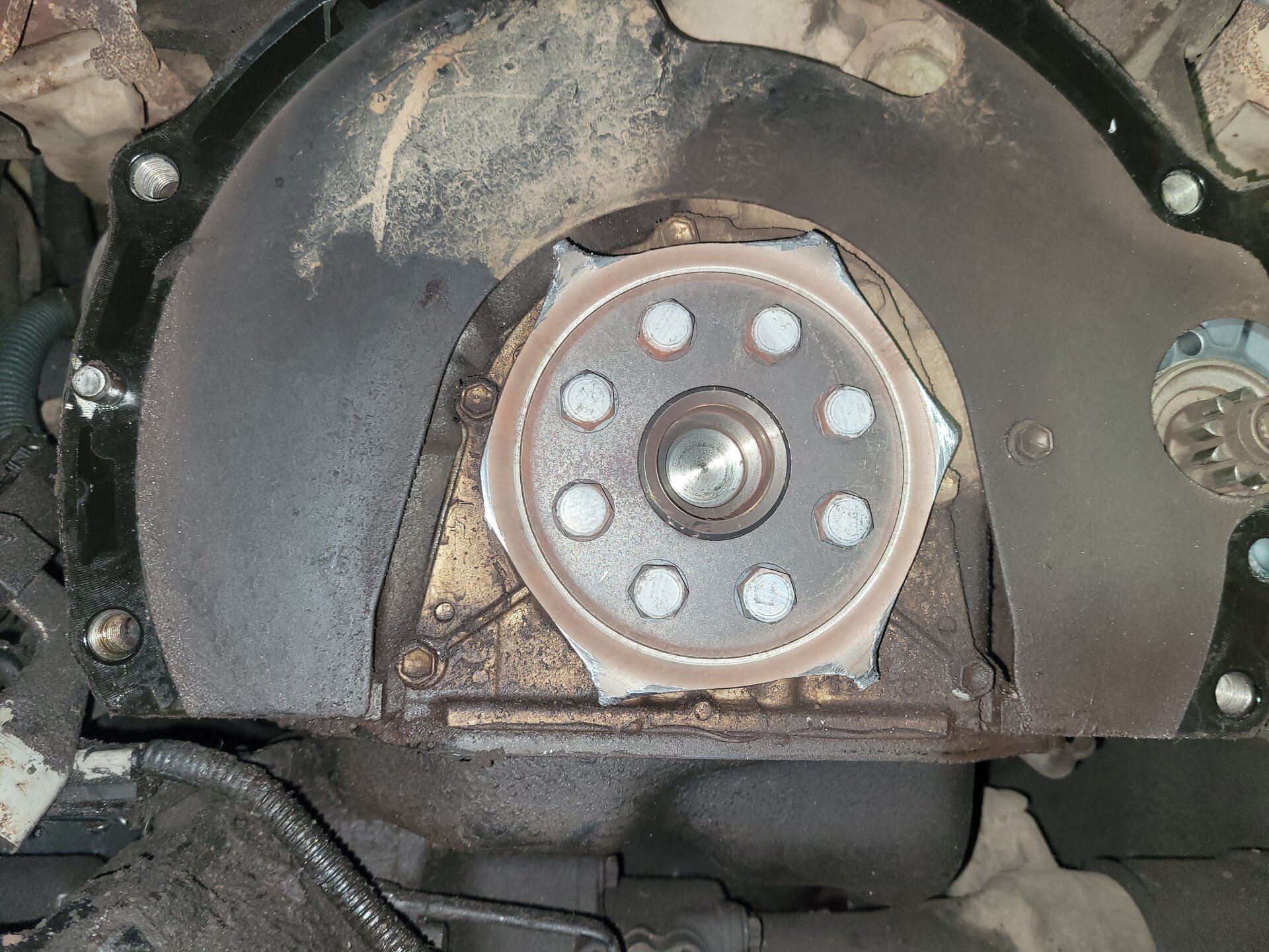

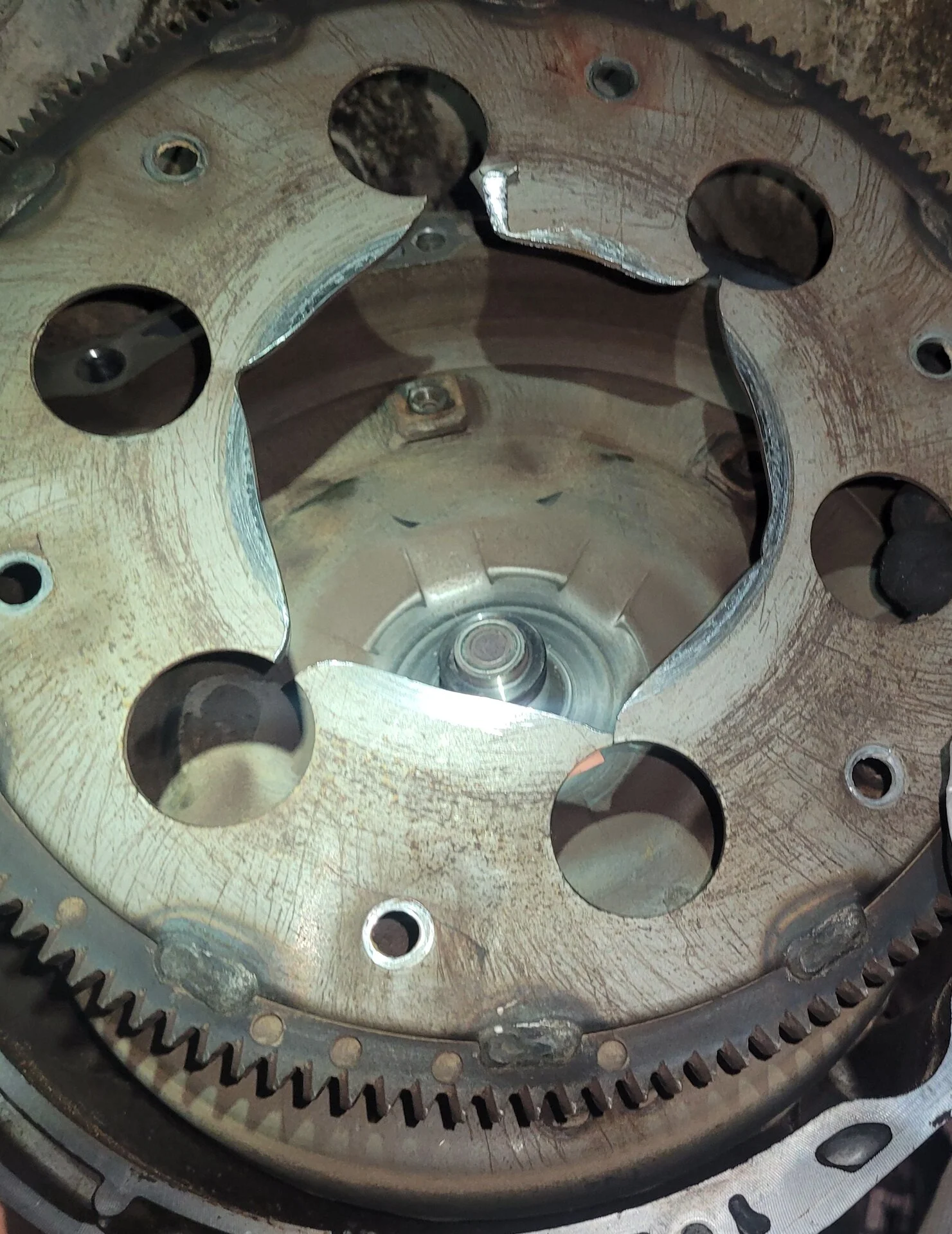

The bolts that holds the flex plate to the crankshaft and a little loctite should be good.

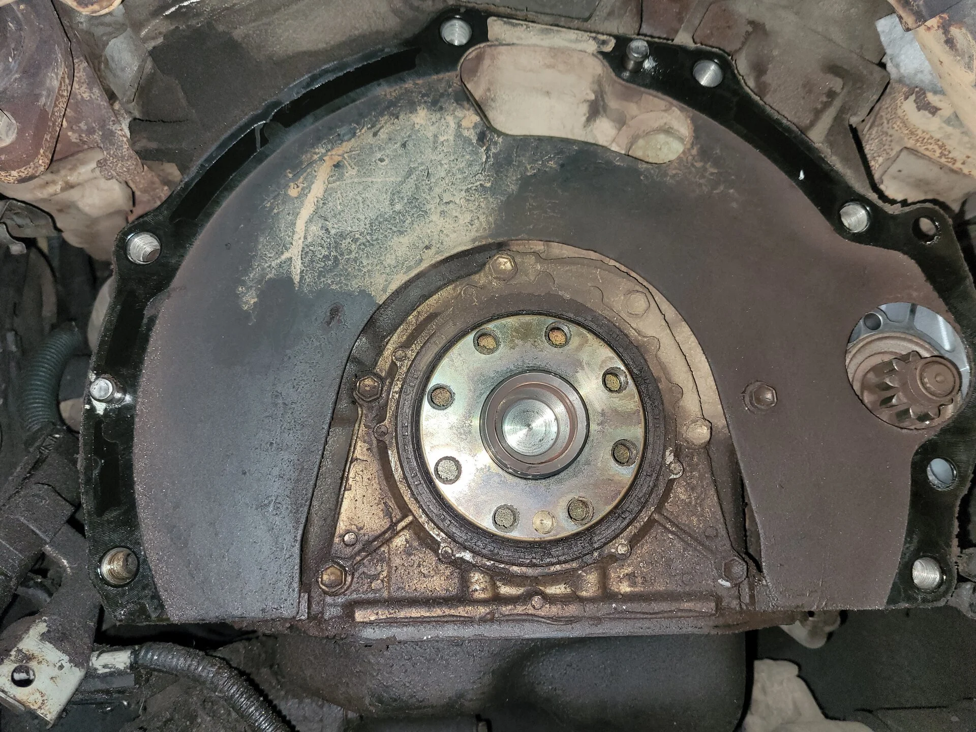

Yeah I removed the flex plate now. Noticed the bolts that hold the flex plate to the crankshaft go back in only a thread or two and then stop. I assume that means they're torque to yield. The ones that hold the flex plate to the transmission are not like that.
I just looked up the torque specs. for the flex plate, it is not a TTY bolts and torque is 55 ft/lbs while the M/T flywheel is a TTY and a two stage torque process.

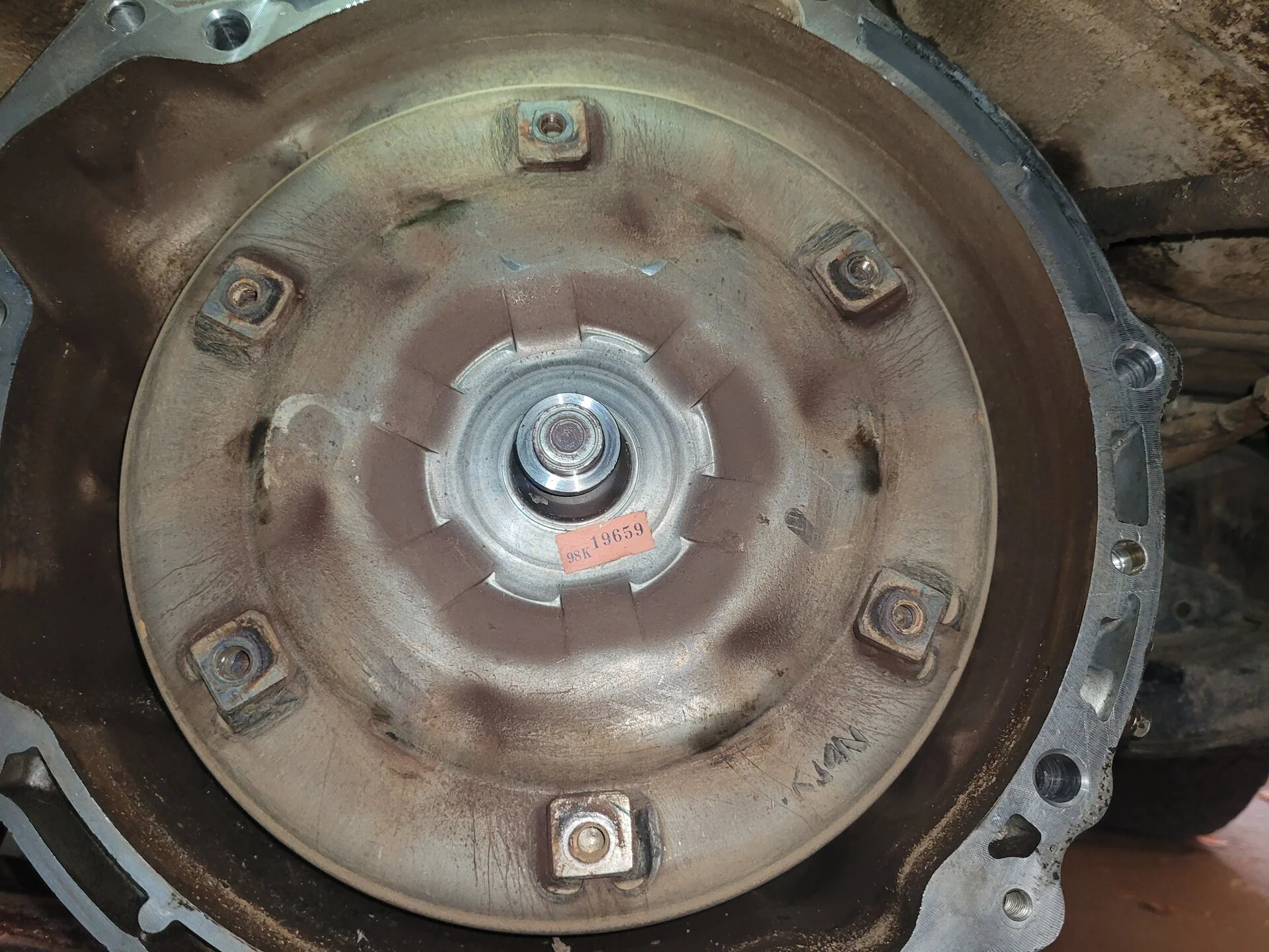

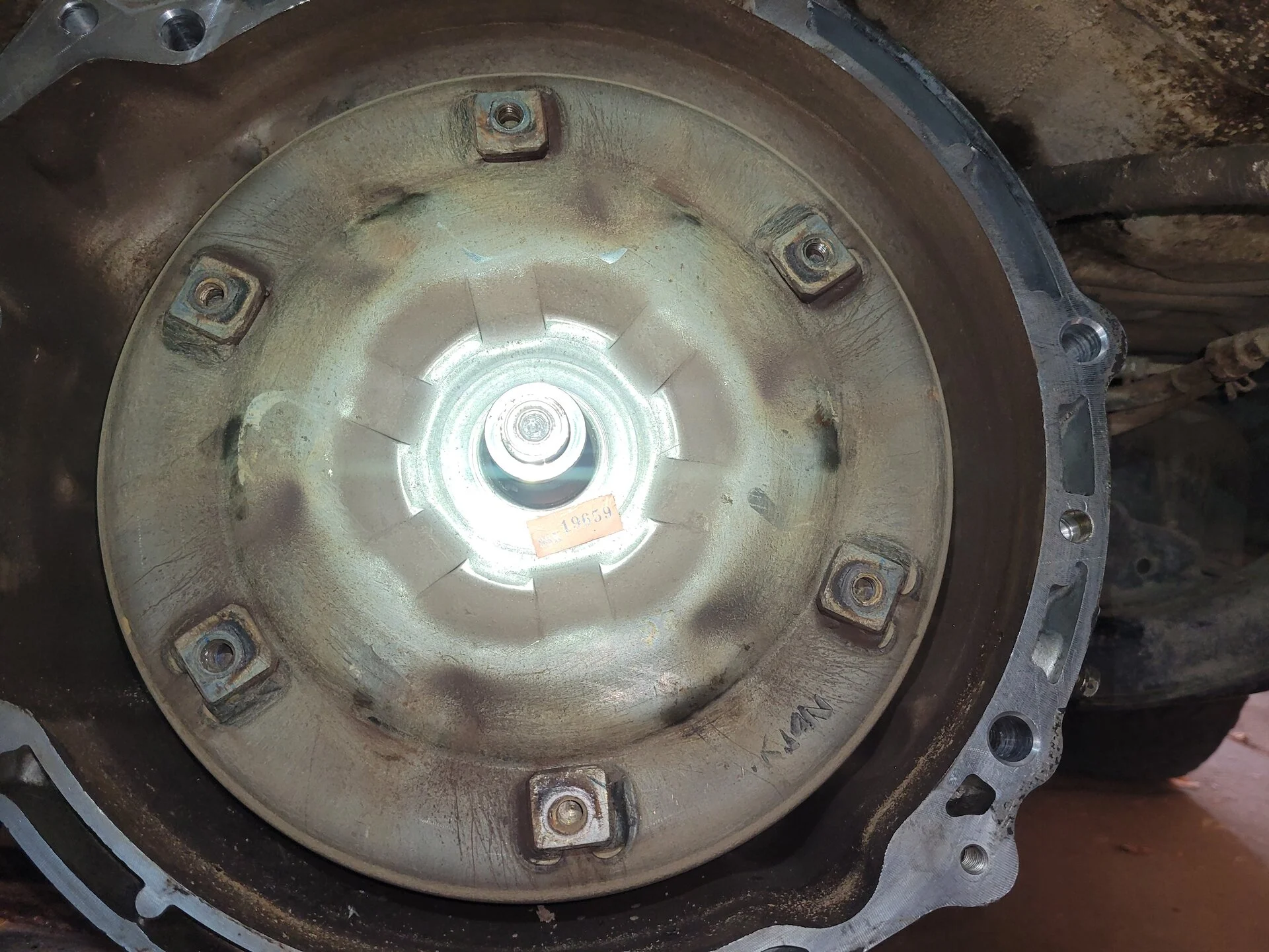

Is there any reason to remove the torque converter for inspection or anything like that?
Or does it look OK to keep the torque converter in place and proceed with installing new flex plate?
I noticed a red dust on the torque converter and some dirt in the bell housing.
Flex plate replacement checklist:
Replace:
- Flex plate
- Flex plate bolts
- rear main seal
- transmission rear input shaft seal
Inspect:
- torque converter
- transmission front pump

What else do you need ? I work for a fleet so we have access to factory specs. Do not remove torque converter make sure to push it all the way back towards bell housing.
