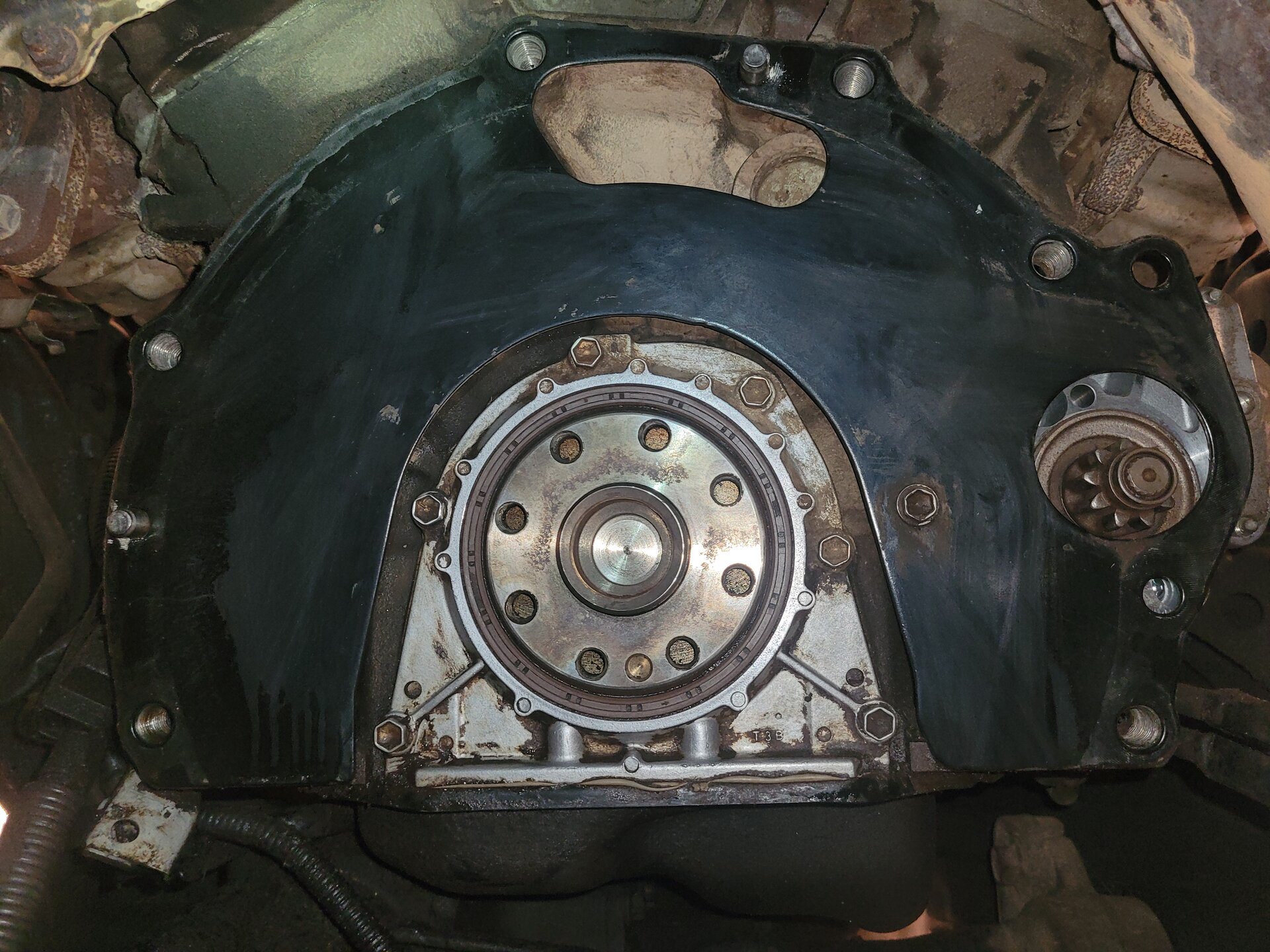

Hello community - Welcome post. I also need to fix a fully broken flexplate.

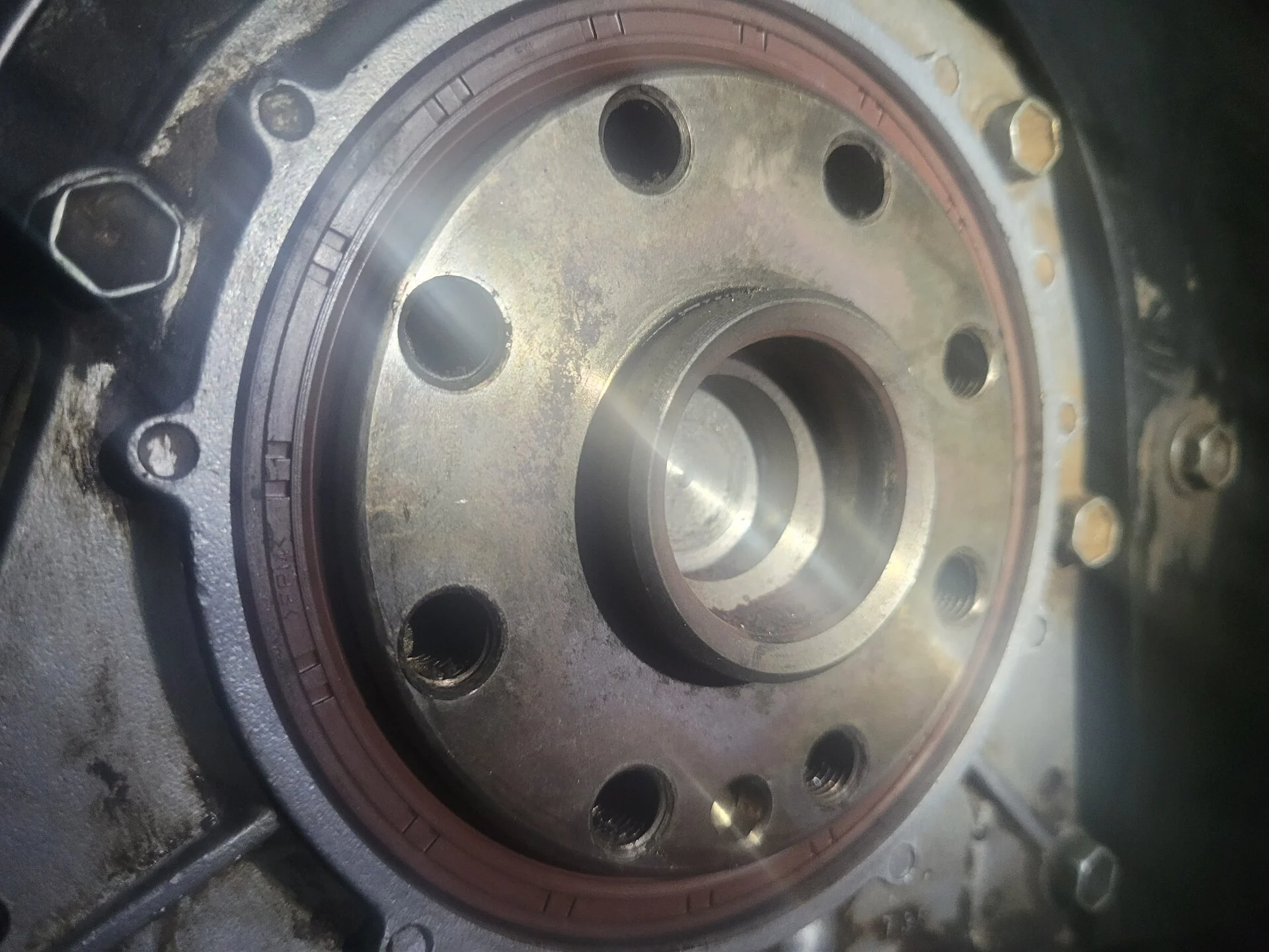

Did I press the new real main seal in too far? I hope not.
Pic 1 is old seal
Pic 2 and 3 are the new one.
Is it bad there's so much dirt/mud on the engine / transmission? / could that be a reason why the flexplate failed?
It's most likely stress cracks and metal fatigue.

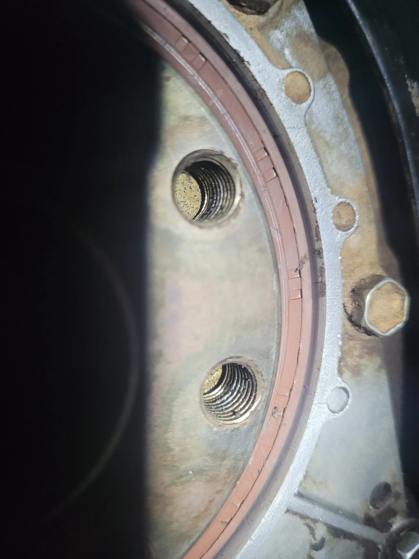

Rear main seal went in too far. Removed it and ordering a new one to reinstall.
Used the wood-screw and wrench-pull method and it looks like the screw contacted the crank surface.

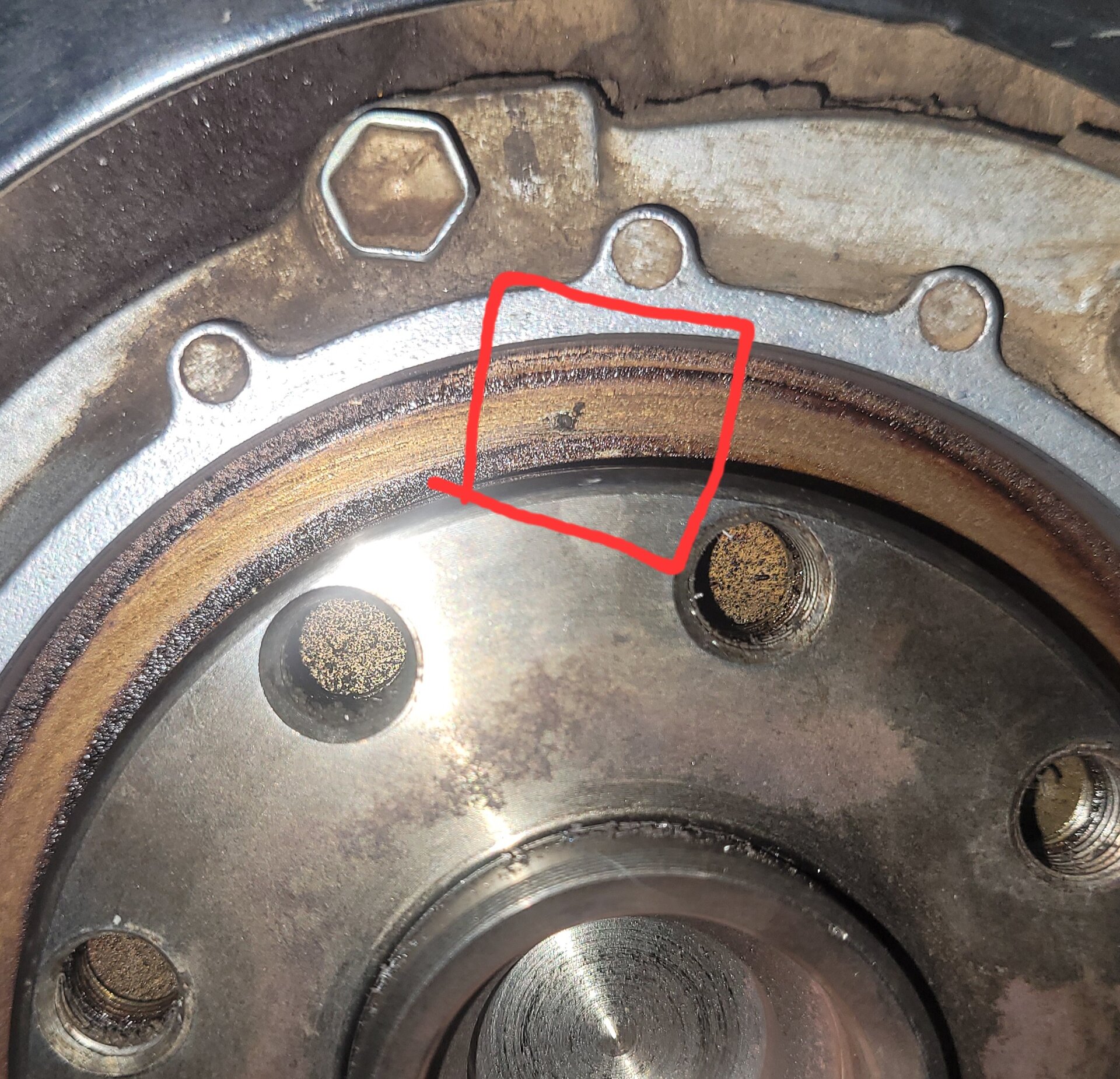

@vipergrhd @splitshot Does this look like something that needs resurfacing before installing new seal? Or is it fine to proceed with install? Please advise. I might hire a mechanic at this point.
You worry too much, even if the seal did go past the original spot it isn't going very far. I would just remove the nick from that since it's not a contact point for the seal make sure to clean the crank surface and apply a small amount of grease on the lip to ease the install. Use the old seal as a driver and tap it in slowly.
Clean the bolt holes and loctite them.

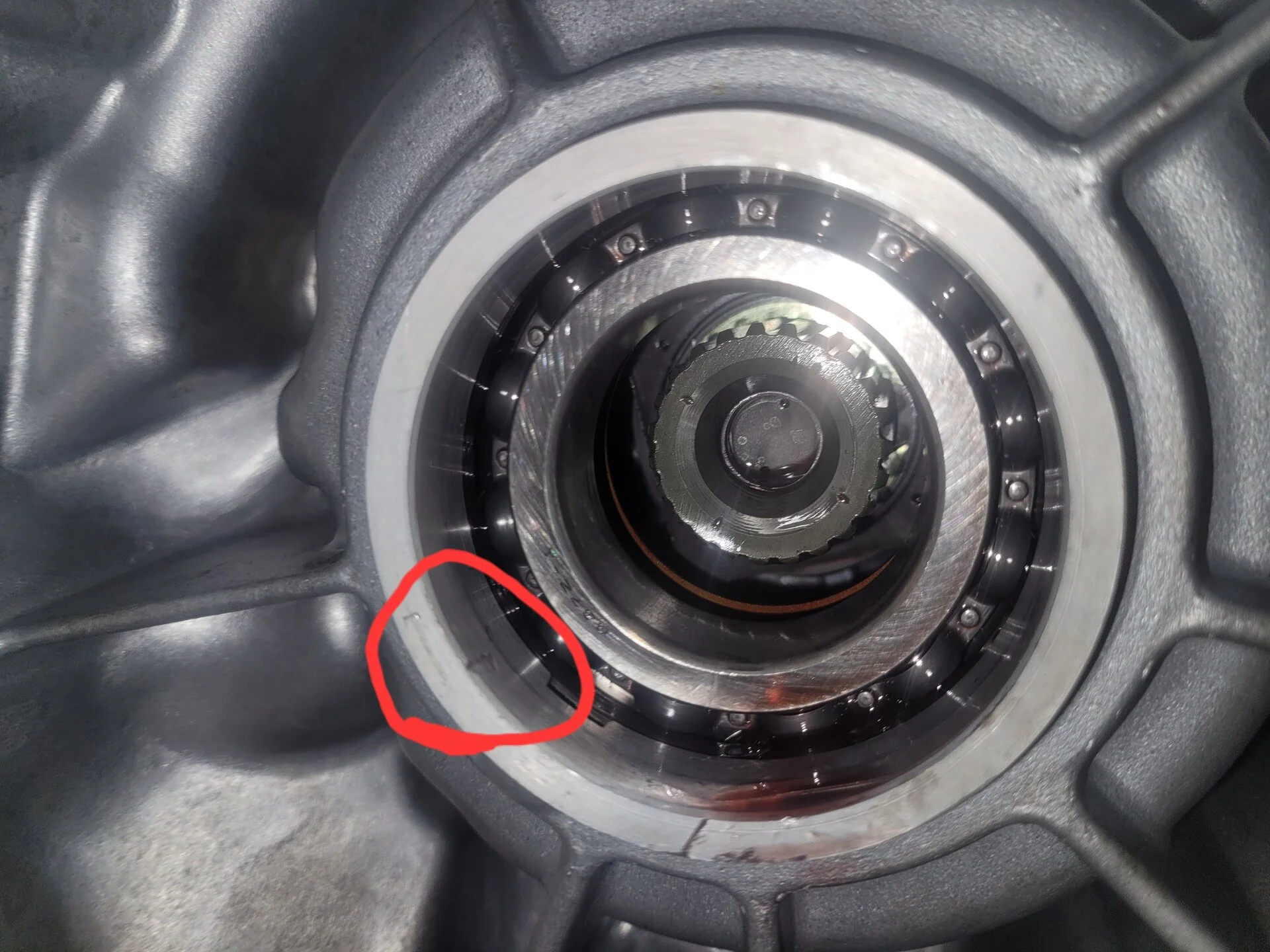

Thanks. I actually removed the seal but may have scratched the housing. Is this big enough to leak? If so, anything I should do to fix it
