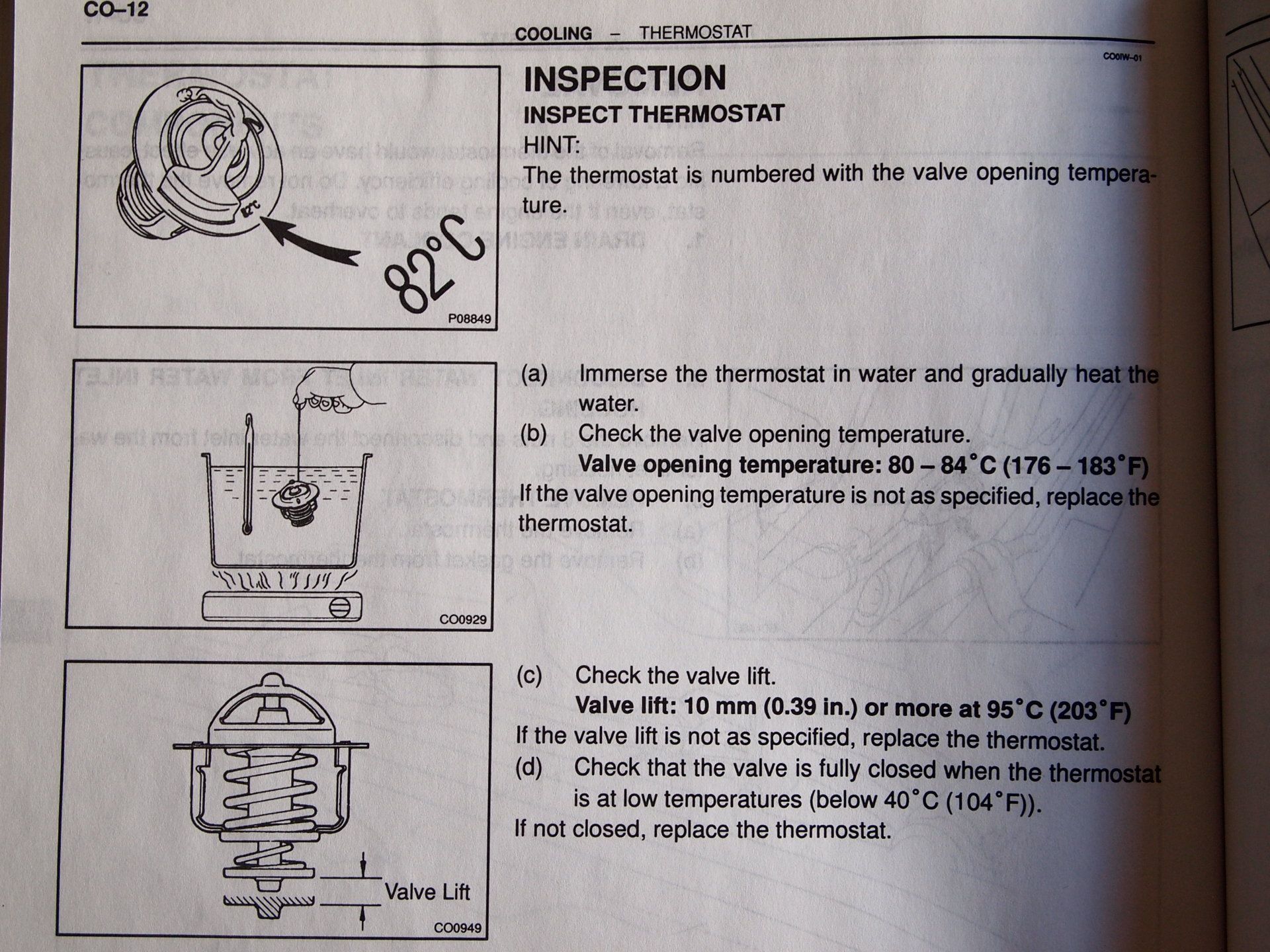

If you've top coolant at radiator and reservoir 5 time after a full cool down (8 hours) and still it keeps needing more coolant, you've likely a leak. But there is situation where air doesn't properly bleed out (burp) and you may just be getting a little more air out each time.
  1. The most common is a thermostat installed wrong. Thermostat has a jiggle valve, which must be oriented up (at top). Very easy to pull and take a look.
  2. Air bubble in heater core is one we've cover.
  3. Something plugging heater core or a line could also trap air or just not allow coolant flow. Back flushing can be revealing!
These may help:
