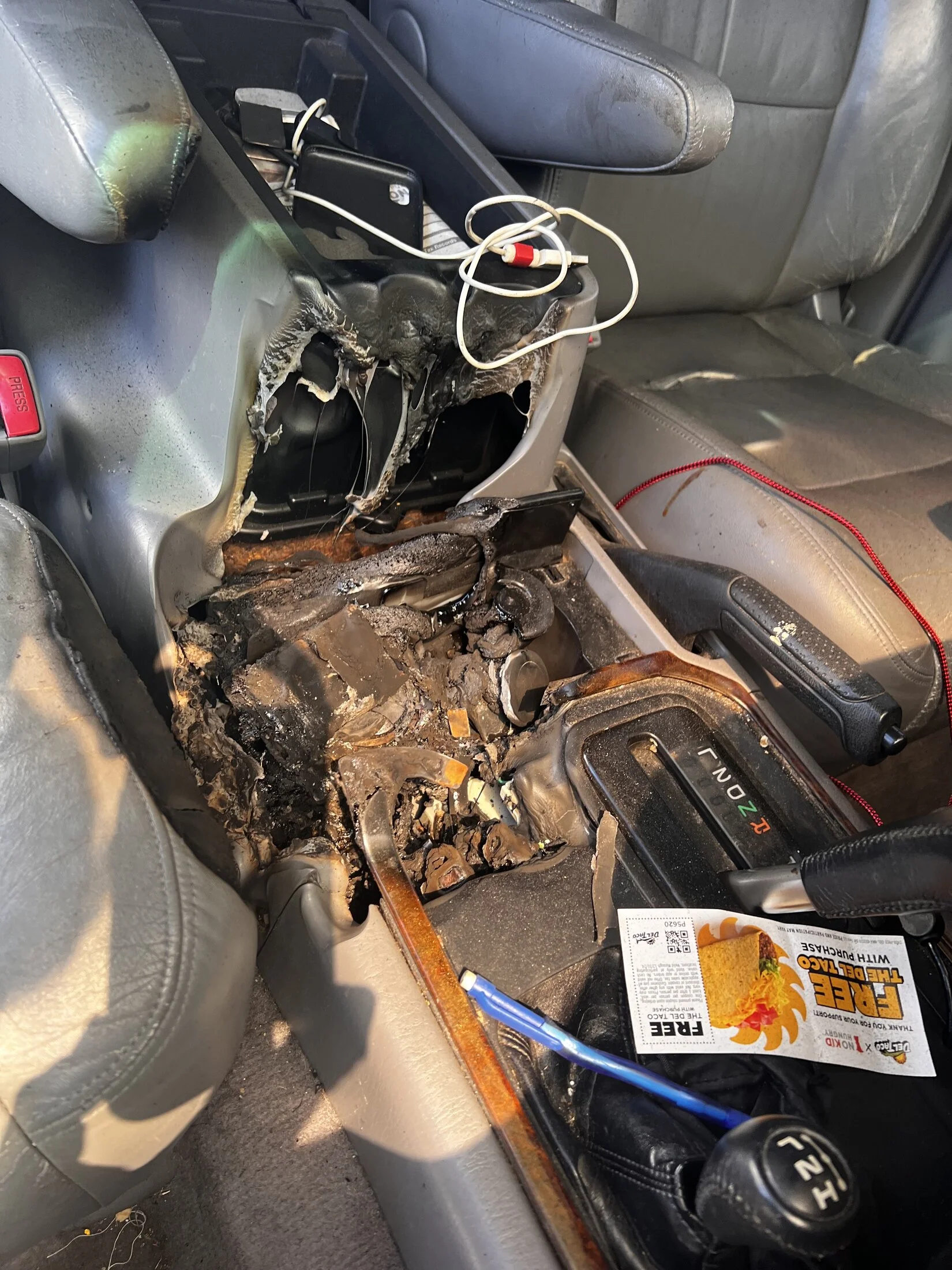

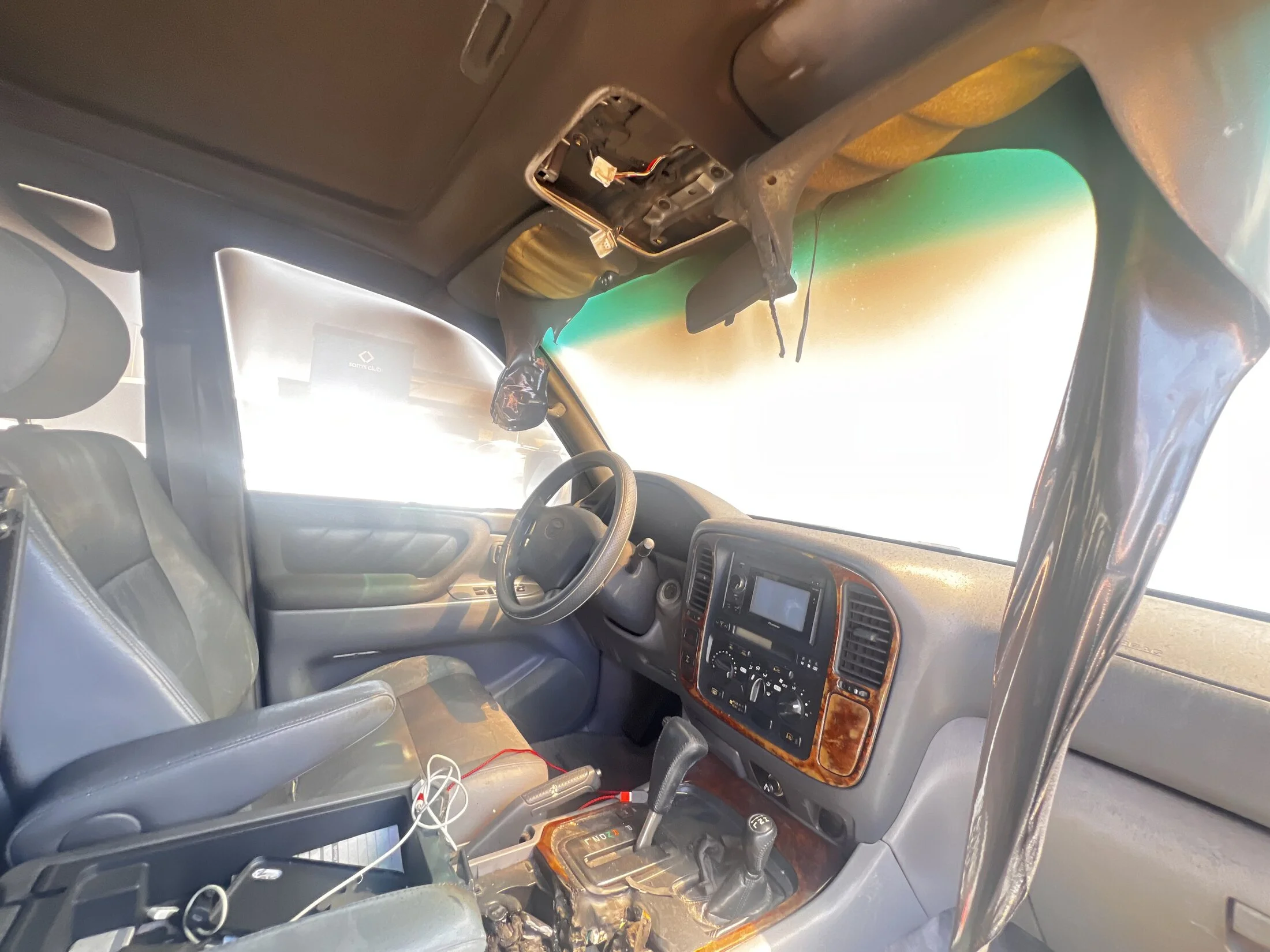

Yesterday, while I was at Sam’s Club, this portable phone battery caught fire while sitting in the cupholders (not plugged in or being used). I was greeted with a face full of smoke and a heart full of panic when I first opened the door. It burned its self out (thank God).
Not sure what I’m going to do yet, but if I keep the 100, I’ll tear apart the dash and replace the servo while I replace much of the interior from smoke damage. Mechanically it’s solid, so it may be worth repairing it.
Also, not sure how my coupon to Del Taco survived but the visors melted! 🤪

I’ve had many batteries swell in the past. Never an issue after that. I’m not going to risk it after this. This battery was not swollen - no indication something was bad, other than being recalled. I completed all the refund info on the recall early that morning! Like I said early it was not plugged in nor was it being used. It just spontaneously caught fire. Thank God my windows were closed and I was not driving.
If my windows were even slightly opened it’s likely the whole vehicle would have gone up in smoke.
If I was driving I would have major burns.
Of all the places and times for this to happen, it was perfect. No one was hurt and the fire didn’t spread.
