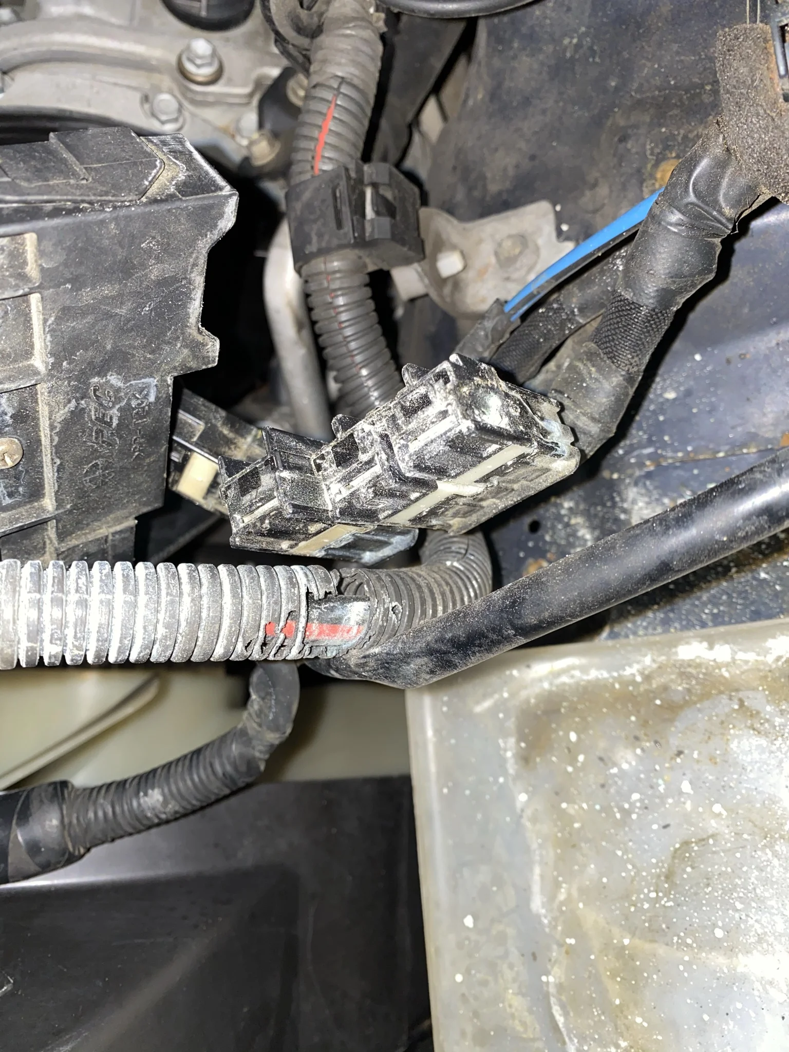

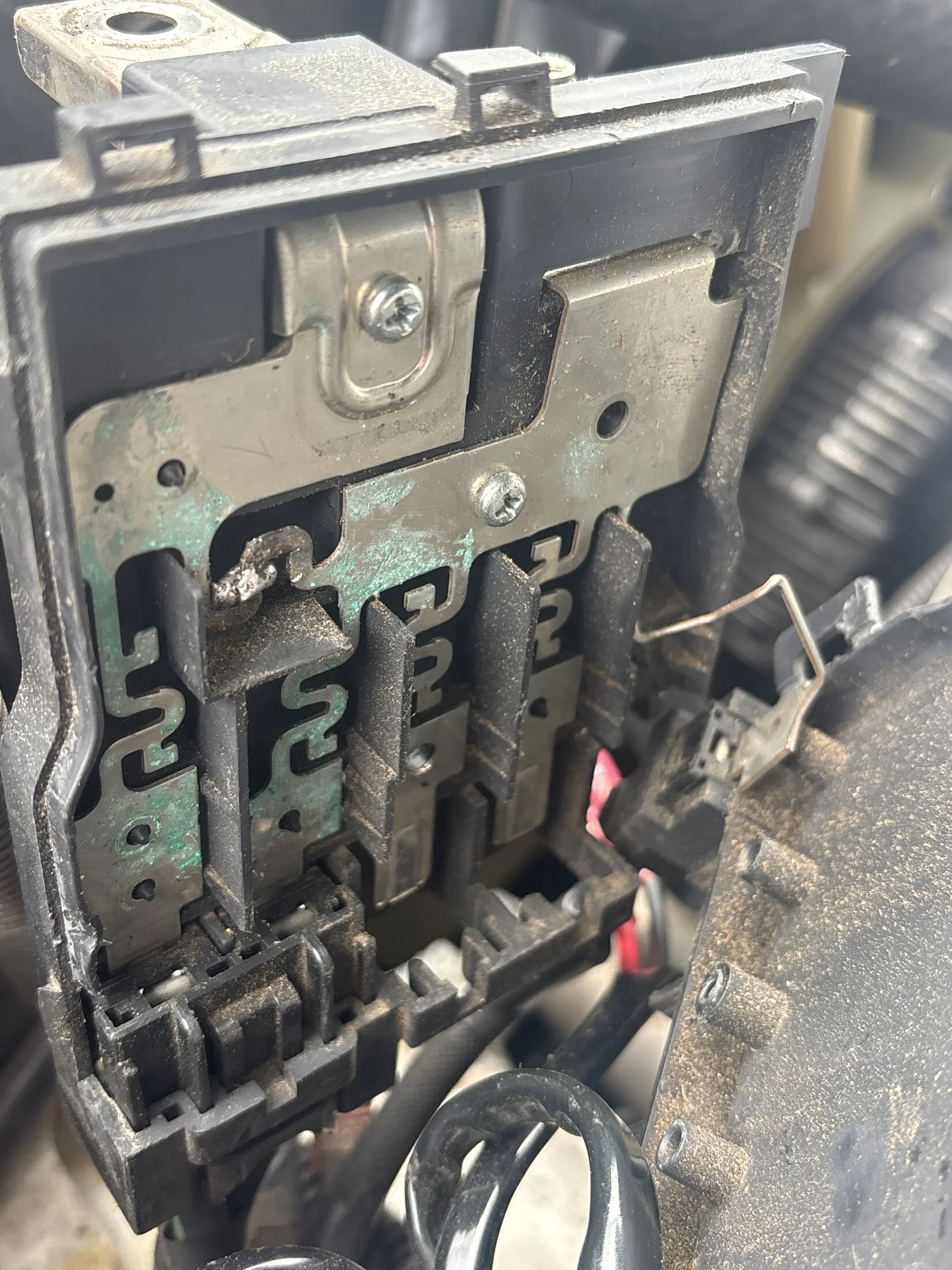

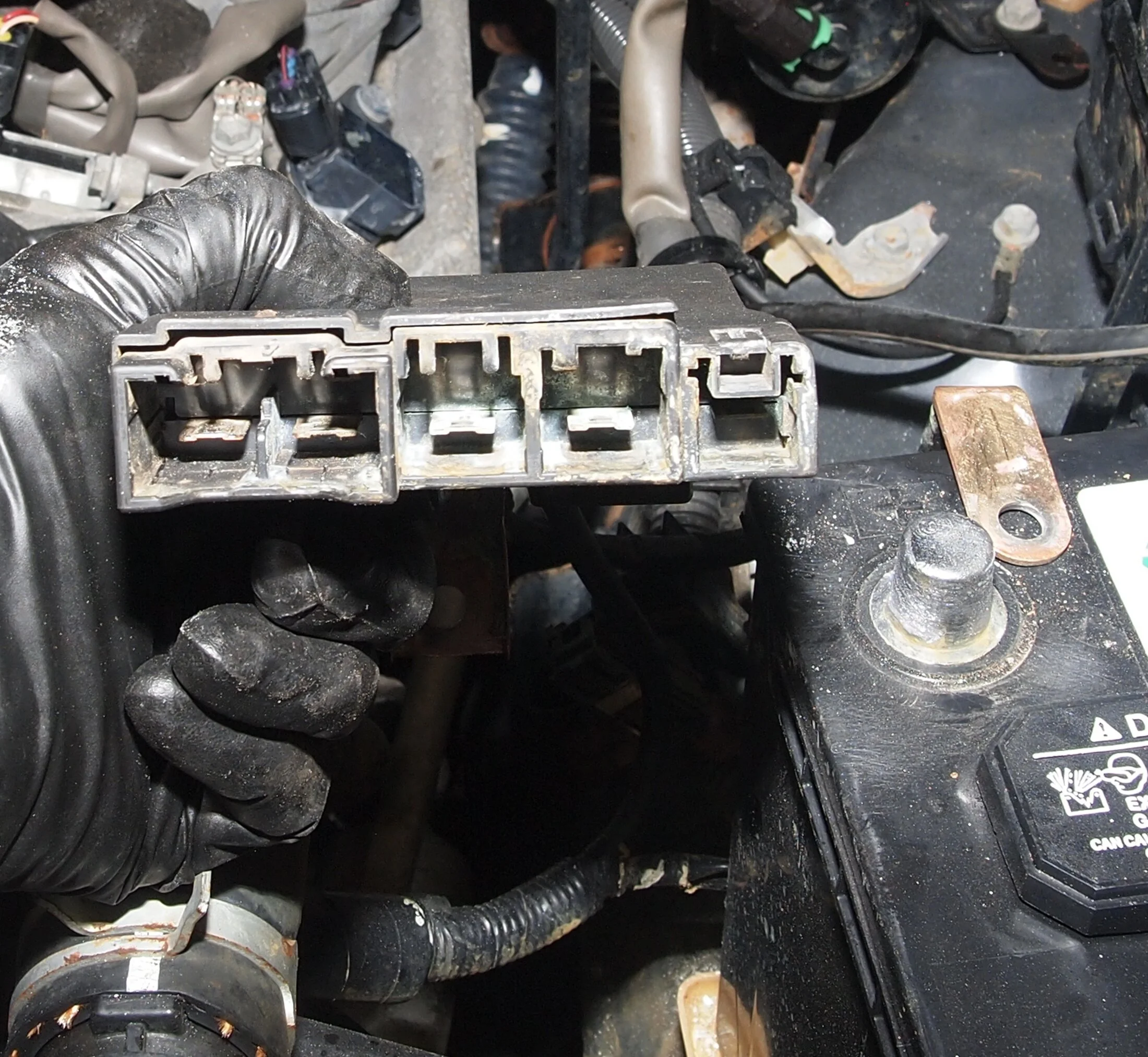

If alternator, the battery would "likely" be dead. Which then you'd not be able to start or run engine for long. Be sure to check wires to a from it. Look for rodent chew marks on wiring. Also check wires at battery fusible link. The fusible link (Rectangular box hang off positive battery pos) has 4 or 5 wire housing block plugs into bottom of it. Follow wires and check all. You may also want to unplug those at bottom of fusible link, and check for oxidation (acid) in plugs. Check wire under rear near rear frame crossmember on both sides.

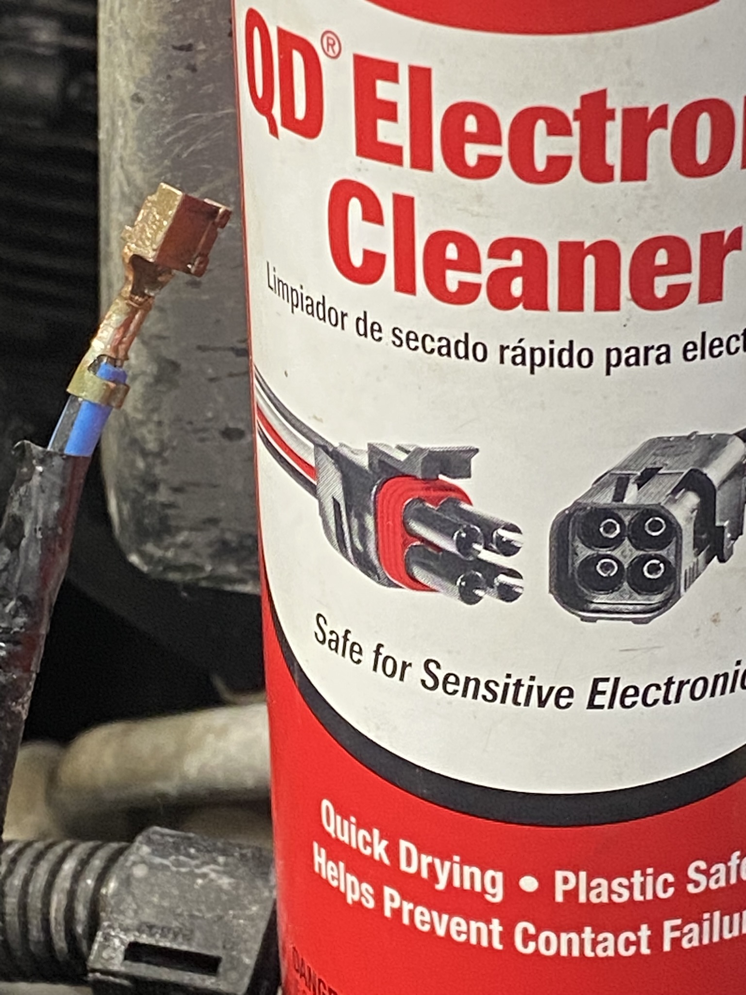

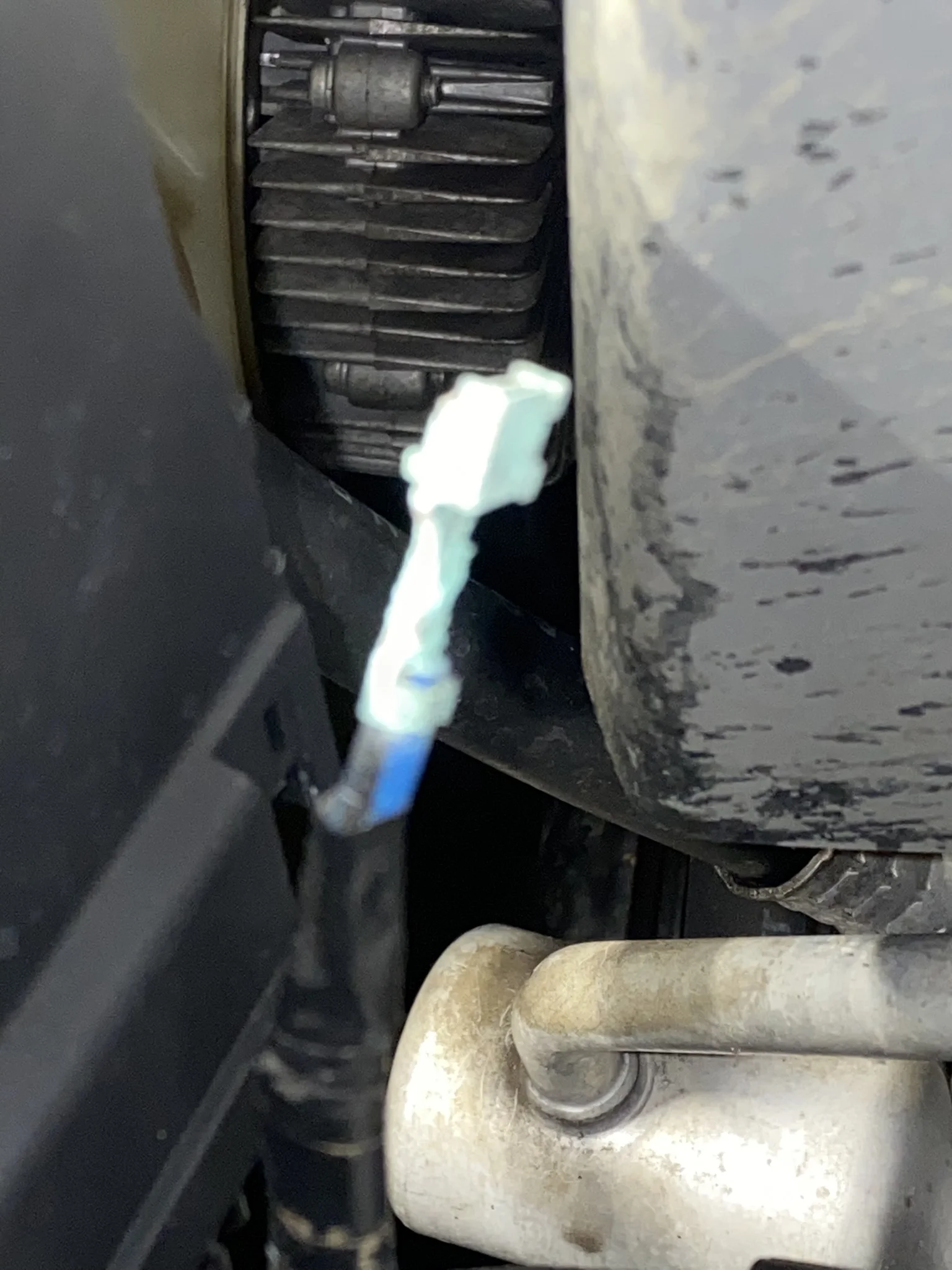

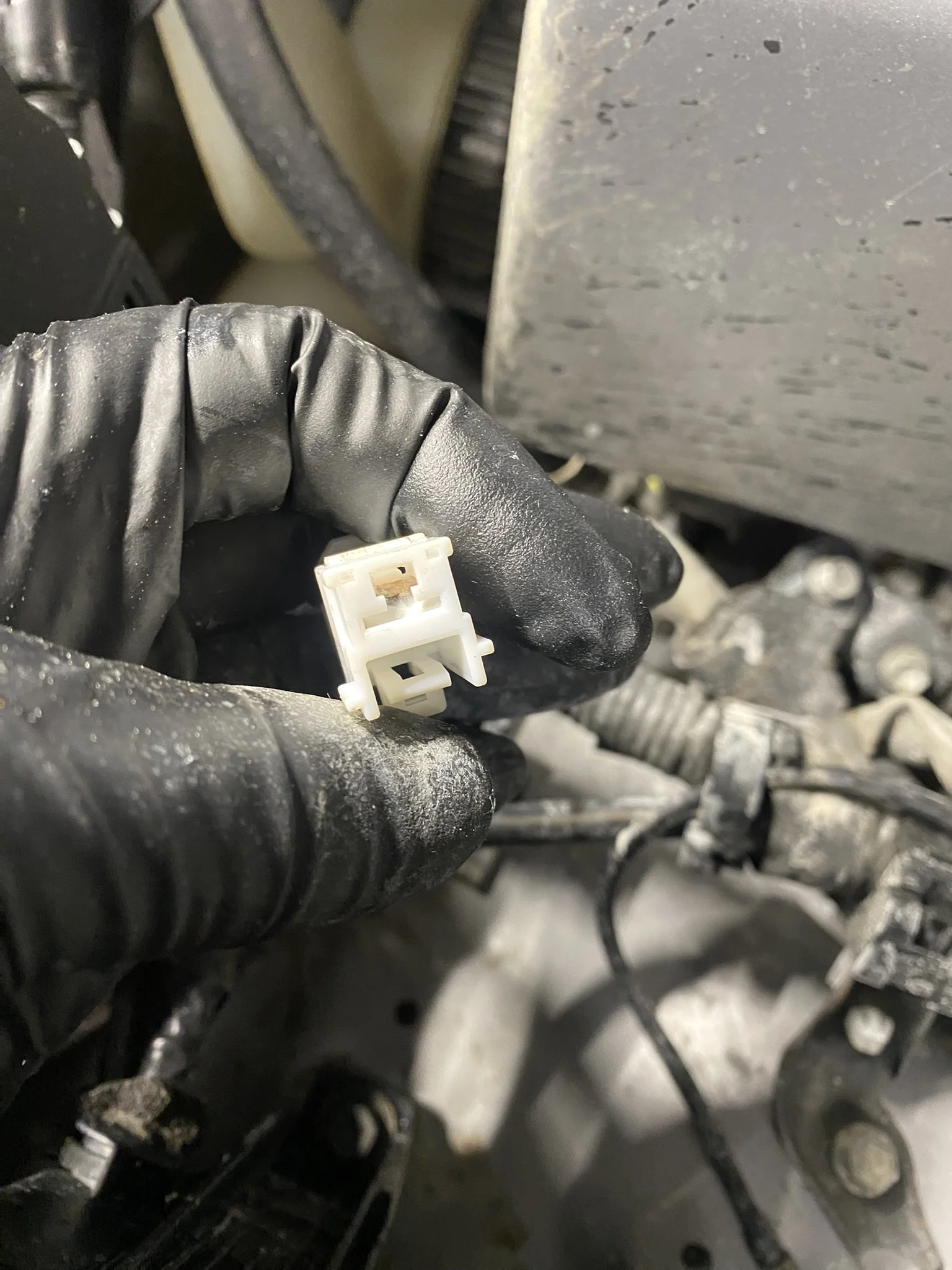

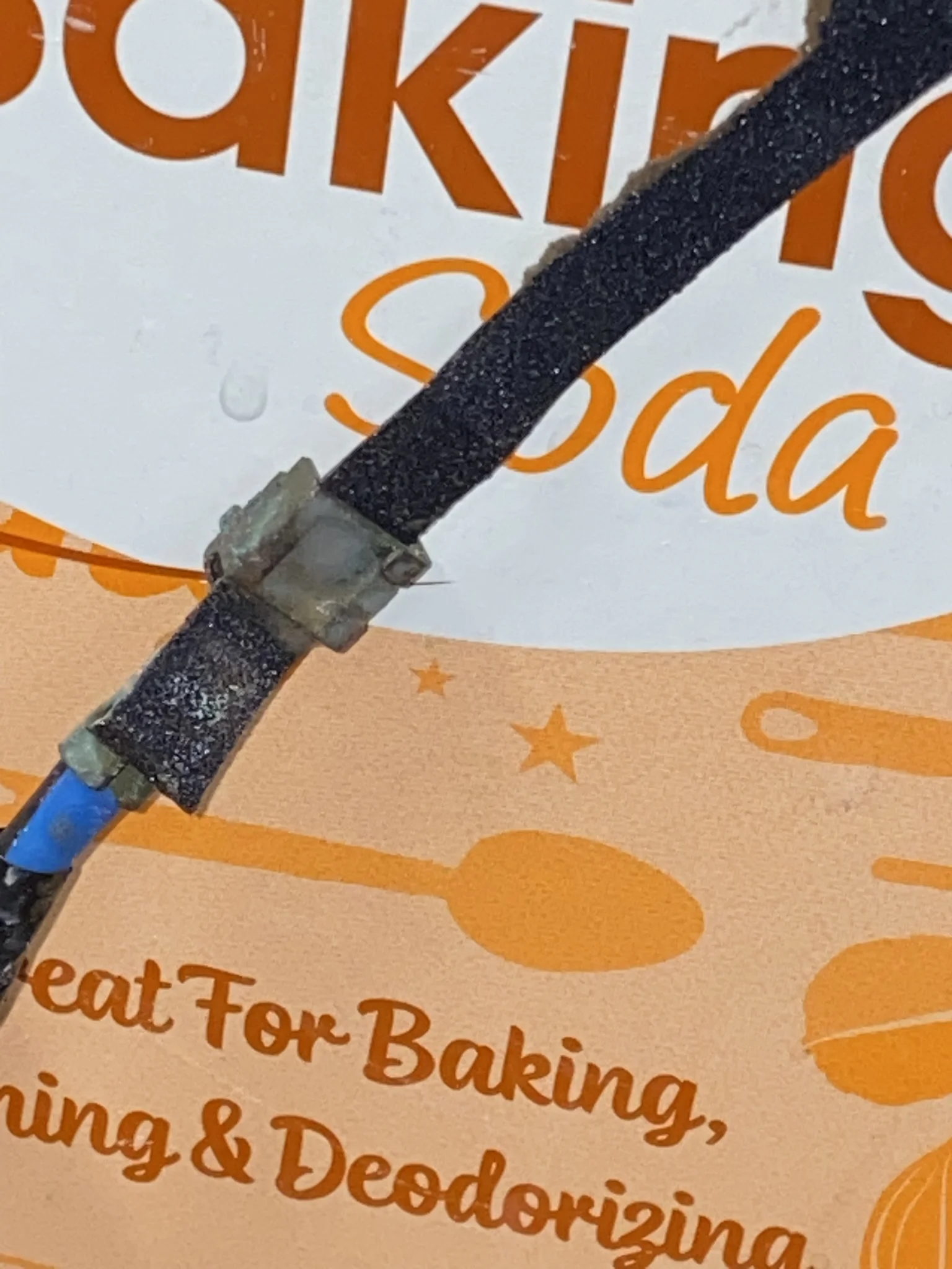

I’ve taken it apart and do not see an issue. A while back I had to solder 1 of the pieces back together but was 10k miles ago and it is holding

You'll likely find some of the wire housing blocks, with acid corrosion also. If so, I'd carefully unpin their wire lead connector, from the wire hosung block and clean up. I like having new wire housing blocks on hand, when I can. Since these may break.

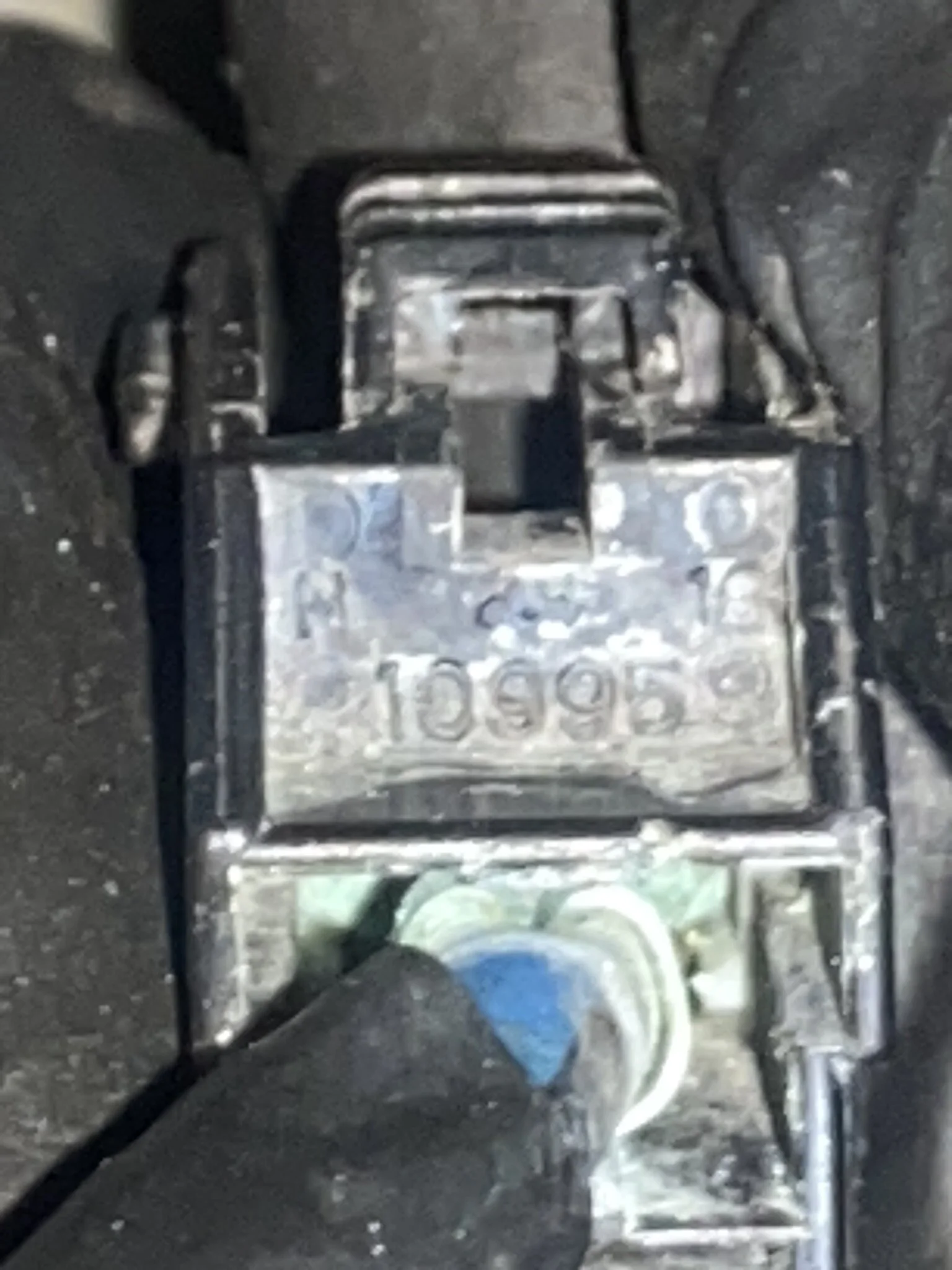

Tip: All wire housing block have the last (Sufix) of part number on them. Just add (prefix) 90980-****** to number you get off them.
90980-10995

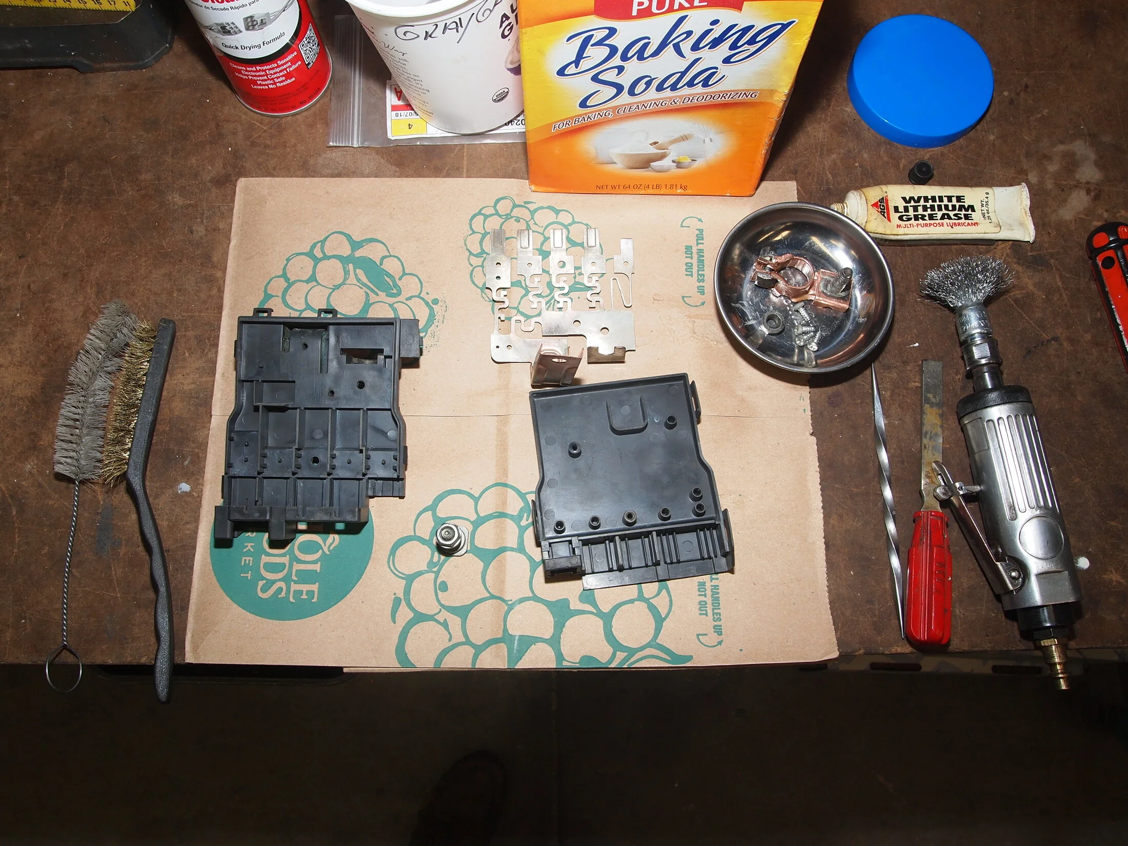

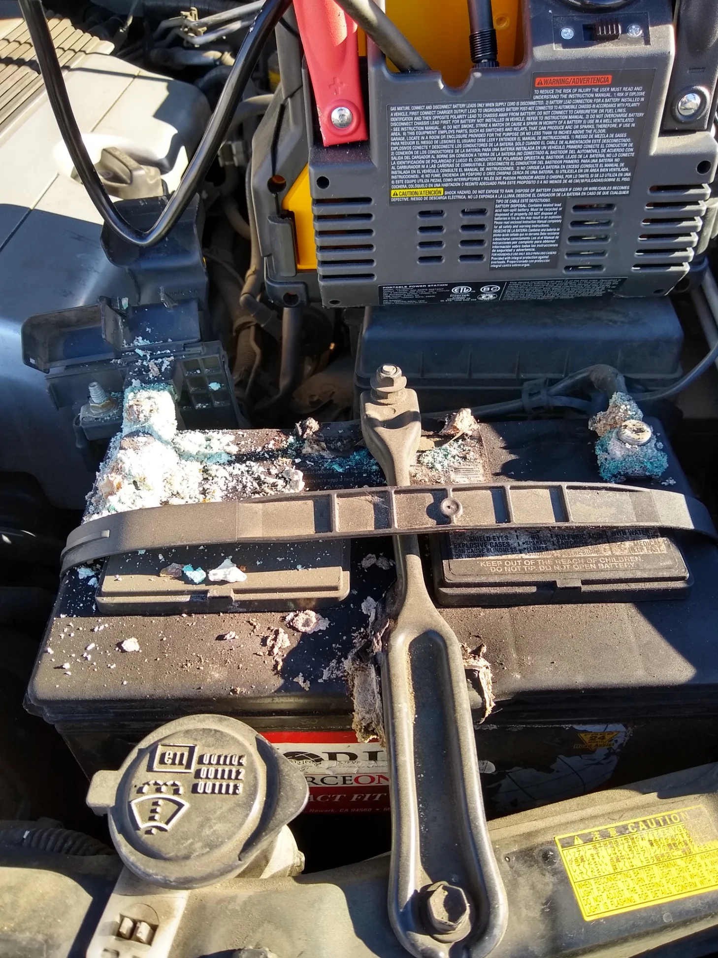

Make very sure, your clean area with a solution of baking soda and water, first. To neutralize the acid. It is the acid, not being kept a bay annually with baking soda. That is the root cause of fusible link issues. If not a break in fusible link. Clean up/out all acid (blue & white). From fusible link and the wire lead connectors, from plug attached in bottom end.
Which may or may not be your issue. but it is a good starting point.

A comment on your fusible link solder repair. Solder repairs are brittle, they do not like vibration. The solder repair may look ok, however an oxdied crack has formed. I suggest if you can...reflow the solder on the fusible link. Or try to jump the two sections temporarily as a root cause check.
Two alligator clips and a piece of wire to jump it
You guys were all over it! Mechanic tested the alternator and it was not working. But before jumping the gun he started testing several other things. Ended up being the fusible link. More specific it was my home soldering job did have a small crack that caused the issues. We were not able to source the OEM part but a temp soldering job by the mechanic will get me home today. Will get the correct replacement installs asap.
