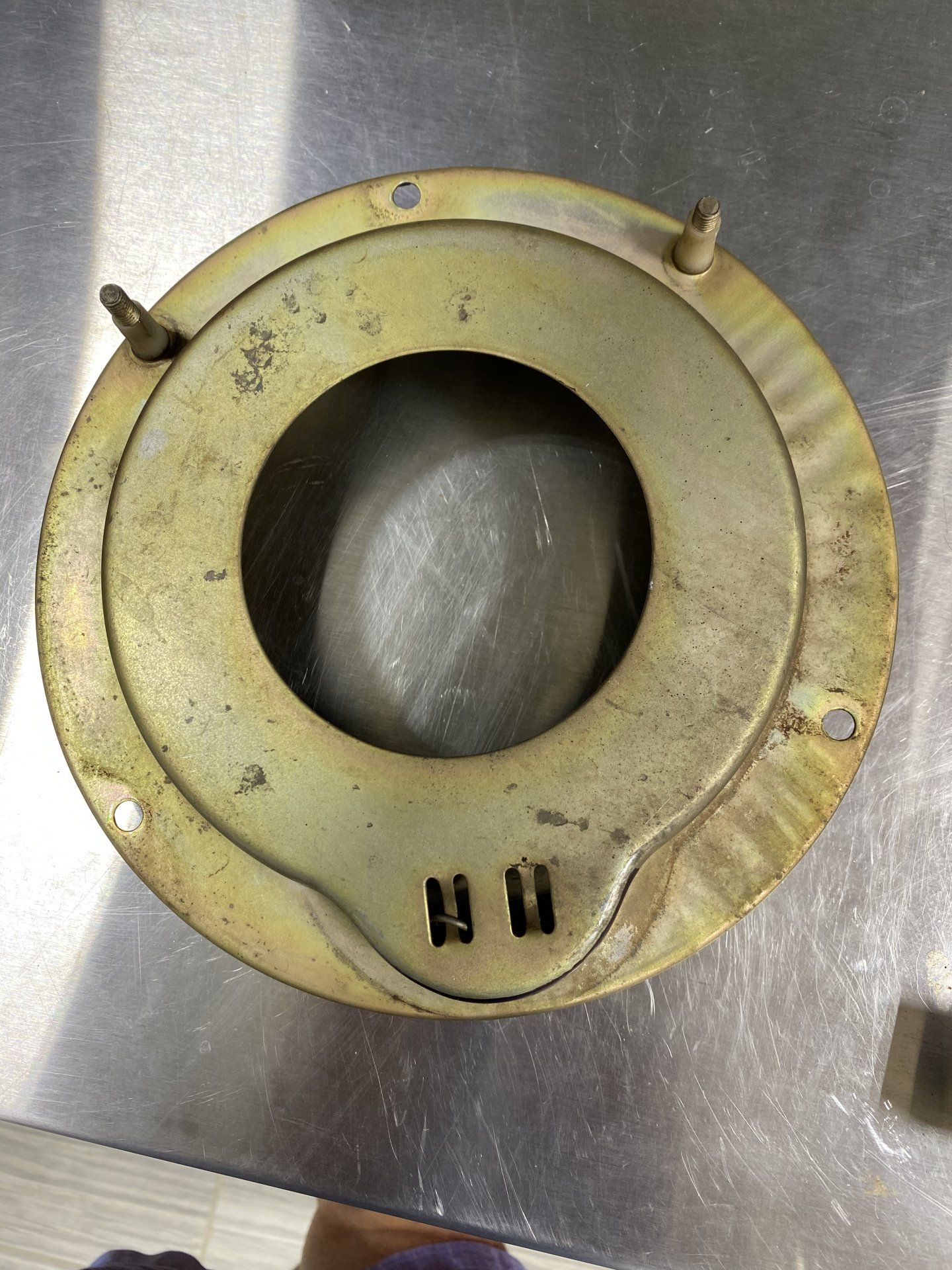

I’m looking for the rubber seals for my headlight buckets, can anyone point me in the right direction.
thanks, R

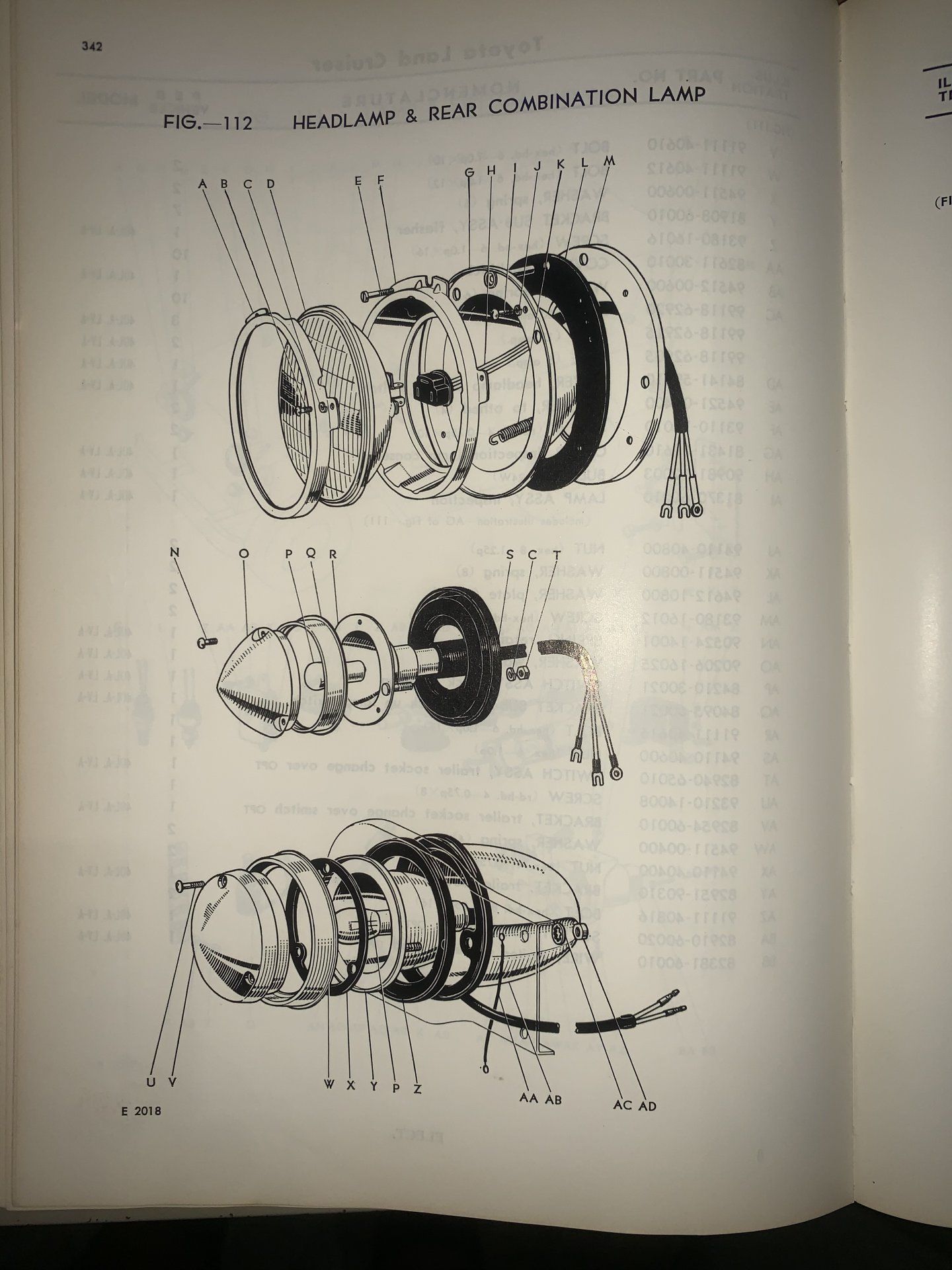

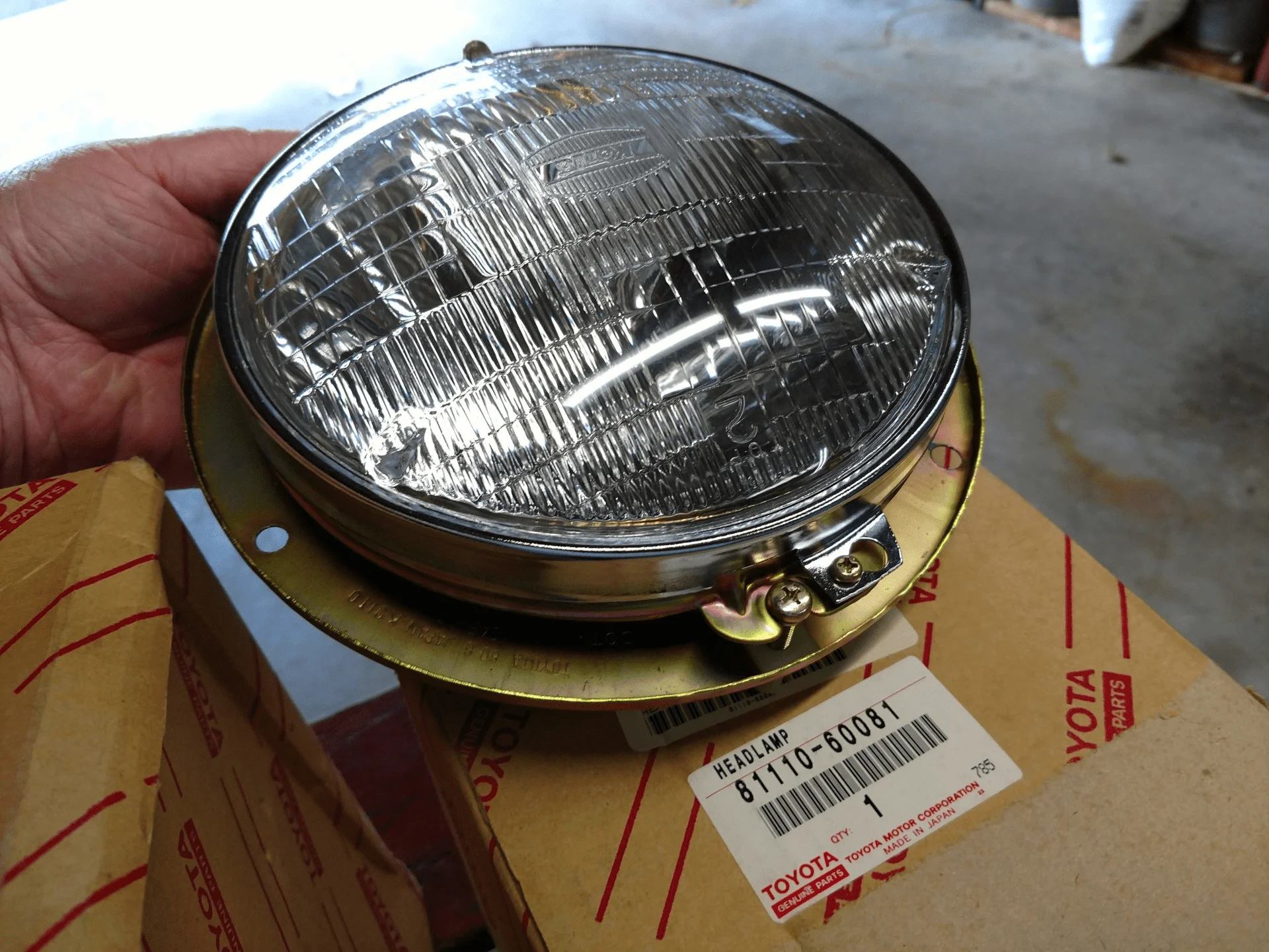

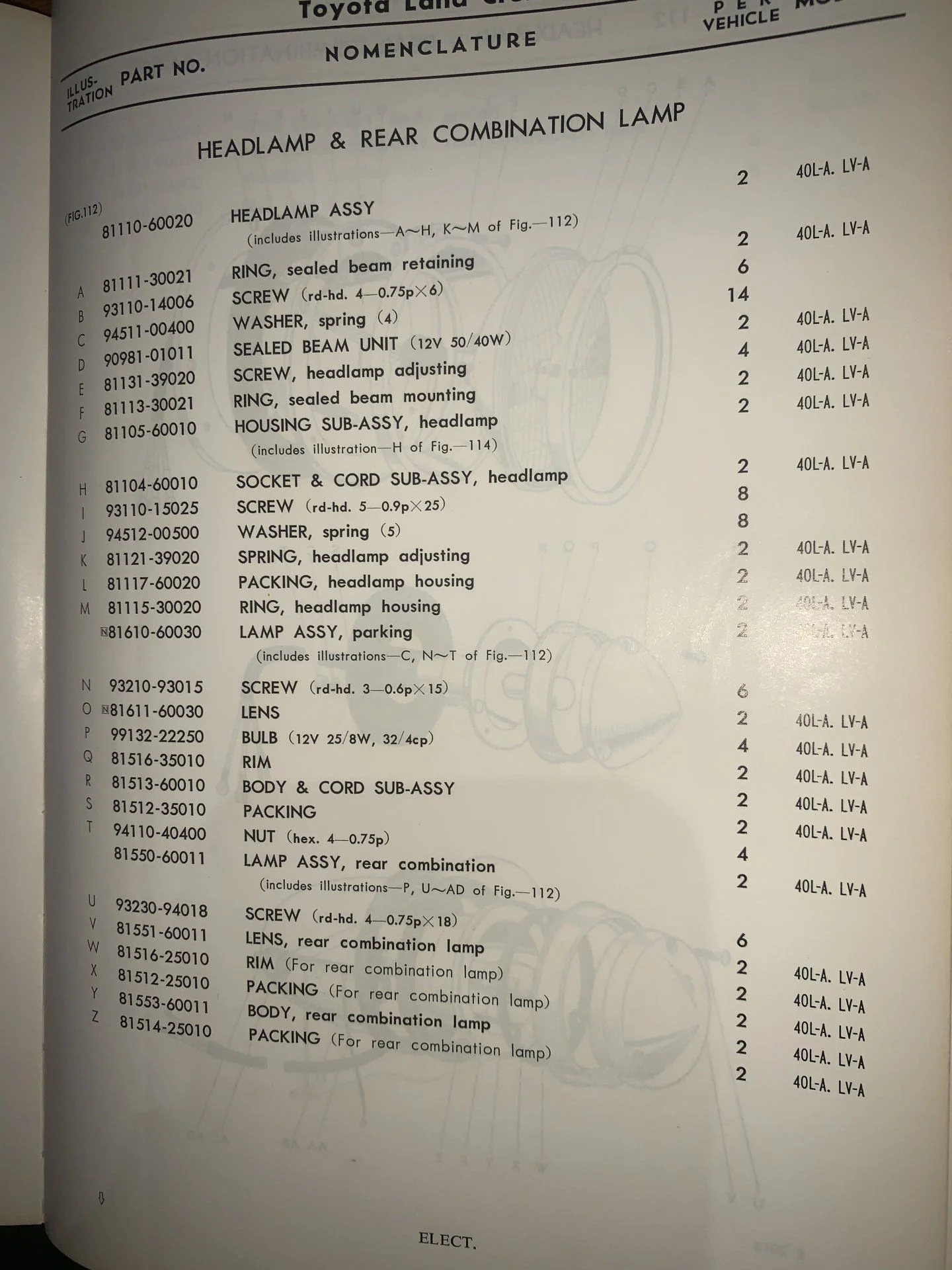

WELCOME To MUD ....... :)
only solid core pre-71 headlight buckets had call-out letter L ,
81117-60020 ,
PACKING , headlamp housing
it was indeed a rubber flat weather strip gasket type approach .......
72-84 NO packing , open style buckets like you have in you pics
