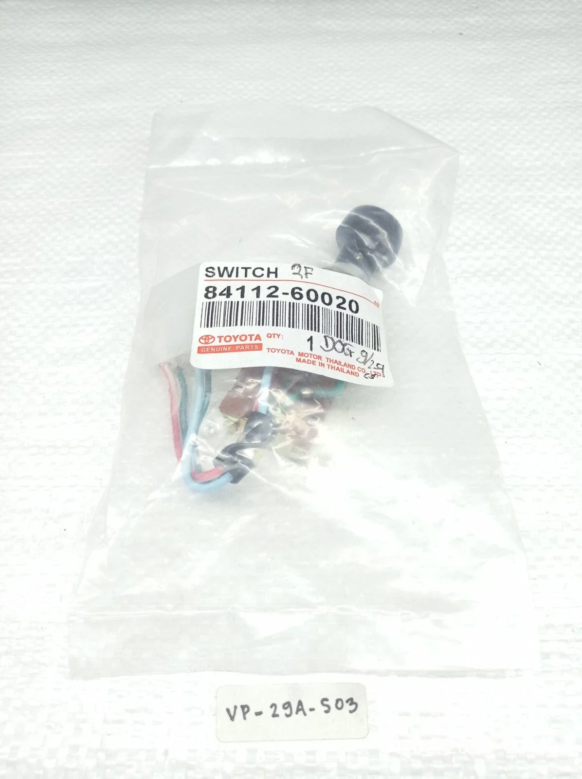

You can have this one. Maybe get one good one out of two old ones. At any rate, here’s the part number. My 40 is Feb 1974.

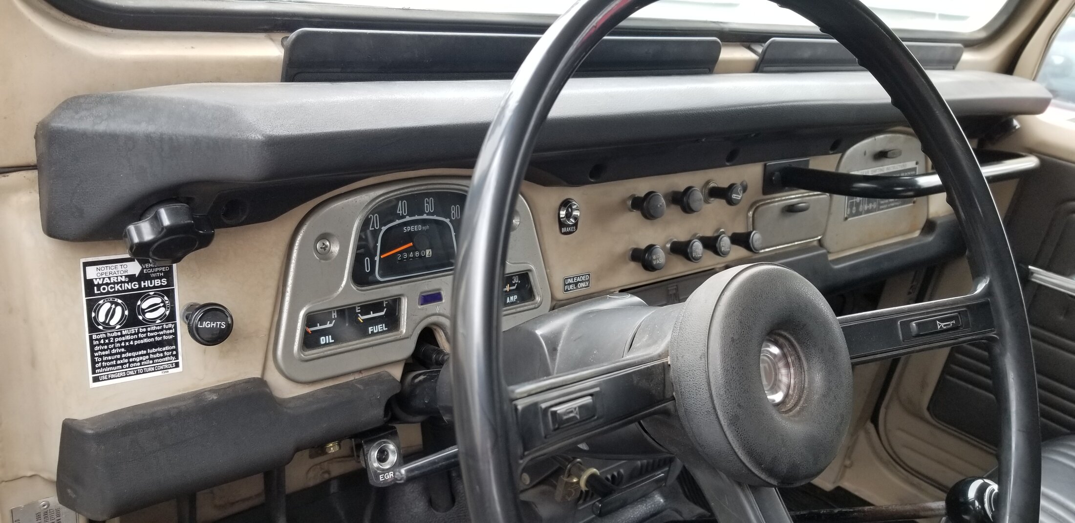

My headlight switch on my '75 40 is missing the chrome trim piece on the drivers side of the dash. I think my switch is ok, but the prior owner must have done some work on that switch and lost the decorative chrome trim in the process. I hate to buy a new switch just to obtain that round chrome piece. Does anyone have that piece or a non-functioning switch they be willing to give up? I'd gladly pay shipping and whatever you think it's worth.
I know what you're saying, but It is a '75, assembled in Costa Rica with components from earlier years. This was per an agreement between Japan and the CR government, to have a company in CR that assembled FJs in a plant there, and sold to the public in San Jose, Costa Rica. The dash, hood, and doors are not what a US '75 would have had. You are right.

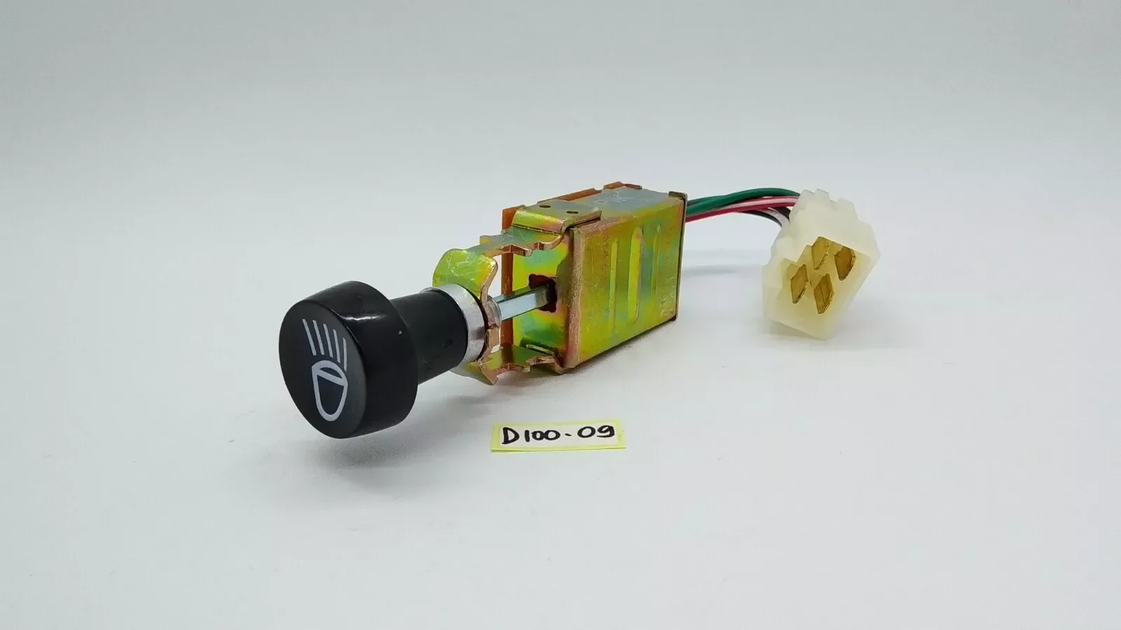

Your Costa Rica assembled truck does not have a OEM toyota head lamp switch ..,
That particular switch you have installed is a Made in Chairman MOE Spec. Market Region … part
It will not be able to be fitted with the OEM Toyota same silver shiny outer pin wrench nut bezel either , because of its aftermarket different thread pitch and diameter design and general nature …
That particular light switch is designed and intended for a Golf Cart , and the red , green and white wires on its pigtail are very unsized in thickness Guage to handle your 1975 Costa Rica 1st pull parking and running lamps let alone head lamps
On also at night time driving ..
You should stop what your doing and make sure it’s wired to a fused circuit and
Not simply hard wired as I have seen many times come to my shop in the past with this same exact switch and others that resemble it …
See below my tech refrence photos of the exact light switch you have and you can further understand what I go over here is by the toyota FSM correctly stated and well intended advice to remove that light duty golf cart switch for 6V and 12v systems with
2 small fog type lamps and 2 small red rear lamps …
Not even close to the AMP draw of a passenger vehicle let alone A nice Land Cruiser like you have …
Matt
these photos below i saw online a while back , i stopped to save because it clearly shows why this golf cart switch winds up installed on land cruisers fj40 fj55 so often ........
this is the same exact switch in the blue 75 costa rica FJ40 above ..
this is a example of intentional scum at work ..
sad ..........:confused:

one word of well intended wisdom here : t
a "correct" aftermarket switch , simply does not exist & you will be repeating the same poor choice that was made already by the poor-choice maker that did not know any better ...
You do know better now as a result of reaching out here in the exact correct way you did ..
only a OEM Toyota Japan spec. Lights Switch will install fit form and function correctly , and for the future as in decades do so as well ...
