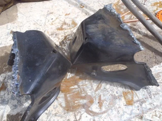

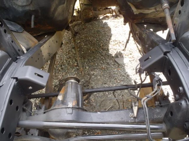

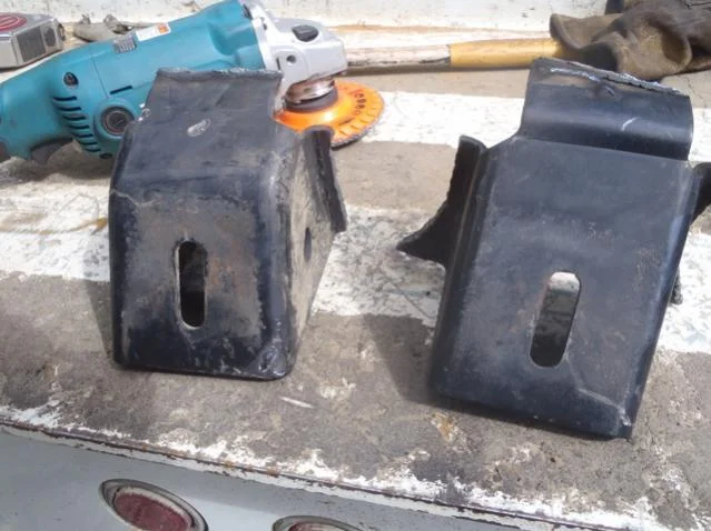

Unlike the FZJ80, the FJ80's 3FE engine mounts will not allow you to bolt the 1HD-T in. They are quite different, in fact. I gouged the welds out around the HDJ81's engine mounts, sacrificing the frame to preserve as much of the mount as possible. On the FJ80, I did the opposite, hacking the 3FE mounts to avoid gouging the donor frame.

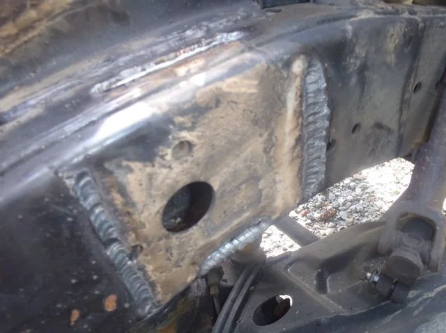

I then cleaned up the 1HD-t mounts, and the FJ80 frame, and the tacked the mounts in position. The mounts are staggered, meaning the right side is farther forward than the left side. Now the are several ways to to accurately transplant the mounts- if it was a totally custom engine install, I'd probably bolt the mounts to the engine, drop it in and tack, then pull the engine and finish weld the mounts to the frame. However, since the frames are the same, I simply took several measurements for each mount and mocked them up that way.
Had I some steel around, I would have tacked a couple pieces in an 'X' formation from on mount to the other, as well as some depth stoppers extending to the front crossmember on each side, to serve as a welding jig. Then I would have cut the mounts off the HDJ81 frame, dropped the whole thing on to the FJ80 and welded it up. That method works great, again, if only I had some steel around.

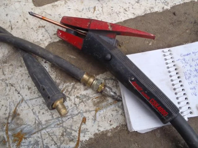

I welded the mounts on with 1/8" Arctec 223 XC. Best rod for outdoors by far. I would have set up my wirefeeder, but I was too windy for running MIG. Anyway, root pass uphand, with a downhand weave and die grind the stress risers. I was pretty meticulous about the welding, because my HDJ81 has some s***ty factory welds, huge stress risers all over the front panhard support. It cracked three years ago and I repaired it, as well as a fishplate behind the steering box. I was thinking about being proactive and reinforcing the FJ80 steering box area before it cracks, I still might. I heard the RHDs were more known for cracking than the LHDs?I dunno if that was a quality control things or a RHD truck leading a harder life?

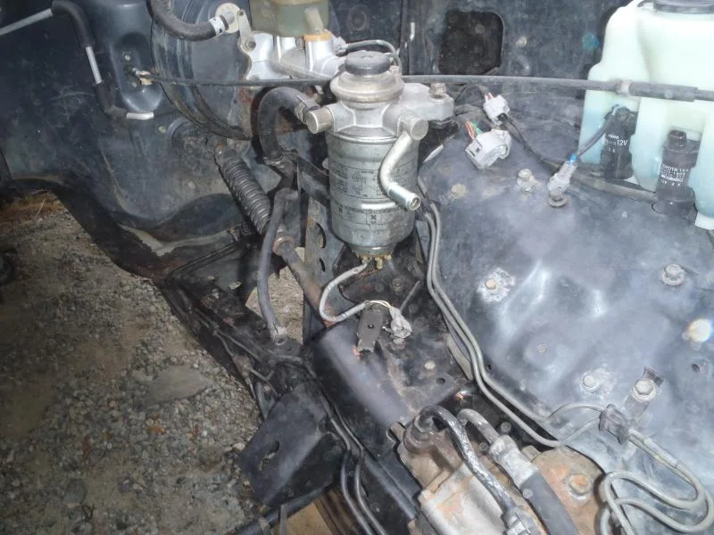

Before installing the drivetrain, I installed the 81's diesel specific fuel tank, line and filter base/primer pump. I also changed the fuel filler neck out. The gas neck has restrictor plate, prevents the diesel nozzle from fueling. Changing said filler neck was a PITA. I had undo that body mounts and lift the body to get enough room to change it. Lastly, I swapped out the brake hardlines as the FZJ/HDJ mounts interfere with the 3FE specific brake lines. Another plus to starting with the pricier FZJ platform for the swap. Note the use of the off road creeper and rounder in lieu of the floor jack for installing the nearly full fuel tank. :hillbilly:

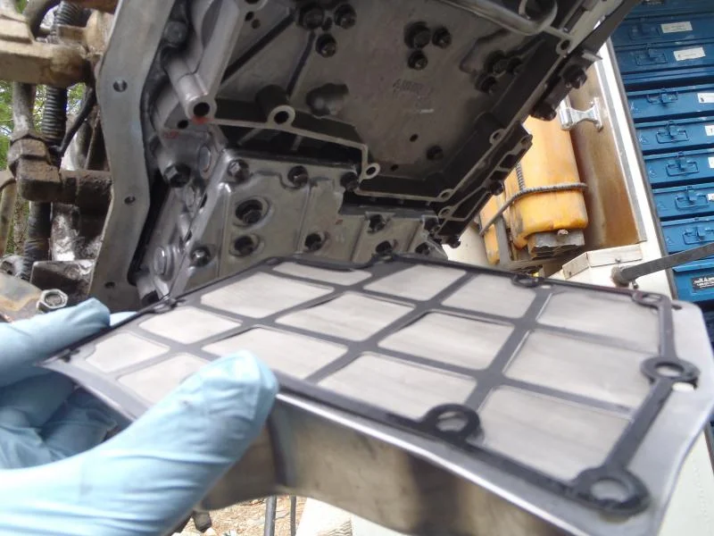

While I had the drivetrain out, I powerwashed and checked everything, replaced the Oring on the PS pump inlet, and replaced the tranny filter. I also replaced some rotten split loom and cleaned the engine/tranny harness routing a bit. I hate bad routing. :mad:

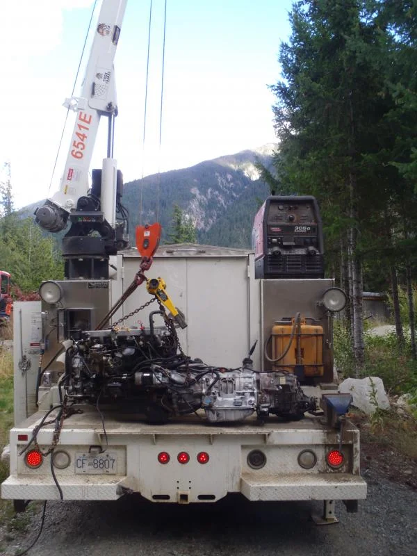

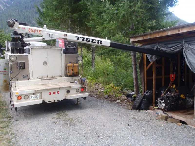

Installing the drivetrain went smoothly. Injun mounts were spot on. Tranny crossmembers are identical as I recall. I used the 81's plastic skids for now, but I'd love one of them fancy cruisenoffroad skids. But most likely I will make my own one day...

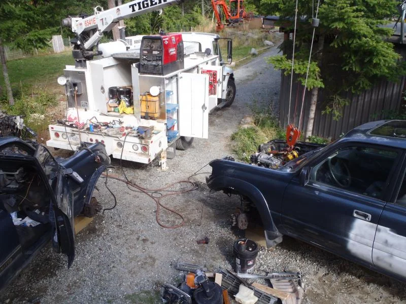

This first pic was taken from my front steps. Why dismantle vehicles 3 feet from your front steps, when there are plenty of better, flatter, out of the way work areas on the claim, you might ask... Well, the idea was that the unsightliness would speed progress so I finish with a couple months, clean up and get on with life. But in reality, I been screwing the pooch on this a lot. Work, life, and other projects have gotten far more attention than the poor Landcruiser in the past few months.
And the mess at my front door? I don't mind too much :hillbilly:

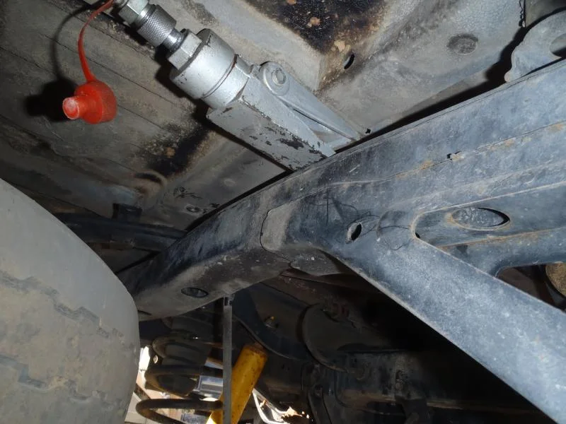

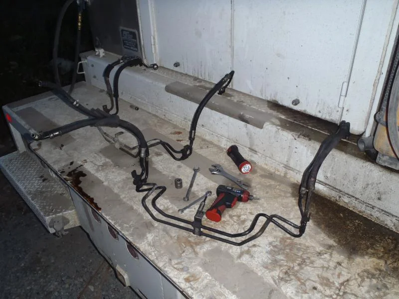

So the HDJ81 uses a RHD box obviously, connected to the gear driven pump by a #6 hose with banjo bolt fittings at the pump outlet, and steering box pressure side and return side. This steering box is also proportional, meaning it uses the electric coil mount at the inlet to modulate hydraulic pressure through the box. It provides less steering assistance the faster you're cruising so you maintain a feel for the road.
I really liked it. The FJ80 box does not offer this option. I thought about building a hybrid box, but like the HDJ81 box, the that inlet casting appeared to be RHD specific and would have interfered with the fender when used on a LHD box. So screw it.
Using the FJ80 box has its own small challenge. It uses double flare fittings, M14 I think. So I set out to make a hybrid high pressure hose using the HDJ81 pump banjo fitting, and half the hardline. Cut/sleeved/silver soldered to half of the FJ80 hardline. It fit good, and no bubbles when I pressure tested it, but I ditched it. The main reasons:
-This line was also to serve as the PS cooling circuit. But it was high pressure. Ideally you want the cooling to be on the return (low pressure) side.
To remedy this, I could have put my spare tranny cooler in the return side, that would be boss, and I will do that when I ditch my M12000 warn for a MileMarker hydraulic, but the main reason I ditched it:
-It was a one off. If the hose or crimps failed in the future, I'd have to get a custom hose made for sure. No good for a vehicle I intend to take far from a half decent hose shop.
So in the end I bought a Napa hose for a 1994 FZJ80. It had 2 rubber sections. I clocked the crimps and formed the hardline in a U shape and mounted on the LH frame rail, pointing upward, right behind the front crossmember.

It gets pretty tight on the USDS of an 80 engine compartment with a 1HD-T installed. The front left corner of said compartment has vacuum, brake, tranny and powersteering pressure, return and supply lines. I spent a lot of time here on routing, and installing split loom. I hate chaffing. :D

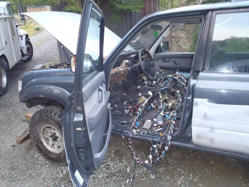

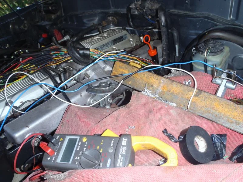

Wiring!

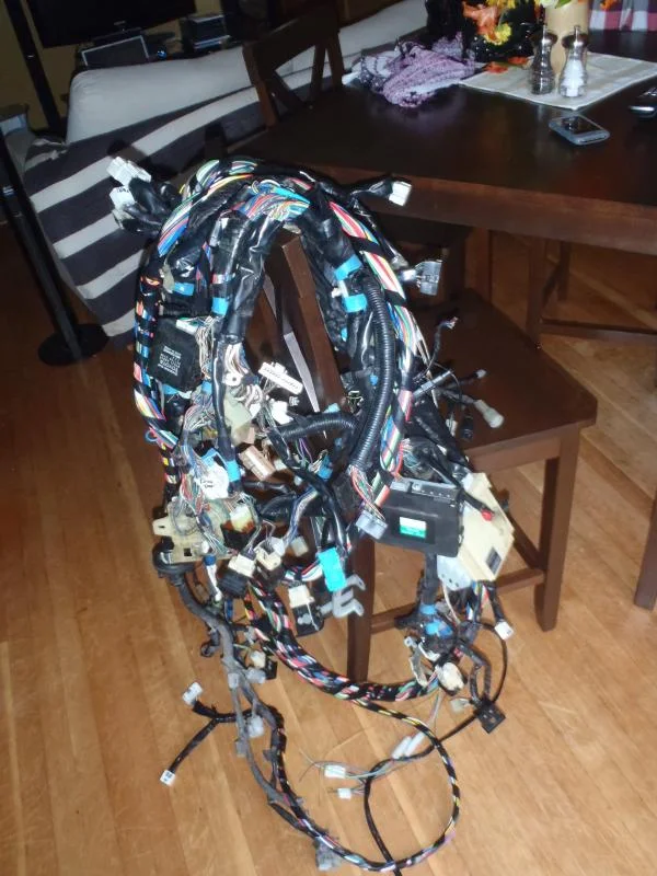

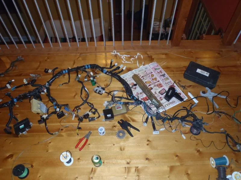

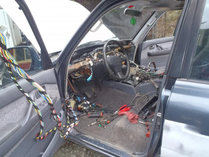

That's a huge part of this swap. Basically the concept I had was to keep the HDJ81 functionality, but in the FJ80 shell. Since the LHD HDJ80 cowl harness is no longer available and cost over $3000 when it was, I adapted the RHD 81 cowl harness to the LHD FJ80 shell. Adapting basically means lengthening, shortening wires, relocating plugs, basically 1500 feet of wire, and a s***wack of shrink tube, tape, loom, solder, and two Snap On soldering guns later... lol
So I figured that since I was drastically modifying my cowl harness anyway, I may as well save the 300 bones for the LHD 1HD-T engine harness (still available) and just lengthen the one I had. So I did.

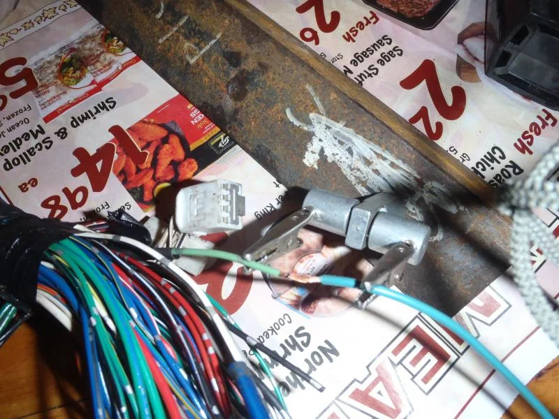

I have a good system for this kinda thing. Its not that bad :beer:
The system is simple. Measure 10 times to determine the length you are lengthening by. Of course too much is better than too little, but the more wire the more resistance you are adding, and more importantly, the more room you are taking up behind the dash!!!
So measure 10x.
Determine the colour and gauge of wire.
Cut new wires, as many as you want at once, just no doubles of the same size/colour combo.
Install 2 pcs shrink tube to each wire.
Wrap tape around group of wires to be soldered, ~6" from ends.
Strip ends.
Cut corresponding wires on actual harness.
Strip ends.
Western Union connection, solder, all connections, one after another so you don't wait for the gun to heat up.
Check joint, slide shrink tube over.
I shrunk all the tube at the end.
In the last pic you can see there was a shielded cable I had to extend. Tach circuit? I used some cable from a VHF I installed.

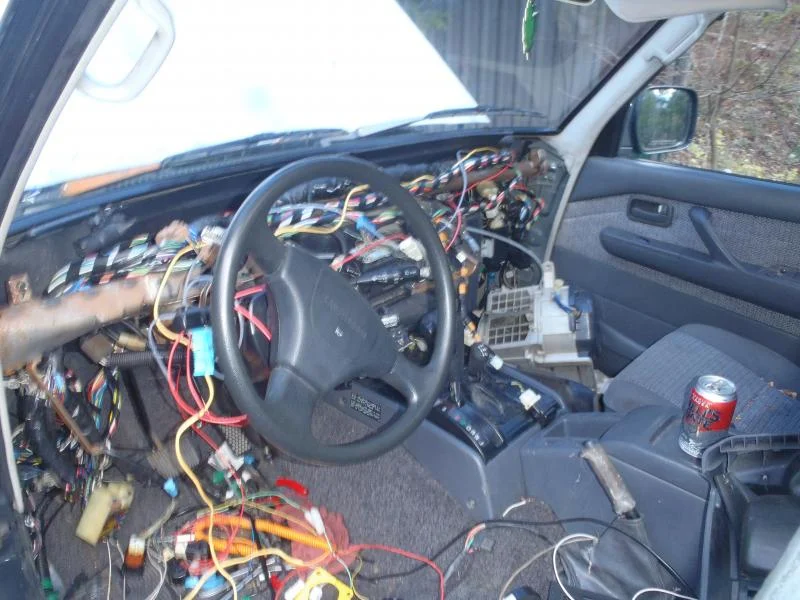

That's all for tonight. The truck is now running/driving. I had to take a break from putting the dash back in. Can't fit the glow timer box back in the stock spot and its pissing me off. Anal like that...
