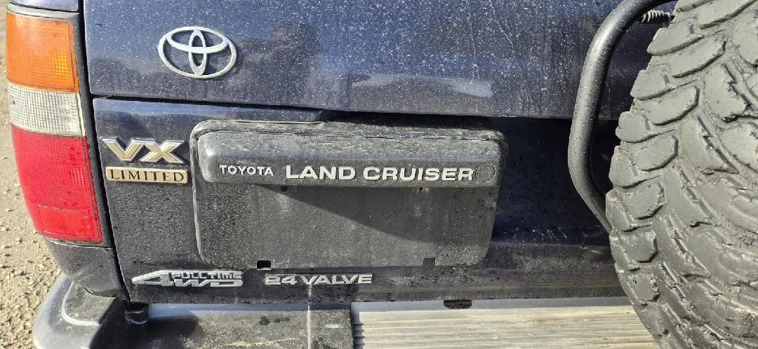

Looking at a rust free low milage (120K) 96 that is Triple Locked and has cloth interior, and a factory rear tire carrier. Unfortunately no subtank, no ambulance doors, and has a damn snorkel on it.
