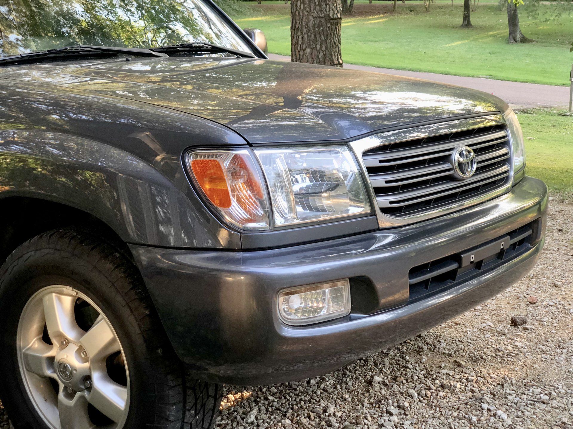

Build date of Sept. 03. Still looking pretty good I think.
