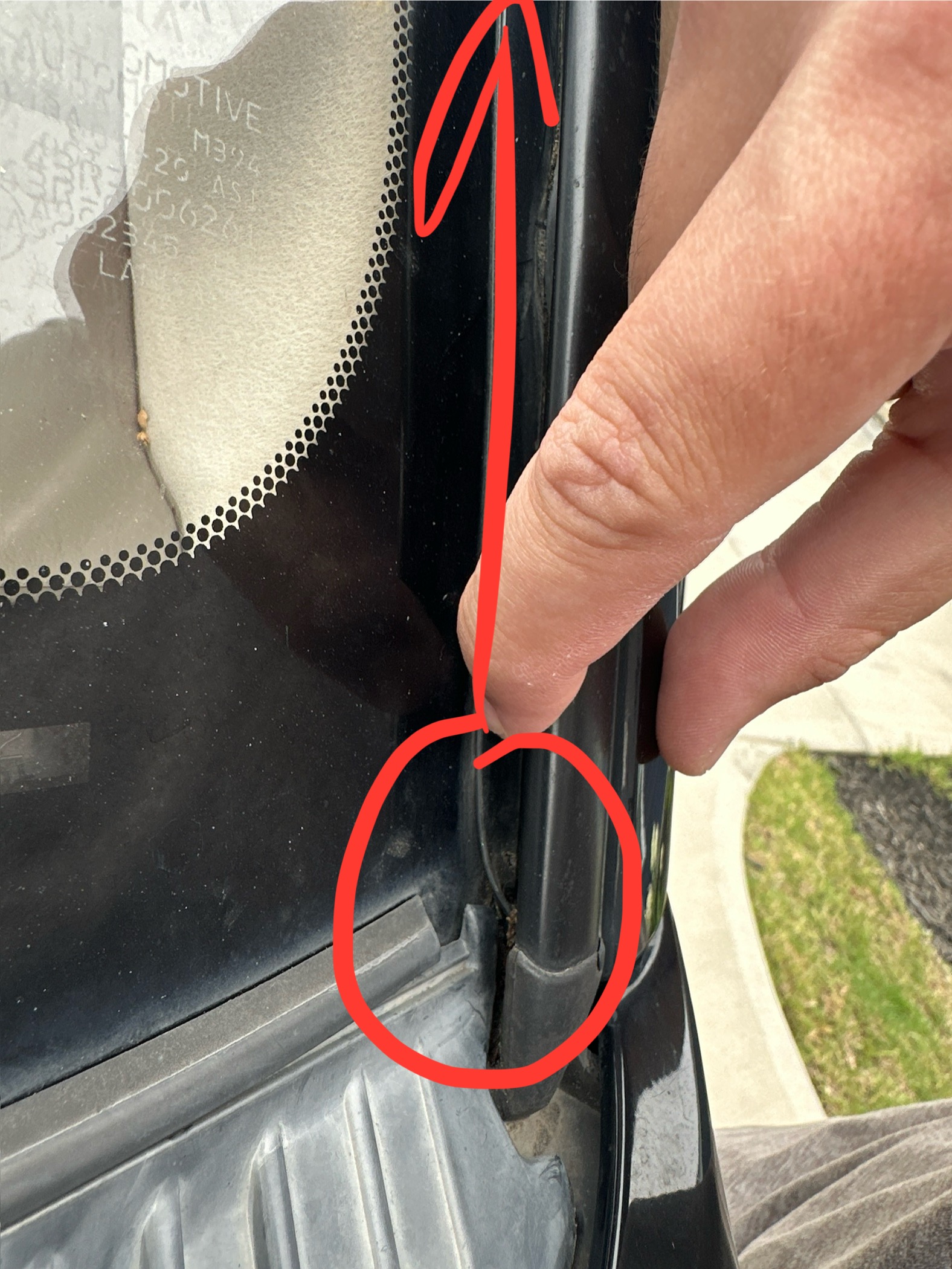

So now I'm at a loss of what to check next. Some other variables for your consideration: I have a Toyota windshield. I did notice that on the passenger side there was a piece of molding(?) missing from the windshield. I hit that side extra hard with the hose, but still no noticeable water intrusion. I thought I remember someone posting that their tow harness caused this problem, so maybe I ought to look there next.

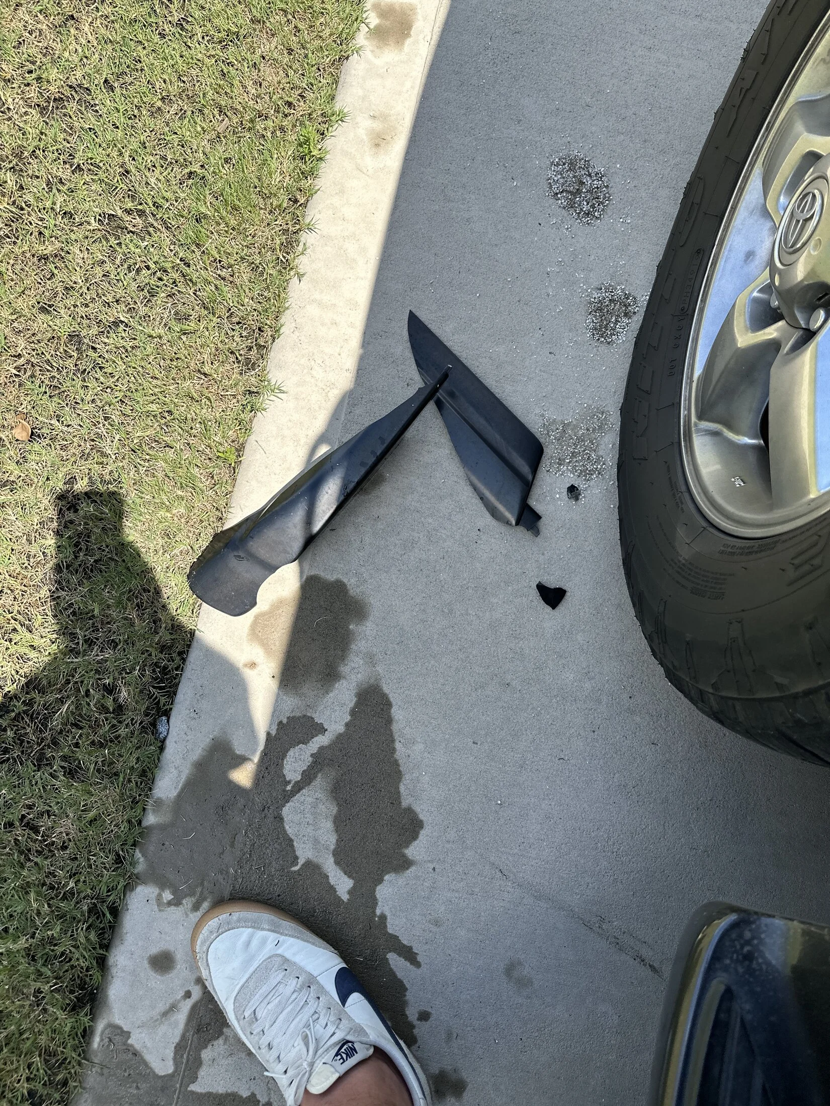

One last sidebar, I managed to snap the plastic roof rack cover on the passenger side while climbing up to look at the sunroof drains. Nothing is ever easy, is it?

The plastic that covers the rack foot is important to keep direct water from the bolts that hold the rack, but you should use some teflon or sealer on the bolts as well since the plastic cover isn't 100% sealed.

Windshield sealing is a PITA and it seems that you got some caulk there that doesn't belong, so someone already tried to seal incorrectly.. I dread the job I'll have to do when I get my windshield reseal plan on the way.

In the meantime, I've ordered new plastic covers for the rack... for the price, I should just get a better roof rack.
