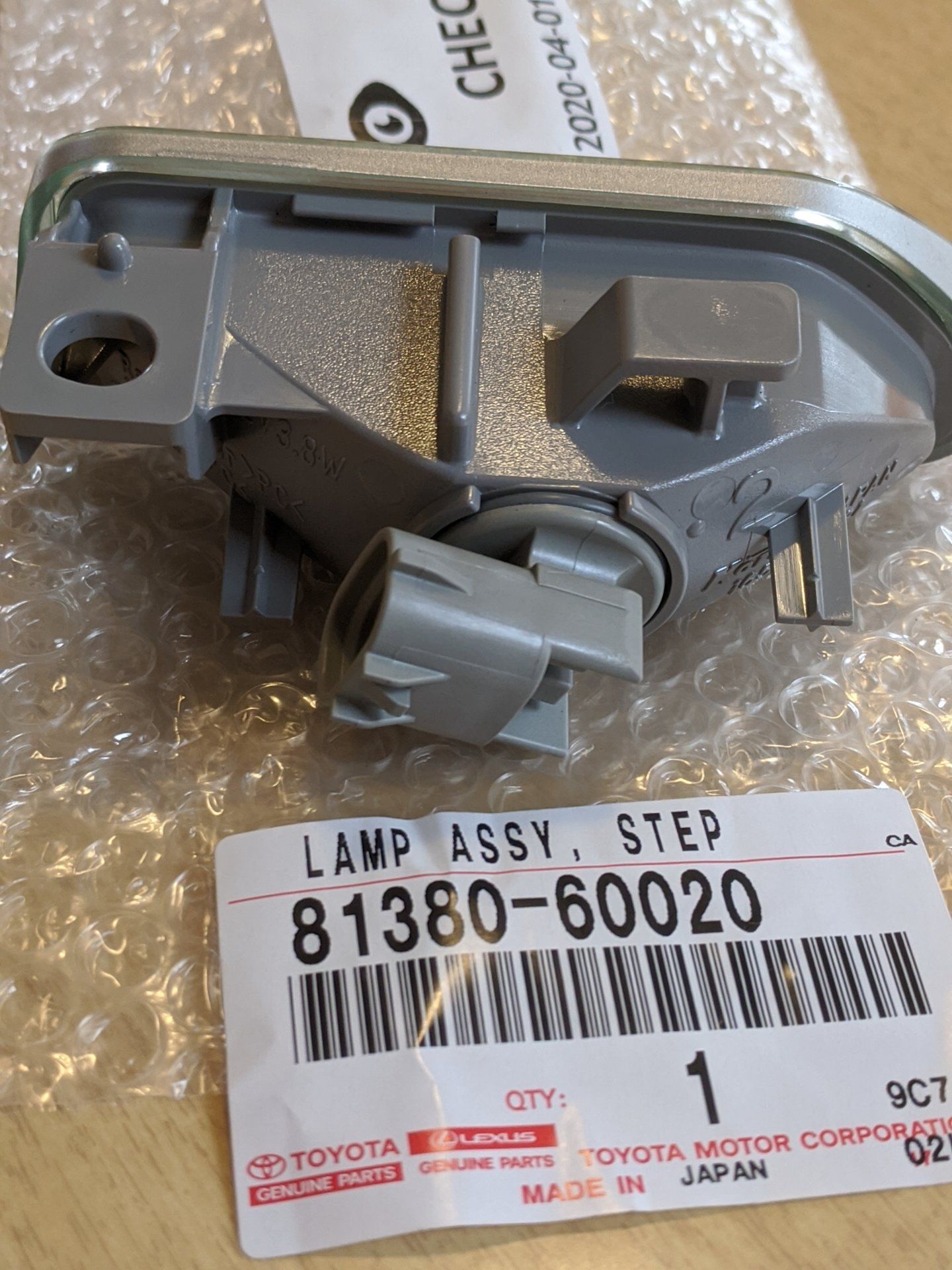

I went and looked at my step lights in my parts bin and all four seem to be the same light as in not a different light for front / back and left / right side. So, it may be that you have to turn clock wise on one side and counter clock wise on the other. The bulb socket is a tight turn but they well made so you may just need to turn a little harder. I recall one of the front ones I reached in with pliers to grab a hold of it.
