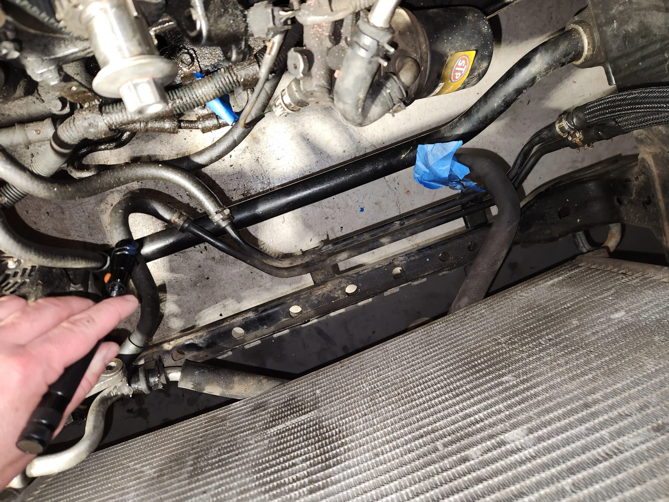

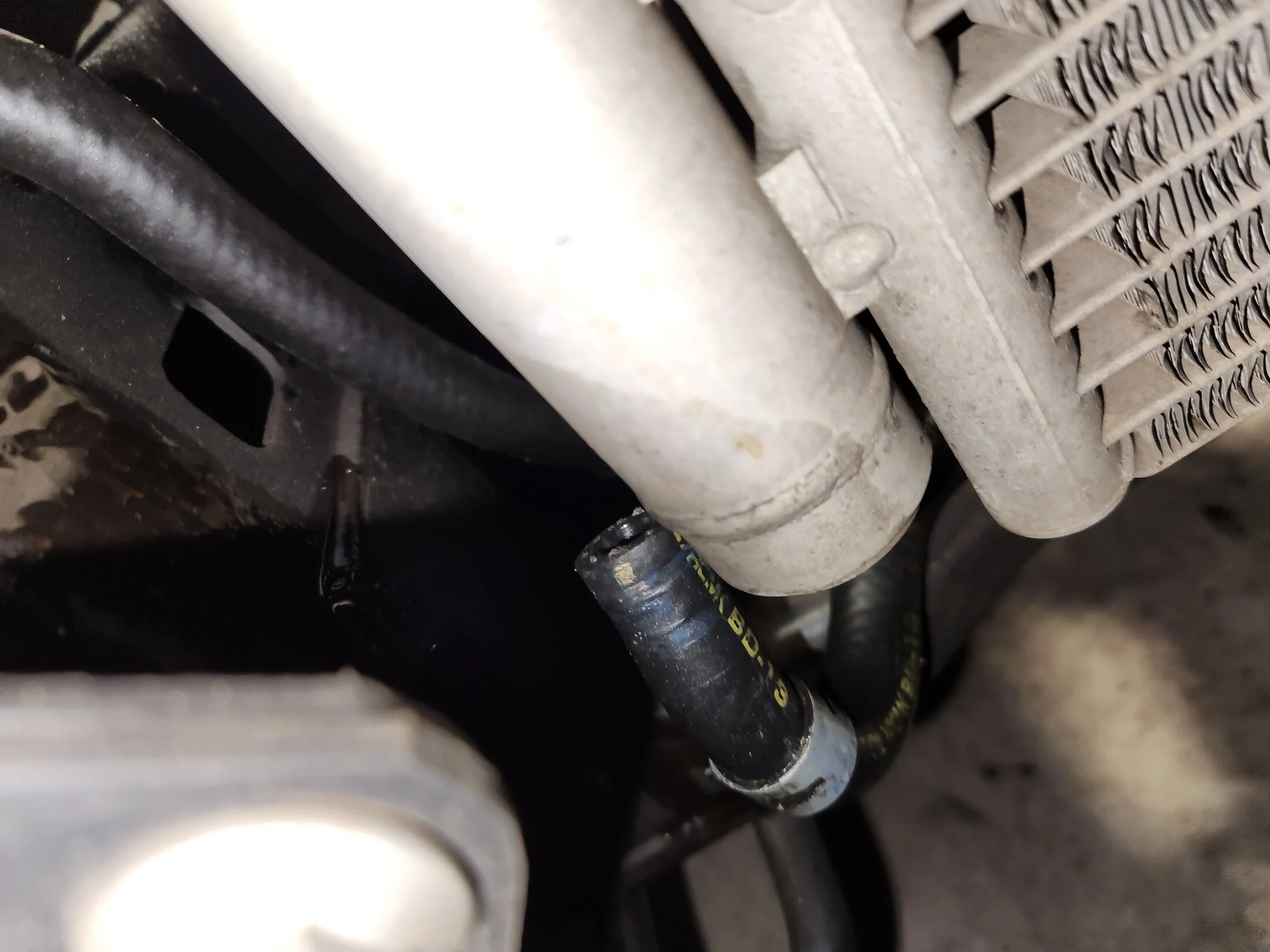

While replacing the Timing Belt, water pump, radiator and compressor, i left the line coming out of the trans cooler uncapped. Didn't realize it was leaking pretty consistently for awhile.
Now I have no idea how much I leaked out and if I can start the engine and drive it to a local shop for them to empty and fill the rest. I've been meaning to take it to them anyway. Unsure if it requires a tow now though. What's pictured is about half of what leaked.
