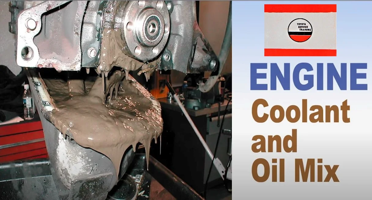

Yep, it lasted 4 months and almost 5K miles in 1KZ-TE. The first and last chinese head for me.
Trying to save some cash on my rebuild and I'm wondering if I should go with less than OEM solutions, I can get one local ish for 400€. I don't think the engine in questions matters as its all the same tin anyway but just in case it's for a 2LTII
Cracked and created pressure to the coolant.

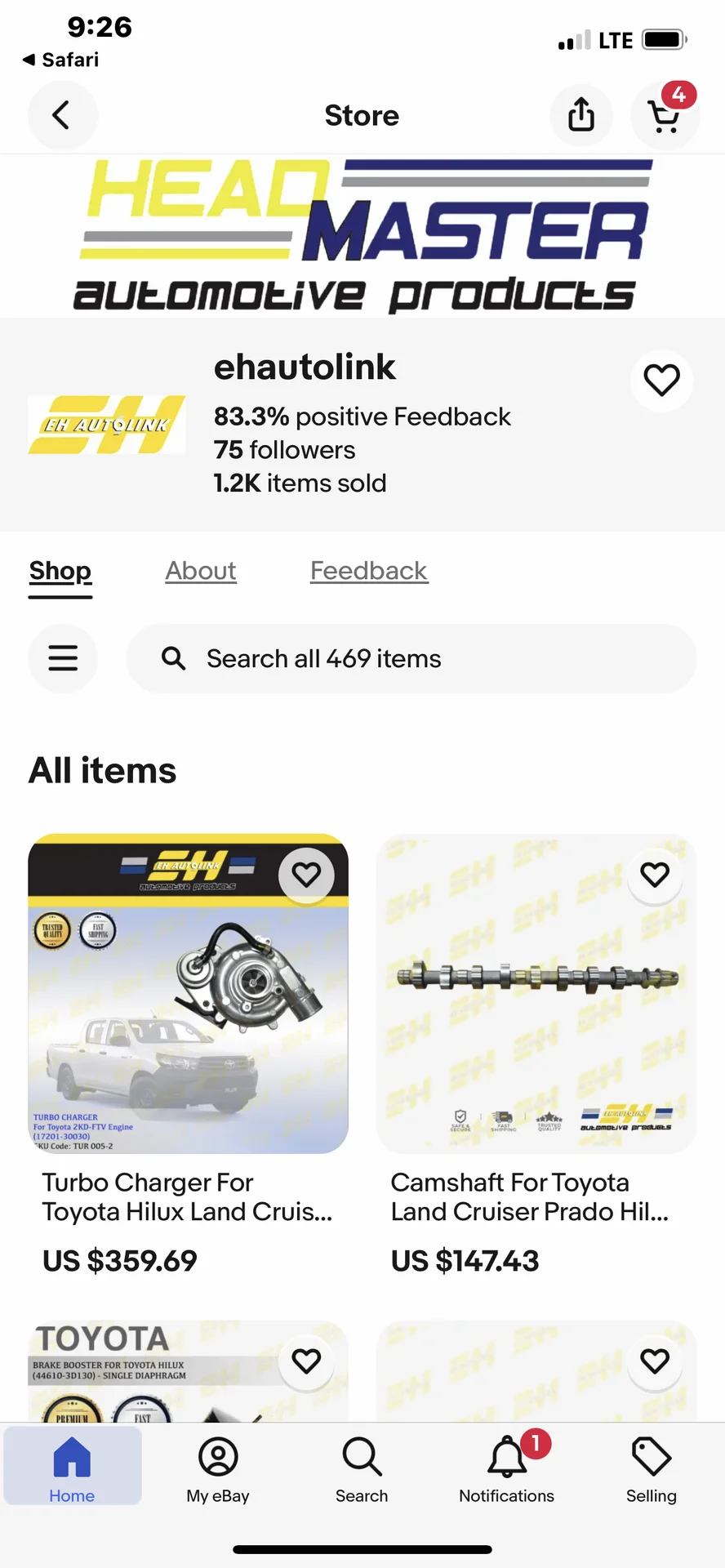

Where do you buy them if its not a secret?
i wouldent mind getting a few of these

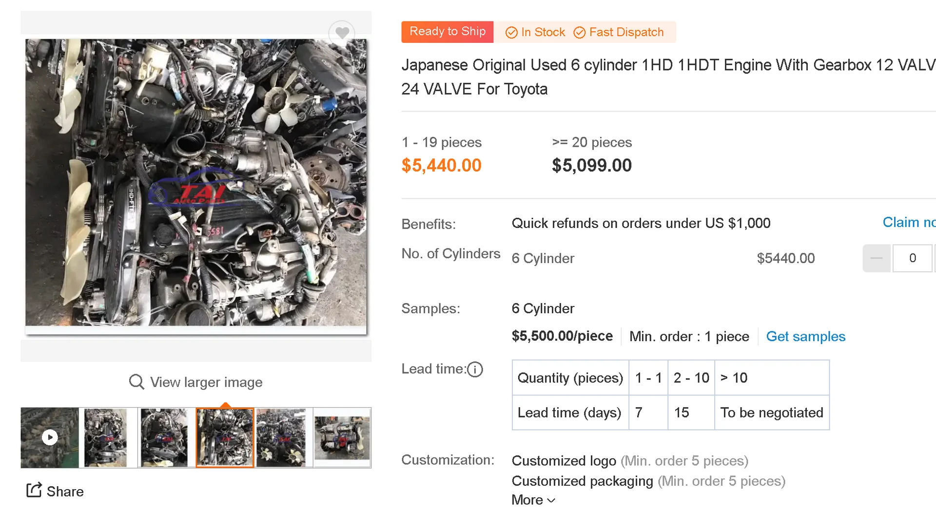

Here in Aus, the 1HZ is common enough that engine rebuilders have these heads in stock on the shelves. If you don't have an option like that available to you, the most direct source would probably be to look on Alibaba, like this one:
The problem with that is, the thing weighs 50kg, so shipping is where you'll get unstuck. If you're running a business, you can bring a palette of them over in a container and wait 3-6 months for them, reducing the relative costs per piece. As an individual, getting 50kgs of anything from a warehouse in Asia to your door is going to be pricey.
Luckily i found a few for sale in the EU so atleast its only a 100 eur in shipping
